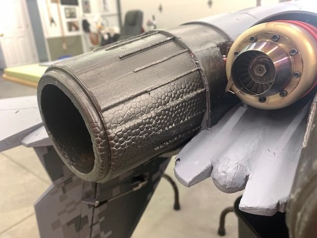

Got a little gatoring on the AB nozzle. Probably from all the auto starts I had today. I will put some HVAC aluminum tape on it and paint it.

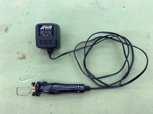

What did you use for removing chunks of foam. I saw the device in the photos, but did you make it or buy it or is it a conversion ?
Details please.
Details please.
Thanks for the compliments guys.
alasdair, the Mig-29 flies great. You will love it.
I think this is the gadget you asked about. It is a lightweight hot wire foam cutter. I got it several years ago from one of my wife's hobby craft stores.
Its a simple wall wart transformer to a handle with a push button switch. I wrap a piece of Velcro around the button to keep it on when cutting. I made the wire cutter from a piece music wire. The small cutters that came with it were not very useful.
I suggested to Keith to make one from a solder gun and shape a piece of music wire for the cutter. Just use the gun trigger to control the heat.

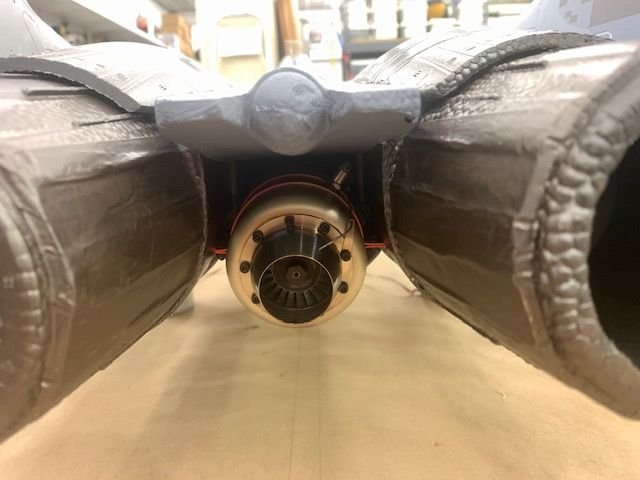

HVAC tape applied to nozzles.
HVAC tape applied and red label ink wiped off with acetone
Tape painted to match nozzles
I attached all 6 air to air missiles to the wings and rechecked the CG. The missiles move the CG aft 2mm which is not significant. Hope to test fly with stores on next weekend.

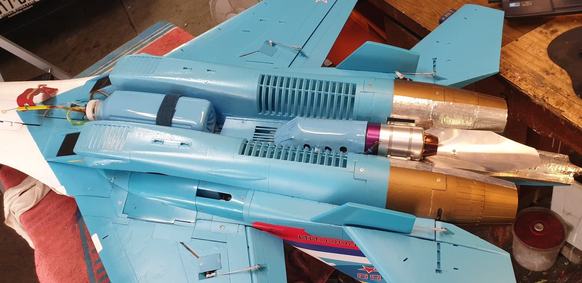

This is my Freewing SU30 and is a similar install. The tank is a one litre juice bottle with felt clunk, no header, and no flame-outs with the X45. Looking at this install, you could make a semi scale cover over the tank and engine and do this quite easily. The cover over the engine is just some thin aluminum
sheet and the engine air comes fro the intake ducts.

Aussie1 had my idea. Just mount an external fuel tank between the engine tunnels and make a flat cover of G10 or fiberglass over the entire bottom to FOD protect the tank and turbine. Paint it grey and nobody will ever see it in the air. Keith did something like this on one of his foamies and it worked great.
I'd get something like this and feed the the header tank if you wanted more than 1000ml.

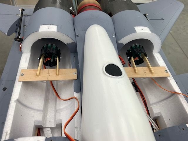

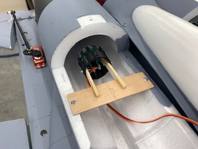

I installed some afterburner lights from RC Geek. They are programmable and I have to on set point at 85% throttle stick.
Lights are designed to attach to the back of the EDF but I made a simple lite ply mount.
Wires routed to front and operate from a Y connnector to throttle channel.
A 2S LiPo battery supplies power. The battery replaces the weights I had in the nose cone.
I also added another washer under the rear turbine mounts. Now the thrust angel has a little more than 6 degrees down thrust. Have not tested it yet but It seemed to be pitching up a little at high AOA and very low speed. We will see.
Ready for next trip out.

Just one question, do you think that two smaller tanks could go to the air turbine tunnels instead in the center between, my skymaster mig has fuel tanks there.
Old 12-21-2020, 08:05 AM
  #72
Viper1GJ
My Feedback: (20)
Viper1GJ's Avatar
Join Date: Oct 2003
Location: Saint George , SC
Posts: 2,295
Received 297 Likes on 193 Posts
Yes I think it would work just fine. I know some others have already done it that way. Its a great flying jet. You will like it.
