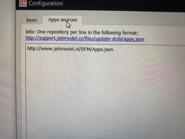

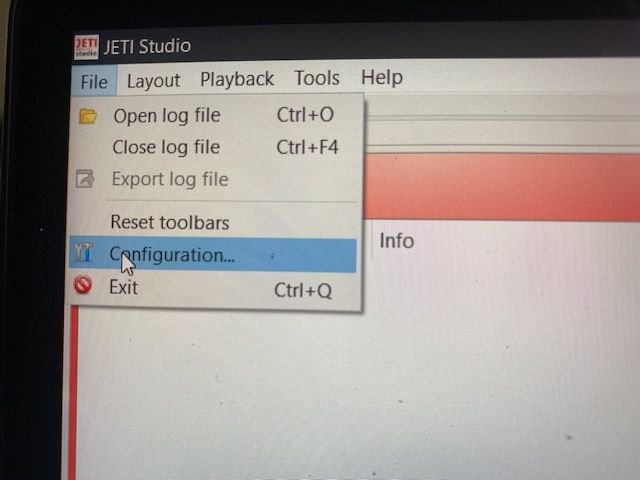

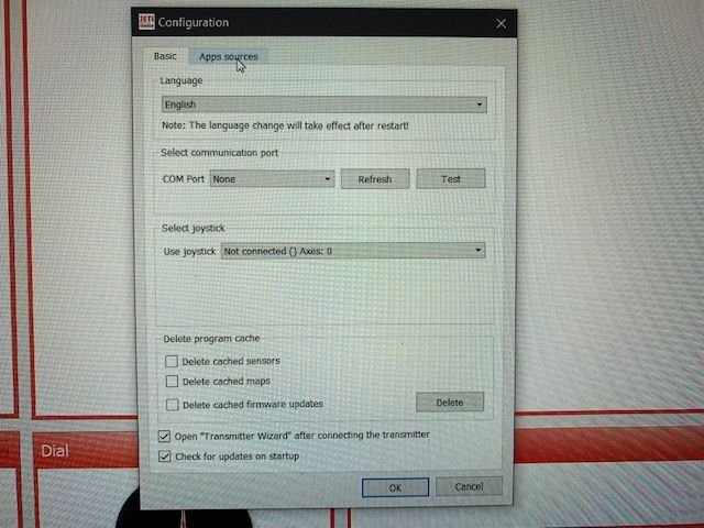

[QUOTE=drfred58809;12698485]Have you, by any chance added another route/link for app files in your Jeti Studio?[/QUOTE
Hi Markus,
I got a reply from Dave last night. He says you have add a link to the configuration in Jeti Studio for his apps. I remember him telling me to do that now.
Go to Jeti Studio/File/Configuration/App Sources and paste in this link: http://www.jetimodel.nl/DFM/Apps.json
Then you should see the DFM apps in the Lua app manager of the Transmitter WIzard.
Hope this helps.
Gary

Hi Gary,
thank you so much for your help & support ! FInally found it and installing ;-)
