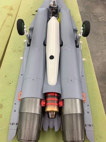

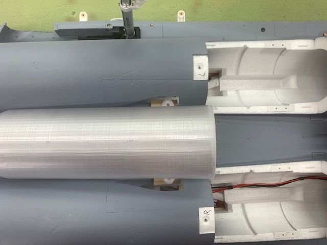

This conversion is in collaboration with my friend Keith (Yellowbird911) and is still a work in progress at this date. As of now the jets have not been flown. We hope to test fly this week. This turbine conversion is not new but the fuel system is unique. Keith designed and 3D printed the functional external centerline fuel tank which made this one of the easiest conversions I have done. Here are the finished photos.
Finished jet
Turbine mounted between EDF tunnels
Functional 3D printed semi scale center line fuel tank with FOD shield for turbine.
NOTE: Keith can not print and sell the tanks due to free design software use restrictions, but he has posted the 3D CAD files in Thingiverse. You can download and print as many as you like for free.
The Thingiverse link is:
https://www.thingiverse.com/thing:4651488
Front of tank

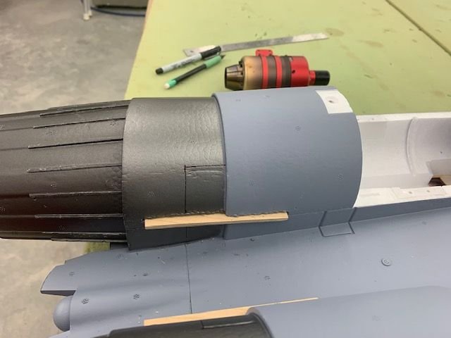

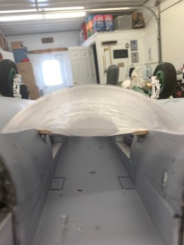

And it starts with a box. Keith and I saw the FW Mig 29 EDF fly at the SC Tiger Meet in October and immediately thought it would be a perfect turbine conversion. Keith has done 6 and I have done 4 using the K-45G3 and so far this is the easiest one to do. It requires very little foam cutting.
Touch up paint from Home Depot paint samples.
Paint match for AB nozzle shrouds
Touch up paint for AB nozzles that I had in the shop.

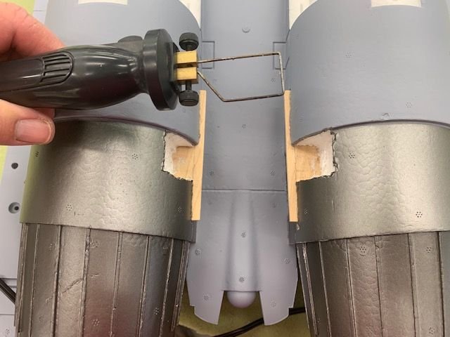

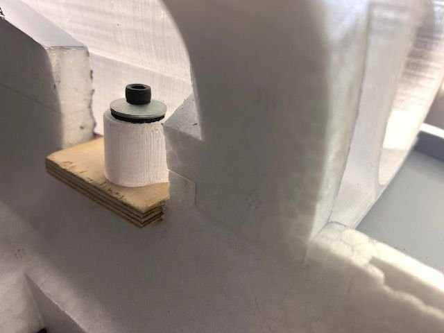

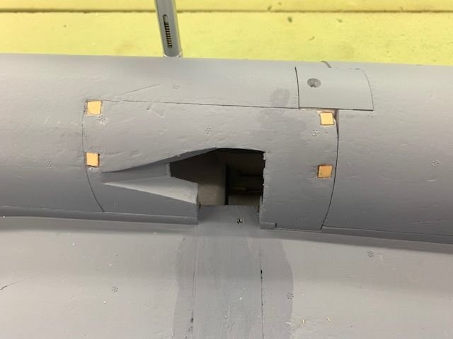

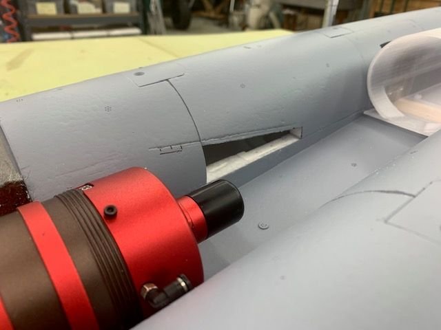

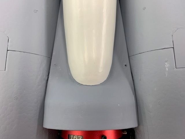

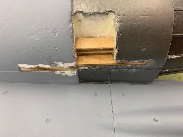

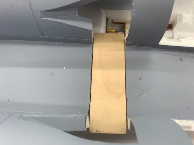

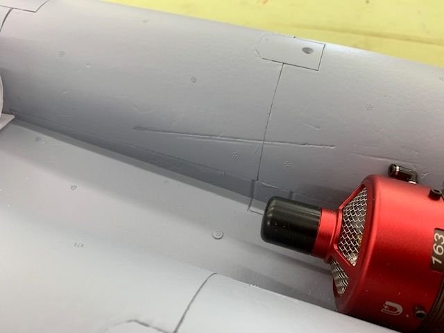

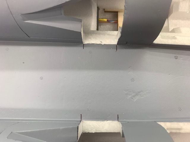

Mounting turbine

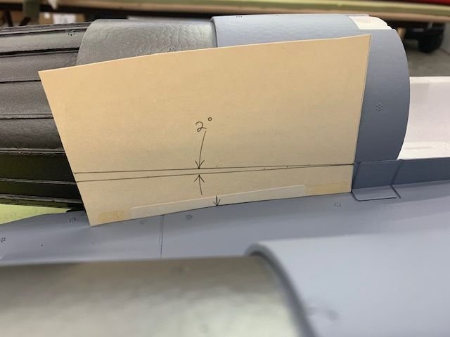

Based on Keith's recommendations and experience from his F-14 conversion I put in some down thrust to compensate for the under slung turbine mount. The amount was 2 degrees based on highly complex TLAR (that looks about right) calculations. The EDF thrust line is the edge of the EDF hatch. I made a card board template to transfer the 2 degree down to the foam.
Stop right here and don't do this!

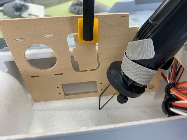

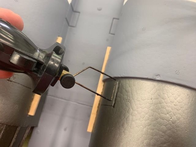

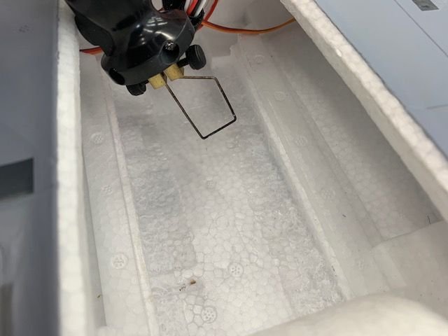

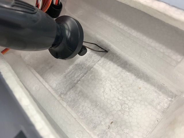

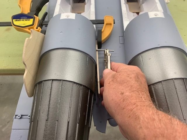

Next I made a wood template to use as a hot wire cutting guide. I forgot to add the space above it needed for the turbine mounts. As a result my slot was 1/2" too low. If you use this method be sure not to follow my photos as you will have to shim the turbine up about 1/2" to clear he bottom of the fuse.
Hot wire cutter
Slide wire back through the foam. Depth of cut is controlled by the pliers next to the wood.
Slot cut

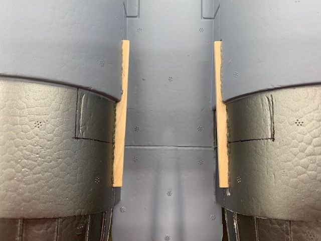

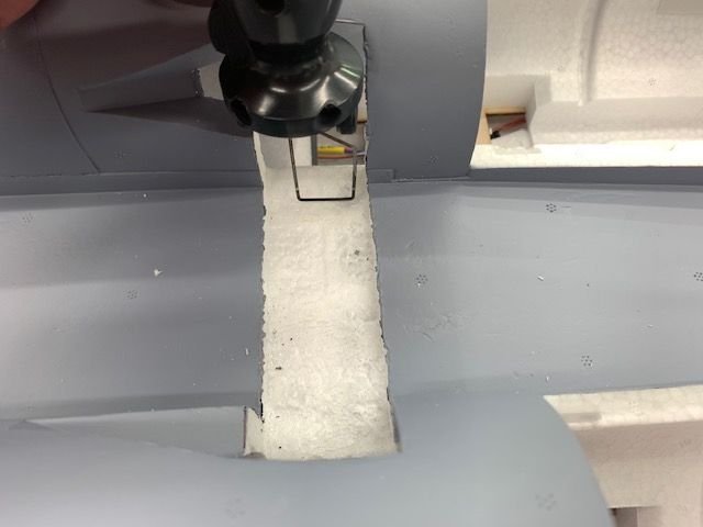

ARRRGH! My slot was cut too low as I forgot to compensate for the radius of the turbine mount.

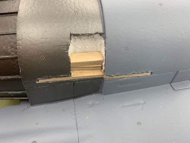

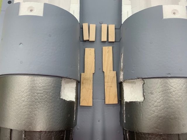

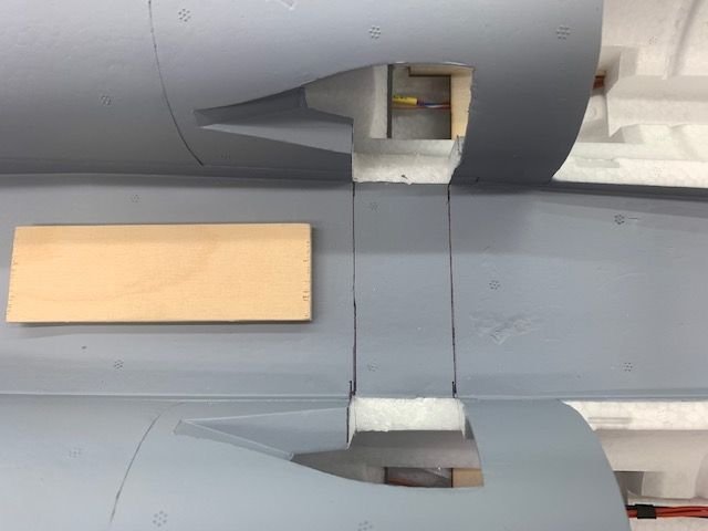

Now the fix. Trace turbine wings on foam.
Mark foam to be removed
Plywood rails in foam
Hot wire cutter to remove foam
Foam removed

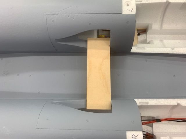

2 1/4" ply shims placed on top of turbine rails. YOU can avoid this fix if you just cut the slots where they need to be in the first place!
Ok here
Parts ready to glue in

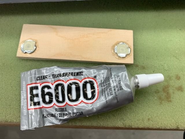

E6000 used to glue in wood. Keith did a glue test with BSI Foam Safe, E6000, and Six10 epoxy. By far the E6000 was best because it bonded to the foam much better.

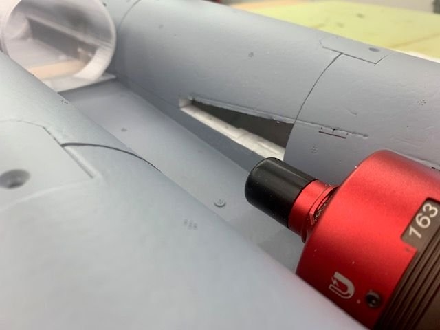

Install pitot tube
I will be using a Digitech CTU with an airspeed sensor. Foam had to be removed from the radom to install the pitot tube.
Careful at the nose since removing too much foam will cut through the surface. Just enough clearance for the air tubes to the module is all that is needed.
Done
Doesn't look bad.

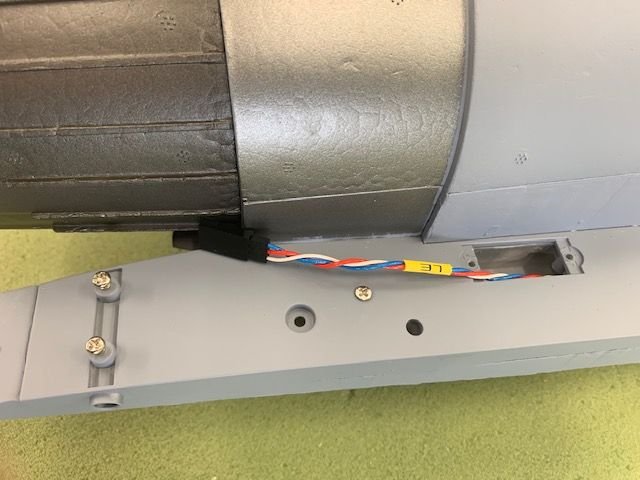

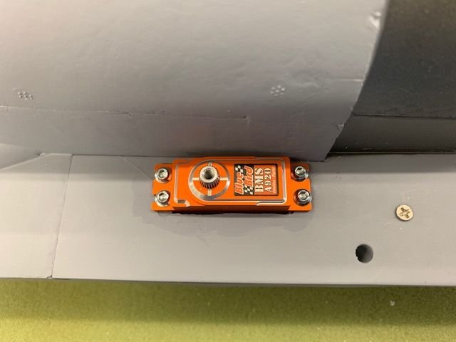

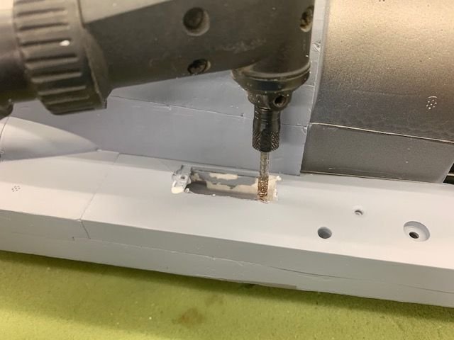

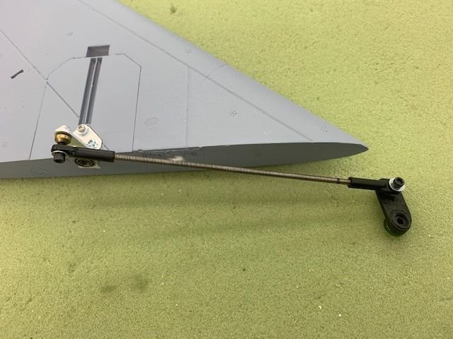

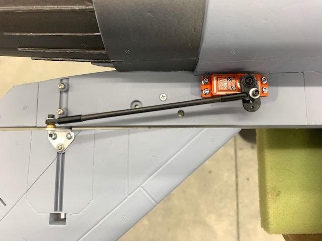

Replacing stock stab servos
There have been some issues with the Mig 29s crashing due to loss of pitch control. The events are well covered in other threads and I won't repeat here. Keith and I decided to replace the stock micro servos with hi torque mini servos and change the stock linkage to 4-40 rods.
I also replace the stock servo extensions with Powerbox Maxi wire
Existing servo hole cut to larger size
Edges cleaned up
New servo installed
4-40 threaded rod used
Pushrod squared to servo arm not the fuse side
Carbon sleeve over threaded rod and inner hole used in servo arm.

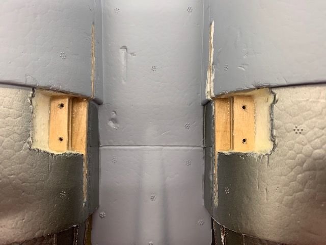

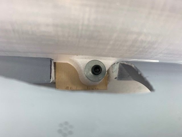

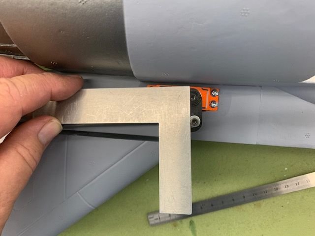

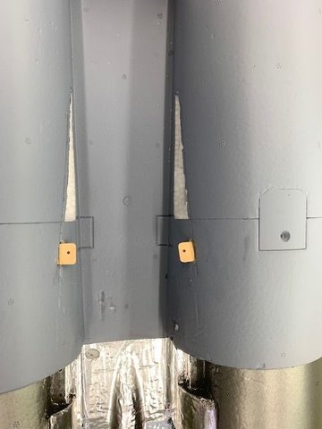

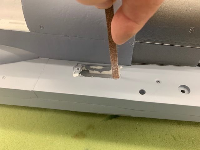

The has been much discussion about the stab mounts twisting on the stock fuse so Keith and I modified the stab mounts as follows.
6mm aluminum rod cut to 190mm
Rod had to be sanded some to fit inside the stab bearings
6mm drill bit used to drill through foam in nozzle
Areas around holes scuffed inside nozzle
Dry fit of plywood hard points inside nozzle
Hard points glued in with E6000
This mod stopped the twisting on the stab bearing in the fuse. Very stiff now.
Mods painted to match nozzle color inside and out.
spitty (09-29-2021)

Thats a great idea to reinforce the stabs!

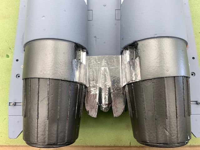

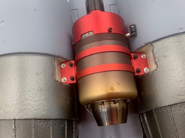

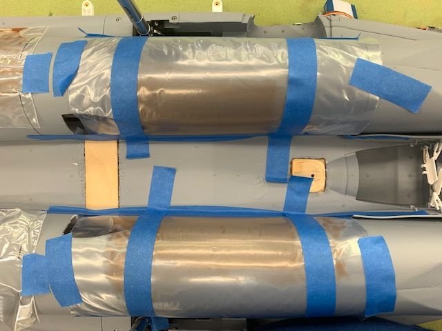

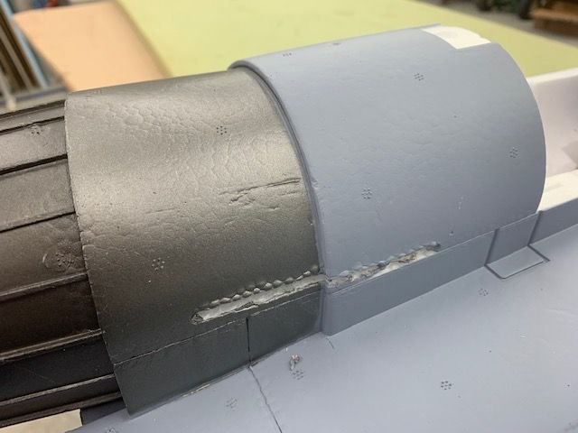

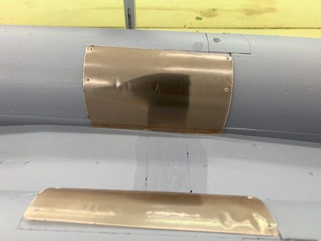

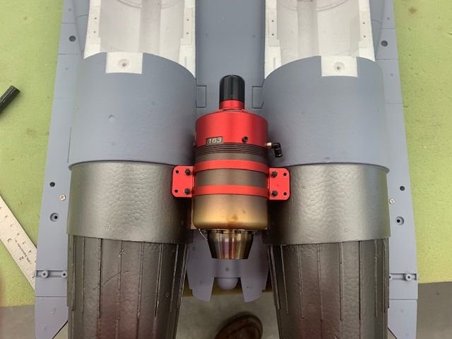

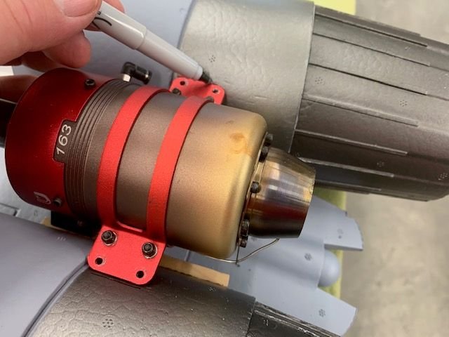

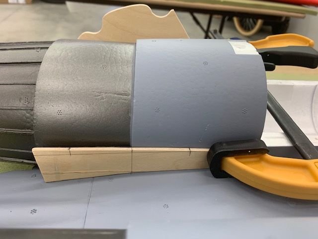

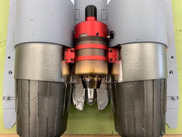

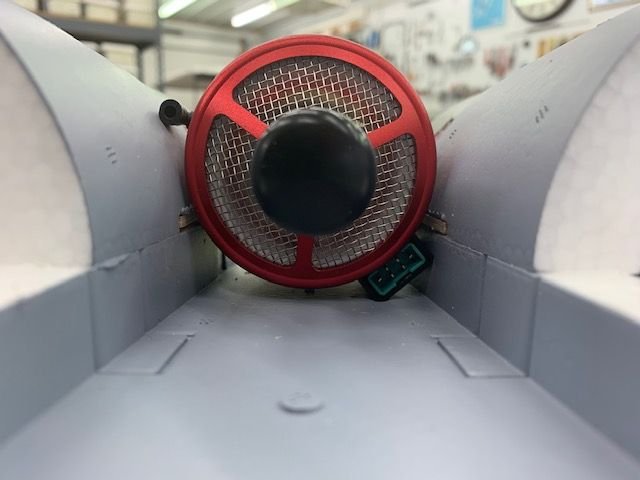

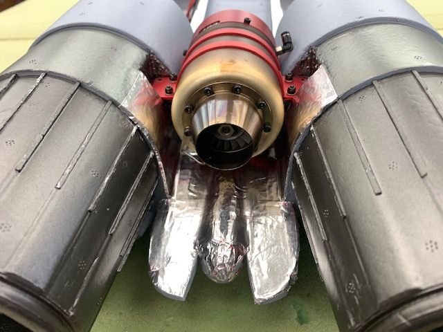

Turbine mounting and aluminum tape
Turbine mounting holes drilled
Turbine screwed on with 3/4" screws to get through all the shims into the mounting rails.
HVAC tape applied to areas around turbine hot section
Gunmetal and grey paint applied to HVAC tape to blend in to the fuse colors later.

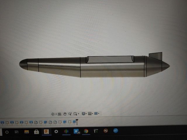

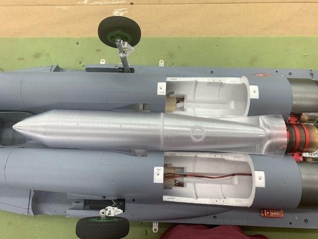

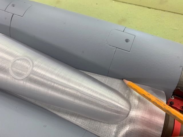

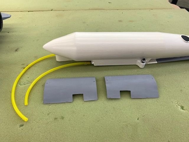

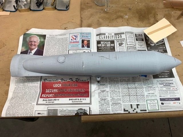

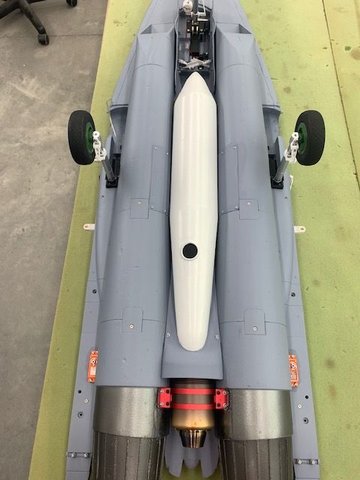

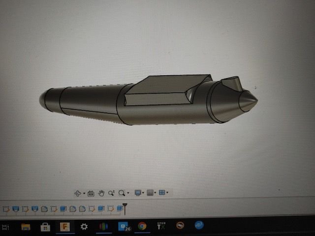

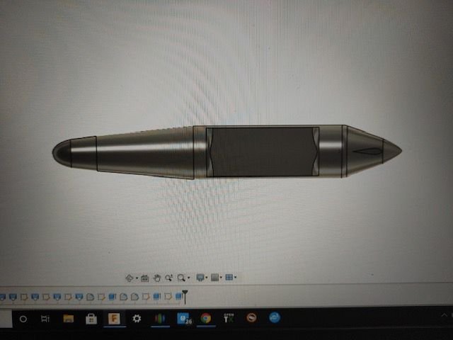

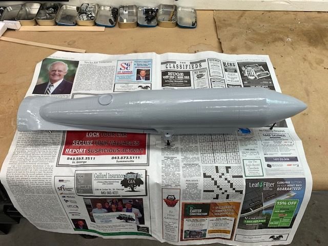

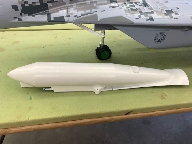

The Tank
What makes this foamy conversion so easy and different is the functional centerline fuel tank. There was not much room for fuel near the CG on the inside of the fuse. Keith had 3D printed external tanks for his F-14 conversion and suggested an operational centerline tank. I found a few photos of the Mig 29 with centerline tanks and Keith went to work making CAD magic.
Good view a scale tank
Rear view
I read that the black hole in the rear of the tank was an APU exhaust port that went through the tank. Could not confirm but it makes sense.

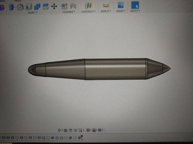

This stuff is way above my paygrade.
Screen shots of CAD magic
And from this you can print real stuff. Who would have ever thunk it?
Old 11-13-2020, 07:18 PM
Viper1GJ
My Feedback: (20)
Viper1GJ's Avatar
Join Date: Oct 2003
Location: Saint George , SC
Posts: 2,273
Received 284 Likes on 185 Posts

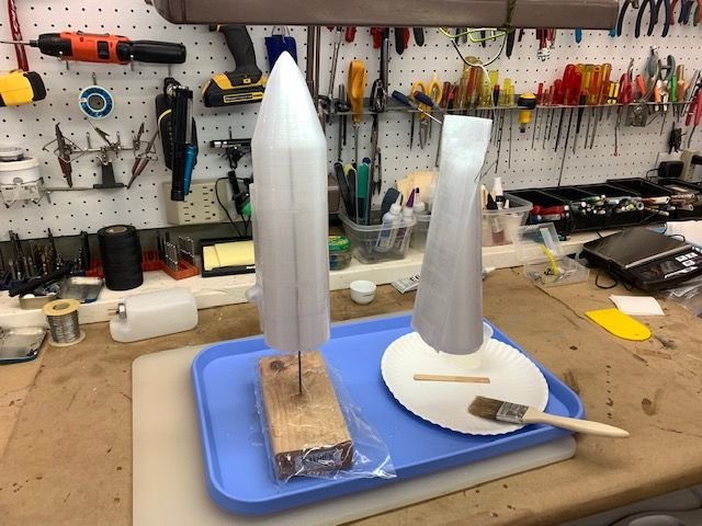

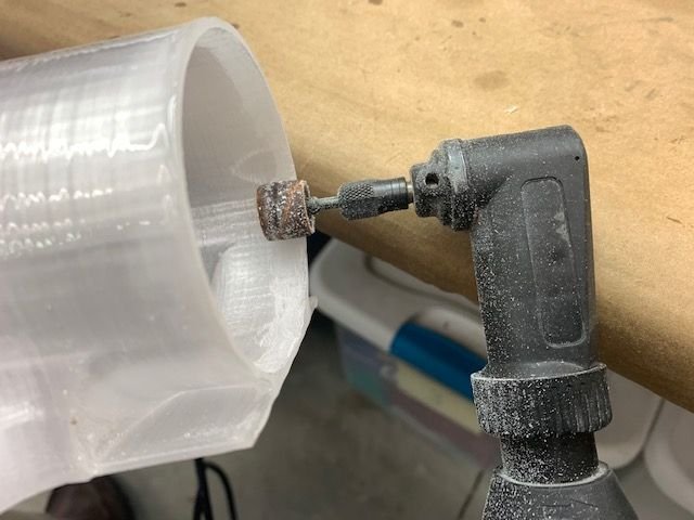

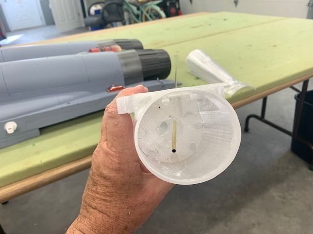

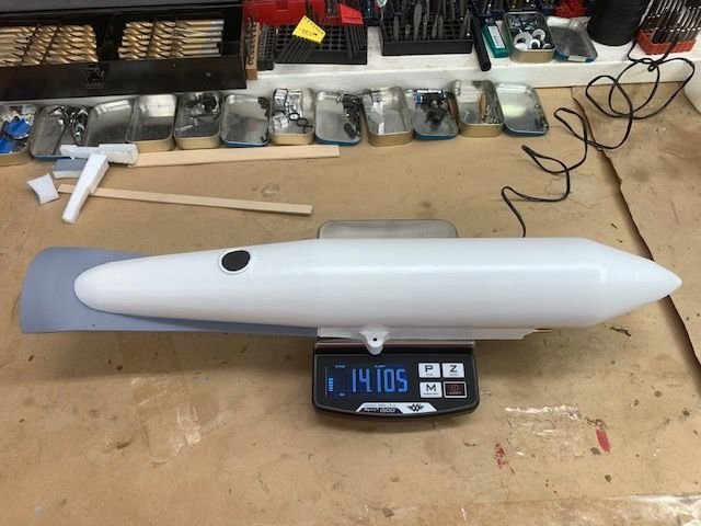

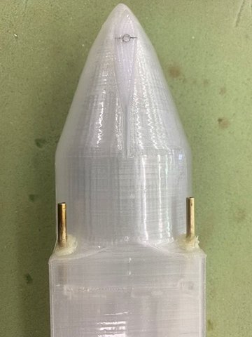

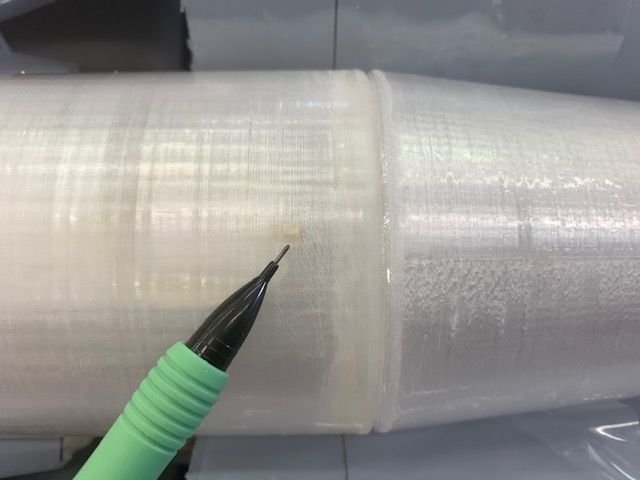

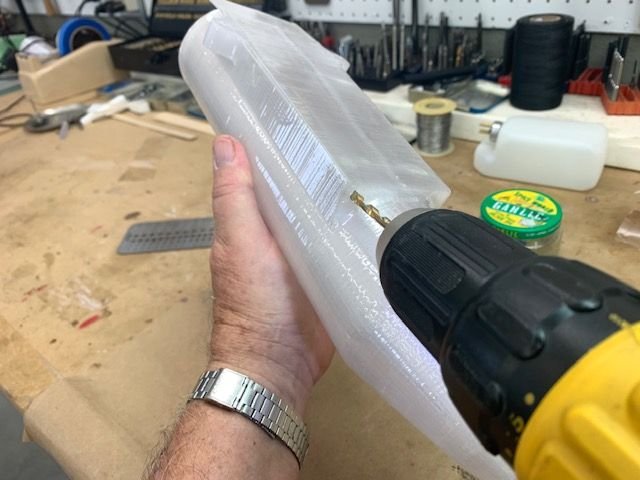

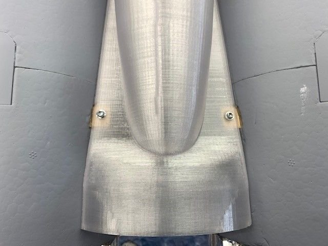

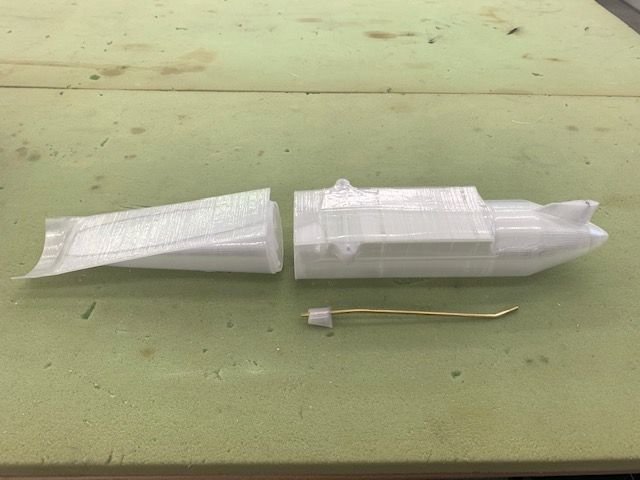

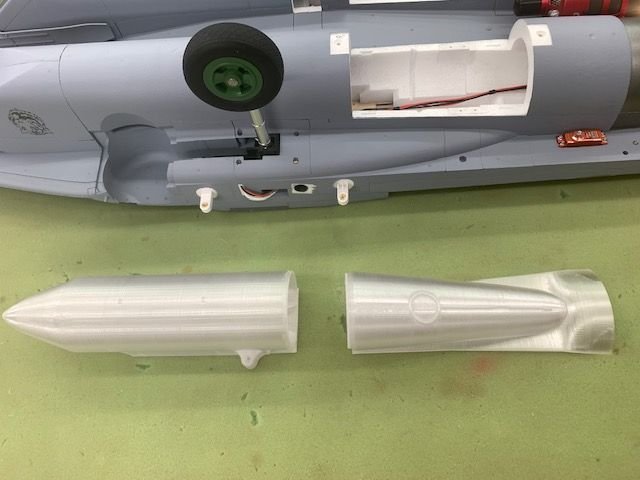

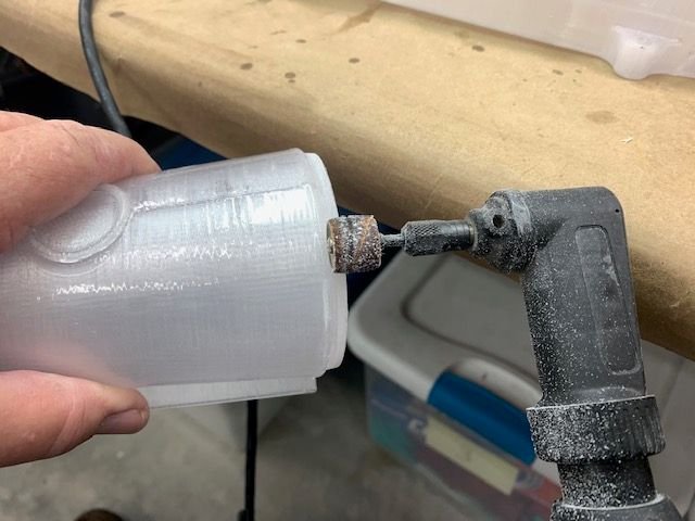

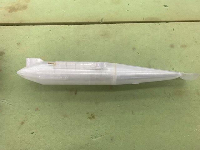

The 3D printed semi scale external fuel tank is the heart of this turbine conversion and is what made it so easy since there was very little foam carving needed to fit in the fuel near the CG. This was my first time to do an external tank so I basically followed Keith's lead and advice.
The tank comes out of the printer in 5 pieces. Front, rear, 2 baffles, and a fuel tube holder (not shown here). The tank is printed out of clear PETG filament which Keith says is fuel proof. It is later sealed with a coat of epoxy resin inside and out.
The rear section has a flat front face that forms the rear wall of the tank when the rear section is joined to the front section. The rear section is hollow and is the FOD shield for the turbine. Only the front section holds fuel. We estimate it holds 40oz of fuel. With the 14oz header tank inside the fuse the total fuel capacity is about 54oz plus air trap fuel.
The rear section plugs into the front section with about a 3mm overlap and forms the back of the tank
The two baffles are indexed on small tabs inside the front section
This shows baffles tacked in position with CA

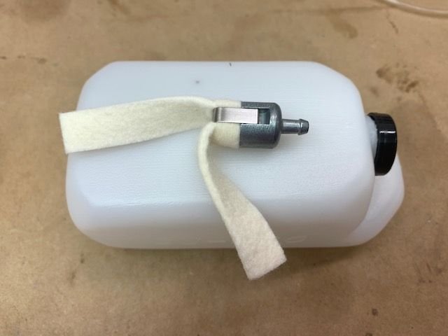

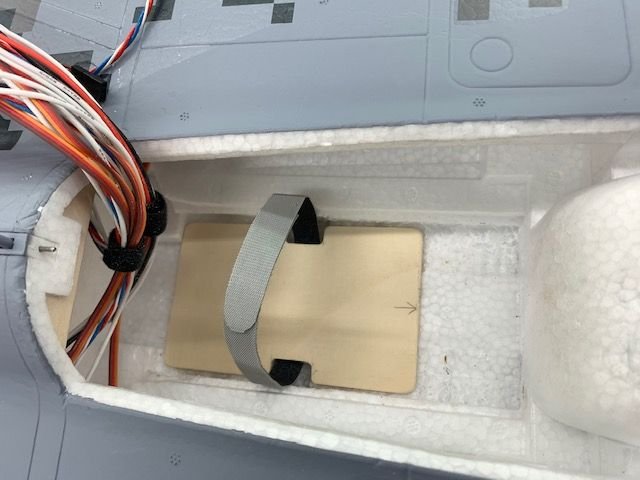

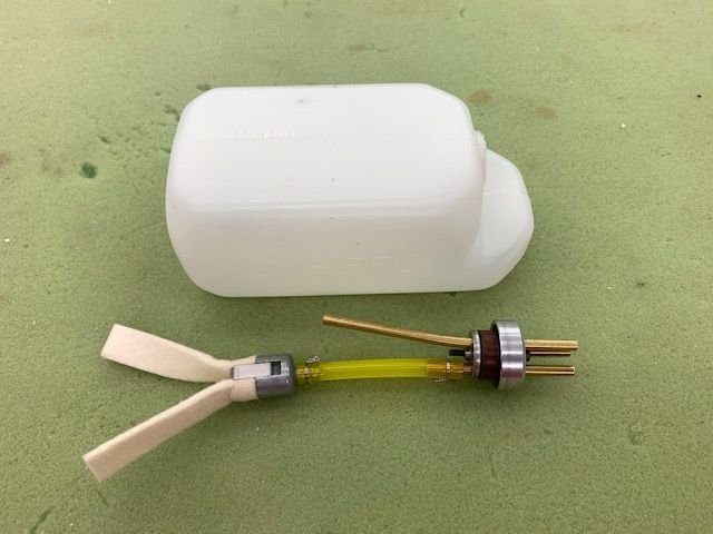

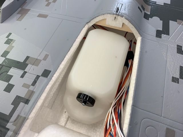

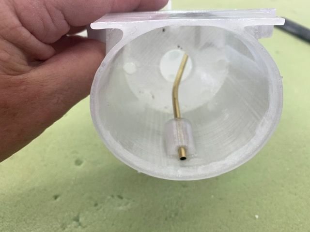

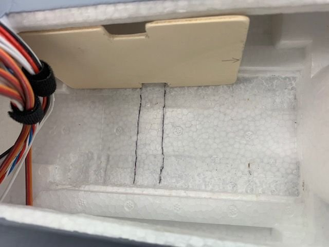

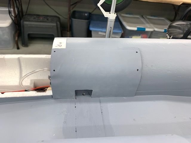

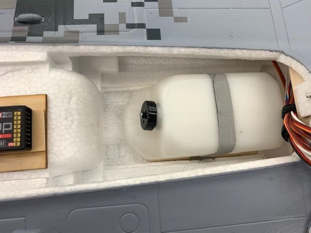

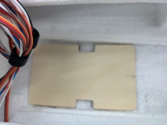

Installing header tank
Dubro 14 oz tank in rear battery compartment fits perfectly.
I removed the factory wood parts and cut out the foam to make a flat floor for the header tank
Foam removed
Header tank floor. NOTE: I did not yet have the centerline tank when I cut this piece. If you do this floor make it the full length of the compartment since the front lug of the center line tank will be mounted to this wood piece. I had to extend mine later.
Area for foam removal for tank hold down strap. Make the wood extend all the way to the front of the compartment for later centerline tank mounting.
Foam removal
Thin Velcro strap in
Tank in
Winged felt clunk part number from DDM Racing Davesmotorsports.com if you want to use one
WInged felt clunk
Tank build. I forgot I only needed two brass tubes and later removed the third tube.

Turbine mount touch up paint
Tamiya X-10 Gun Metal matches the dark silver in front of the AB nozzles for the turbine mounts

Tank parts
1/4" plywood used for main tank mount into foam. Plywood needs to extend inside the EDF ducts for later reinforcement
Plywood mount and tank in the NACA cheater holes. Tank lugs are against the aft edge of the NACA hole
Foam removed down to bottom of fuse on each side
Lines for foam removal for plywood mount
1/4" foam removed making the plywood flush with the fuse bottom
Dry fit plywood in slot
Holes drilled to fit tank mounting lugs and 6-32 blind nuts installed, CA glued, and taped over to prevent glue from fouling the threads. E6000 will be used to glue in tank mounts later
6-32 bolt with rubber sealing washer to hold against plastic mounting lug
From inside the duct. The plywood extending inside the duct is for reinforcement against the foam since this is the main part holding on the tank under G loads
Rear tank part dry fit to ensure everything is correct.

Front tank lug mount
Tap front lug hole for 6-32 bolt
1/4" ply front mount bolted to tank lug
Plywood outline traced on foam fuse bottom
Area of foam removal
Remove foam from under header tank floor. This is where I learned I should have made the tank floor cover the entire front compartment.
Ply wood tank mount rounded to fit foam shape behind nose gear doors. I did not work too hard here since it on the bottom and out of site
Header tank floor extended, drilled, and counter sunk for a 6-32 flat head bolt
Header tank fits over bolt
Front and rear tank mounts glued in with E6000, weighted, and let dry overnight
Internal plywood braces cut from 1/8" plywood
Brackets installed on inside of each duct. Epoxy is used on the wood to wood contact areas and E6000 is used on the wood to foam contact areas. This to help spread the load over the foam holding the tank on the jet during G loads

Rear tank mounts and turbine air inlet holes
Rear tank section is taped in place on front tank section and then the FOD cover lines are traced on the foam
FOD cover lines traced on foam
Turbine air inlet cut lines marked just below the FOD cover lines
Turbine air inlet holes cut by removing foam from the EDF hatches
Turbine inlet holes
FOD shield mounting tab location marked on foam just below the FOD cover line. Slot cut with hot wire as before for 1/8" ply mounting tabs
Mounting tabs installed and drilled
View from the rear
Rear section of tank FOD cover secured with servo screws. Now the front section of the tank and the rear section of the tank can be glued together and held in alignment with the front mounting bolts and rear screws while epoxy is curing....but not yet!

Sealing, installing fuel tubes, joining, and painting the tank
The inside and outside is sealed with a coat of epoxy. We used West Systems 106 with 206 hardener. I mixed 60 grams and it did the whole job. First prepare a place where the epoxy can drain out when pored in the front tank. Next prepare a hanger system that will allow parts to drain and cure with out touching. I used a coat hanger wire on the front part and the mounting holes in the FOD shield on the rear part. Keith used a screw in the front lug. Pour enough epoxy in the front section and roll it around to coat all the inside surfaces. The epoxy will secure the baffles to the sides. Allow the epoxy to drain out and then brush a coat on the outside of all surfaces on both front and rear sections. NOTE: This step must be done before the fuel tubes are installed.
After the epoxy is cured the hardened drips are ground off the front and rear sections for a good joint
Rear section cleaned up.

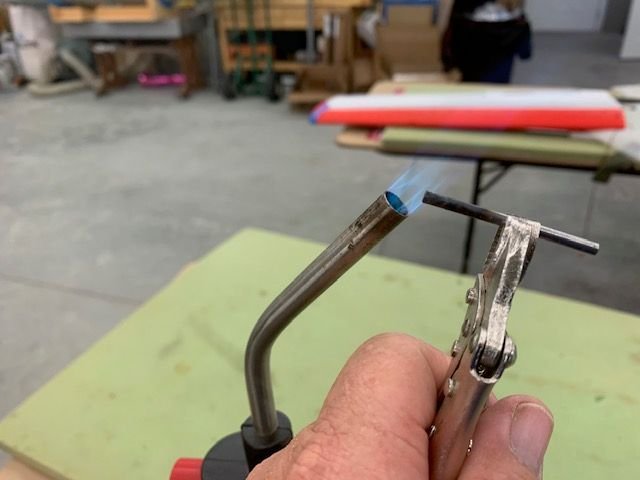

Next the 5/32" brass pickup tube hole is drilled aiming at the center of the rear baffle.
The drill passes through the front baffle and the tube is pushed in through the center of the rear baffle
The brass pickup tube is bent to fit prior to tack gluing in with CA. The fuel tube holder is shown here.
Fuel pick up tube is tacked in with CA at the front hole and is NOT glued to the holder. Only the holder is glued to the bottom of the tank. This allows the tube to expand and contract and flex inside the tank and not stress the glue joints.
Vent tube drilled and installed on left side here. After tacking in with CA and getting proper alignment the tubes and tubing holder are glued in with SIX10 epoxy. The tube holder is also epoxied to the bottom of the tank. NOTE: the tube is not glued into the holder, only the holder glued to the tank bottom so that the tube can flex in the holder. On my jet I chose to put the pickup on the right and vent on the left.
Next a piece of plastic is laid across the fuse bottom where he tank joint is. Then SIX10 epoxy is applied to the front and rear sections and they are pressed together. Squeeze out is cleaned off and then I taped the tank parts together. Then the tank is transferred to the fuse mounts and screwed down. This photo shows the tape removed and the tank is screwed to the mounts and ready to cure.
It is critical not to get epoxy in the fuel pick up tube. I had it about 1/2" ahead of the joint line.
Tank removed when epoxy cured. An under water leak check should be done and any pin holes fixed. I had no leaks. I rough sanded the tank with 220 wet sandpaper.
I brushed on a thick coat of 2K auto primer and let it cure
Next was a wet sanding with 220 paper. I kept telling my self " its on the bottom out of sight" so I didn't go overboard with finishing
Next I brushed on 2 coats of KlassKote satin white epoxy paint and let it cure overnight
I free handed the grey and black paint on the rear section
Good enough, Its on the bottom!
All done it was 14.1 oz and came out much better than I expected. I was happy with the results.

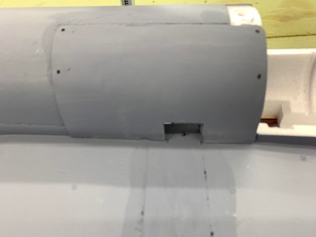

Making fiberglass NACA hole FOD covers

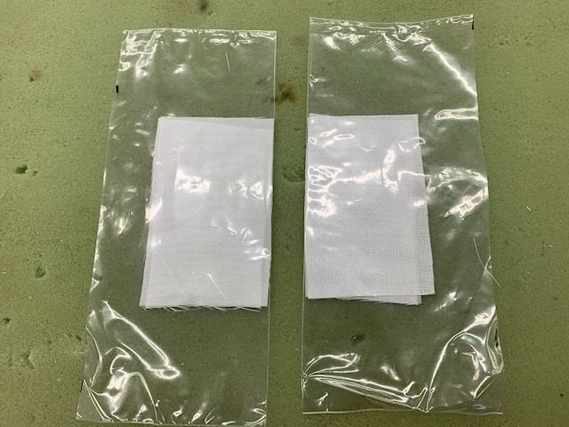

2 layers of 3 oz cloth placed into two cut off 1 gal zip lock freezer bags like envelopes

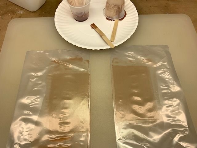

Epoxy resin poured in on glass cloth and excess resin squeegeed out
Freezer bags taped on engine necelles to cure
Cured parts cut to size and corner holes drilled over NACA holes. The center line tank holds the lower part of the covers in place.
Plywood squares imbedded in foam to hold screws
Covers painted and trimmed to clear tank mounting lugs
Covers installed with small screws
