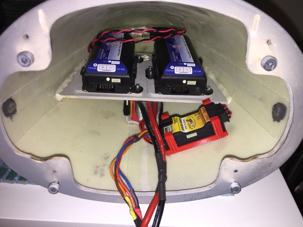

So I went through my 220RXI with ECU version 12 which also has telemetry. I am using the BMS (batt management system ) as well.
I am a bit disappointed that the battery I ordered with the turbine does not have the matching balance plug that fits into the BMS. Really?
How does jet cat expect us to find the right one when they can't supply it on the battery that plugs into to their BMS? Especially when they DID supply the two receiver batt charge leads.
Does anyone know know what plug fits the balance plug on the BMS module?
Dave

Dave
JetCat (Germany) don’t supply batteries with any of their turbines as they can’t ship them anymore. When they could, the battery matched with EH balance plug that was pretty std in Germany, companies like Graupner used EH on all their batteries and Chargers.
All batteries I get in the U.K. now are JST-XH so I provide an adaptor lead from XH to EH if people go that way.
Dave

This is what you need: https://www.der-schweighofer.at/Sens...-65-cm-a210599
Tassos

thanks !
Where did you get the BMS mount (red)?

i looked all over and i ended up using regular 2.54 mm spaced connectors.... basically servo connectors. i get the insulators in 1, 2, 3 and 4 positions.
