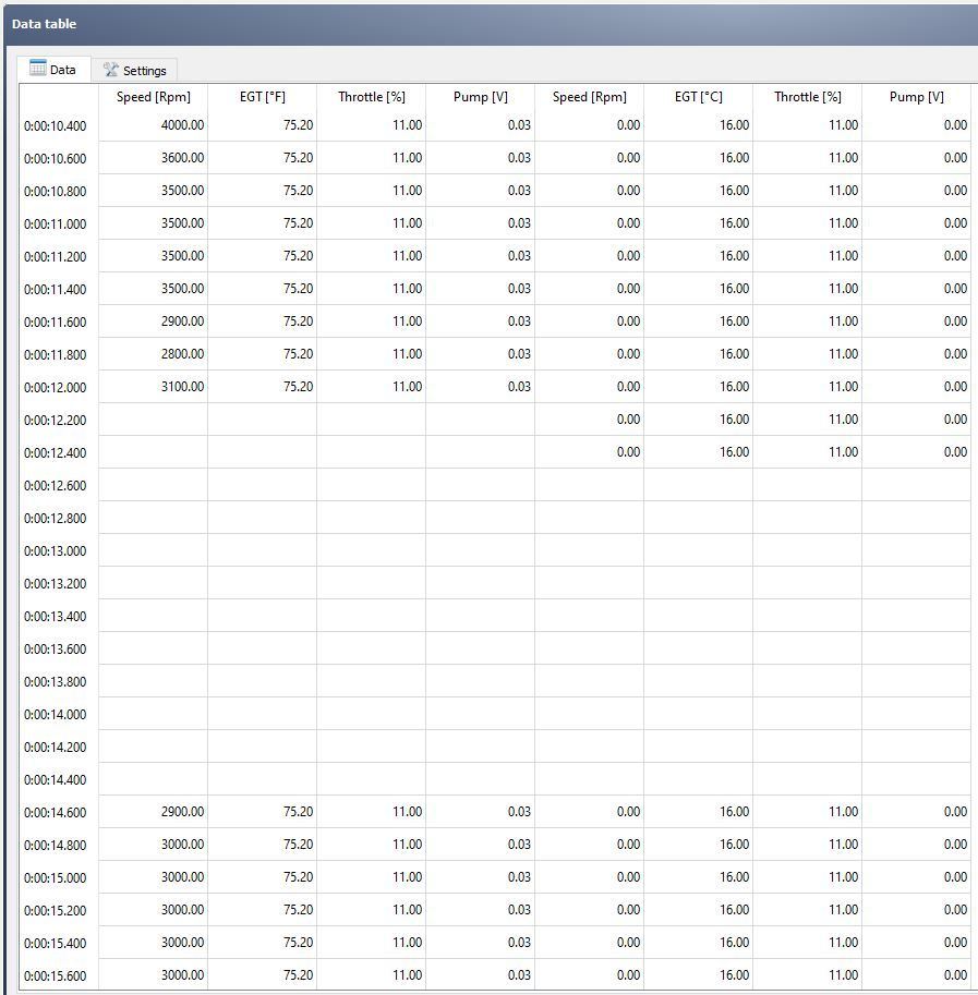

Short time telemetry signal drop-outs, which are quite likely, will show the same thing. If the pump stops then the engine will flame out, so multiple pump stops is not possible unless you have the auto restart enabled. Check the other engine telemetry items, at the times when it shows no pump volts does it still show sensible rpm, temp, main battery volts, or do those also show zero or some silly number?

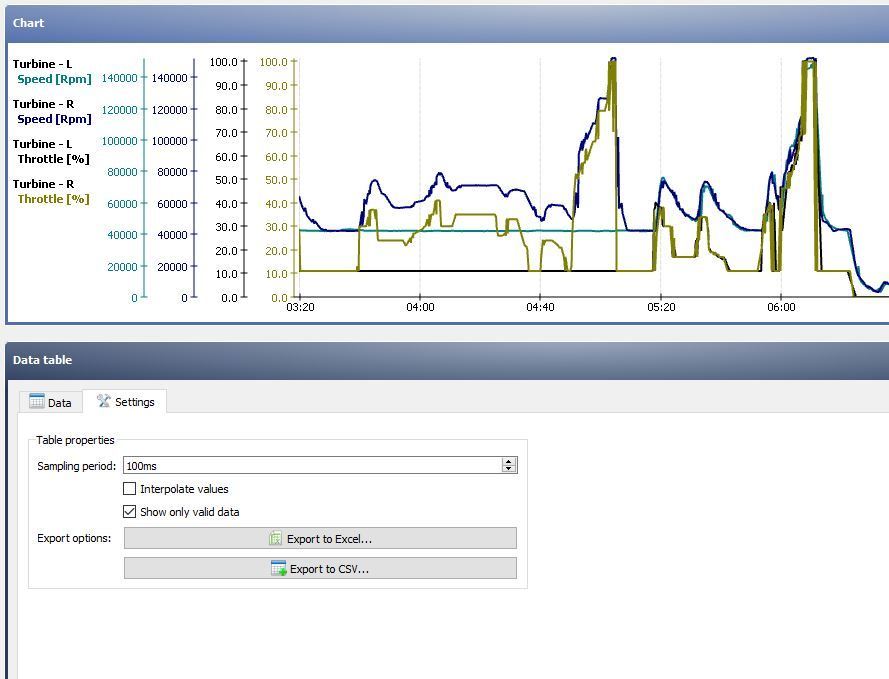

Download the Jeti log into Jeti Studio. Open up a Data Table and import the Turbine parameters. Go to the 'Settings' tab in the Data Table window and select 'Show only valid data'. By default, Jeti Studio holds the last value if there is no data.
That will allow you to see any data drop. Export the data to Excel to have more flexibility in looking at the data.
I'm in discussion with Gaspar about cyclic data drops that I've seen on my twin Merlin 100 model. Two telemetry adapters connected to two separate ports on a CB400. Gaspar's theory is a timing issue between the two adapters data arrival, and to try connecting them both via a Jeti telemetry expander module.

Here is the log showing the pump voltage dropping. If the pump stops for a fraction of a second the turbine may continue to run. It did that twice where the throttle was at 100%. The final drop had the throttle at 60%.
