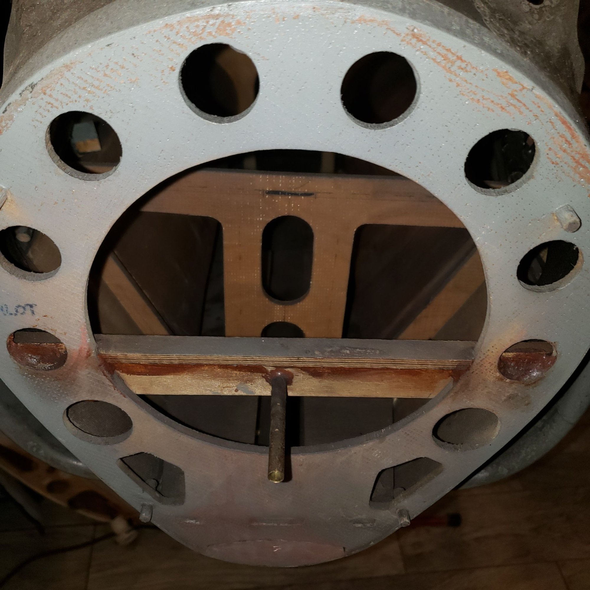

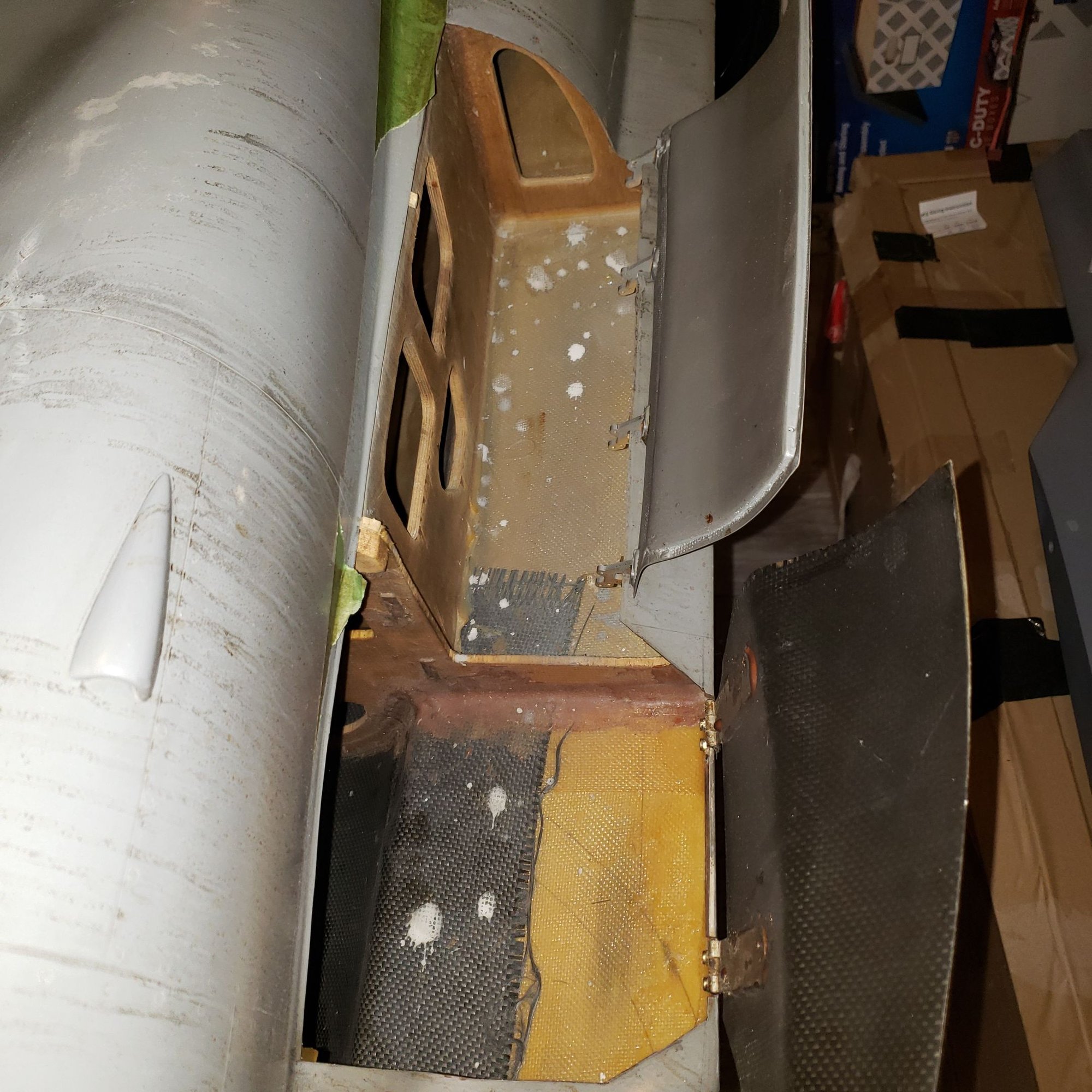

505 has served us well. Now has come the time she will share her soul for the better good of MAC's 6's.

Rather than fight through time consuming reverse engineering this 33 year old "Flight Of The Intruder" movie 6 to duplicate the windshield and side cutouts we decided to use the original windshield to create an overlay template for routing. This will assure clear panels fit each individual cutout without time consuming adjustment by either MAC or its customers.

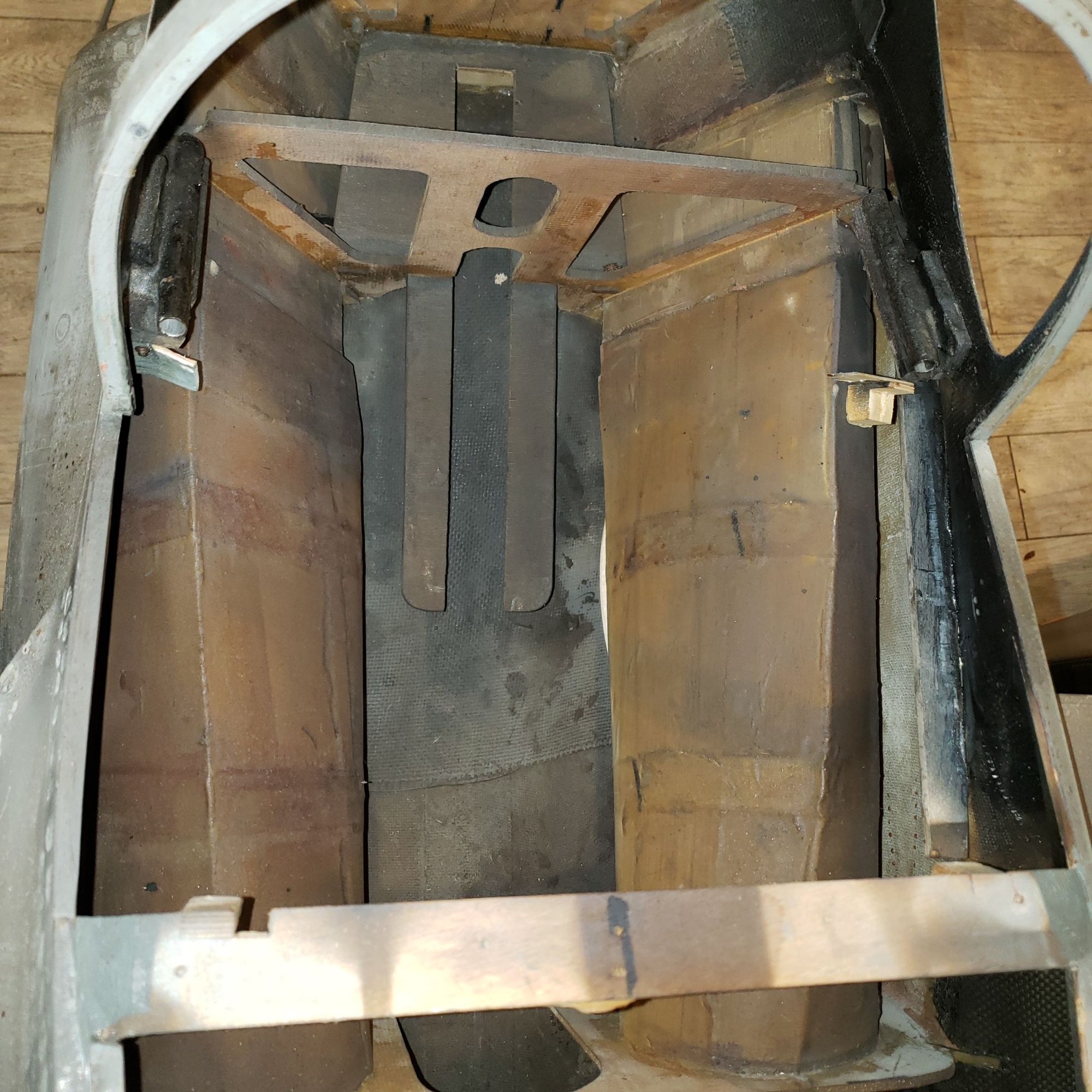

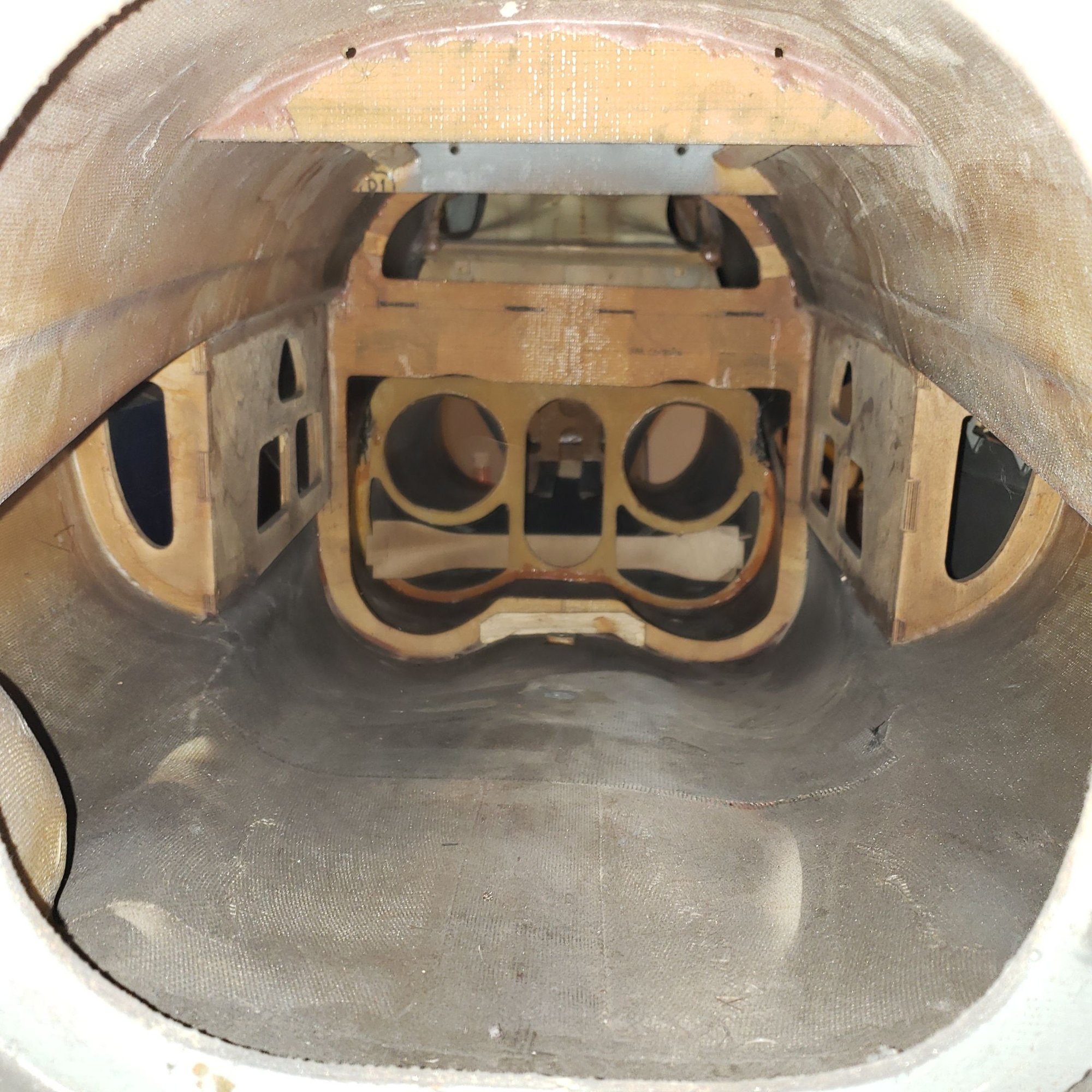

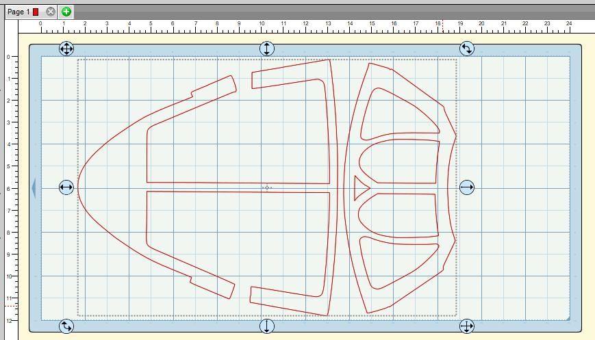

Sam said the Epilog laser is working great. Below is the pilot side of the cockpit tub wall. Sam needs to turn off his Iphone's autofocus...:^)

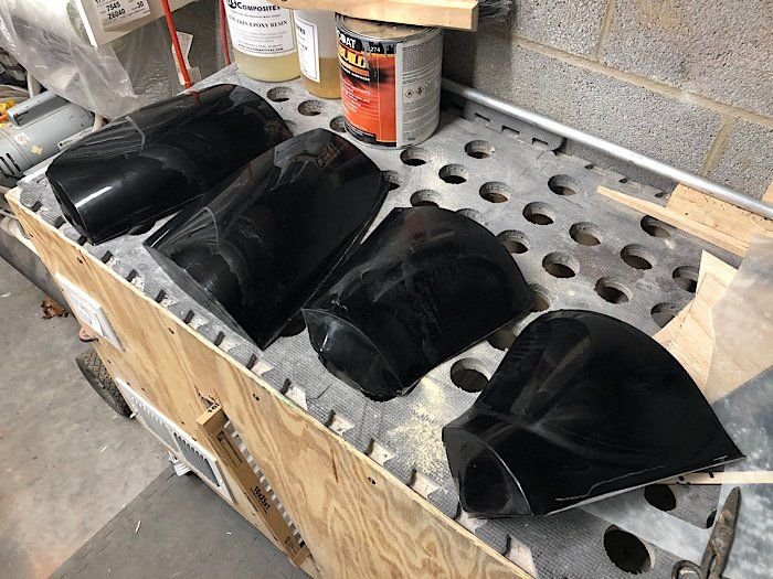

Windshield canopy mask was removed from the movie A6 fuselage. Next, the large main canopy sections.

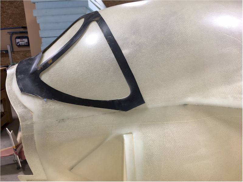

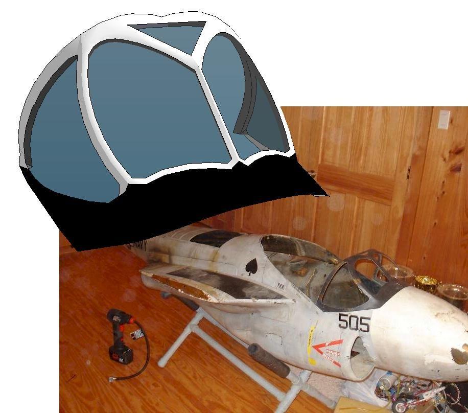

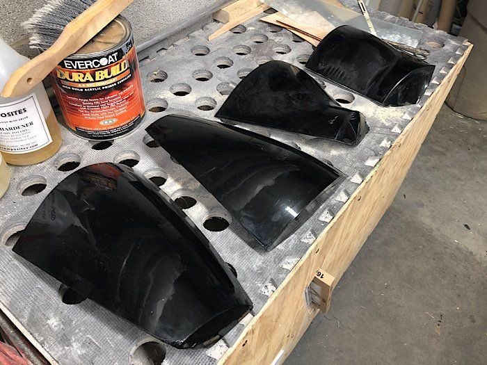

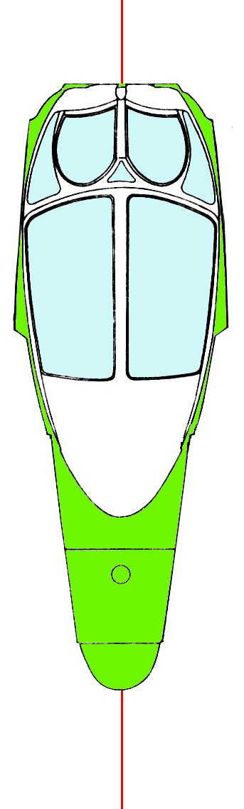

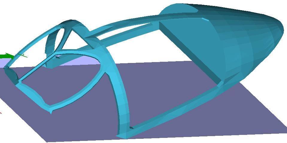

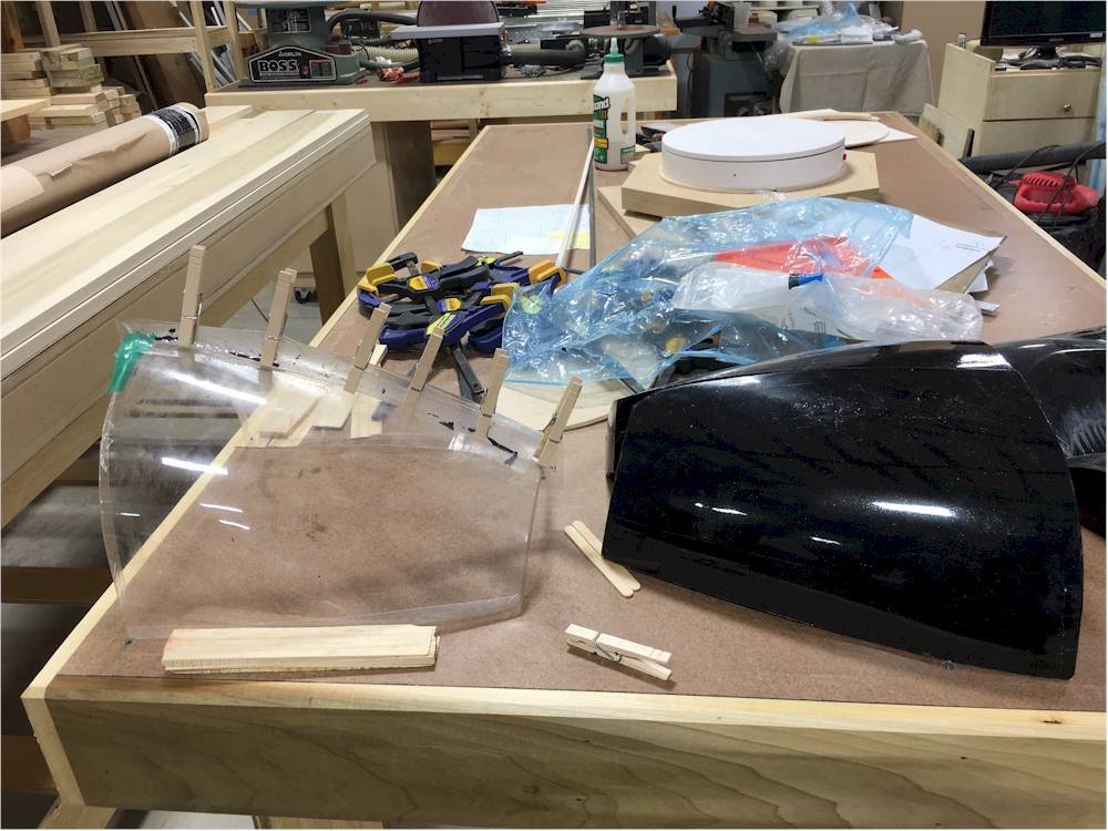

The most challenging portion of this entire project...
A cap template is created to cover the entire canopy/windshield portion of the fuse to enable routing the glass openings.
#157
Hi Ron,
There is a canopy "cap" being created as I write this. The cap is oversize (larger and three times thicker) than the actual windshield and overhead canopy frames by atleast an inch all around the perimeter of the canopy section of the fuselage. This permits accurate centerline alignment/centering of canopy frame cutouts. We were originally going to let customers cut their frames but thought it best to enhance our value by reducing the task to Hysoling the clear sections in place... ;^)
We already have all seven clear canopy molds and two (2) sets of clear. One set is the original "Flight Of The Intruder" #505 clear canopy sections. They are being used to assure alignment.and fitting of an accurate canopy and windshield frame.

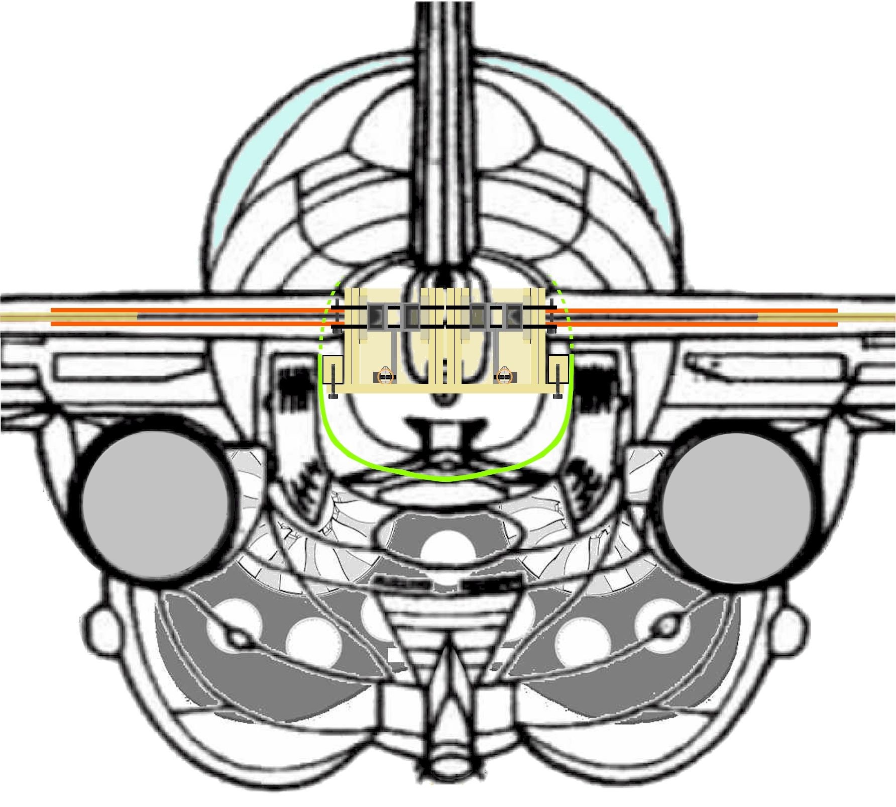

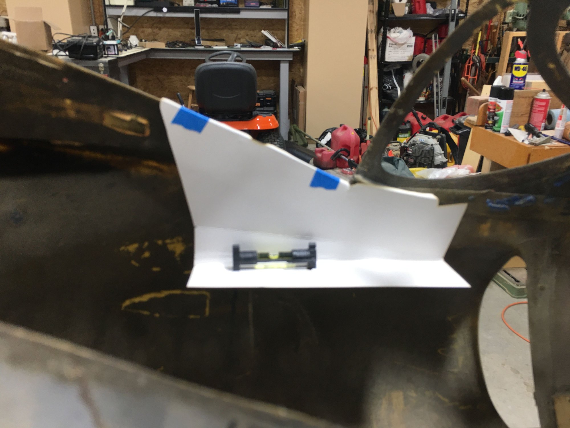

Below is the dial-in allowance for movement in or out to accommodate proper door clearance. I reduced main tire diameter by 1/2 inch to reduce the consequence of offset angle. Mains sit 90 degrees to the ground. Scale tire diameter @ 1:5.5 is somewhere betweeen 4 1/2" and 5". Smooth aluminum center wheels look like they will accomodate our brake decision with no issue. All this is of course a first blush guess.
We have graduated from designing to fit and fitting within what for all purposes is the same as 3D chess or checkers. Layers: landing gear rails...EDF rails...inlet and exhaust. Layers are offset laterally as well as vertically.
We are getting there...............somewhere ;^)

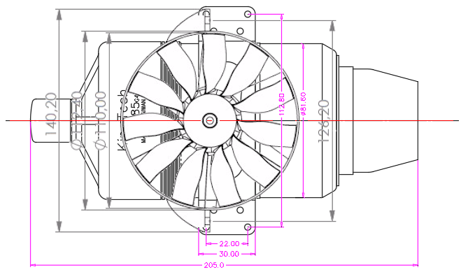

Looking for opinions from both EDF and Turbine pilots.
My A6 has two 110mm JetFan with FSA exceeding 105% per. According to multiple evaluations each fan is pushing 19.5# static @ 87% FSA exhaust on 12S in my config. As ineffecient as recip ducted fans were back-in-the-day the typical power to weight ratio is 1.623# of model per pound of static thrust, which unloads X% in air. My 6's target weight is 41#~44#.
Based on weight of my flying drumstick what turbine would be recommended for prototypical flight... Remember this is an attack/aka bomber typically flown low and much slower than fighters. Typical mission was as the ultimate Wild Weasel/ECM platform.
Thanks in advance...

The "41# - 44#" seems to always magically increase, 120 or even the new Kingtech 130G4 which is lighter than the 120 for some added grunt to help carry it on up through the verticals and better on grass.
You can always throttle back.

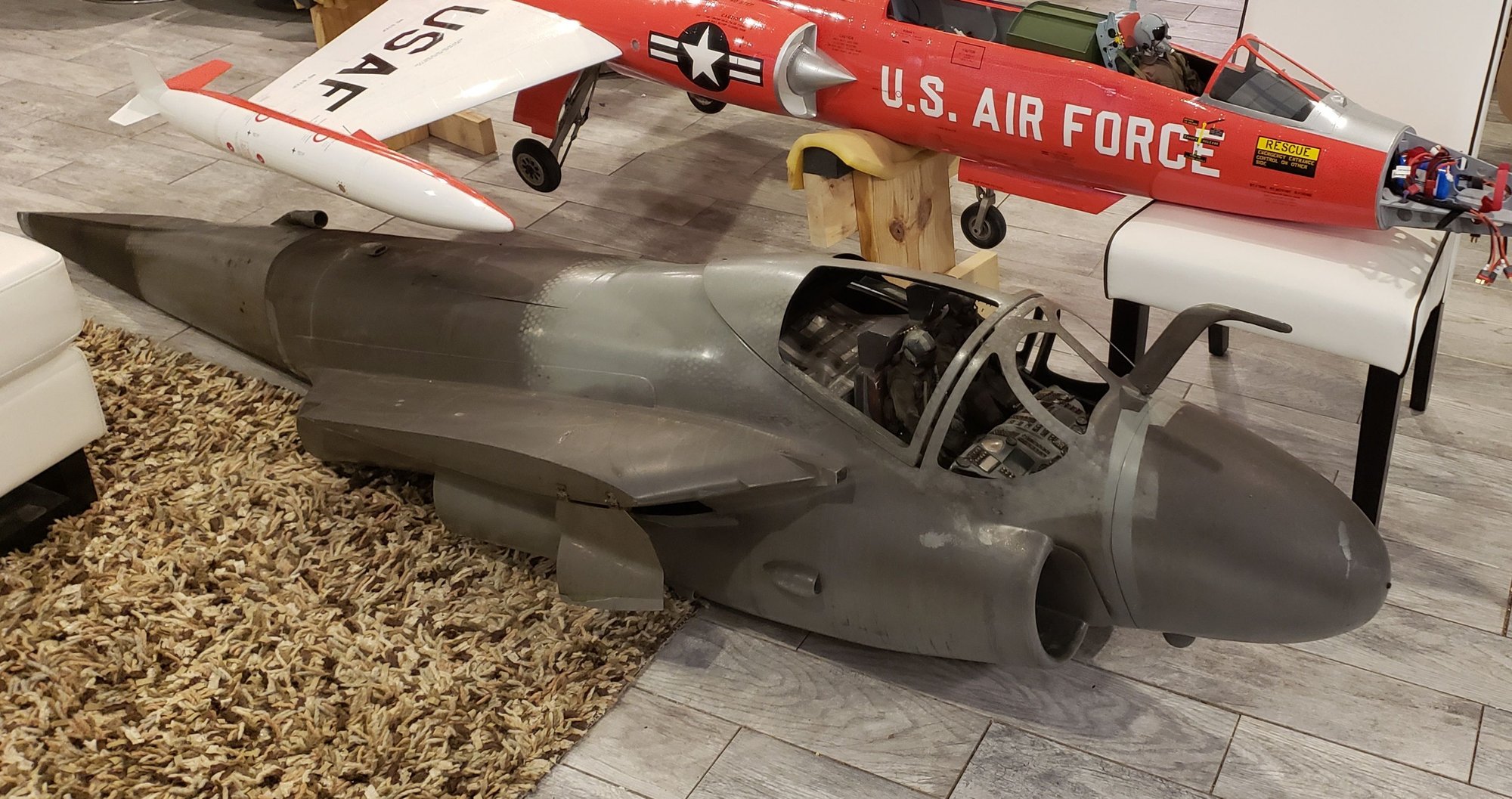

Readers have probably not read this nor other online threads from the beginning to know my A6 weighs 1/4 that of the original movie model powered by a pair of ByroJet 91 recip without intake ducting.
The ByroJets generated what was "claimed to be" around 10# each. This is the same config Byron used in their F-15. Each JetFan 110Pro generates a "consistent" 19.5# static thrust with a 105% FSA intake and 86%~87% exhaust outlet. My 41#~44# AUW estimate is on the high side...not low.
Based on the above...my inquiry is directed to current owners/pilots of a turbine powered Grumman F9F Cougar/Panther of comparable weight @ 85"~100" w/s.

My A6 fuselage weighs 1/4~1/5 (depending on which section is weighed) of the empty (16#) movie model "fuselage"...We have begun utilizing Airex in the layup. The original "flying" recip ducted fan powered movie model weighed 35#~45# sans landing gear.
The "empty" movie model weighed:
2 Wings @ 10#, Fuse & Stabs @ 19#, Vert. Fin & Rudder @ 2#: 31# Empty (Nothing) & Dry. By comparison Airex/glass infused rear half of our fuselage weighs 22.4 ounces compared to Vic's layup @ 36.6 ounces. This layup includes the vertical fin and rudder. Original movie 6's had built-up and attached balsa and ply vertical fin and rudder...not molded in fuselage.
