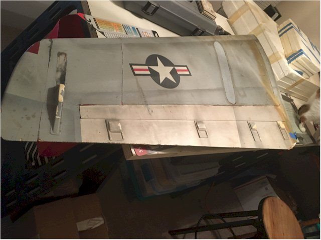

We developed a new four piece mold to correct geometry issues of the original DCU fuselage...symmetry of the original was horrible. Developed a removable scale cockpit tub replacing 90% of the inaccurate vacuum form parts with an accurate resin molded scale cockpit. Created electric sport scale gear and reduced the weight of original scale gear by 60%.
Additional scale elements were developed; removable flying stab module, articulated tailhook, fiberglass weapons rails with releases, and articulated Mk-82 Snake Eye retarded iron bombs. There are components available to assemble four versions of the A6.
Looks like your 6 was exposed to the elements a bit. Was the Byron wing attachment used? Where did you get your DCU 6...from Mark? There were eight (8) pulled from the original mold. JetMart in Atlanta ended up with everything then sold all to a Pacific Rim customer.

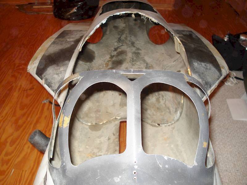

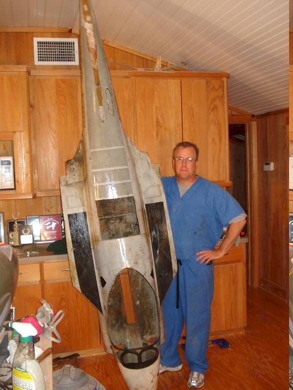

Not sure where it originated from but have a bunch of misc parts with it.

DCU's A6's did not come with anything but vacuum forming, ten foot long one piece fuse and foam wing core, vertical fin and stab, nothing more... There were two movie 6's with retracts made by Matrix Machine at the tune of 14# each.
My movie A6 was gifted to me by fellow Bomber Field member, Barry Raborn. Barry had been gifted it from the owner of the Houston special effects company contracted to the John Millis film "The Flight Of The Intruder". It had been horribly damaged in a hurricane that came ashore in Kema, TX. (See pix below).
I bought an unassembled 33 year old DCU pull in Florida after I literally stumbled into it listed in an estate sale. In addition to the five 1:5.5 A6 for the movie, DCU pulled eight fuselages from the molds to sell.

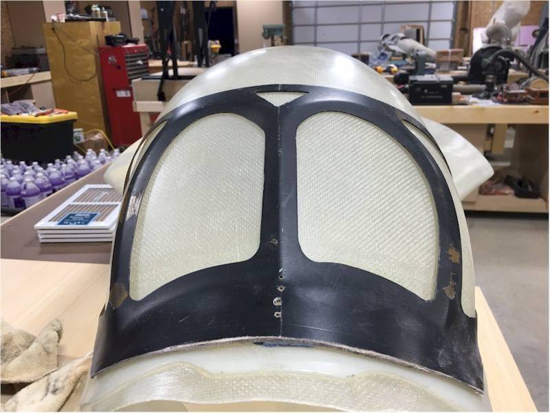

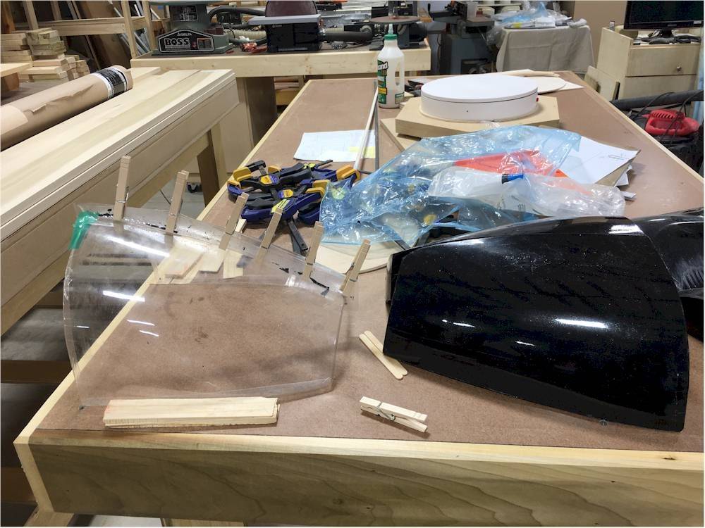

Nick, we have plugs created from the original clear canopy parts of the "Flight Of The Intruder" movie A6 to pull with our new vacuum former. Do you need clear canopy parts or did they survive whatever your fuselage went through?
I suspect the fuselage you have may have been one of two static models made with Matrix gear. Its internal structure is completely different from those flown in the movie. Damage looks like it went through the same Kemah, TX hurricane as ours.

Sure, I will take a couple of canopys, are they ready to ship? How much? I can send paypal just let me know thanks.

We will be pulling clear parts in the future. Do you want a full set (6). All clear parts are individual items. It would be good to trace all your frame inside edges then cut the insides out. These should be mailed to Sam for comparison of size and shape. Remember the DCU layups were not symmetrical. We can slip your cutout tracing over the clear we already have to check the fit. Mail the cutout templates to SAM @.

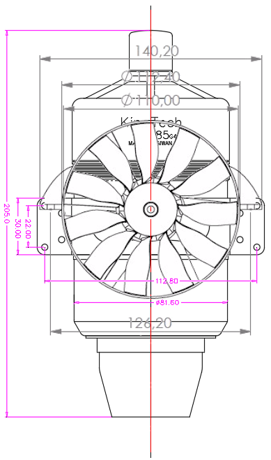

Maybe a dum question but why don’t you go and try the single turbine out the back like that German Kit Me-262? Is it for scale looks? I would think that getting the kit built as a flying prototype would be good. I’m sure this has been discussed earlier
Old 06-23-2022, 08:36 AM
  #186
Flite-Metal
Flite-Metal's Avatar
Join Date: Jun 2020
Posts: 330
Received 12 Likes on 11 Posts
Default There are no dub questions... :^)
Interesting question... One that is easy to answer with an illustration. Our A-6 Intruders are designed for 39# or greater EDF.
There is a single turbine powered A6 configured as you suggest. I think it is in Austria. Below see how a pair of KingTech "85"
will fit in the same mounting rail foot print as the JetFan 110 Pro.

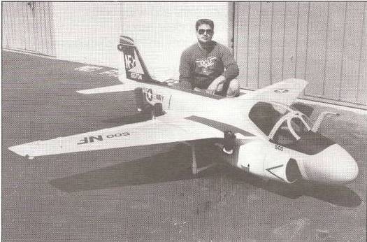

I doubt that is the Matrix landing gear that was made for static pix if needed...They did not fly. The Austrian A6 is too
small for the 1:5.5 Matrix gear. While the Matrix gear is very realistic it weighed over 14#. The one's that flew in the
movie were powered with a pair of recip ByroJet ducted fans after being thrown over bluffs/cliffs in Washington State
or launched from trucks/jeeps in the Majave.
Here is one of the movie 1:5.5 A6 Intruders.

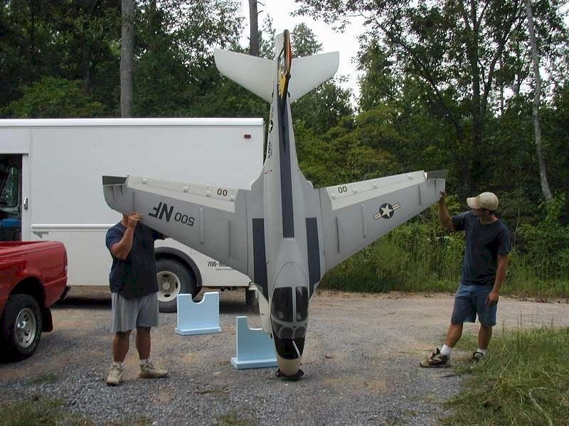

Man I love the size and have been wanting a true scale A-6 for a looooooong time. I had worked with MIBO and they have the jet done but still no landing gear.

Keith,
Unlike the ten foot long original one piece movie A6 fuselage we created a 3 piece mold...radome, center/wingroot section, and rear section just behind the exhaust. Our method of attachment makes for a strong non-slip fuselage with improved portability. Original movie fuselage weighed four times the MAC A6. Our extensive use of infused laminate foam provides regidity with huge reduction of glass and resin.
As for gear, original movie A6 gear manufactured by Matrix Machine weighed over 14#. We have worked with the two "Made In America" gear manufacturers to create an our initial gear. These have molded scale sheaths over proper scale dim retracts. A CNC milled aluminum gear will be available from Darrell at Sierra.
Airex infused laminate foam sheet (green and white) used to reduce glass, increase strength, while reducing the fuselage weight. In our case our fuselage weighs 25% of the original movie A6.

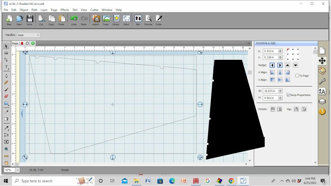

Establishing the rudder cut line:
The rudder is molded in with the balance of the rear fuselage section. This assures greater strength than sheeted foam epoxied to the fuselage as was the case with the movie 6's and eliminates vertical alignment issues. We are providing a ready to attach rudder with king post already installed. The attachment is Robart Hinge Point hinges with a music wire common axle

Removable rudder:

Nick,
Is your 6's canopy frame removable? We are about to calculate the large canopy frame openings to match the original movie 6 clear pieces. Our movie 6 had that portion of the fuselage damaged and was removed before we were given the fuse. Would you consider permitting us to borrow your large canopy section as a template guide to trace the two side openings onto one of our pulls to create a router guide template?
Ed Clayman

Ed,
Thanks for the offer, but my aft canopy section has internal structure, not easily removable without damage to the slide mechanism. I would think it should be a simple process to draw this out using all the documentation available to get an accurate outline.
NIck

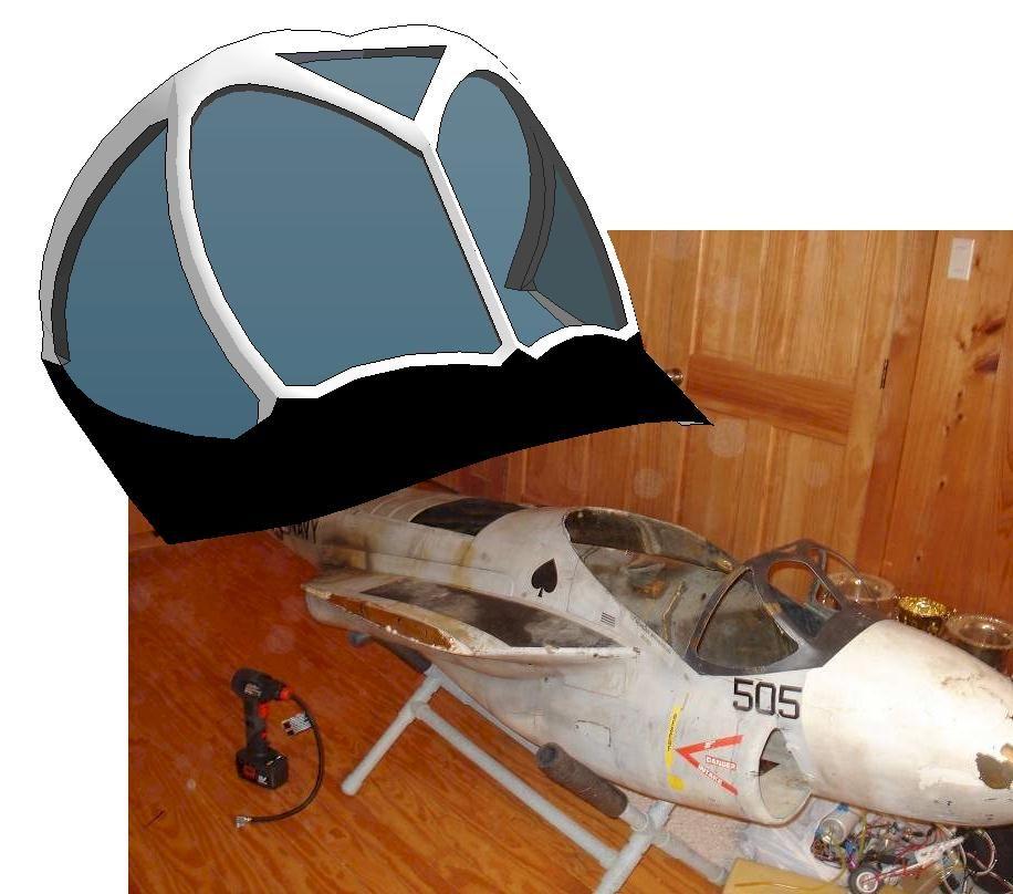

DCU did not use scale documentation when they "carved" several elements of the original movie fuselage/mold. This translates into their A6's individual clear panels are not mirrored nor were they created the correct shape and placement angle as that of the 1:1 Grumman A6 Intruder. This is masqueraded by not having obvious visual cues on this extremely large fuselage.
I have corrected multiple non-scale elements and features... Below is the correct shape and placement angle of a 1:1 Grumman A6F (Same as that of the A~F) according to CAD plots on three inch centers that Bob Kress (VP Fighter Div. of Grumman) sent me thirty years ago. I duplicated the 1:1 as left and right...the same for the windshield. If you compare drawings to your A6 fuselage the difference will be obvious, especially triangular shape / angle..
We have done a great deal of due diligence to assure accuracy and functionality of our MAC6's. Major DCU miscues have been brought to 2022 standards and customer expectations. We have had the luxury of time to do so...DCU had an extremely short turnaround allowance (typical for Hollywood). DCU did the best that could be done back-in-the-day (35 years ago).
By chance,,,did the miscellaneous parts you referenced in an earlier post include a set of aluminum retracts? The person who manufactured the retracts for "The Flight Of The Intruder" film no longer has the CNC code. It was said to be a hybrid...not compatible with today's CNC mills.
