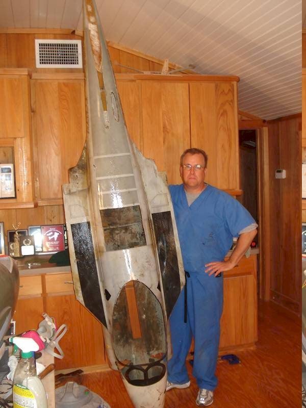

I had posted in other A6 Intruder threads, some going back to 2003, and decided it was time to create a dedicated thread on design/build of a series of 1:5.5 Grumman A6 Intruders. As you can see, we are well into this 115.3" w/s 117.6" long fuselage A6. Most, if not all of you, are familiar with the 1991 "Flight Of The Intruder" film. First things first...redesign the original one piece fuselage into a three piece for sake of easy transport and access to inside.
The FX producer of the film lives in Houston. After a hurricane decimated his FX facility in Kemah he gifted what was left of the original A6's from the movie to Barry Raborn. After realizing this was damaged beyond what he deemed repairable...while I was visiting he gifted it to me. I had an A6 project in the planning stage so this was like discovering gold...

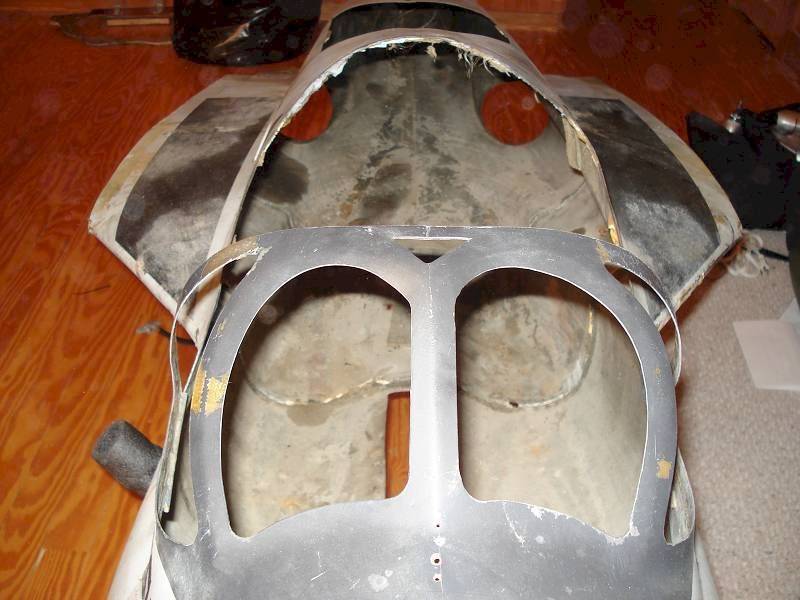

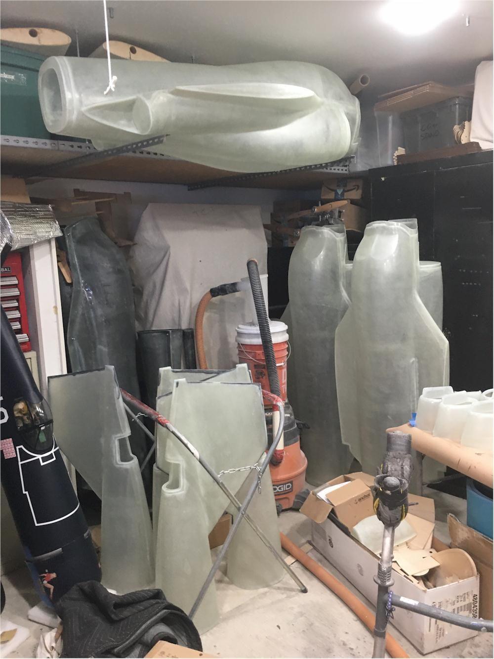

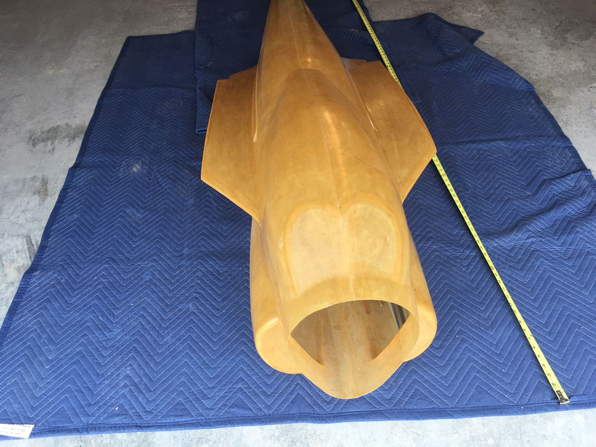

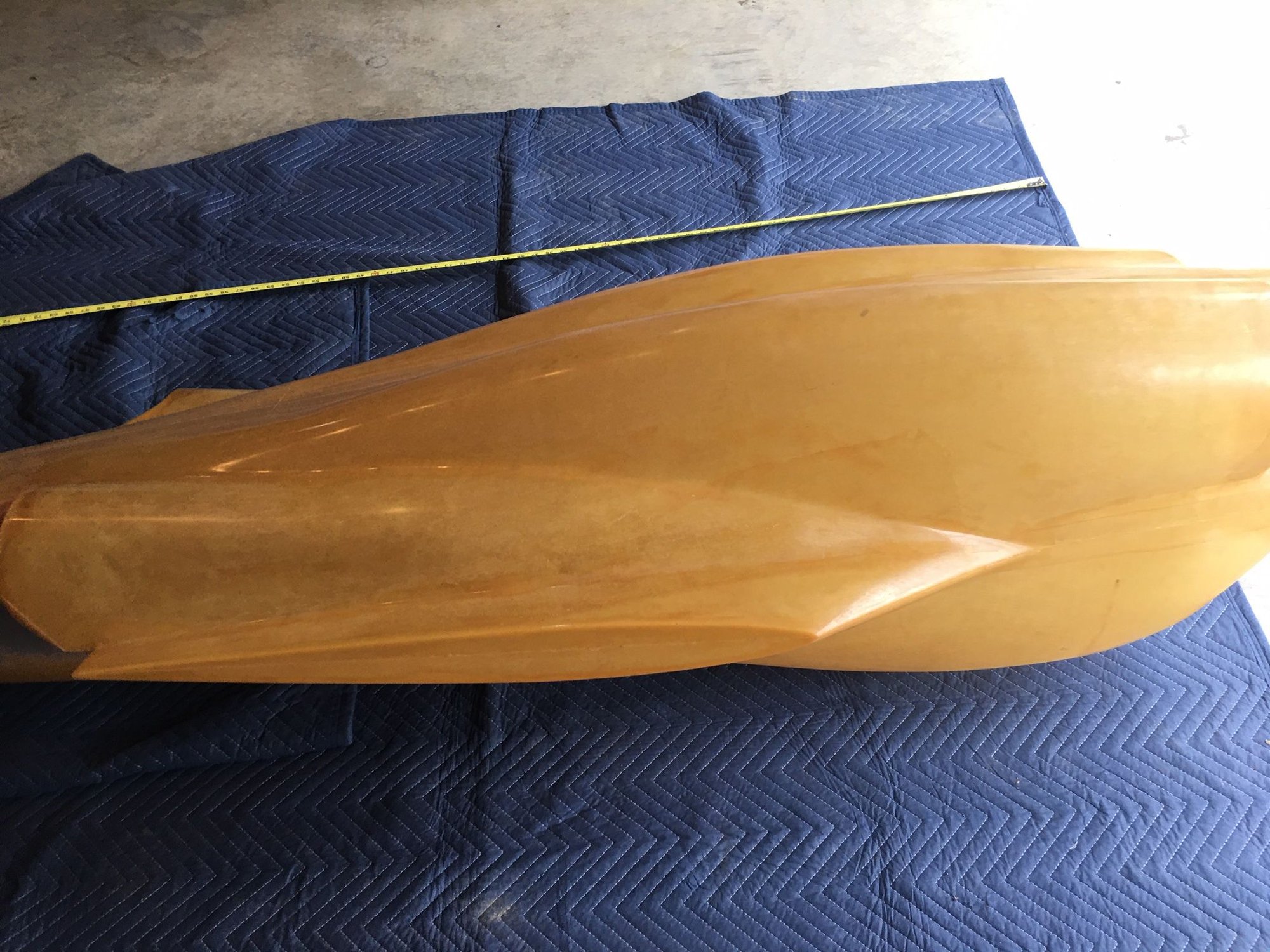

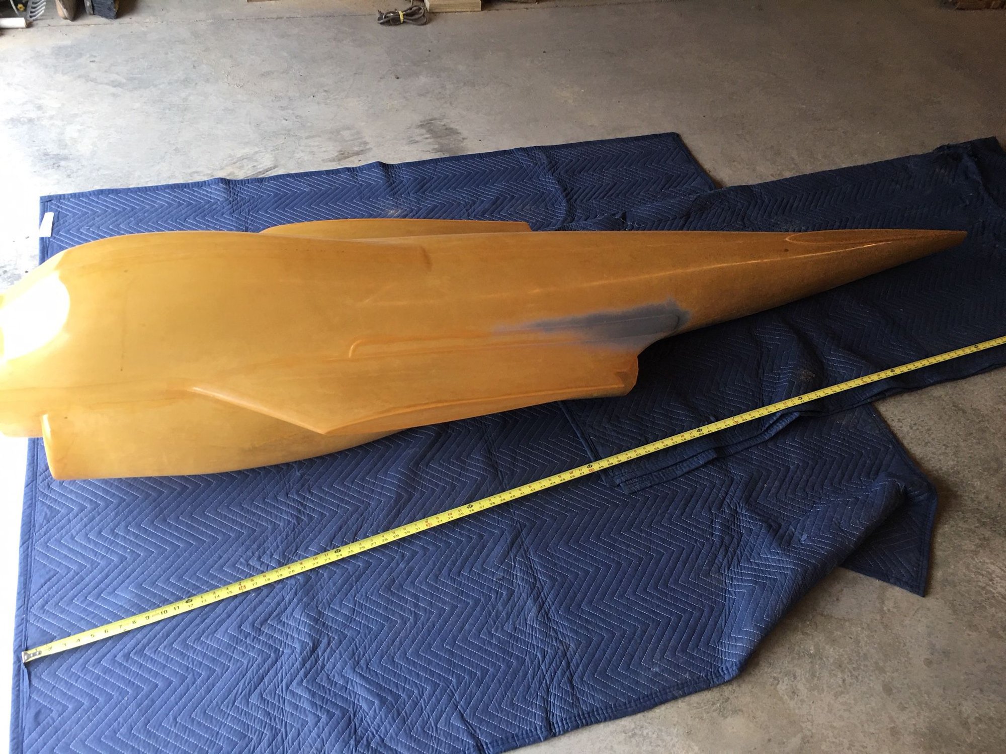

I immediately set about searching for the original movie 6 molds. I was about three months late to the party when they were sold to "someone" in the Pacific Rim...Because there were eight fuselages pulled from the original mold I set about searching for one of them. A month later I found one in Florida in an estate sale. The next day we were off to Florida to retrieve.
To some this might appear ready to roll... Not hardly. The movie models did not have scale features nor functionality. Below is the short list of the improvements made to the original.

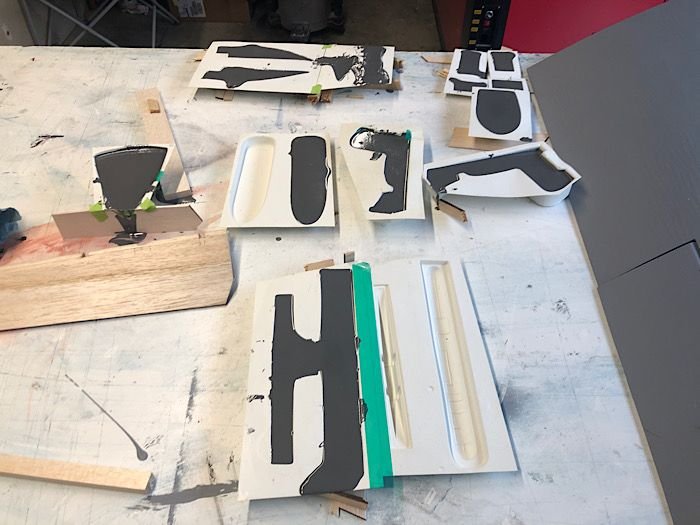

Default 3M 6303 Fine Line Polypropylene
The tape I ordered this morning arrived so its back to cutting doors.

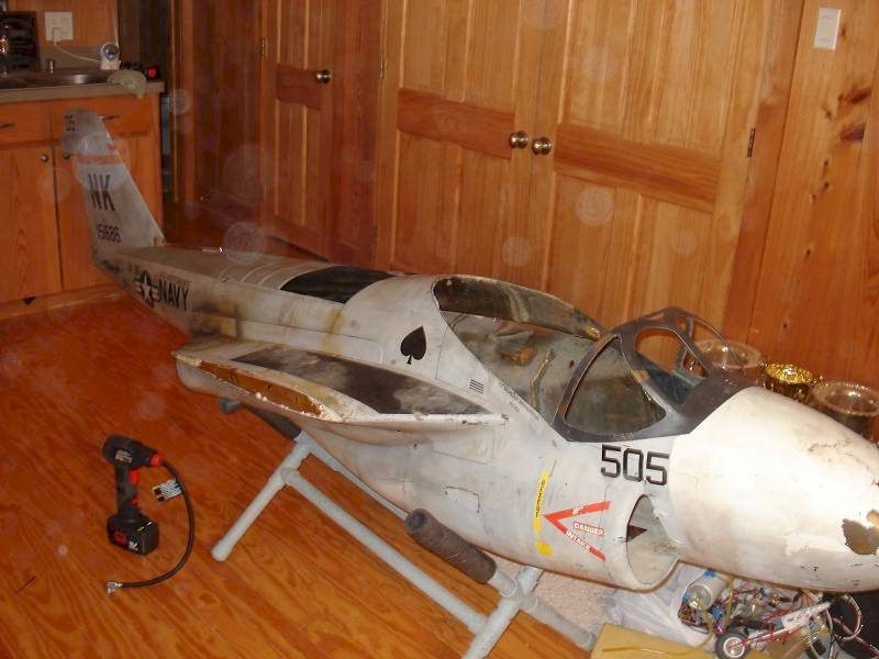

Cougar and the A6 have the same plane form will fly like a pattern plane. What are you going to do to restore the 9's surface while keeping it light?
As for rebuilding movie 6 it would be tuff considering there are no canopy frames available...and it would be a bear to scratch with its double overhang ellipse shape..

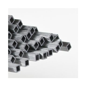

After three weeks I had not received the 6mm sq. C/F tube ordered from Hobby King... They were not going to advise availability issues...
Found a manufacturer of 1/4" square x 78" CF tube. They provide a cut down service to reduce UPS cost. Should arrive within 10 days. Small
dim square tube is not readily available as is the round. C/F in these are unidirectional and do not bend...

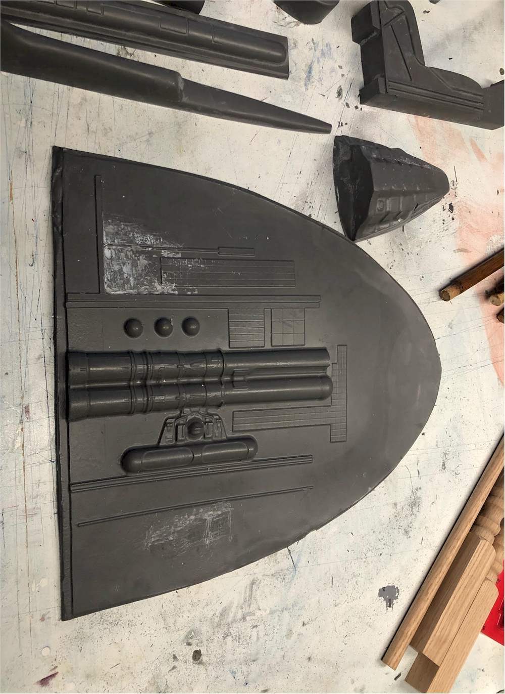

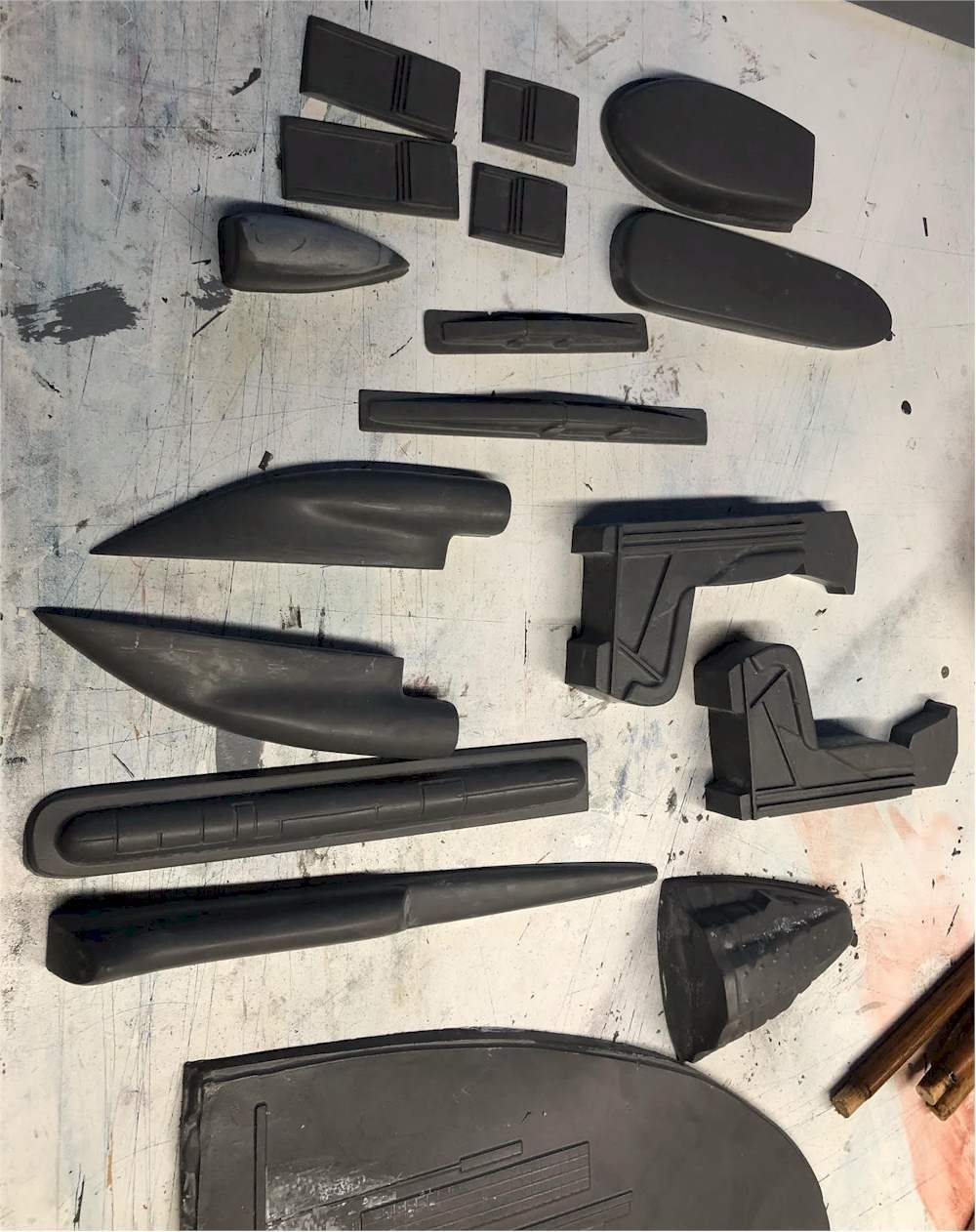

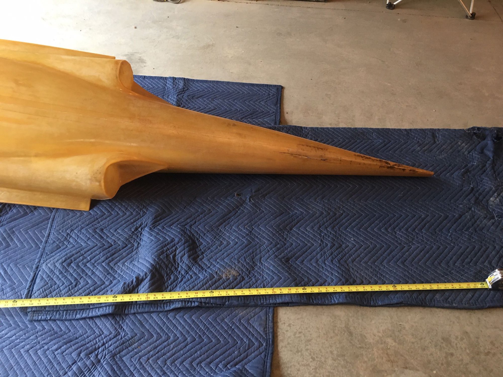

Default Replacing 30 Year Old A-6 Intruder Vacuum Forming
From this:
To This:
For proper perspective imagine the larger images multiplied 21/2 times for the actual part sizes.
Here is the hole they go into:

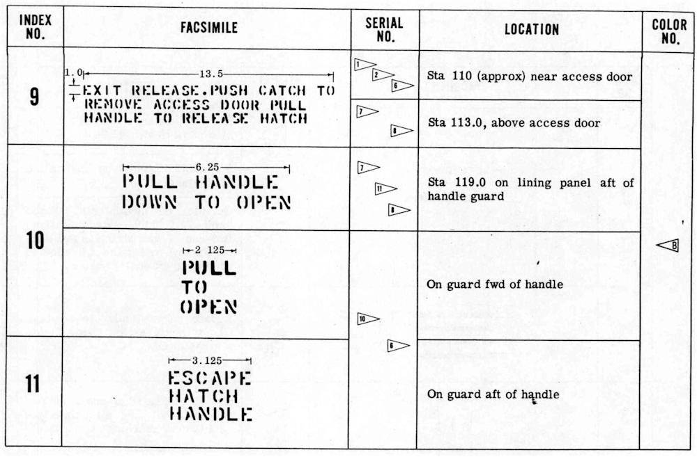

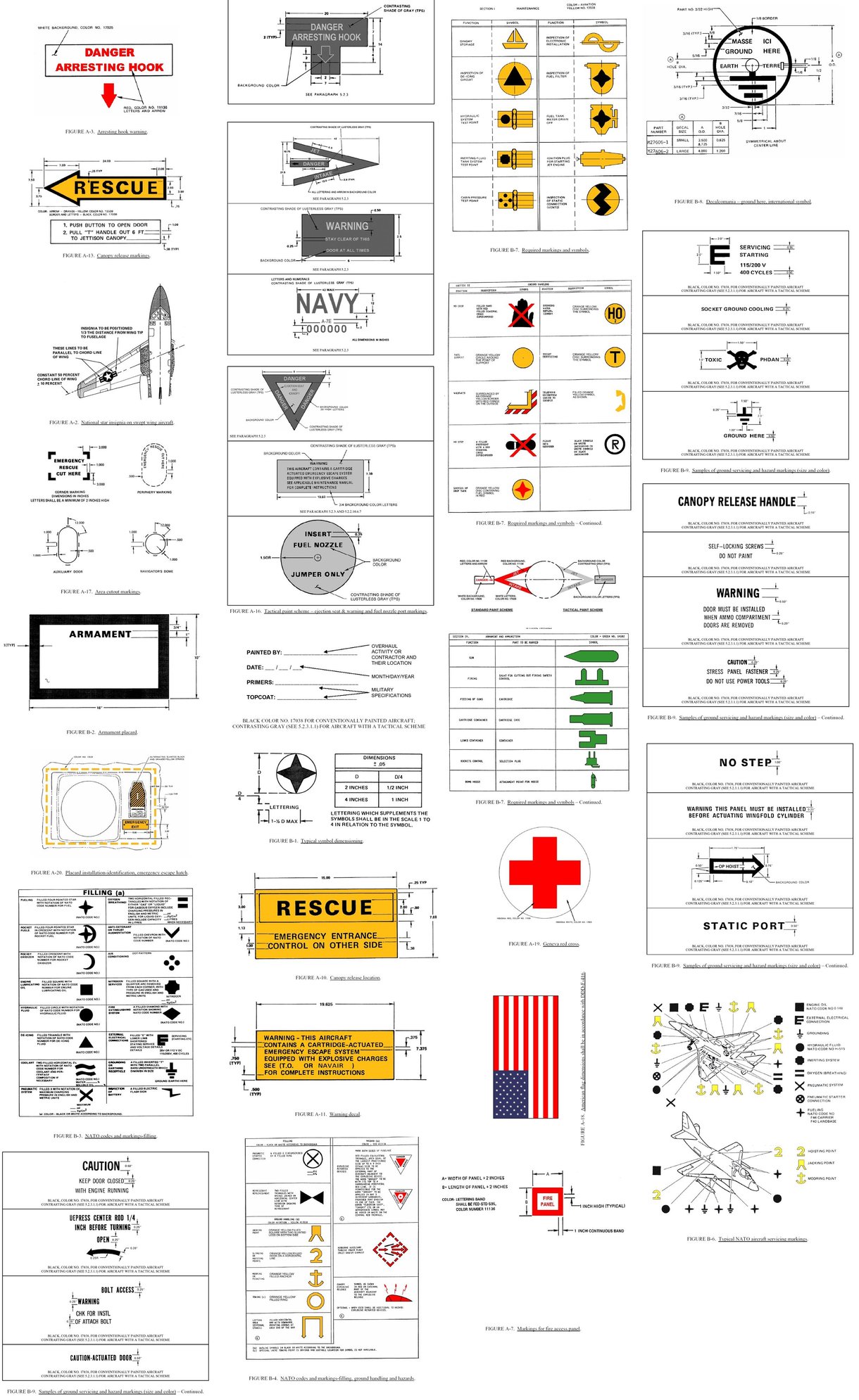

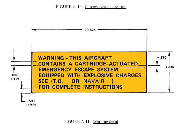

I am looking for USN placard and stenciling. Unlike the USAF the USN placarding and stencil nomenclature is virtually the same on jet and prop aircraft. I have the USN Mil-Spec and revisions B and C. Unfortunately there is a minimum of explicit nomenclature in that document. Because the marks are the same across all the aircraft the maintenance manuals and T.O.s are where the placards and stencils are for maintainers.
If anyone has access to the A6 surface maintainer's T.O.s I would certainly like to buy decent photocopies of the stencil dims pages. Below is what these look like. Most are black and white with a color guide column showing the FS #and its placement.
I have a few in color. Most stencils on an A6 are yellow, black or white.
Because the majority of the nomenclature is "yellow" and "white" against a process blue background they are not useful...
