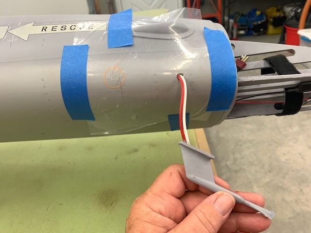

Positioned and hole drilled for air tubes
Flat base needed fitting to curve of fuse side. Plastic taped over area for a release agent.
Mounting holes pre drilled so location can be seen from outside after putty is applied.
Icing light weight body putty used to fill the base
Air data probe held in place till putty kicked off and cured
Removed ready for trimming while putty is still soft
Excess putty trimmed off before it got hard
Ready for sanding
Plywood mounting plate epoxied inside fuse side to hold screws. Screwdriver used to keep holes centered.
Mounting holes drilled
Mounting done.
A little bigger than scale but OK for me
Painted with KlassKote aluminum paint and ready for final install and connection to Jeti Mspeed sensor.

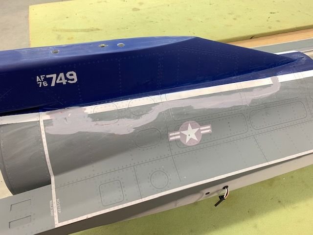

Body work and primer
The plan for repainting the fuse is the same as for the nozzle, cheap, quick, using materials on hand. I rough sanded the epoxy fill in the crack and then applied two rounds of Bondo glazing putty with and artist trowel. Then block sanded with 220 grit.
Final putty sanding with 400 grit by hand. It's not perfect but it's good enough for this project. I tried to keep the putty out of the rivet circles as much as possible.
Grey primer from rattle can sprayed into paper plate and then brushed on with fine water color brush and then fine sanded. Panel lines scribed on after primer applied. I not going to worry about the rivet circles since there were not many affected.
White stripe got touched up with some rattle can white I had in the cabinet. It got sprayed on a paper plate and brushed on. It will all get a coat of matt clear when done so the white gloss will be flat in the end. Next is to mask off the white and touch up the grey and blue. I plan to use the airbrush for that if i can figure it out how to make it go again.

Final paint touch up
Masking for grey touch up. I spent about 5 mins masking this off and got ready to airbrush. Not so fast. Next I spent about an hour fighting my airbrush and finding out that when I used it to spray the soft lines on the nose back in May some paint got in the trigger slide and it was sticking. Took it all apart and got it cleaned out and started to spray and it quit. Found out paint too thick. Thinned paint and got it done in about 3 min.
I masked off the white and grey and sprayed the blue. I forgot to take a photo of the blue masking. The blue HD touch up paint was almost a perfect match except for being semi gloss not flat.
I have a can of the 2K matt clear left and will spray it on after this dries a couple of days. I'm pretty happy with the fix. Only thing I had to buy was the touch up paint and I only used about a half teaspoon of that.
Nose gear door and cracks painted with a small brush.
My arts and crafts nozzle project did not come out like I expected but at least it's not gold anymore. The gun metal paint I used to make the wash was not really dark enough to provide much contrast over the aluminum base coat at the trailing edge. So I did the best I could with what was in the paint locker and it's done. Once again why I don't do real scale stuff.

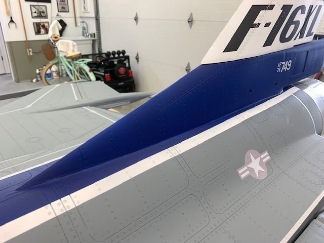

Flat clear coat applied...all done...ready to FLY!
I got a can of Krylon Flat Clear from the hardware store and tested on the bottom of the wing. It was a perfect match to the existing clear coat. The AB nozzle was covered with a paper towel to keep overspray off. The Krylon was perfect for the small touch ups and did not require wasting a full can of 2K clear on a small job. Plus I didn't have to take it outside to use.
The flat clear over the blue was a perfect match.
The grey touch up paint is just slightly lighter than the factory paint but it probably wouldn't be noticed if not pointed out. The flat took the sheen off the grey touch up.
No reflection from the sunlight in the door window now.
I got the vinyl cutter out and made a canopy name tag. Canopy taped off for clear coat spraying
3 coats of flat clear applied and canopy tape removed. My dumb and stupid pilot still has not found the shoulder harness yet. Maybe I'll show him later!
