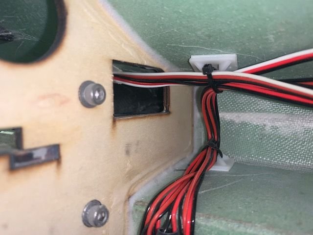

Pipe looks really nice with double rows of spot welds. It had some minor dents on the outer sleeve but they are of no factor in performance
Inside tube is smooth and round
Pipe mounting tabs have very sharp corners. I cut my hand when unwrapping the pipe on the corner.
Fixed the corners with a dremel wheel

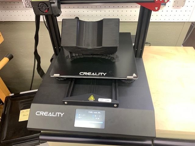

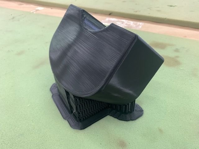

First draft 3D print fuel tank
Printer finished sometime last night with the first draft of the forward fuel tank. I don't know how to use CAD stuff but my buddy Keith can send me STL files and I am just getting dangerous enough to get something off the printer.
Just off the printer with supports still attached. This first draft tank was made just for testing and only has 2 shell thickness. It is good enough for test fitting and making any mods needed.
Keith suggested printing the final version in two parts to allow some internal structure for extra strength on the front and rear faces and then joining similar to a conventional tank. Final version will be printed with a translucent PETG. Estimated volume is 55-60oz.

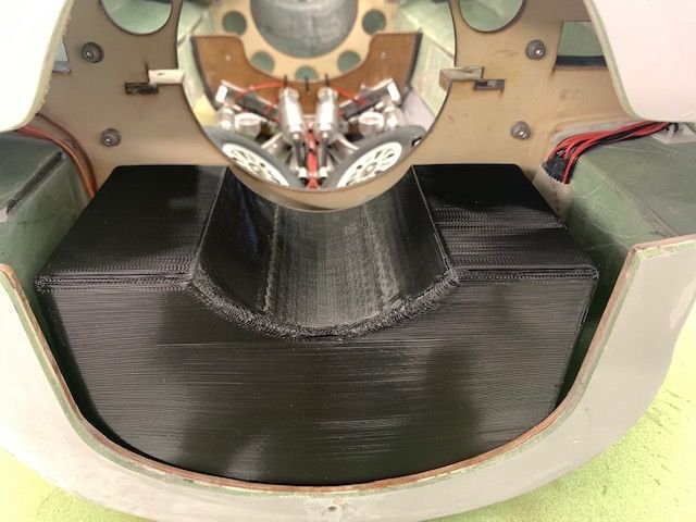

First look at tank fit
Basic fit looks good.
Thinking up a removeable mount system
Good opening for air flow over tank

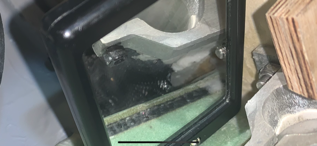

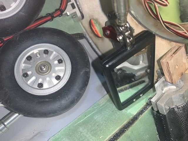

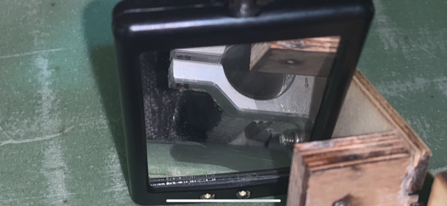

Inspection mirror under the wing clamps.

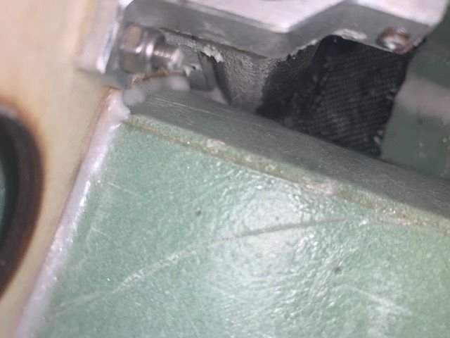

Left rear tube. This one needs to hold lots of the load. No epoxy between spacer and sleeve.
Left rear blown up. You can see the gap between the sleeve and the spacer. the bolt and nut are on the wing tube clamp surface

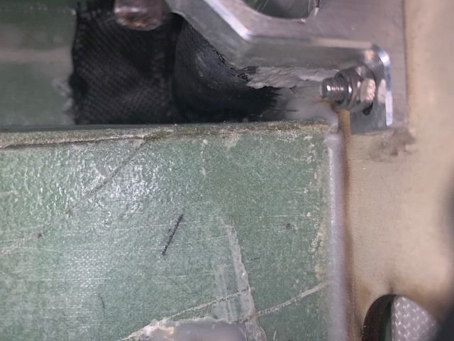

Right front
Right front same problem but the CF is wrapped under it a little better but it does not contact the wood.
Right front again.
Left front
Even though my flying style mostly is smooth with slower high AOA stuff, I will feel better with beefing up the wing tube joints. After inspecting the bottom of the wing tube joints, I am thinking abonut making a simple mod that will help a little. I will inject Six10 epoxy as much as possible between the sleeves and the spacer to fill the gap and then wrap some CF cloth (fiberglass if the CF will not lay down ok) from underneath the sleeves to over the top and through the rectangular hole and down the other side of the formers. I may try laying in some CF tow in the lower corners of the formers if I can get to it. This will make sure the other side of the former is tied to the wing tube sleeve. Suggestions appreciated.
Gary

I just talked to the Knight factory and they are willing to make any replacement parts to help beef up the joints. Let me know if you need extra formers, clamps or other parts to beef up these area.
Mike.

Your inspection confirmed my suspicion based on your first post about the wing joiner. If that were me, I would not fly it without significant reinforcement at the outer end of the tube. As shown, I would class it as very unsafe.
Ideally the factory would install an outer 1/8" ply rib that was mechanically interlocked with the bulkheads which would also support the outer end of the wing joiner tube, thereby providing an outboard mechanical up/ down load-bearing capability to complement and react the wing bending loads against the existing inner clamp block.
As that cannot be easily retro fitted, maybe consider adding a hard-wood support block above and below the tube (full-length) that completely fills in the area between the tube and the upper and lower fuselage skins, and then glassing that in with additional carbon. Also, add another mini-bulkhead on the opposite side of the tube to the existing one to help tie the upper and lower fuselage skins together.
