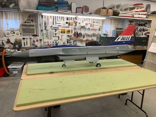

I dropped the gear and got the fuse standing up for the first time.

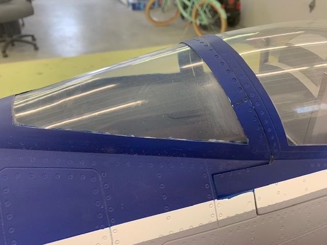

Grey overspray on canopy. Not sure if there is a way to clean this off with out destroying the canopy plastic. Suggestions appreciated.

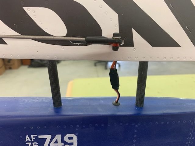

I attached the vertical fin and rudder servo plug
After the fin would not seat on the dorsal fin I discovered the wire was puckered up in the servo arm slot.
Then I realized the servo wire comes up just below the servo arm and there is no where to tuck the wire.
So I had to remove the servo and run the wire to the rear of the servo case. I recommend the servo wire in the dorsal fin be moved aft about 1.5" to avoid conflict with the servo arm.

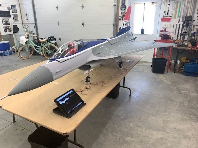

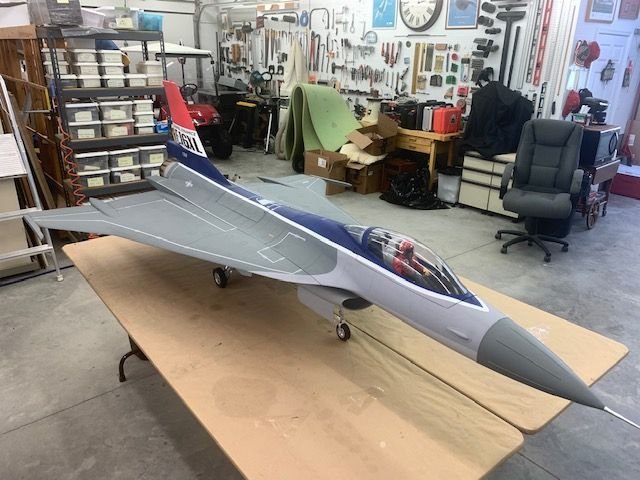

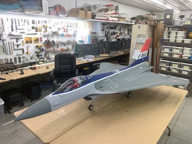

Wings on!
Finally got the vertical fin installed and clamped on. Clamp screws worked good. I noticed the main wheels are tilted in at the bottom when extended. I see no way to adjust the angle of the wheel. If flown on pavement I think the outside edge of the tires would quickly wear.
Got wings installed and clamp screws worked well here also.
Happy snaps with wings on.
The nose up angle of the missile rails really looks goofy. The missile rail should have a slightly front end down angle. I may try to fix that before flying if time allows but it's not simple because the missile rail is the outside hinge pivot point for the aileron. This also shoud be corrected at he factory for future production.
Top view looks really cool. I really loo forward to flying this jet.
I found that the trailing edge of the root rib of both wings will move up and down about 5mm with just a little push. The trailing edge of the wing will have to have an anti rotation pin before flying. This must be done for future production.
I spent about an hour doing musical chairs with equipment on the Xicoy CG machine. The measurements between the fuse part line and the gear provided in the build guide for the recommended CG were exactly the same on this model. I found that it would be quite nose heavy with batteries in the nose. With all the radio components in the traditional location under the cockpit I found I could move the batteries from the back of the front fuse to the nose and shift he CG about 1.5 " I also found that I could be at or forward of the recommended CG if the air trap, pump, and turbine DRU box were mounted above the front tank in the aft fuse section. This would allow me to keep all the wet fuel stuff still connected in the rear section when the front section was removed. So that is the plan for now. I remember Josh told me that F900's jet flew poorly and was tail heavy at the recommended CG so I want to be able to move batteries to get forward of the recommended CG for the first flights.

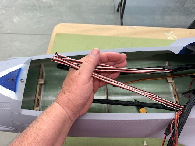

Taming the wires!

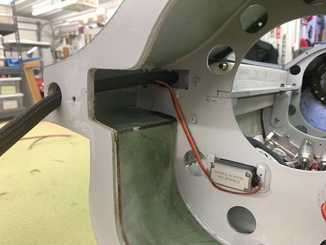

I decided I had to do something with all the wire bundles so I used slotted flex sleeve to enclose wire bundles. I started with the gear bundle at the front former.
Gear cables come forward and pick up the left main gear door servo wire and up and out the front. This section will have the front tank, air trap, pump, and DRU box so I needed to get the wires tucked in and out of the way.
I got this cool tool from Ultimate Jets. Makes tucking the wires in the sleeve easy.
Right side servo wires and right main gear servo wires come out the right side
Left servo and AB LED wires to go...

I know that plastic modelers used to use toothpaste to polish the canopies with.......you might try that, applied w/ a Q-tip to remove the overspray........very carefully! Followed by a polish to clean it up.

I find denatured alcohol works fine on plastic. Put it on a q tip or napkin and wipes off pretty easy.

I tried the denatured alcohol and it didn't work too well. Maybe some polish will work.

Plastic is strong enough to hold most chemicals. I quick pass with some turpentine might do it but don't trust acetone Lol. That can fog it up sometimes if you scrub with it. But D alcohol is very safe I find. I always seem to get paint or epoxy on my canopies but I never have had a problem with D alcohol. There are plastic cleaners and polishers for headlights that are safe to. The problem though can be from the paint they used etching into the plastic. Then plastic polish might be your friend there but sometimes nothing works if that's the case. Then you start thinking about painting the inside a grey or black when all else fails.

Try automotive clay bar using quick detailer for lube, then polish with plastic polish to remove any marring.

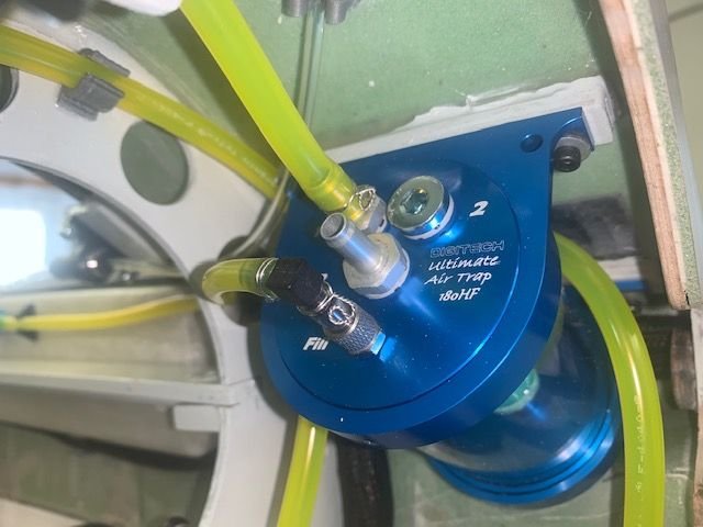

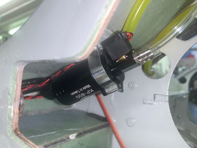

Installing fuel system

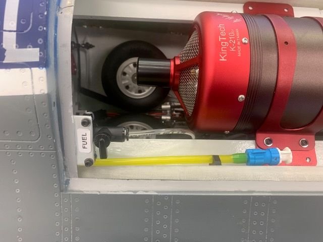

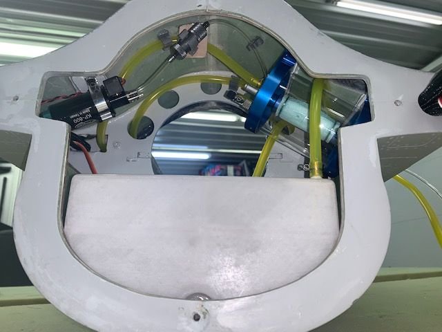

I concluded after my weight and balance exercise to mount the entire fuel system in the aft fuse. This keeps all the wet parts connected and together in the rear fuse. This makes taking the fuse apart much easier since there are only wires to disconnect.

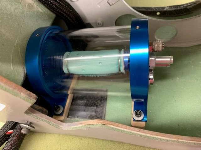

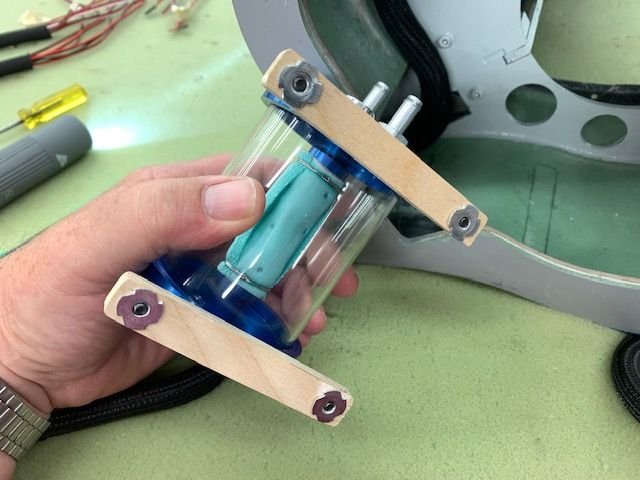

Dry fitting the air trap. I like the Digitech air trap mounts because they allow the tank to be rotated to any angle. This made it easy to mount the air trap on the ceiling and still have the tubes in the correct positions.
Glue positions marked
Blind nuts used to attach the air trap to the mounts
Masking tape keeps epoxy out of the bolt threads
Fuel pump mounted in similar fashion
Fuel pump epoxied in place
Front tank vent connected to overflow tank vent fitting
1/16" craft foam I stole from my wife's craft room placed on tank mount for some padding
Tank strapped in and connected to left saddle tank. Safety wire on tubing connections
Fuel system in ceiling of aft fuse section. I ran out of 3/16" ID Tygon. I needed 5" more to connect air trap to pump. More Tygon on the way.

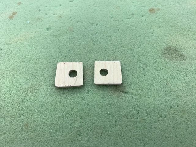

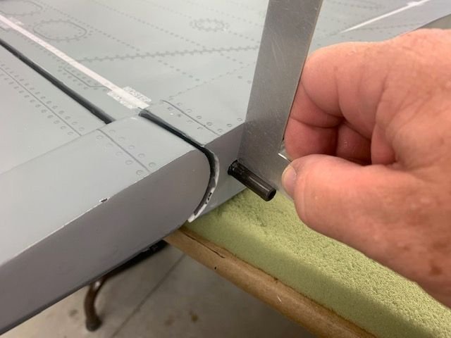

Wing trailing edge anti rotation pins installed
After seeing he flexing of the trailing edge of the wing I decided to install anti rotation pins on the trailing edge before I flew the jet.
I found out this powered screwdriver with extensions makes it a lot easier to assemble and disassemble the fuse sections. I attached the forward fuse before before working on the trailing edge pins. I wanted the leading edge pins engaged to insure the wing alignment would be correct.
Position of trailing edge pin marked on each wing.
The 8mm carbon pin will go into the wood behind the root rib. This is good.
Holes drilled. I started with a 2mm bit and worked up to 8mm
8mm carbon tube pins tacked in with medium CA and squared with root rib.
Pin tacked in ready to fit to fuse
Wing attached to the fuse and pin location marked on fuse side
Holes were cut where pin enters the fuse side just slightly oversize.
1/8" plywood square donuts made and drilled for 8mm pins.
Vaseline was applied to the carbon pins. 5 min epoxy applied to the plywood donut. Then the plywood is placed on pin and pushed into the fuse side. After alignment is checked Six10 thickened epoxy will secure the carbon pins into the wings and the plywood donuts to he inside of the fuse sides.

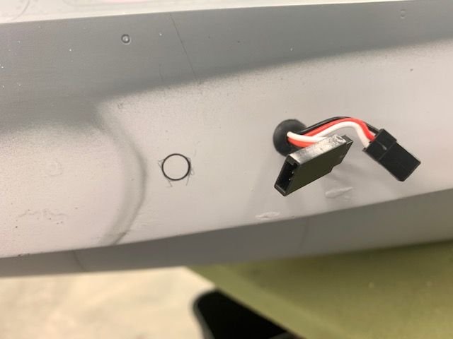

I just noticed the arc/slot in the fuselage side, behind your new anti-rotation pin. Looks like maybe they originally designed this plane to use fuse-mounted servos with direct drive slots into the root of the surface perhaps?

I think the arc you are talking about is paint overspray when they sprayed the top dark grey with the wings attached. I don't think they planned direct drive from the fuse. There is a servo pocket cut out molded into the bottom of each wing where the outboard aileron servo could go in the wing.

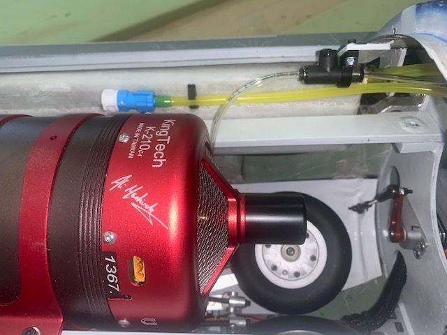

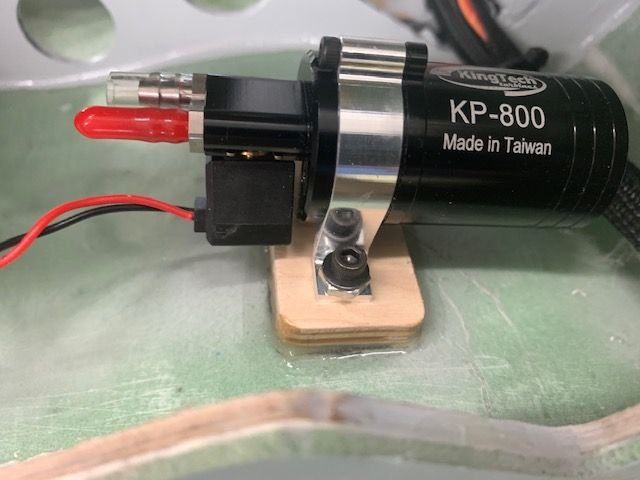

Fuel system finished up
Fuel system finished up except tubing from air trap to pump inlet.
Digitec Ultimate Air Trap 180ml
Here is the Ultimate Jets sleeve clip. Works great on the Kingtech filters. It's a loose fit so the filter can jiggle a little to dislodge air bubbles. The fuse is upside down in this photo.
Fuel pump less connection tubing from the air trap.
Fill tube and master fuel shutoff.
I didn't have any of the small Festo ball valve holding brackets so I used the wide one that came from Kingtech.
View from the front of the turbine looking for air molecules to eat!
Air molecule view from front of air intake just before it's gobbled up by the turbine!
And, oh yes the new roll of 3/16" ID Tygon was delivered this afternoon just after I bolted the fuse sections together to work on the electronics. So first thing tomorrow is to crack open the fuse again and install the last 5" of tubing. Go figure!

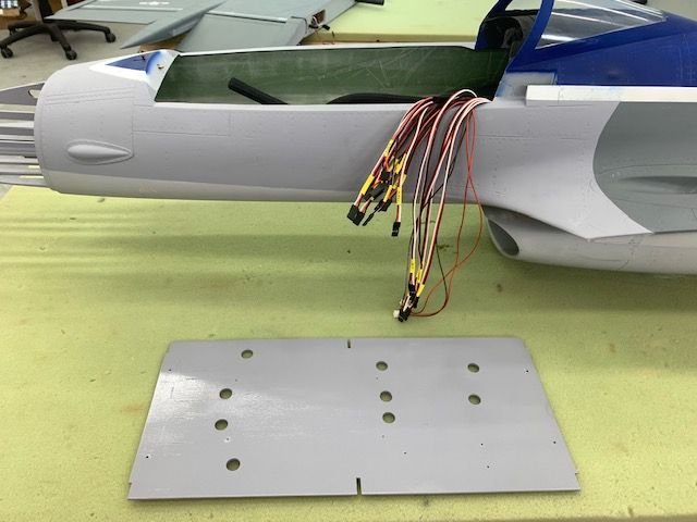

RC Install

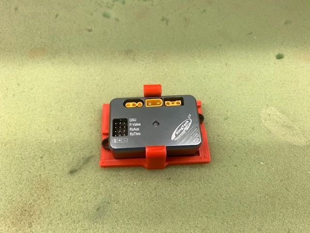

Mission impossible! Is this were the tape self destructs?

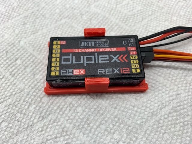

I started out keeping the 3D printer going making bling for all the little boxes.
Here's one Keith drew up for me today.
As long as I can download or get the stl file from an email I can print it. I ask my self why and quickly answered because I can!

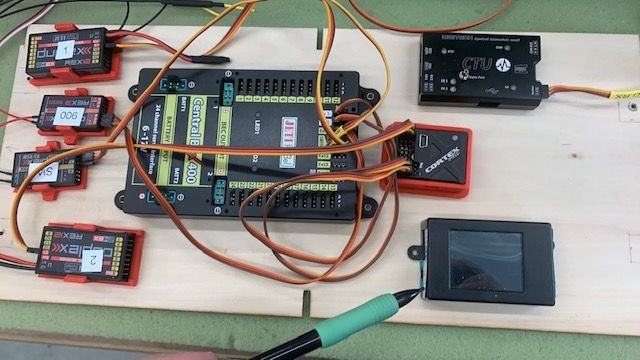

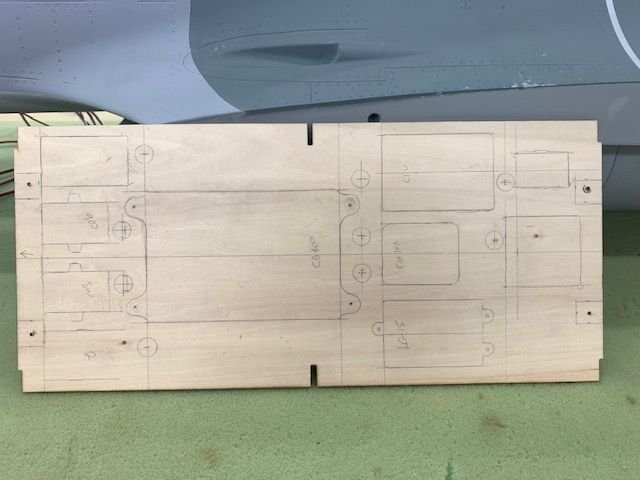

The layout evolved with planning were I could put antennas that were not near all the carbon fiber in the forward fuse.
I added the AB LED and landing light controller to the back of the board. When I turned the CB400 around I had to completely reorganize the output map to avoid a bunch of crossover wires and make sure all the flight controls were in CortexPro stabilized slots. My plan is all the connectors between boxes will go under the board. All of the big cable looms will have to be on sides above the board. To be continued...

I see what you're talking about on the wing itself, I was talking about this that appears to be an arc in the side of the fuselage at the wing root.

...I was talking about this that appears to be an arc in the side of the fuselage at the wing root.
Auburn02,
You are correct. I never saw the marks on the inside before. They are on both sides in the same spot. It looks like something in the molding process was planned and then glassed over. If you shine a light from the inside or outside the hole and arc are clearly visible but I have no clue what they are for. Good observation.

I cracked the fuse sections back apart and installed the final piece of Tygon from air trap to pump and finished the safety wiring. Fuel system is now ready for fuel. I reattached the fuse sections and started working on the equipment tray.
Final equipment tray layout. I kept the 3D printer busy making the part holders. The turbine DRM is not on the tray because the cable from the DRM to turbine is not long enough and I don't want to mess with making it longer. The airspeed module location (seen above the tray) is TBD pending mounting the pitot tube in the scale air data probe location on the lower left side of the nose just behind the radome. Next is to cut wiring holes, mount everytining, and hook it all up.
Minor victory for 3D printer novice, I modified a receiver holder to fit the AB LED light controller.

More RC install...
The plan!
Big moment here. I finally had to make the decision to cut the wires. No going back now!
Let the crimping party begin. 1 down, 40 more to go...
Party's over! I had to trace each lead to figure out what label went on it. So far everything works.
Equipment tray painted. Next is to get everything mounted and connected on the tray. Then hook up the servo leads.

Why make a 3D printed holder for the Unilight controller when it sits in the mount with it's own mounting brackets?
