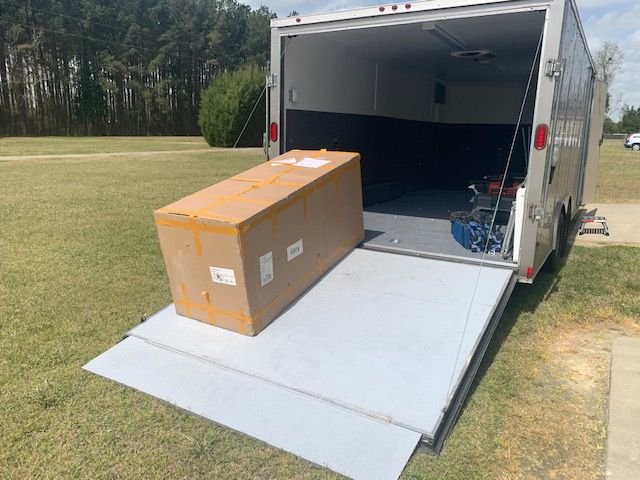

Got notice from the shipper that my jet arrived at the regional freight terminal but it would be several days till it could be delivered to the house. I did not want to wait so I drove to get it.
It's a big box and weighs 60 lbs without the pallet it was on.

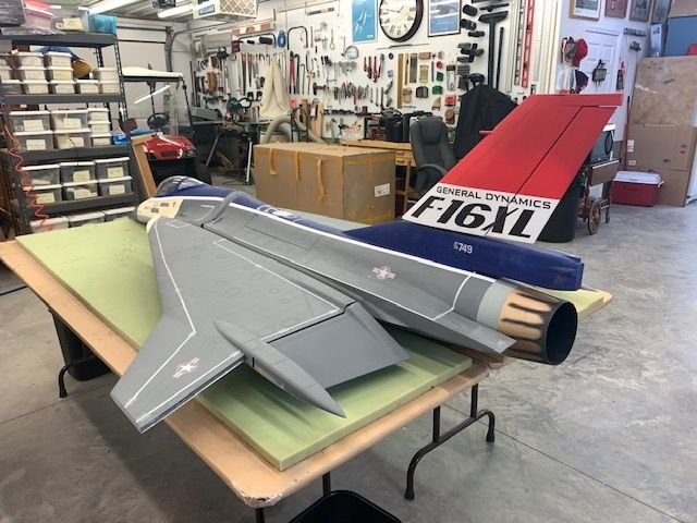

First look! 1st thought is it looks like an F-16 and it's the correct color! 2nd thought is it's packed real well. Wood cage inside box with custom cut EPO foam packing on each end.

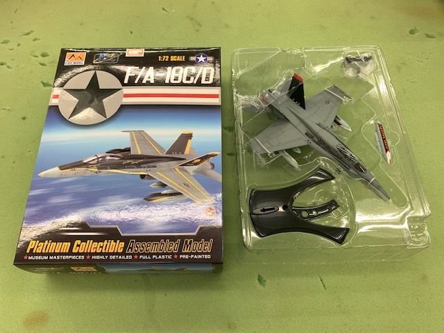

I saw a loose box and thought it was parts. It turned out to be an F-18 display model with stand. Nice touch of swag!

Just 5 pieces in bubble wrap inside the box. Forward fuse, aft fuse, vertical tail, left and right wings. No parts box. I hope the fuse is stuffed full of parts!
Unwrapped the tail and discovered the finish is a very flat matt finish. Not bad just different than I expected. I've been used to the SM and BVM gloss clear coat. It has a slight sheen if viewed at low angle to light. It actually reminds me of some or the F-16 jets I used to fly. I can't remember what the real XL was like since I only saw it once back in the early 80's. You won't get sun glint from this finish!
Forward fuse unwrapped next. Looks like fuse is stuffed with parts. I was not expecting the cream color. It is supposed to be a light grey. This looks like a factory paint shop mistake. This destroys the scale look of the jet. It will be hard to fix. TBD.

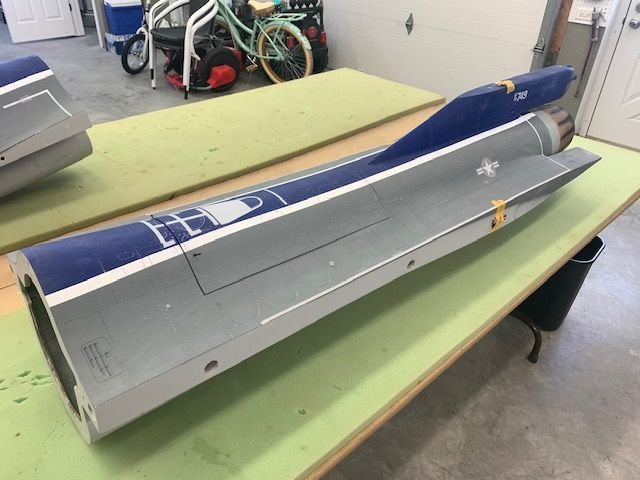

Rear fuse unwrapped next.
It is stuffed full parts. Also looks like an explosion in a hook up wire factory. Looks like it is pre wired but no plugs on wire ends.

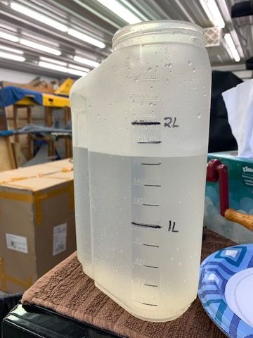

Hi F900, Thanks for the info. My turbine is a K210G4. I agree 120oz is not enough. I was talking to my friend Keith tonight about a 3D printed header tank to fit in the space at the front of the rear fuse section. I can print it if he can send me the files he draws. I gave him some rough measurements and he sent me this pic of a rough draft design.
Estimated volume is about 55-60 oz.

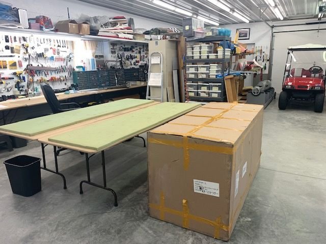

Here's the mock up. The tables are 8' long.
The tables are 30" wide so 60" total.
This looks like a fun jet. I'm really happy with the size at 1/6 scale. I've been hosting the SM and BVM 1/5 F-16s the last few years and this one will be much easier to pick up and move around.

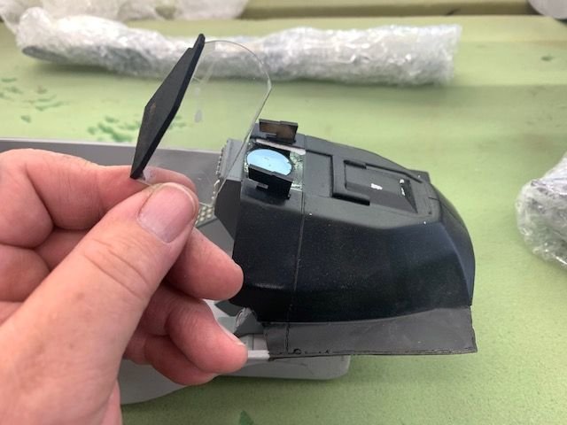

Forward fuse was stuffed with the cockpit and other parts. I unwrapped the cockpit and found the HUD was broken off and one side piece was missing. Also had some glue on the HUD glass.
Nice cockpit is provided. However it is the wrong cockpit for this jet. The XL was a Block 10 A model F-16 built in the early 80's and had round dial steam guages, and the radar scope between your legs. It did not have the dual MFD displays that came later with the Block 20-25 C model jets. I discussed this with Mike last December but he said production was already underway with the C model glass cockpits so that is what would come with the kit.

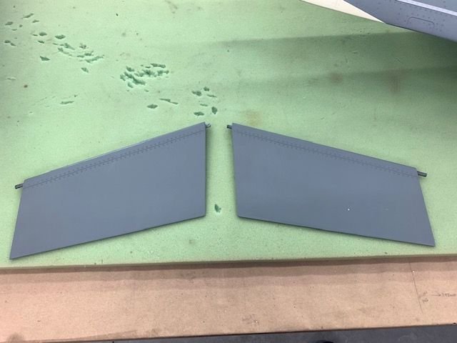

Outboard elevons
Missile rails that hold the outboard elevon hinge pins

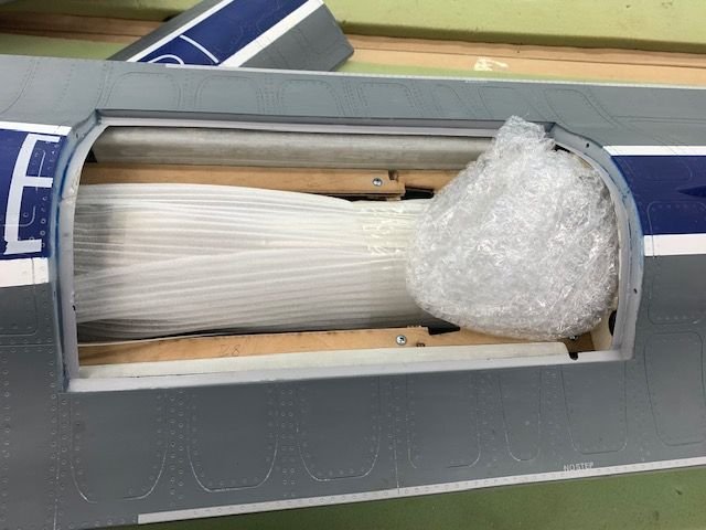

Rear fuse stuffed with pipe

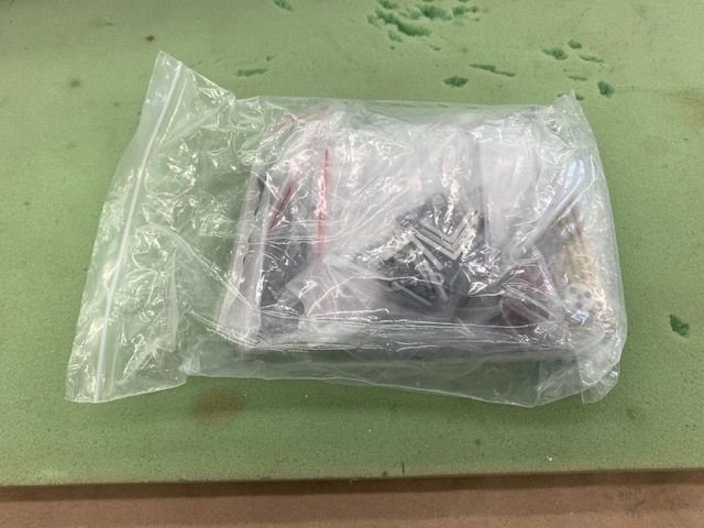

Finally found the parts bag in the rear fuse.
Several sets of hardware, tank hardware, JP brake controller, JP gear controller, and some fake carbon fiber vinyl for the equipment tray. No instructions or manual is included.

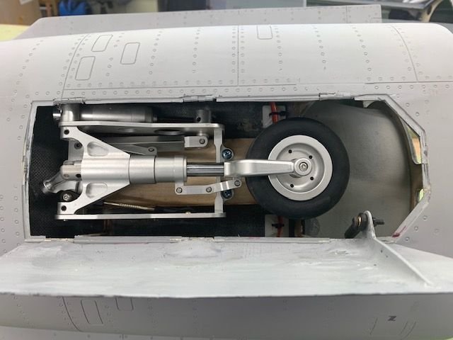

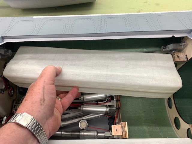

Radome is held on by a threaded pitot tube.
Frame is fixed and non removeable as in SM and BVM models
Equipment tray removed
Space under tray for wires. Wires shown here are nose retract, steering, and nose light
Turbine rails held in place by 3 screws.

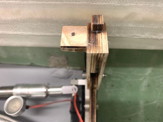

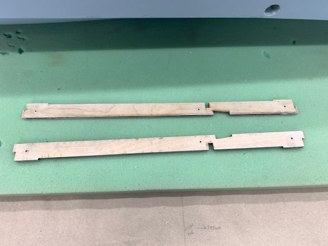

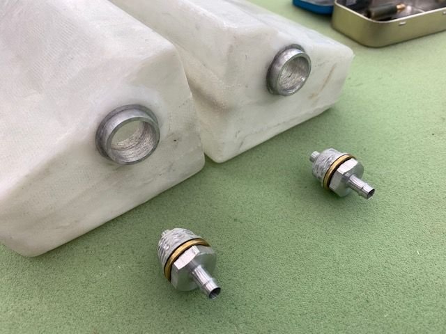

Turbine mounting rails removed. Tanks held in by rails and a wood bracket.
Tank holding bracket is held on by one bolt and nut in former
Tank bracket removed
Tank slides out
Im told the tanks hold about 60 oz each. That is only about 120 total which is a little less that I would like.
Main gear doors
The front wing clamp screw is accessed from the bottom through the gear well

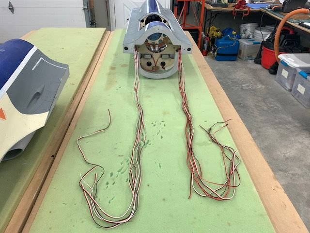

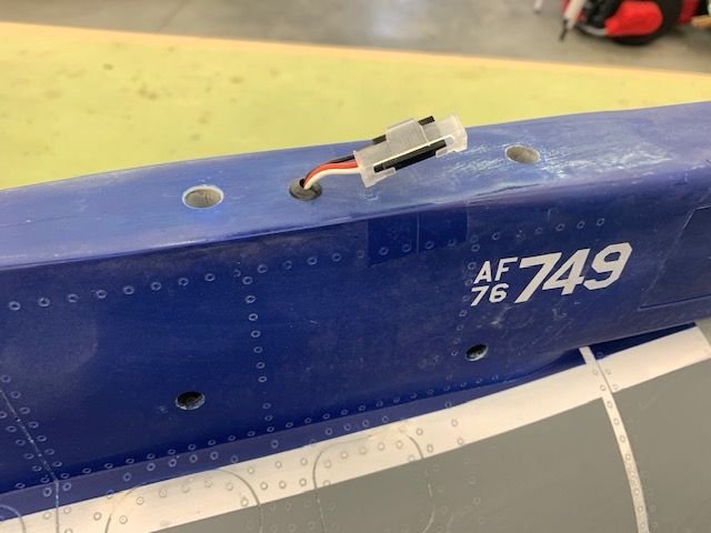

Rear wing tube attached with CF to fuse and formers
Same for front wing tube. Servo wires are run thru the braided sleeves and glued to the fuse. All good if you don't ever need to change wires. I had planned to use PowerBox Maxi wire for servos but these are glued in so I will use them.
Pre wires for left wing
Pre wire for rudder
Pre wired fuse with wire sleeves glued to fuse sides
Wires from the rear fuse section. Plugs will have to be crimped on each wire. It will be fun sorting out the gear, brake, and light wires.
Left side wires are left wing elevons and gear, brake, and light for each main gear
Right side wires are right wing, rudder, and main gear door servos.

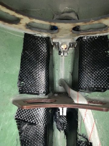

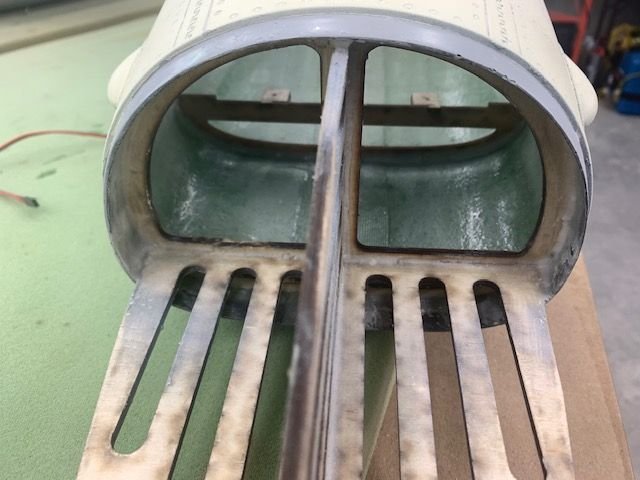

Here is the view from the pipe bell area toward the rear. Servo leads are in the striped sleeves
Looking up toward the vertical fin mounting brackets and rudder servo cable sleeve. Looks like carbon cloth is wrapped around the front mounting clamp.
Tail pipe ring in rear looking forward
Cockpit area looking to rear. Wires are nose retract, steering and light
Nose gear well. A mini servo mounts in the lower part of the NG frame for steering. Pushrod is installed seen on the bottom frame in the photo
Nose gear door servo
Nose gear door
Parts table. Parts for F-105 and F-16XL intermingled here. Maybe I could make a hybrid F-105XL!

After spending half a day doing yard chores I finally got to the shop and started modifying the fuel tanks. I'm installing a "high flow" fuel system using 3/16 ID fuel lines from vent to pump.
I found my fuel tank fittings fit right in the existing tank openings. I used a permagrit round file to score the inside of the tank fittings to grip the hysol epoxy.
3/16" ID tank fittings with threads scuffed up.
Fits like it was designed for it. I checked for clearance inside the fuse and there is plenty of room.
Cutting vent fitting holes with round permagrit file in drill
Test fit
I scuffed all the mating surfaces. I inspected inside both tanks with a small mirror and they looked pretty good. I have seen some China tanks that have blobs of chinapoxy and glass fibers inside that required cutting them open to clean up the mess. These had just some shop dust plus what I put in them cutting the holes.
Tank rinse and volume check
Both thank held less than 1.7 Liters. I estimated 1.68L or about 57 oz each for a total of only 116 oz. We will have to add another tank for sure to support my K-210G4.
I cleaned all the mating surfaces with acetone. Hysol was applied to both surfaces and parts inserted. Squeeze out cleaned off with Q-tips.

Originally Posted by RC_MAN
I'm looking at how the wings plug into a plywood former that has a bunch of holes in it. No carbon reinforcement between the former and the fuselage. This may be the weak link. What do you think?
Good observation. I will have to look at that. There is carbon cloth over the tube bonding it to the fuse skin and the former on one side but it does not extend in very far on the wood. I will look at that and maybe add some more carbon cloth to spread the load on the wood a little more. That is what is so good about more eyeballs looking at stuff. Thanks.
Gary
