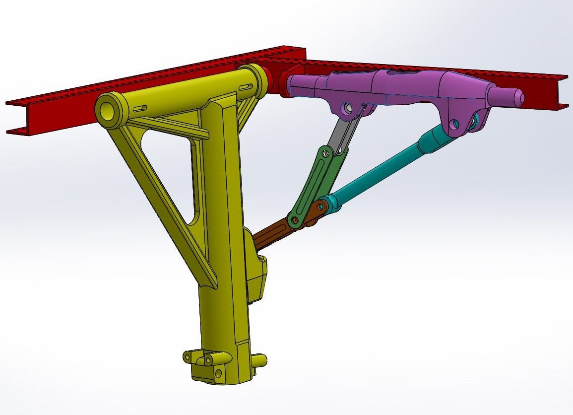

Mini flyer, do you have data, that you could extract a mechanical “schematic” of the main landing gear linkage? Also of the canopy actuating linkage.
Meaning if you are building data and sharing, these would be at great interest to me. Thanks
Old 10-03-2022, 06:14 AM
  #43
Miniflyer
Join Date: Dec 2004
Location: Neuburg, GERMANY
Posts: 1,062
Received 12 Likes on 8 Posts
Hello Matt,
The canopy opening mechanism is not that easy, as it is integral part of the frame, of the rear canopy base and the ejection seat rail. It will need to have all those parts matching together in order for it to work.
The main gear is fairly straightforward, with the brace pulling in the leg and a hydraulic cylinder on the main strut aiding.
None of the parts are in the design phase yet, i just have the sketches and pictures, but i will get to work on it as soon as i have another project wrapped up.
These might help on the landing gear.
Regards,

Miniflyer, can you outline why some struts have this piston and other don't?
Regards,
Its not a factor of strut, its the aircraft version. T-38 and early F5 had the "weak" gear with the slim tires. Later F5 versions received beefed up structures, stronger engines and a stronger landing gear with wider wheels. Looking at the geometry and position i would suspect the cylinder controls the angle of the gear door. On the T38 a stiff connection provided enough clearance to clear the slim wheels, but for the wider wheels the door needs to be angled outward further. Im not 100% sure but i dont see any other function that would make sense at that position.

Yep, you are completely correct. On this other image from a crashed airframe it shows a pad that would connect to the gear door.
I finally found reference material for the gear and still not 100% correct as some parts are out of line yet getting there.
