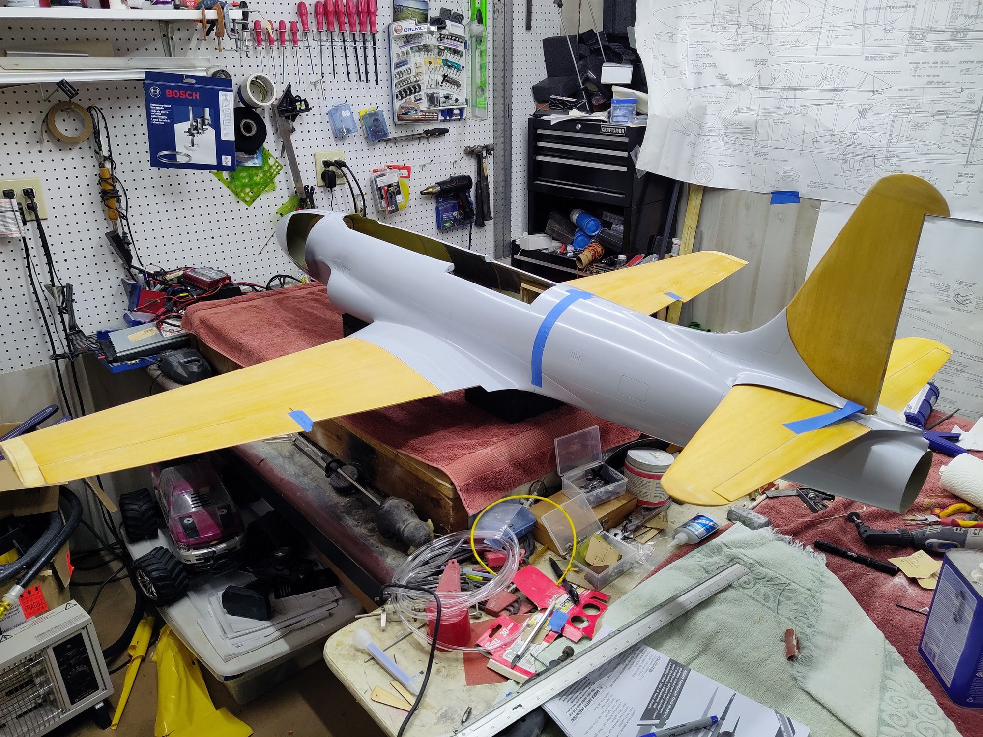

So i picked up the turbine version BVM T33. I started on it a little while ago and decided to show the progress. I am to the point of getting ready to spray primer. I have a little bit of spot fill on the fuse and some small detail work. It builds pretty straight forward with very few issues. The servo mounts and all bulk heads have been installed. I have been using West systems 610 epoxy. This stuff is great as it doesn't run. It does take 24 hours to fully set. The intakes, bypass and tail pipe are all in. I have had the gear in it but removed them to get ready for paint. The tail pipe and bypass will come out for paint as well. Here are some pics of the build.

I made a little more progress today. The scale inlets are in and just need to finish up gluing the tip tanks to the mounts.
Power is going to be my trusty propane start K-80.

Looks like a fun project. I built 2 P80s. I remember that people were filling in the under camber below the intakes on the bottom on the T33. With my P80 it enjoyed full flaps speed brake out and crow on landing

can you elaborate more on filling in the under camber? I know that some people were putting stall strips on the leading edge of the wing near the root to force the center to stall first.
As far as the side nose cover it has the blocks to lock it in then on the aft end is a BVM slide latch pin. I will get pictures later and post.

Joe that's a nice color scheme . Easy to see. The area in front of the speed brakes on the older kits had a under camber . It effected landing in a bad way. People would fill it with the lightest product you can get. Balsa then glass would be the lightest. I did the hatch the way you stated. It only came off once. If you use about 10 MM of crow stall will not be a problem. When I was doing my first flights even with crow, flaps speed brakes the plane would get pitchy on landing. CG was right. I finally put 4 OZ lead in the nose and problem was solved. This is a plane that you never! let off the elevator on landing. Good Luck Dan

...... the plane would get pitchy on landing. I finally put 4 OZ lead in the nose and problem was solved. This is a plane that you never! let off the elevator on landing. Good Luck Dan
Totally agree with Dan. I flew one with an AMT Mercury HP and it was great, especially once I had added some more nose weight.

just one suggestion, do not use that red filler, remove from everywhere you used it, you can use acetone to remove it. The reason? It never cures, when you do your final painting, because of the solvents, it’s going to get soft and will show through the finish and ruin it. What you need to use is the blue 2 part glazing putty (same brand) it cures in minutes and is very easy to sand.

Joe one thing I noticed from your pictures you did not put button head screws through the nose gear door hinges . Glue will not hold up and it will allow you to repair them if the nose wheel does not come down. Dan

Thank you for the suggestion. That is spot filler putty. I have used it for years on many a models. The steps I use it in are to fill the imperfections in the seam first. After I sand it down, I then will be putting a coat of primer on the entire jet. After that I will use the spot filler again. Then those small area's get a shot of primer again. I don't paint directly over the spot fill. I do have the Chromo lite body filler that I use on deeper scratches.

I can see from your photos that the “cusp” or droop of the leading edge of the inboard wing section has been removed on your model.
My T33 was flown with JPX 260 and was quite heavy. As did several other fliers we tried hard to eliminate its tendency to flick easily at the stall, which also meant careful handling was required for landing.
We tried root spoilers, crow, ailerons both moving up as elevator was applied. Things improved but the only real fix was removal if the cusp, so for you the problem is solved.

I Thank everyone for all of the input on the T33. Some really good advise on this particular Jet. After looking at mine a little more in depth. I believe this one to be the latest and greatest kit for the turbine version. It does not seem to have the undercamber on the fuselage. Also the wing tank mounts are aluminum tubes into the wing with carbon fiber rod. This structure gets glued into the wing tank then is held in place by a single screw through the wing into the carbon fiber rod. The front hatch does have the latch on it as well. A little bit of fill at the wing roots and I am close to primer.
I also started the cockpit and hatch cover.
I looked at the plans and the CG is 3.5 inches behind the leading edge at the root where the wing meets the Fuselage
