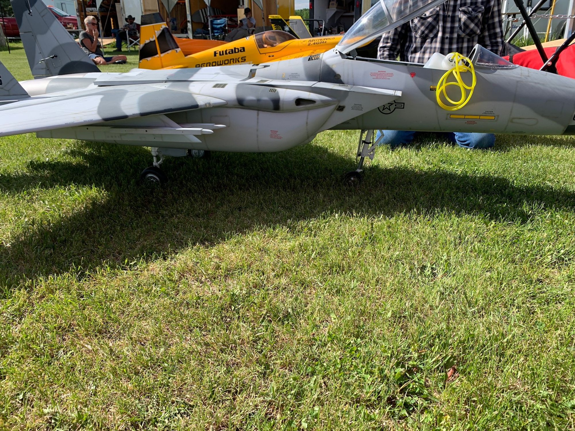

Don't forget Sean at Strictlyscale.com sells lots of scale parts for these F15s. Here was mine before I sold it. I loved the plane and the droppable bombs was a fun addition. The moving inlets was a pretty big undertaking though. It did work fantastic in the end. The gear was really the only headache. I crashed this plane on maiden due to a flameout. I was inverted not moving very fast right over the end of the runway. Just didn't have enough speed to get her back so she went right into the trees. Was pretty much toast but I fixed her all up again.
I did every load out imaginable and the plane flew perfect with any load out. No CG changes needed.
Another really big thing is to throw away the big center fuel tank. Get a smaller one made and use that. I did use the stock one but I cut the entire middle out of it and rejoined the top and bottom. The stock tank is simply to large and makes rotation at takeoff challenging. I had mine on scales while fueling and it was 1 lb tail heavy empty and full 1 lb nose heavy. So it changes allot when that center tank is full.
