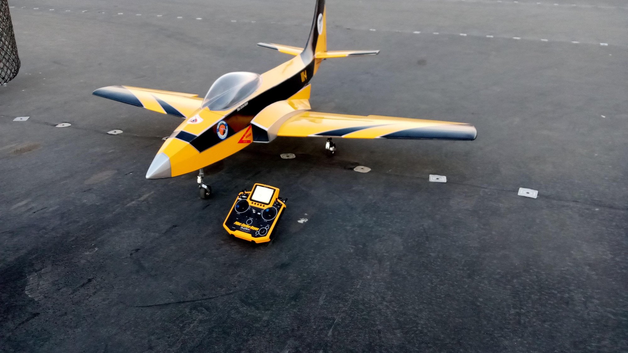

I finally maidened my second 125% Turbinator.

Nice!! Congrats, what size engine?

Power is a JetMunts M166TS. This one is about 4 pounds lighter than my first one.

A couple of 125% Turbinators. I got 2 more flights on mine and feeling a lot more comfortable flying.
David's was under 10 feet of water for 3 days after Hurricane Harvey. It got re-maidened yesterday and flew great.

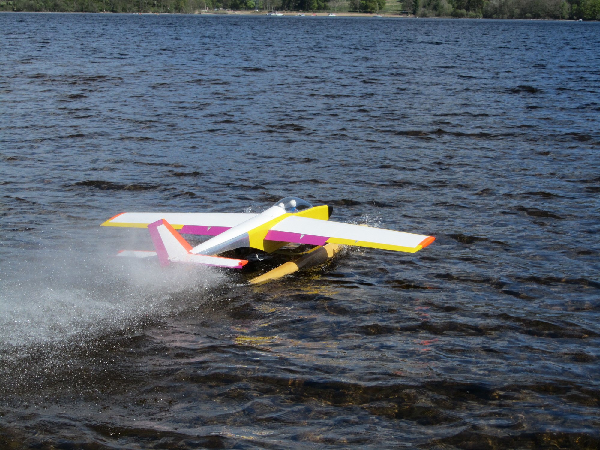

May have to put floats on them.
DO IT!
My JayTee flies great off water with floats. Been doing that for 12 years or more. It doesn't like rough water though. Occasionally it will take a mouthful of water early on the T/O run and the fire goes out. Does no harm.
Once it's on the step it is fine, it's just that transition phase as it accelerates and throws some spray.

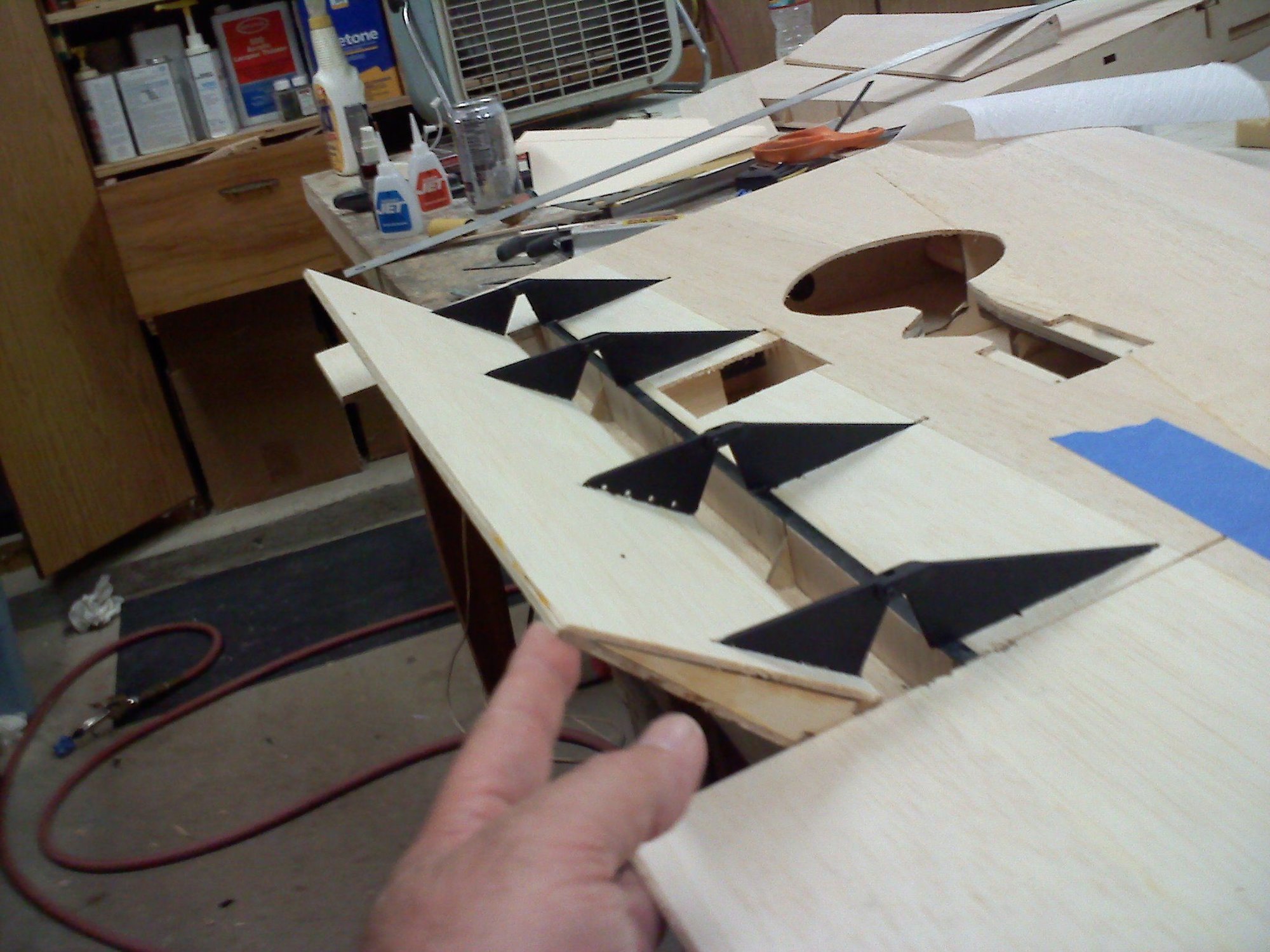

Found this on the original thread started by Ron Stahl. This was measured on my first one.
Elevator - 1 1/4" up and 1" down
Aileron - 7/8" up and 3/4" down
Rudder - 1 3/4"
Flap - 4 3/4"
Crow - 7/8 up aileron with full flap
My flaps are hinged with Yellow Aircraft hinges.

I built the 3 piece wing and it balances on the forward wing tube.
