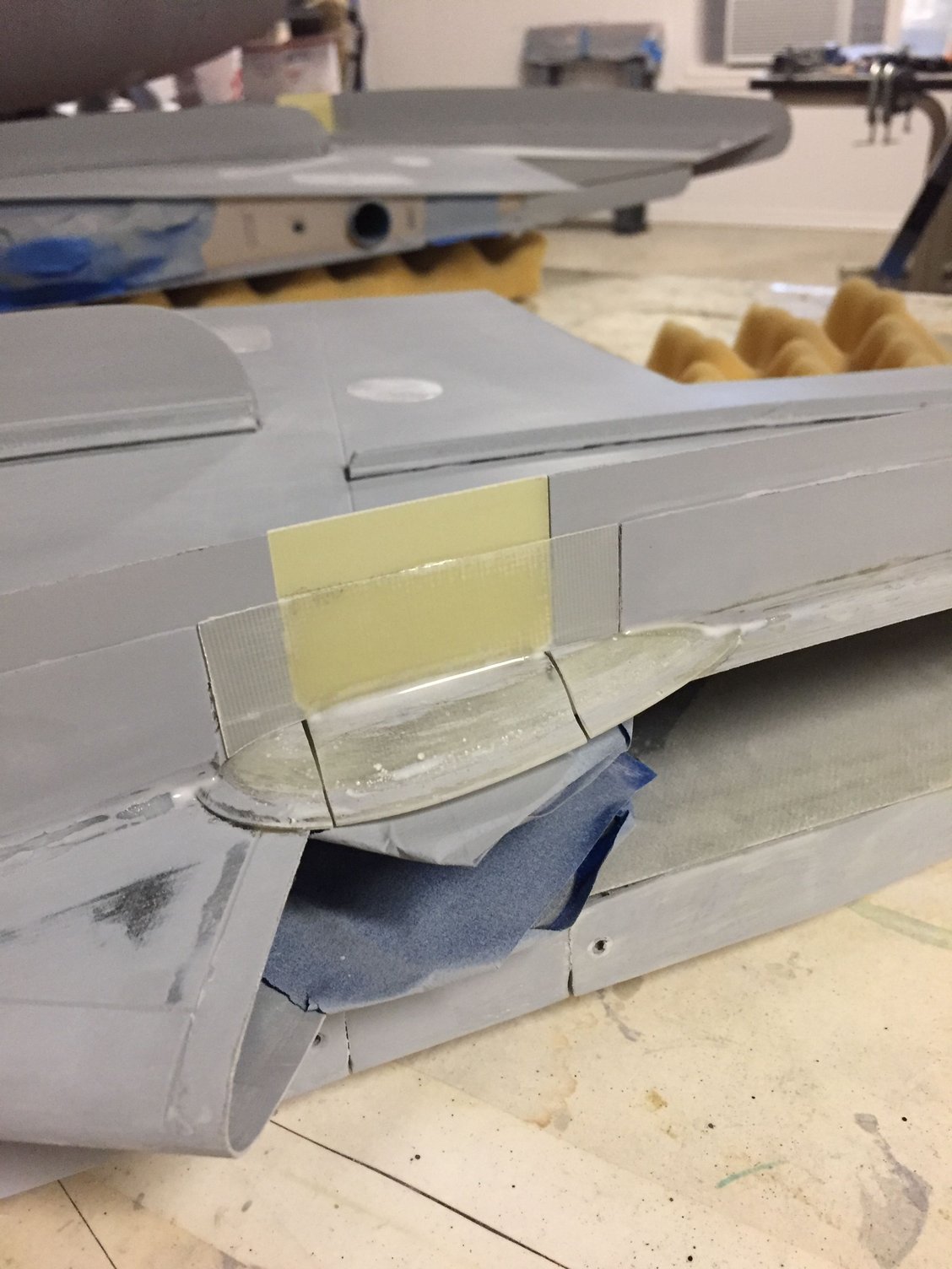

#42
Actually those last two pics looks like the wing carrythru structure WAS already bonded in place. Below is a pic of that same structure outside of the model. It appears I don't have many pics showing the wing rigging, but the wing incidence meter and the digital angle meter was used a lot.
After the wing was rigged to the correct angles, and structure inside the fuselage had been bonded in, it was time to get to work on the inboard wing fences. There is a small wing fence that was made of G-10 or poly-ply, under the wing and just outboard of the inboard TE Flap. After that was installed, I started on the Outboard Fence. This fence wraps all the way around the airfoil, at the wing pivot station, and will need cutouts in the fence on the top and below the wing, to get access to the pivot pin. The lower portion of the fence turns into the outboard pylon, also. and, this fence has varying thicknesses... So I made the fence by stacking G-10 sheets to the needed thickness, Then to create the lower pylon portion of this fence, I added ABS grown pylon halves, to build up to the needed pylon thickness. These were a bunch of work... Plus, since the wing has anhedral, they have to be aligned so that when the model is sitting on the ground, the fences hang straight down, and not normal to the wing plane.
2020 Feb, wing carrythru structure and inbd wing structure.

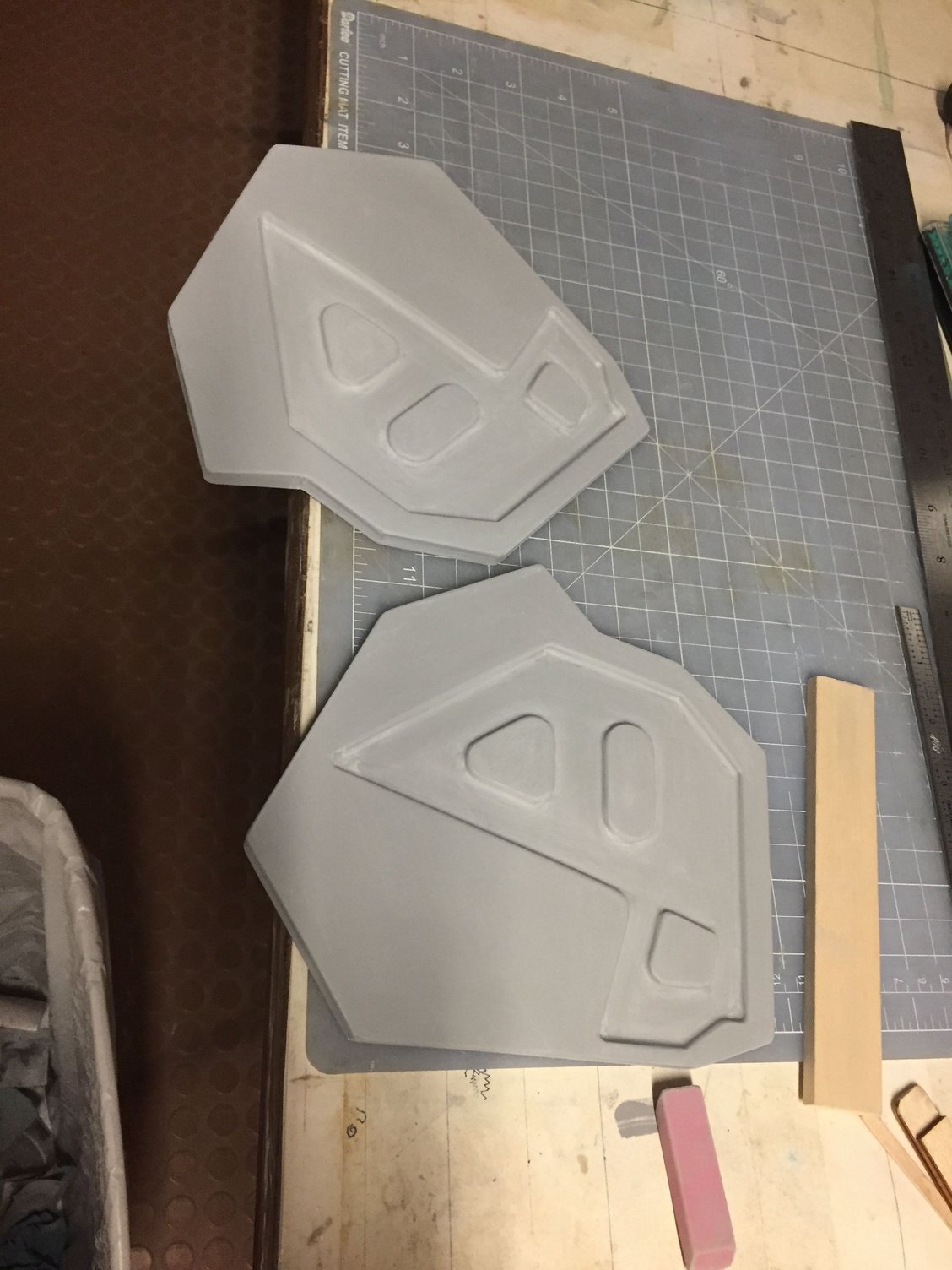

Some of the parts to build a outboard fence / pylon.
Outboard fence on LH wing. note the cutouts above and below the wing pivot point.

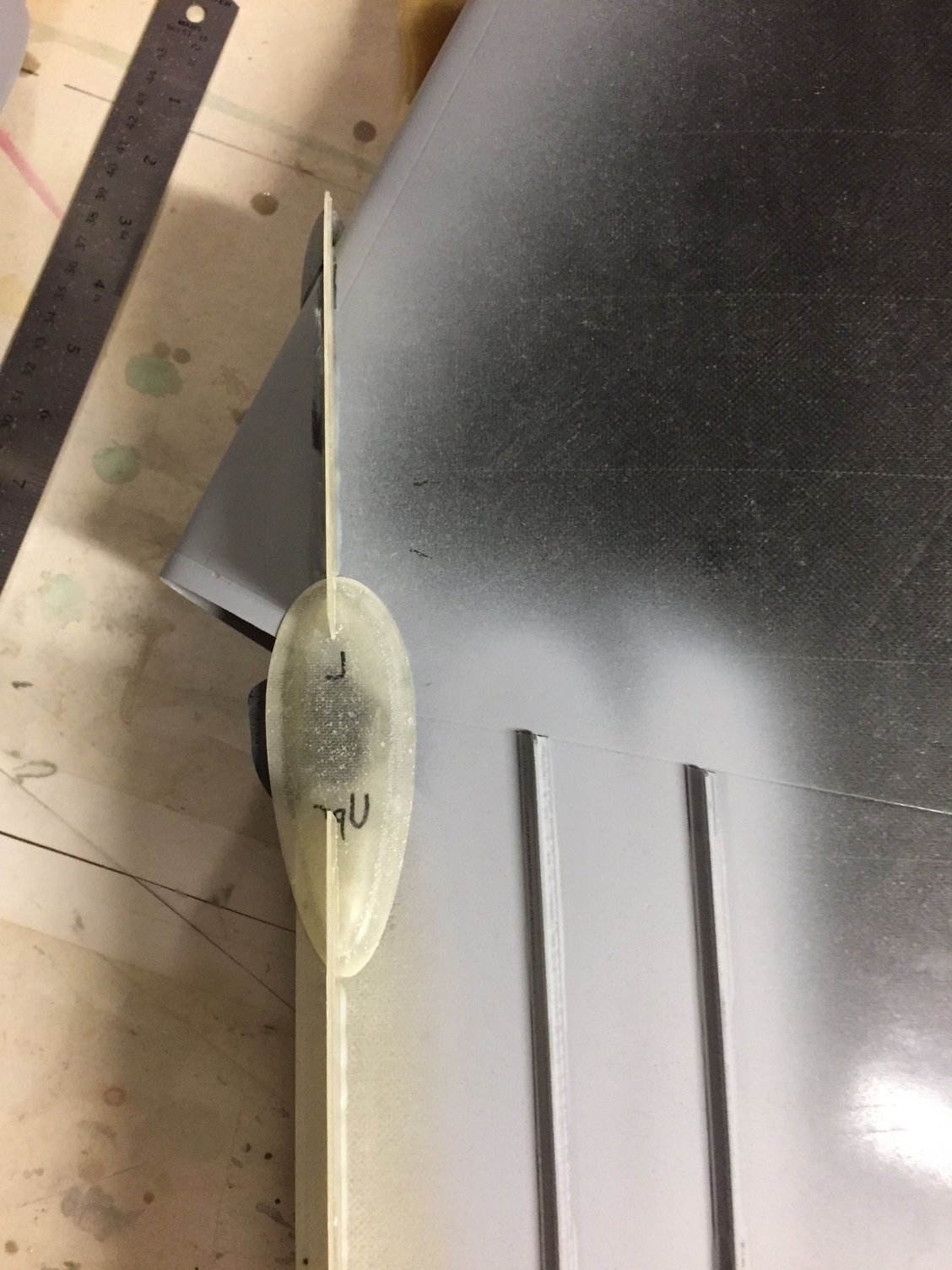

Teardrop shaped pivot covers made and located above and below the wing pivot point. They will later be sliced into sections...
Then, installation of the midboard fence, which is mostly on top of the wing, and slightly wraps around the wing LE.
Closeup of the Upper teardrop cover, having been sliced up, with part of the fence attached so it is now removable (slide up and down), but screwed in place for flight.
Pivot cover slid down in place. similar cover made for the lower side, but the lower cover also becomes part of a pylon.

Next, I got back onto the MLG doors. They needed inner liners to stiffen them up, so a mold was made to create those liners. Also, a scalloped part was going to have to be made, as a wheel well, for the portion of the tire that gets hidden inside the fuselage when the gear is up...
Primer time.
Quick molds made for the MLG inner liners.
Parts were laid up with the liner molds, then attached to the inside of the MLG doors. the large doors mount directly to the MLG strut, while the smaller triangular door mounts next to the lower "trailing link" portion of the strut. There is one more door that covers right where the main strut pops thru the lower wing - I'm gonna hold off on that door for a while.
