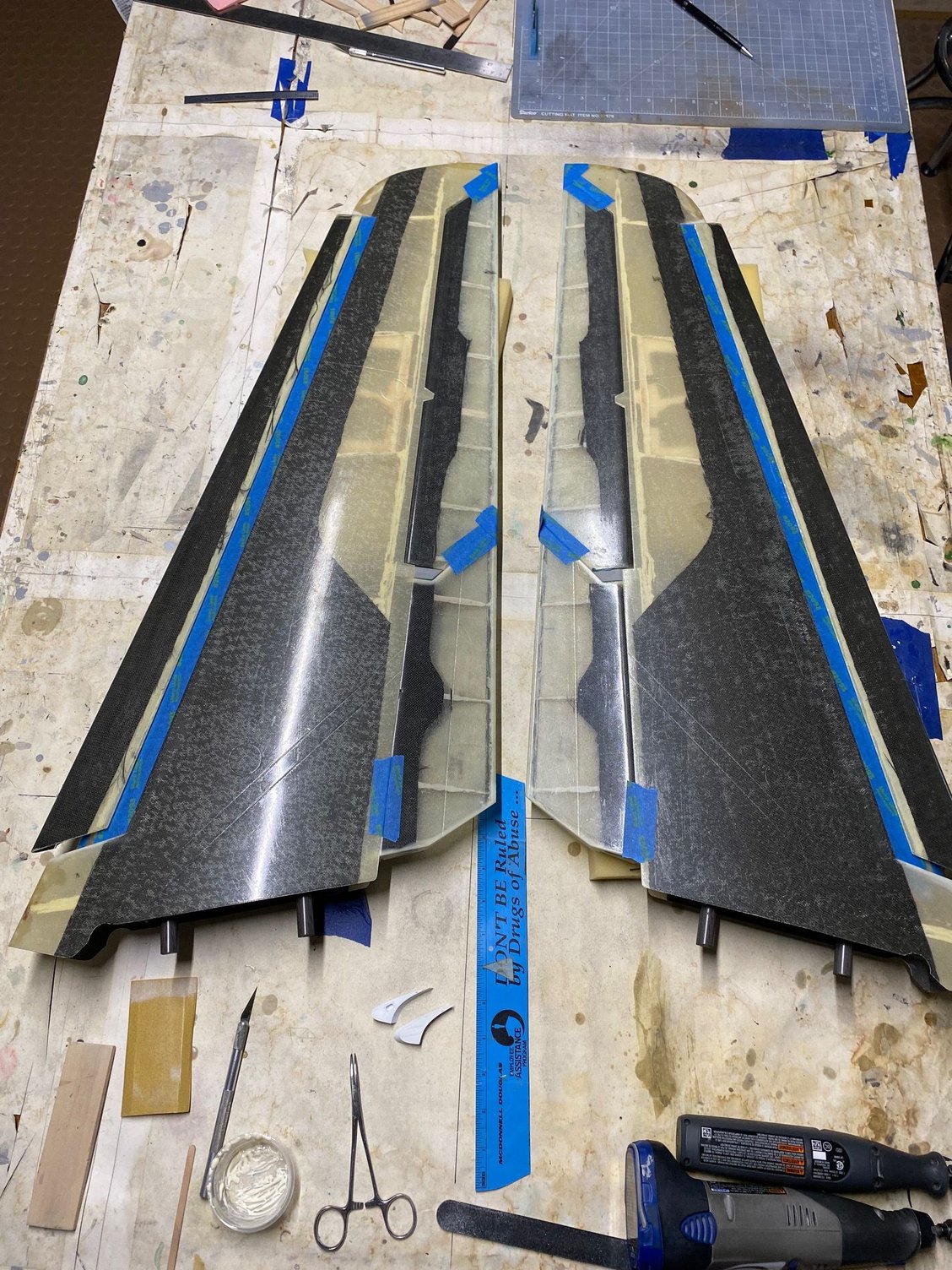

So I decided it would make sense to start on the Fitter2 Outboard wings first. That way, since I have all the TE control surfaces, I would just need to make the slats, then I would quickly (?) have full up outboard wing panels. I can't save weight on any control surfaces at this point, but I CAN save a bit of weight on the outboard wing internal structure, by increasing size of some of the lightening holes, or making more.
Also, we have a lot of heat down here in Texas this month, so I probably won't be flying much. That means I'll have some time to try to hit this thing hard. Away we go...
LH outboard wing made. Getting ready to close up the Fitter2 RH outboard wing.
Starting to bag Fitter2 Slat parts
Slats installed, and pulled out of the outboard wing slightly. The slat build and install went a bit more quickly, relative to Fitter1. Previously made control surfaces and associated hingeplates installed here.

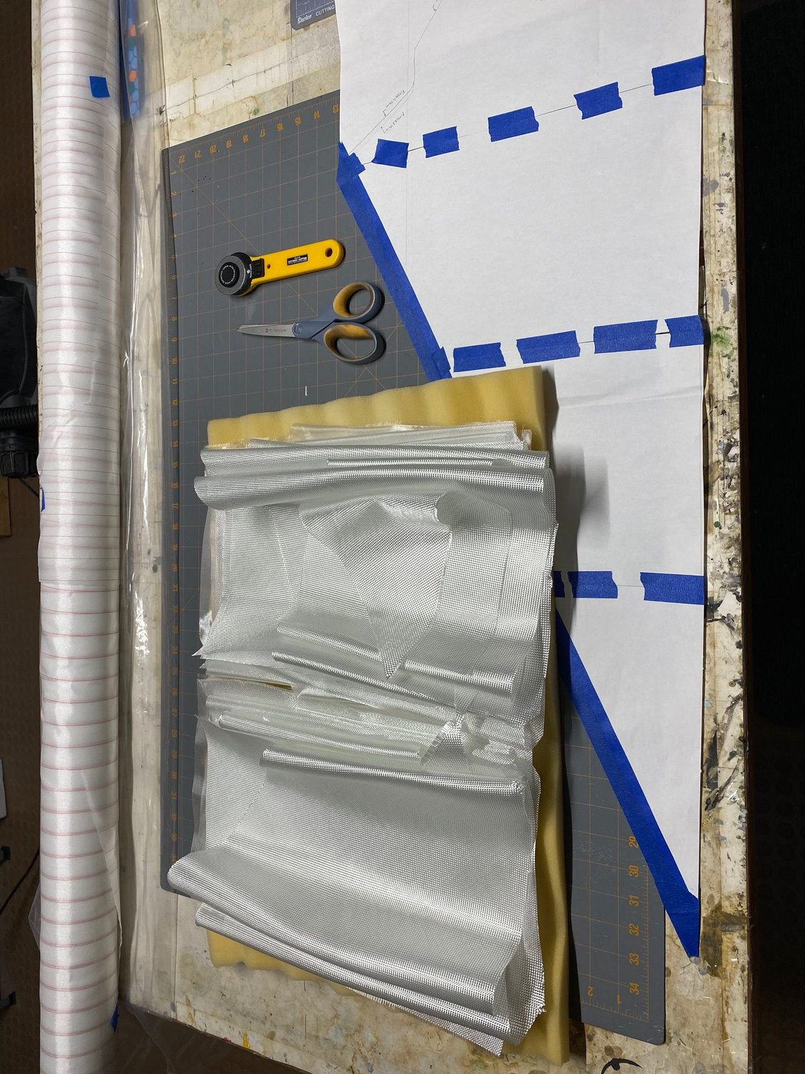

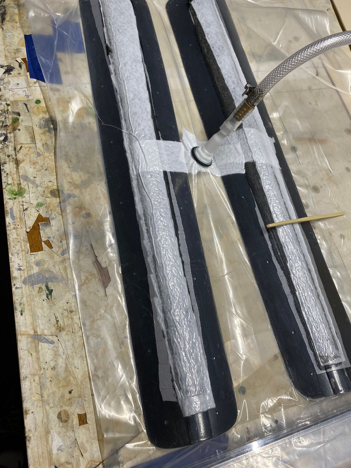

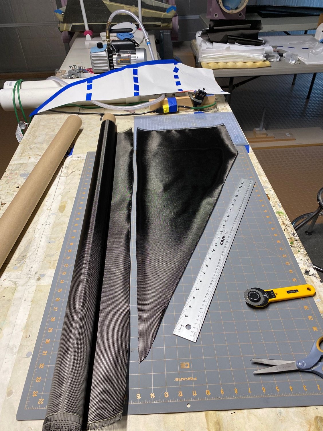

I now have all parts for the outboard wings for Fitter2. Left will be to do any fitting adjustments, servo covers, and a lot of little stuff, but since the parts are all fitting, I'm gonna put these assemblies aside, and jump on the inboard wing skins. Cloth all cut to size, and these layups will begin today.
Cutting out the carbon fiber reinforcements
Fiberglass pile for the inboard wings. chop chop...

Received 186 Likes on 114 Posts
Hi Thomas,
the black stuff I’m using is actually 1k carbon cloth. I have some 3k, and I may have used some on my first Fitter H tail, but I think the 1k is sufficient.
Instead of using CF tow, I'm using pultruded CF strips of varying sizes depending on where they’re located. They’re usage is mostly inboard, since that is where the higher bending loads are.
Many of my parts were laid up with 3/4 oz, 2, 4, 6 oz, then 1k CF cloth from LE to just past the high point of the airfoil. It does vary some, due to the shape of the parts. For instance, on the outboard wing panels, I continue the CF as a strip outboard that runs above/below the plywood spar, to create more of an I-beam concept. On my slats I just laid up, my existing pair seem pretty rigid, so I replaced the last 6 oz layer with a 4 oz layer.
I'm using the first model as a baseline since I know it works; and will try to improve it from there on Fitter2.

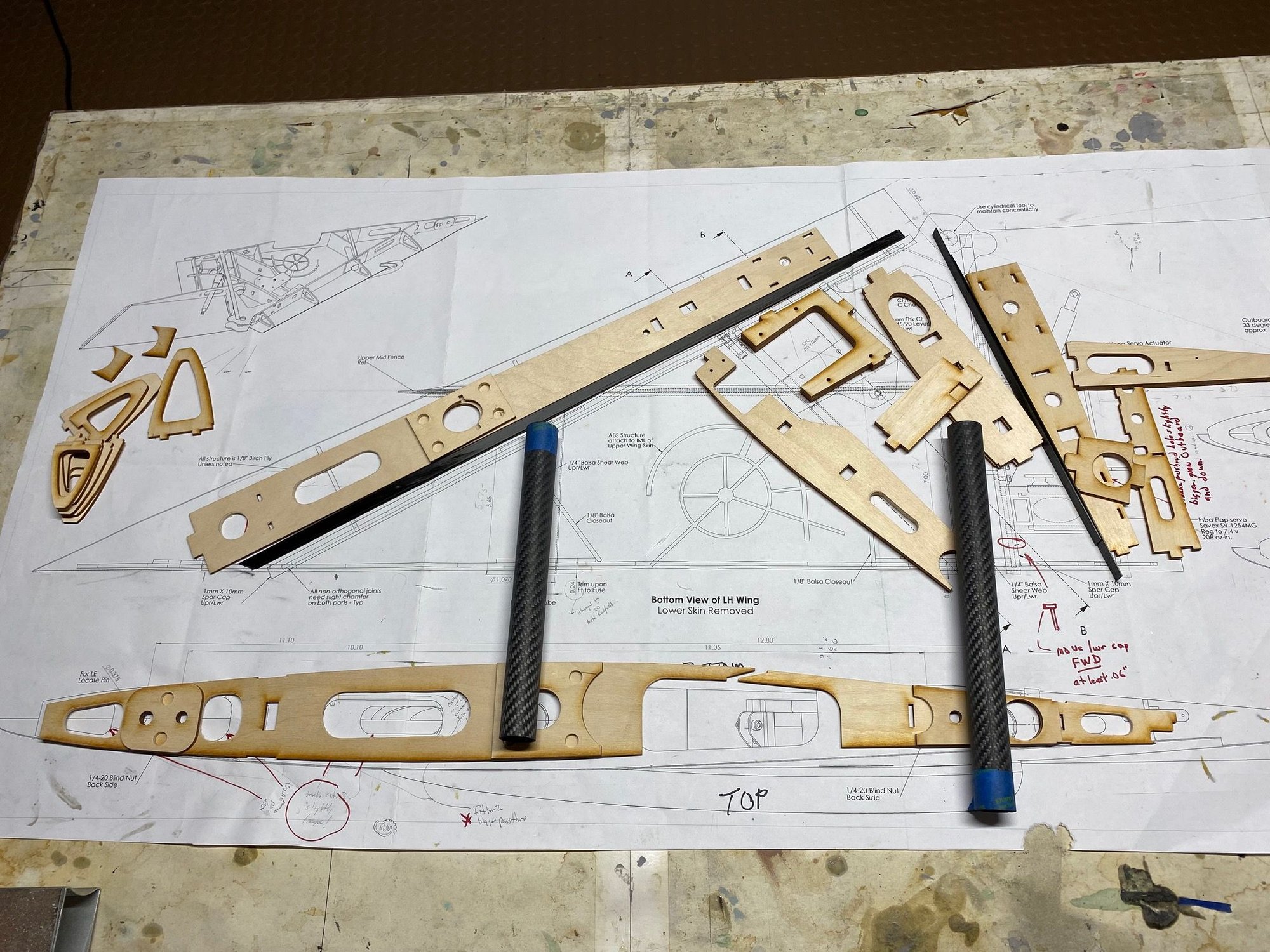

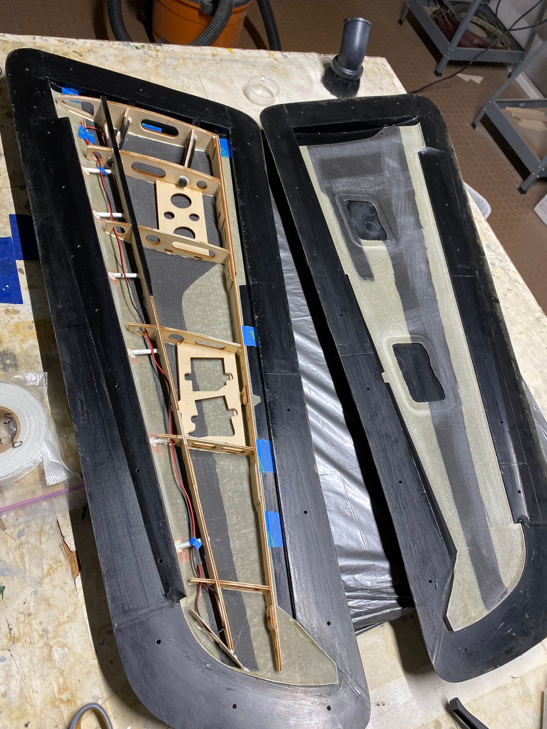

I just finished trimming the inboard wing skins for Fitter2. The layups went well - maybe a bit more uniform than on the first model (Fitter1). Also dug out the parts for the inboard wing internal structure, and will begin structure buildup in the coming days. These parts were laser cut at the same time when I had Fitter1 parts cut out. This time though, I went through each part and decided if there's any dead weight material that isn't really contributing to carrying load. Or if any access holes could be enlarged. So I spent a half a day with my Dremels, and started trimming away what I think is excess material. Then I updated my cad files so if there's a Fitter3, I won't have to go thru this routine again (I'll have updated files for laser cutting).
New inboard skins all trimmed up (for now).
Some of the structural parts that will get assembled.
