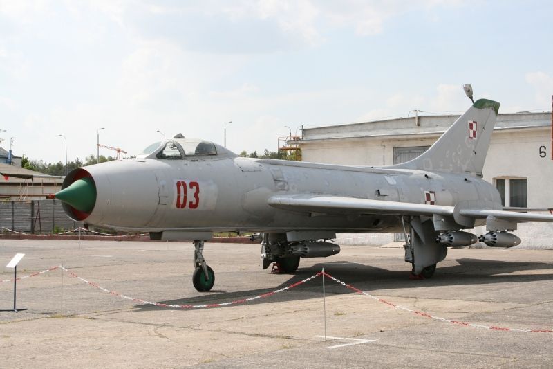

A bit about the actual aircraft. This aircraft was a further development of the Su-7, which was flying around the 1950-70s. The Su-7 had high takeoff and landing speeds, and the manufacturer was looking to improve on these characteristics, from going to a delta wing planform, to trying out a variable sweep wing. The extreme leading edge sweep (around 62 degrees sweepback) of the wing is beneficial for high mach number flight, but is a detriment to low speed flight. Variable sweep became "a thing" back in the 60s, with the F-111 in the US, along with a few predecessor test aircraft (Bell X-5).
After several variants, the swing wing version of the Su-7 turned into the Su-17. Different external shapings of the aircraft caused it to eventually develop a larger dorsal spine that would extend to the vertical fin. The Su-17M3 has a dorsal spine that blends with a nice curve into the vertical fin leading edge. On the M4 variant, that curve is replaced by an additional air inlet and exhaust, which I suspect is used for avionics cooling. There is also a UM3 variant, which removes a wing root gun, and becomes a 2 place aircraft, for pilot instruction.
The notation of Su-17 is used to designate the Russian aircraft ( or Soviet aircraft). This aircraft was exported to several countries (Poland, Hungary, East Germany, Czechoslovakia) - the export aircraft were designated as Su-22. So there are also Su-22M4, UM3, M4 variants. In a few cases the export aircraft had larger diameter engines. I'd suspect the avionics would also vary depending on the receiving nation.
Polish Su-7 (fixed wing)
polish Su-22 UM3 in special color scheme

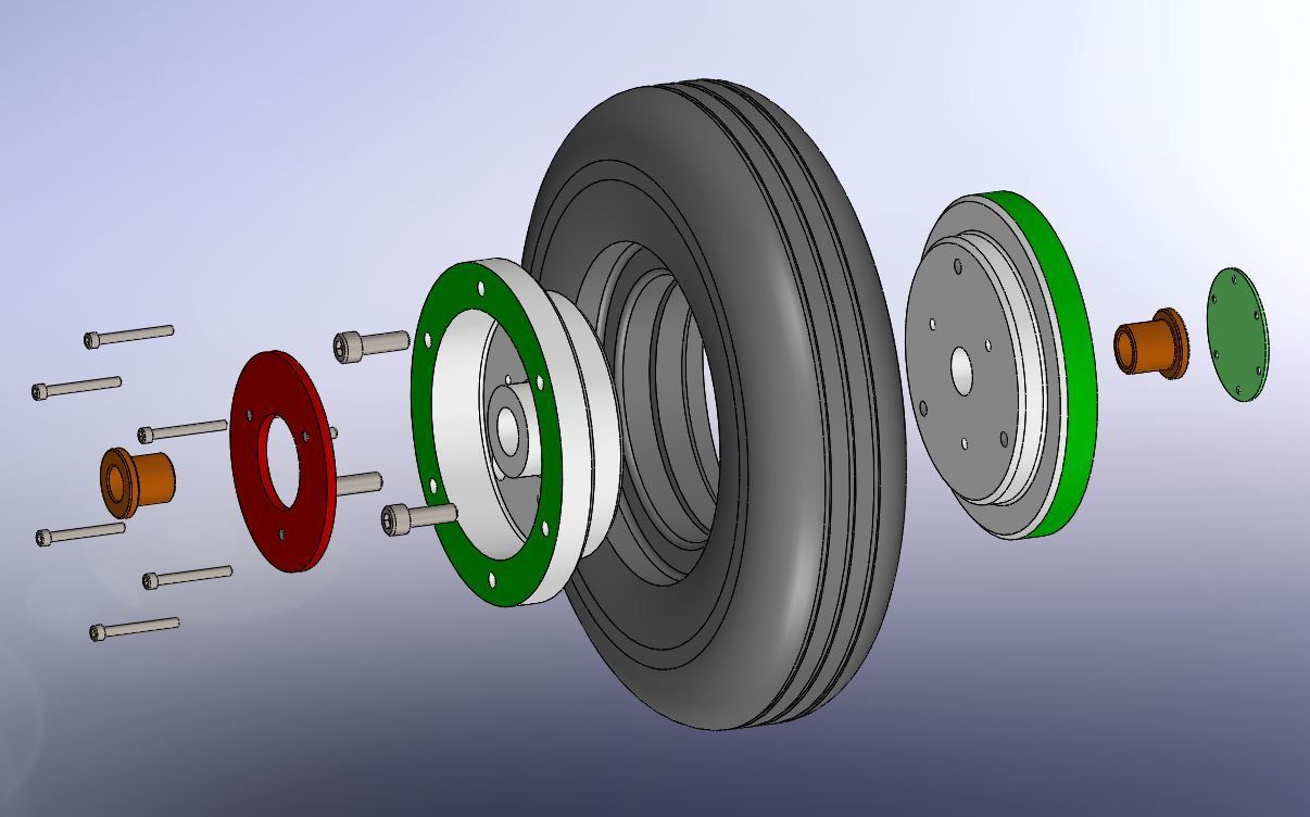

Prelim layout of the MLG. Electron EV-50s installed. The strut and wheel can fit into the MLG bay if I rotate the strut about its centerline axis. A yaw arm was added to do this. If I don't do this, commercial retract unit would not be usable - because the swing angle of the strut is angled in the planform and side views. the retract unit would be poking thru the top of the wing.
MLG wheel assembly. I could not find tires anywhere near the diameter I needed, so I was going to have to try casting them. Great...

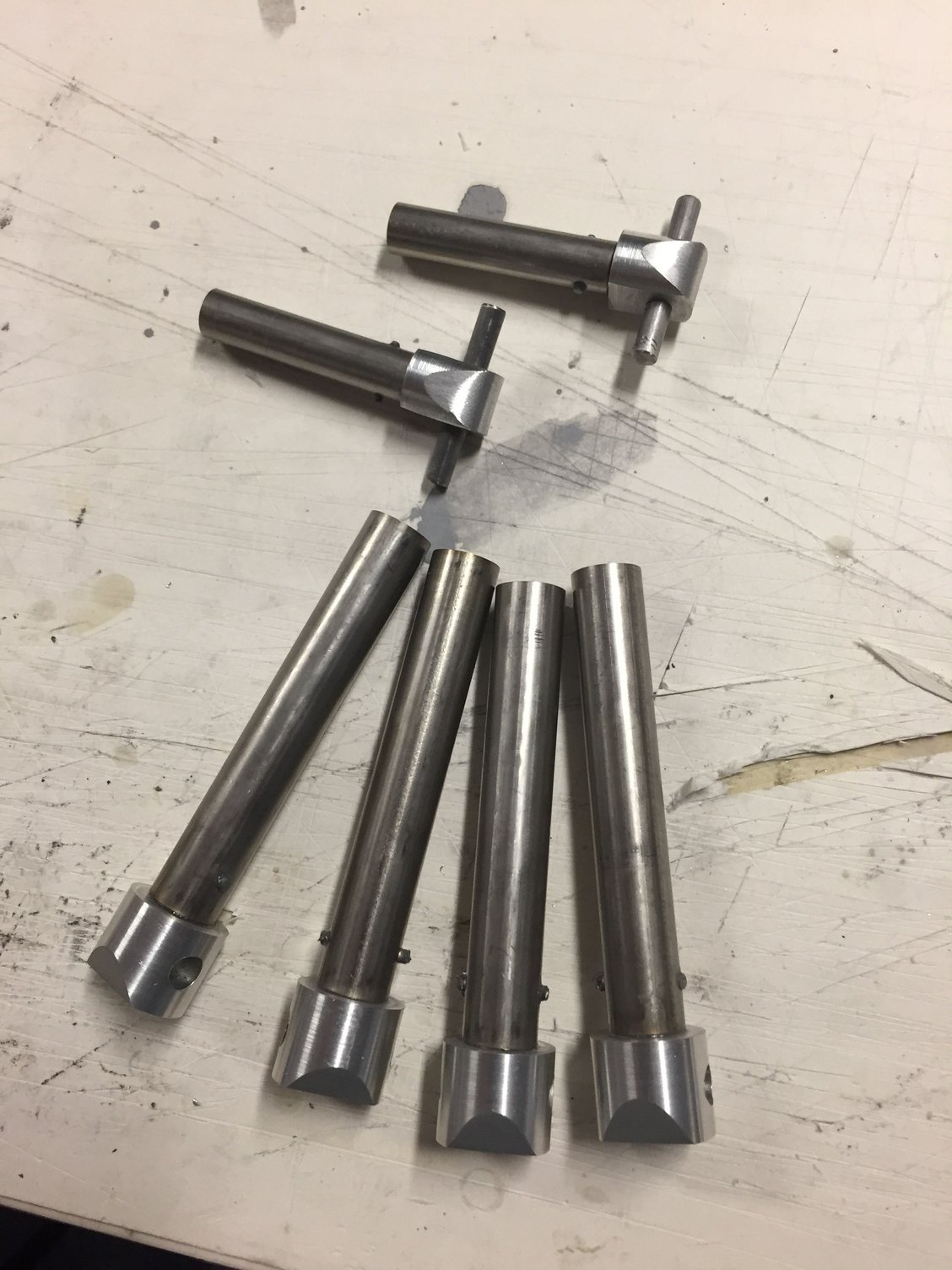

After the landing gear was modeled up in Solidworks, I grew the basic strut parts out of ABS plastic. I also grew a bagel sized tire shape, to eventually use as a plug for the whole tire casting experiment to be done. And I started machining some of the lathe "turned" parts for the NLG. I have a Small lathe, and am certainly not an expert with it, but I was going to try my best with it, and learn during the whole process. I do not have a mill, so any "flat machined" type parts I was going to have to make other arrangements.
Ultimate Jets actually had a perfect sized/shaped Behotec tire available for the NLG, so there was one success. I quickly ordered a few. For the next few months, I started making aluminum chips, ordering more bits and radius cutters, springs, and more aluminum stock. The Aluminum parts were from 7075-T6, and some of the less significant parts are 6061 (T3 I think) - whatever the common heat treat is. If I were to do it all over again, I'd just order nothing but 7075-T6.
At this point, I started describing this build in my JPO District VIII column of Contrails (~ February 2019).
A NLG assembly, and the start of a MLG strut assembly.
Lower strut assemblies, for the NLG and MLG - 2 sets.
Plastic printed (grown) ABS struts, along with machined rims and the Behotec NLG tire. the plan was to make 2 usable landing gear sets for now.
MLG or NLG rims in early stages of being turned on the lathe. Not even sure which is which right now. :-)

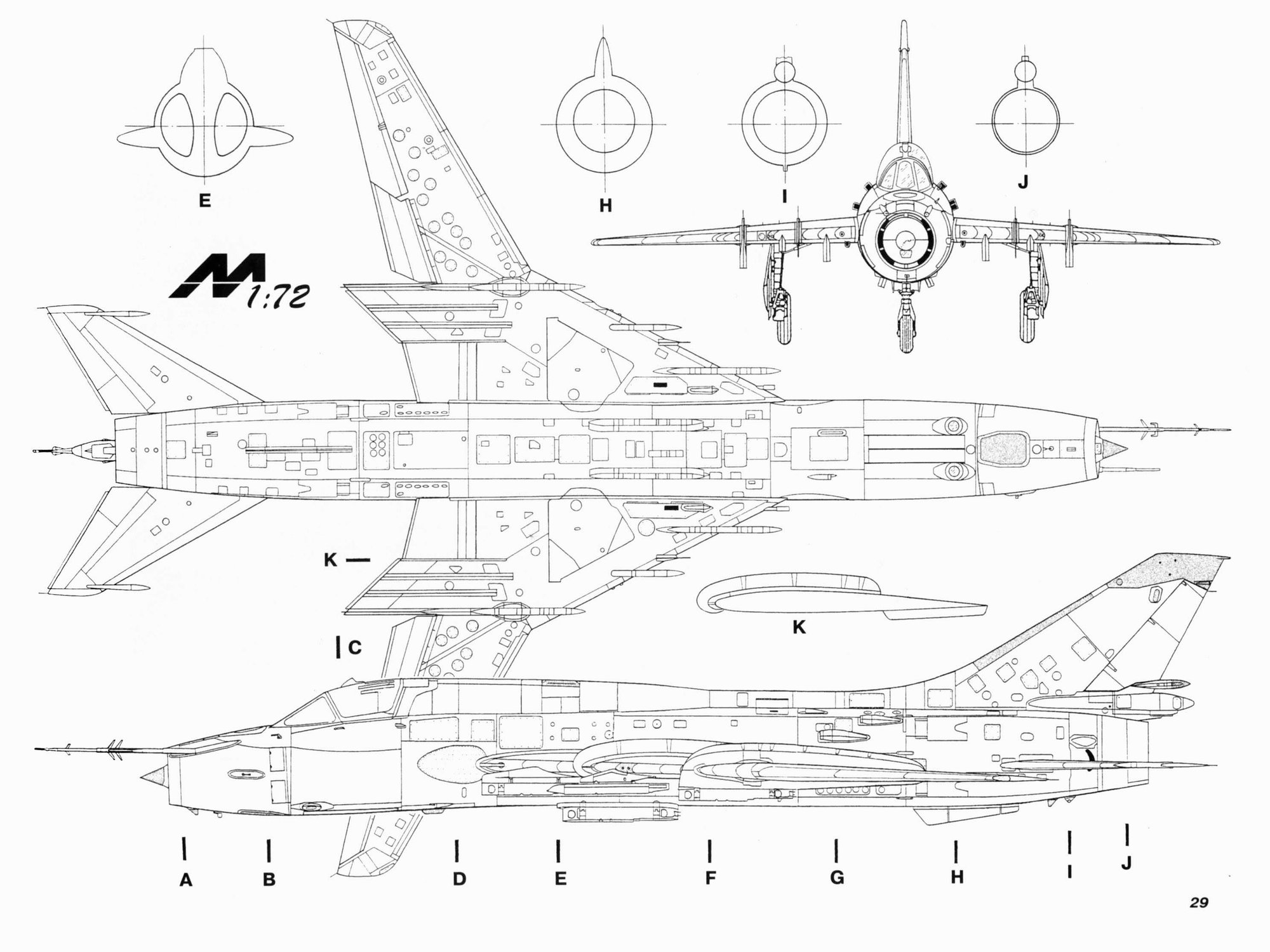

I should also say, when I was trying to figure out the scale of the model, I also started a spreadsheet listing the component that makes up the model, and a best guesstimate of the weight of the item. I did this on my F-107A project from about a decade ago, and it worked pretty well. I wish I had done a better job (spent more time) approximating the weights - there were several items like wing fences, where, you'd think they would not contribute much to weight, but they would... When assembling the landing gear parts, it was evident I would be adding lightening holes into a lot of the chunky parts (rims, etc). Which is not a problem, but I would rather have designed more of that into the gear in the first place.
Also, anything having to do with pylons and stores, I did not keep in mind a contribution of weight to the list. Mainly because I figured If I get that far, I'd be ecstatic. Some of this project began with a bit of a "Ready, Shoot, Aim" attitude. I did not want to over analyze, then decide it could not be done...
Anyway, a 1/6 scale model would yield a size of about 112" length, and a span varying from 65 to 89 inches. I was shooting for 42-44 lbs dry. Always good to have a goal...
I will continue more postings tomorrow. Back to the model.
These are the 3 views I based the model on.
I was eventually able to find and purchase the book these 3-views came from, which is Armada #21, which evidently is a series of books similar to the Squadron book series in the US.
