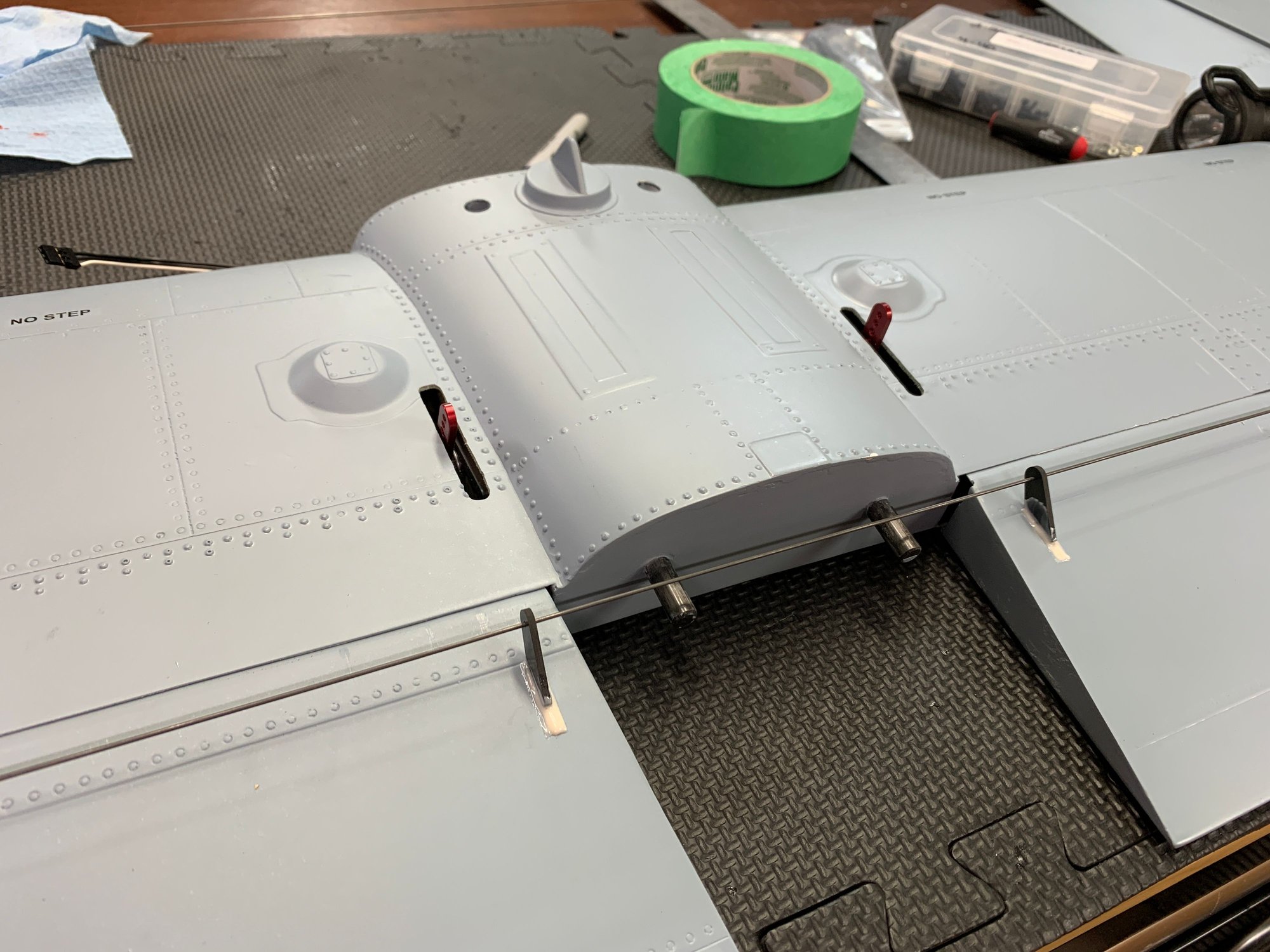

Wing as it comes out of the box.
Overall shot of the wing before Pylons mounted.
Complete Wing gear extended.
Complete wing gear retracted.
Wing going into storage into the SAFE REVOC Bags!

Arm Geometry for Air Brake. Initially setup with a JR Nylon Super Horn but was way too flexy. Switched to 15mm sea craft aluminum arm.
Overall Shot.

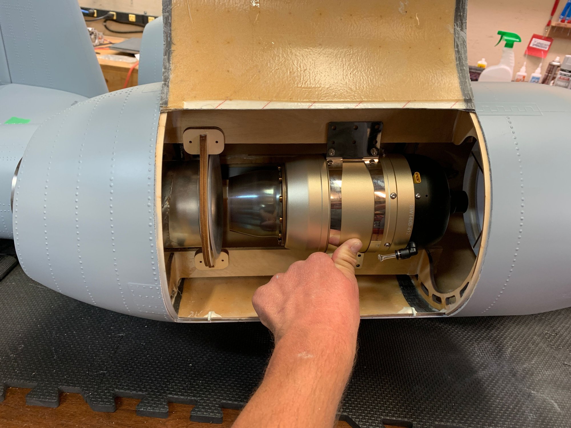

Th
Pip mounted to bell mouth with Rivets.
Short rivets used so wood mount fits over.
Pipe assembly mounted to wood mount.
SWIWINI 140's mocked up
Engine mounted.
Front view
Back View
Overall view. This will all get removed now to paint the inside of the pod.

What weight are the SW140’s? Did you weigh those turbine rails before installing?
I spent ages removing weight from the pods!
Hey Dave.
The Swiwin 140's come in at 1395 Grams for just the engine.
All 4 engine rails together come in at 206 grams (51.5g each)
What engines have you run in the A10?

Jon
Missed the question! JetCat P-130’s. Your rails are lighter than the original ones supplied in my kit, but I made composite rails where all four were around 120g
