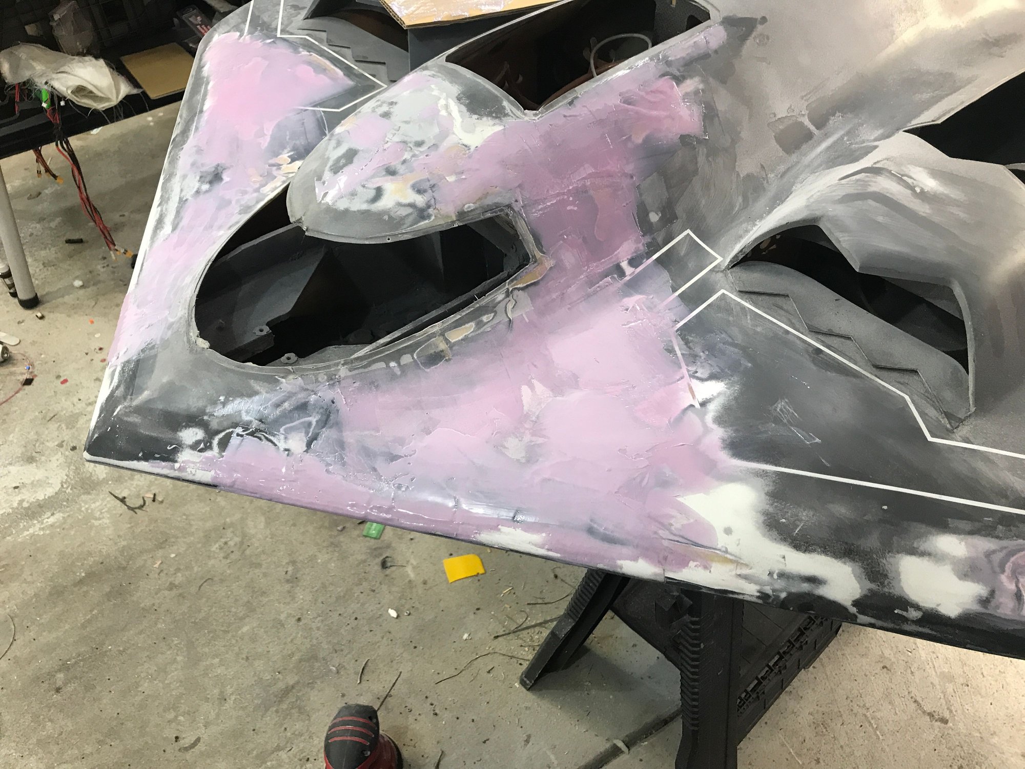

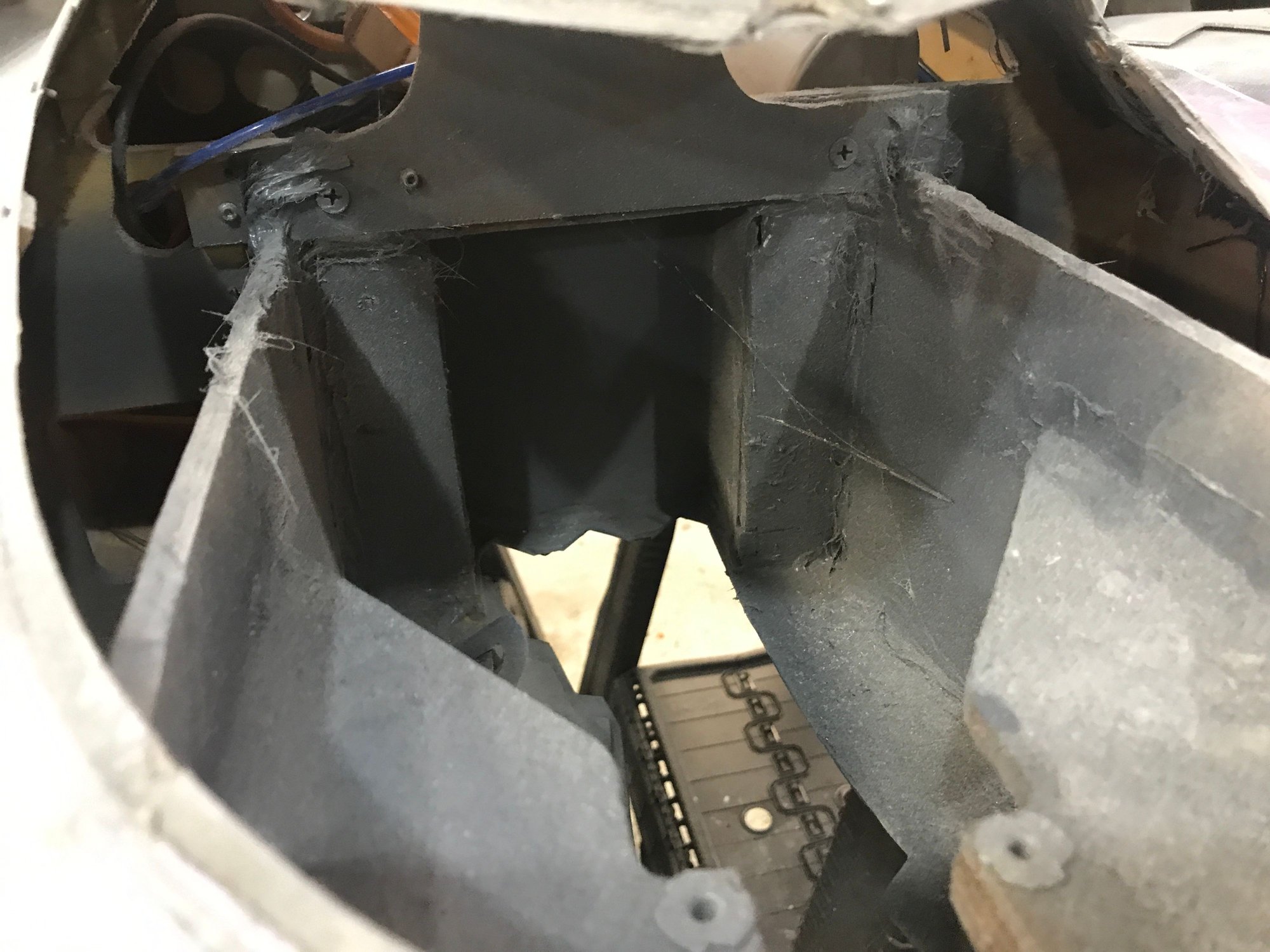

So this is the pictures, I don’t have the pictures from before the repairs, but the plywood formers are new and some skin elements added from carf eurofighter to make it strong straight and light have been used special bondo to repair full scale compost airplanes and plastic materials,

Looking great. Keep posting pics. What is the purple filler material you used?

Just some windows frames, decided to go full carbonfiber and just live the black windows panels this should be lighter and stronger than the original version

Nice work on the repair

Trying my best, the worst thing to make it was the plywood formers and keep it all alignment with the remaining led and the nose to not end up too low or too high, the body is just skin and this could be formed to shape, for now I’m just trying to make it air worthy and maybe later after possible success some more details to make it look more realistic.
