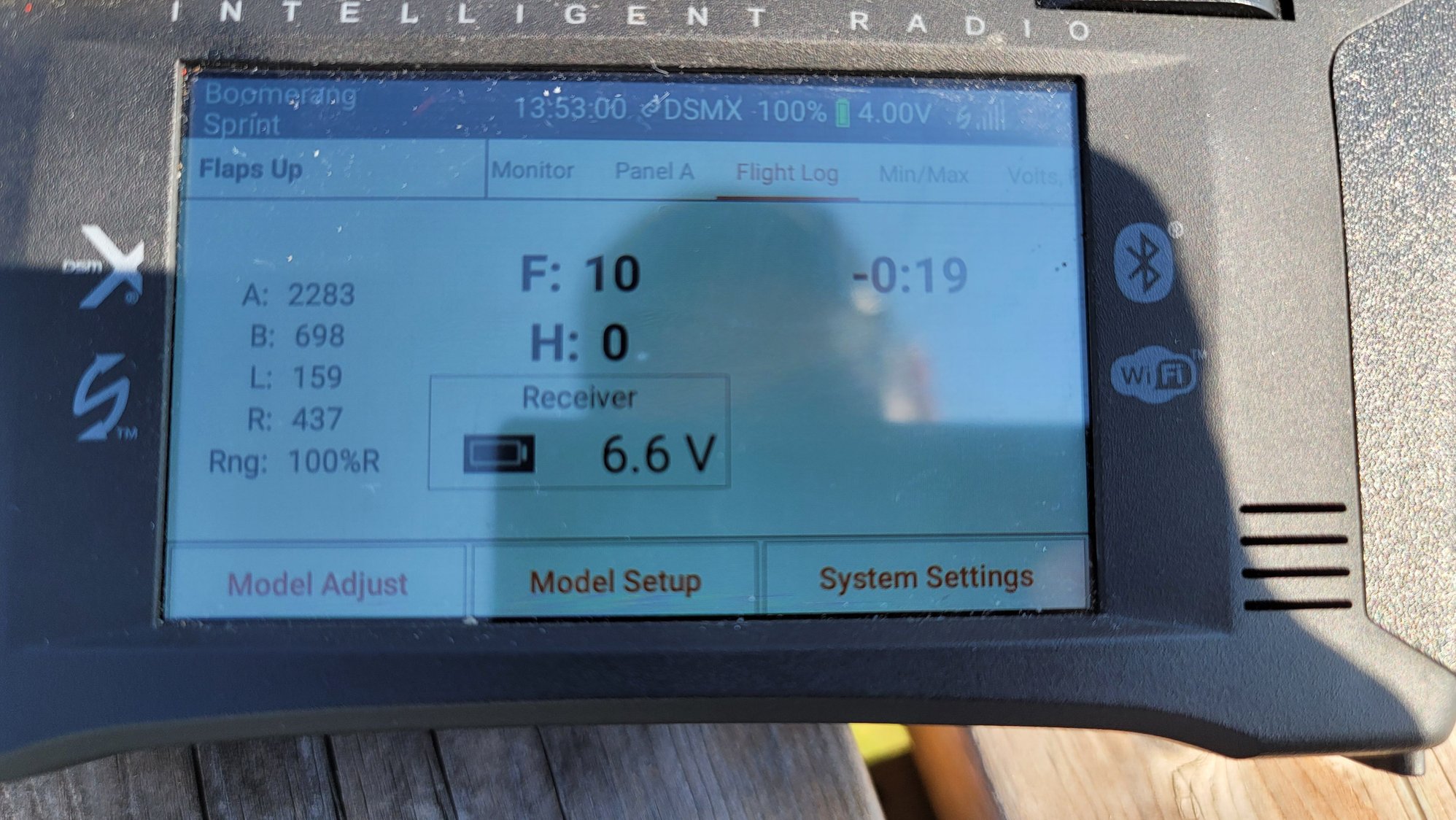

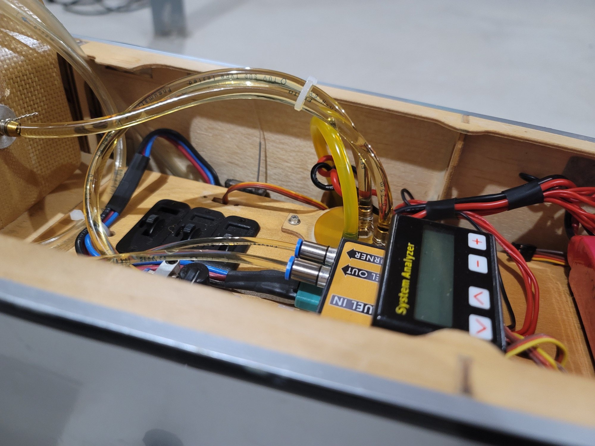

I'm looking for some advice on my setup in a Boomerang Sprint. Currently using an AR12310T receiver with 3 satellites and an iX12 transmitter. My concerns is with the amount of frame losses (Fades / F) and individual antenna fades I am experiencing. I'm wondering where everyone is placing their satellites for best radio reception and to minimize antenna fades. I am also struggling to understand what to do with telemetry as I'm seeing a significant amount of losses on that.
Current Satellite Positioning:
Left Satellite is shown in the picture with the radio deck mounted.
Right Satellite is Shown in the picture with the radio deck removed.
Satellite B is located on the fuel tank.
Image attached below of Frame Losses over a 5 minute flight including taxi.
What changes in position should I consider? What is the expected normal that most are seeing in terms of frame losses and antenna fades?

Change the orientation so there is less chance od the aerials pointing at you/Tx. The one on the tank as you taxi/fly past will be racking up fades. It’s only the tip of the aerial that receives, so turn that say 45 degrees in a plastic tube.
since the tip hatch is hollow. Put the vertical aerials above the split line, so they are into the hatch void. Get the telemetry aerial away from all that wire!

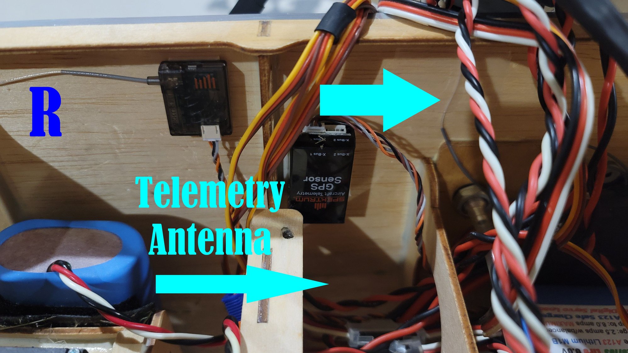

First off, the telemetry antenna is blocked by all the wiring near it. But the plane will still fly even with no telemetry data making it back to the Txer. However, if there are spurious emissions going on in the adjacent wiring, the telemetry antenna can also pick that up causing other RF issues.
The two remotes that are out in the clear look OK and those are probably giving you an appropriate # of fades. You did not tell us the ID letters (in the Pics) for the various remotes. So it is impossible for us to figure out which one has what # of fades. But I have a couple remotes just like that in my Sprint. However, they have the old antenna design.
Lately, it is NOT unusual to see 400-800 fades in a 6 minute flight. The one on the tank is probably not working well. We typically do not put them on the tanks. However unless there is Kevlar or carbon fiber embedded in the tank this location is typically not a problem. But, as previous stated, it should not be pointing at the Txer. But on the top of the tank is a great place to put a mount and get the remote up in the clear under the canopy. I probably would not have it horizontally polarized as you already have that covered with one of the other remotes. I would get it at a 45 degree angle up and not have the end pointing at the side.

Also I don't like to mount antennas close to other electronics (I like >3" away) and one of your pictures showed a remote right next to a GPS unit. I'd keep a bit farther away from that too..

Hi All, thanks for the replies.
Dave Wilshere, I will try and change the positioning of the antenna on the tank. I do believe that being this close to the tank is causing issues as well and as a result I'd like to see how I can get it further away. I don't have any room to get the antenna much higher as the tank is near max height. Is there a better spot for a remote receiver in the rear of the fuselage? Do you have pics where you mounted yours?
As far as getting the vertical Left satellite antenna in the image higher or above the parting line, this may be difficult too as the cockpit is right in this area only leaving me with about 3/4in to play with. I'll take aa looks and see what I can do.
I'll move the bottom telemetry antenna, just not sure where to. The fuel tank is huge and the antenna is not long enough to get around it. Keep in mind the deck is off and the wire seen in the image for the top/upper telemetry/antenna would be under the deck when it's fastened.

field0455, I only mentioned B, L and R as the A antenna is the telemetry signal only. I've shown where these are within the pictures. Will see if I can move the antenna further away from the GPS.
