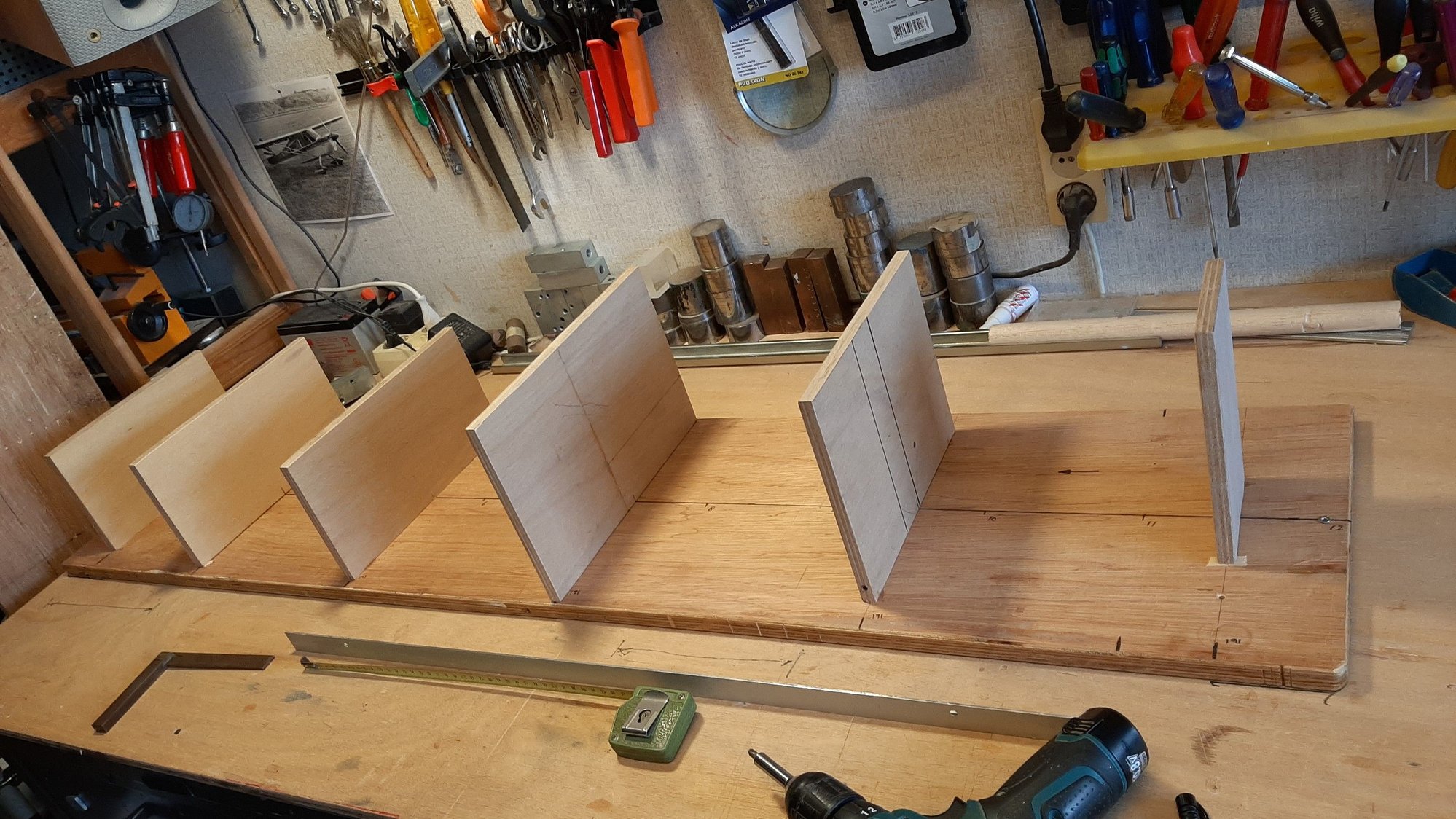

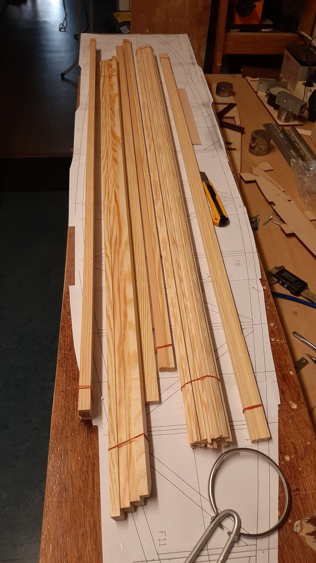

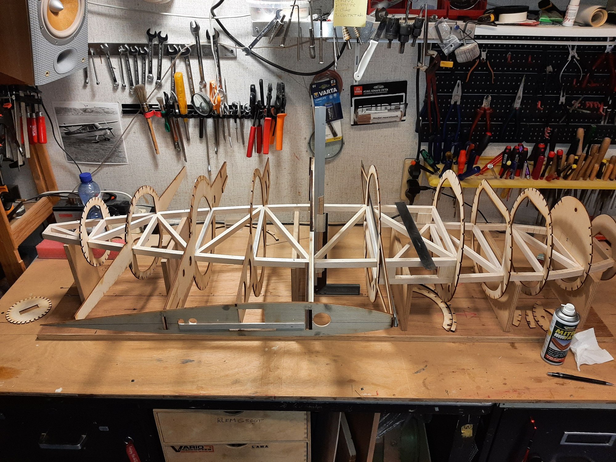

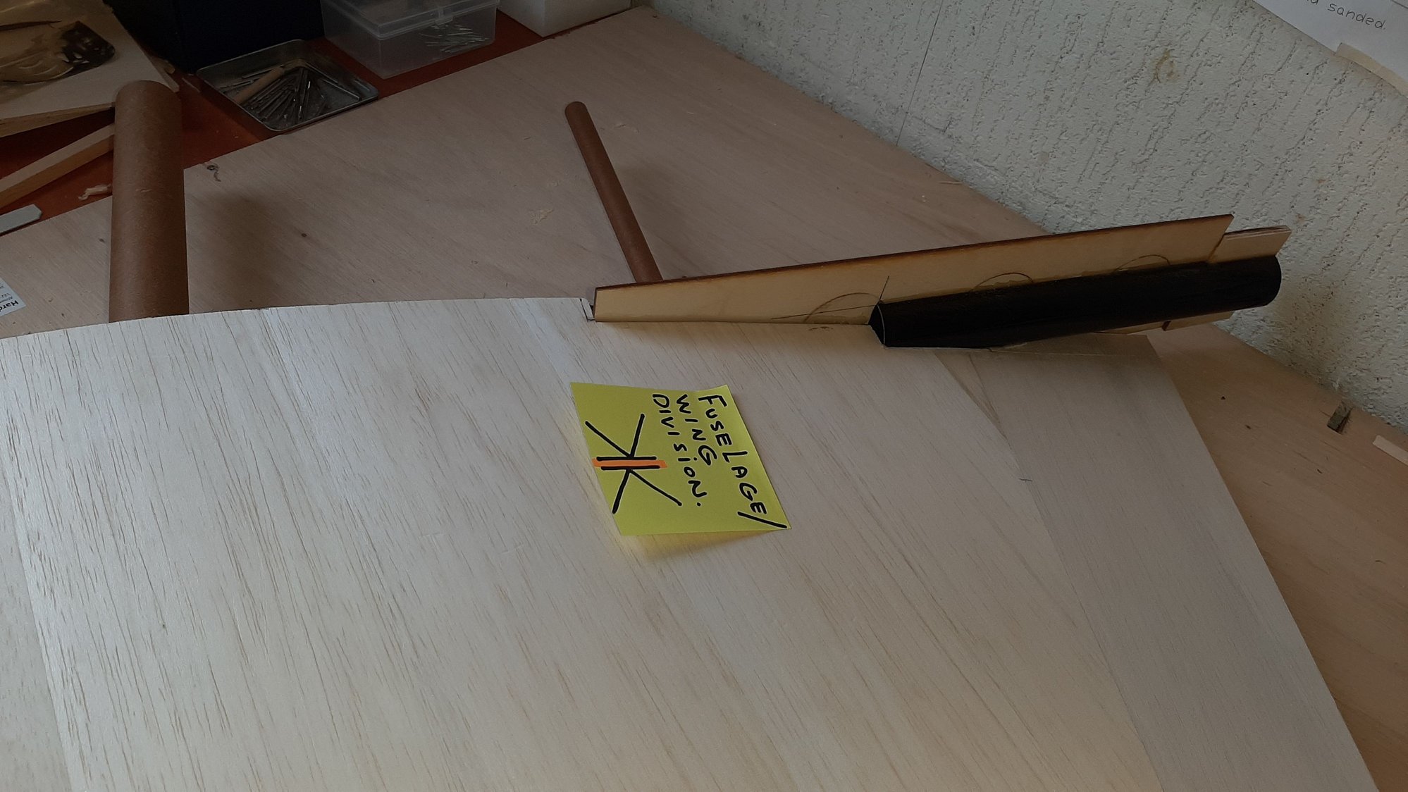

Hi everyone,
I'm building a 1/4 scale Vampire DH-100 from K. Sterner this winter.
I will post some pictures of the build in the coming months.
With best regards,
Cesar.

Originally Posted by redcesar View Post
looking good! I have been building mine on and off for the past five years, I have the build on this site.Coukd you pleas tell me were you got your marking from?
thanks
Jerry B

Hi Jerry,
I have the remarks from https://callie-graphics.com/
Regards,
Cesar

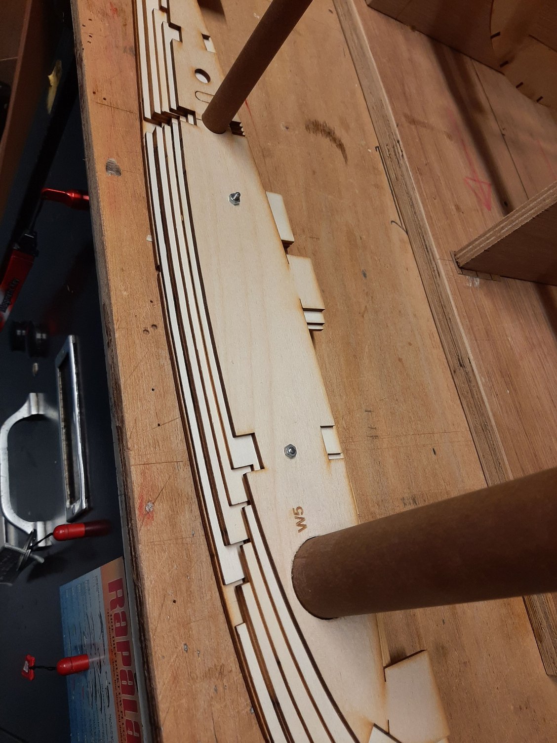

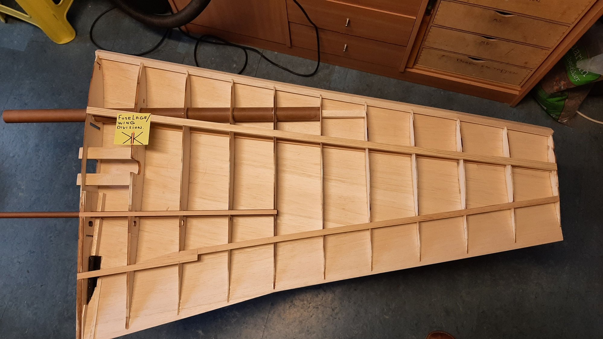

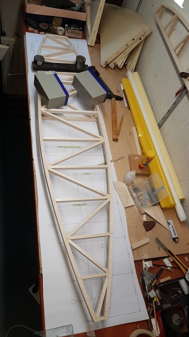

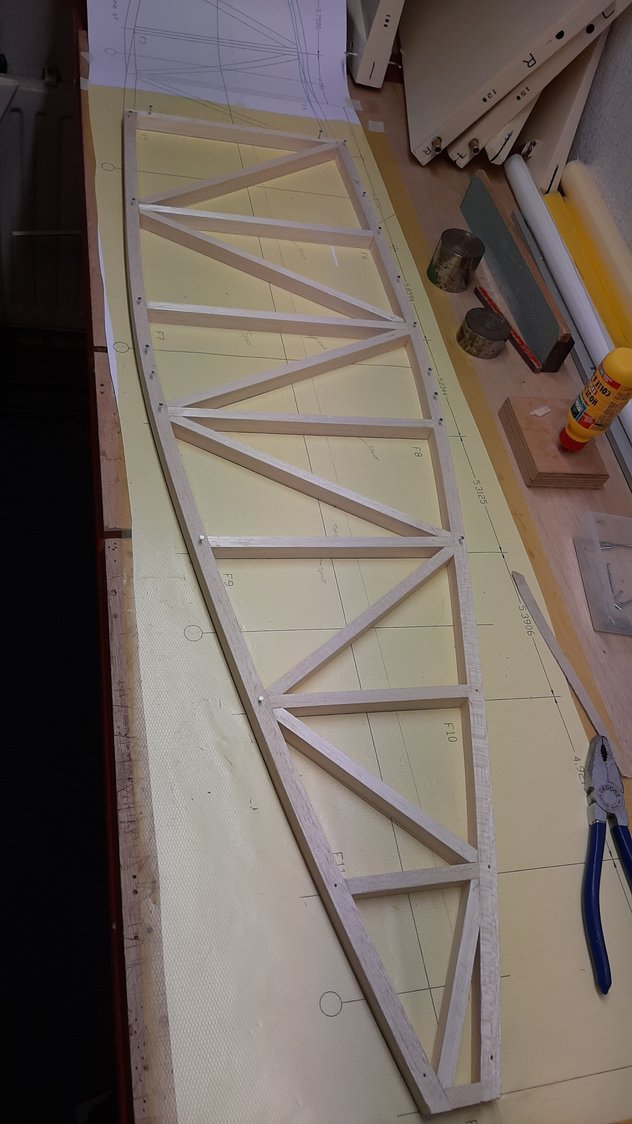

The wing panel without the jig feet.
Cesar

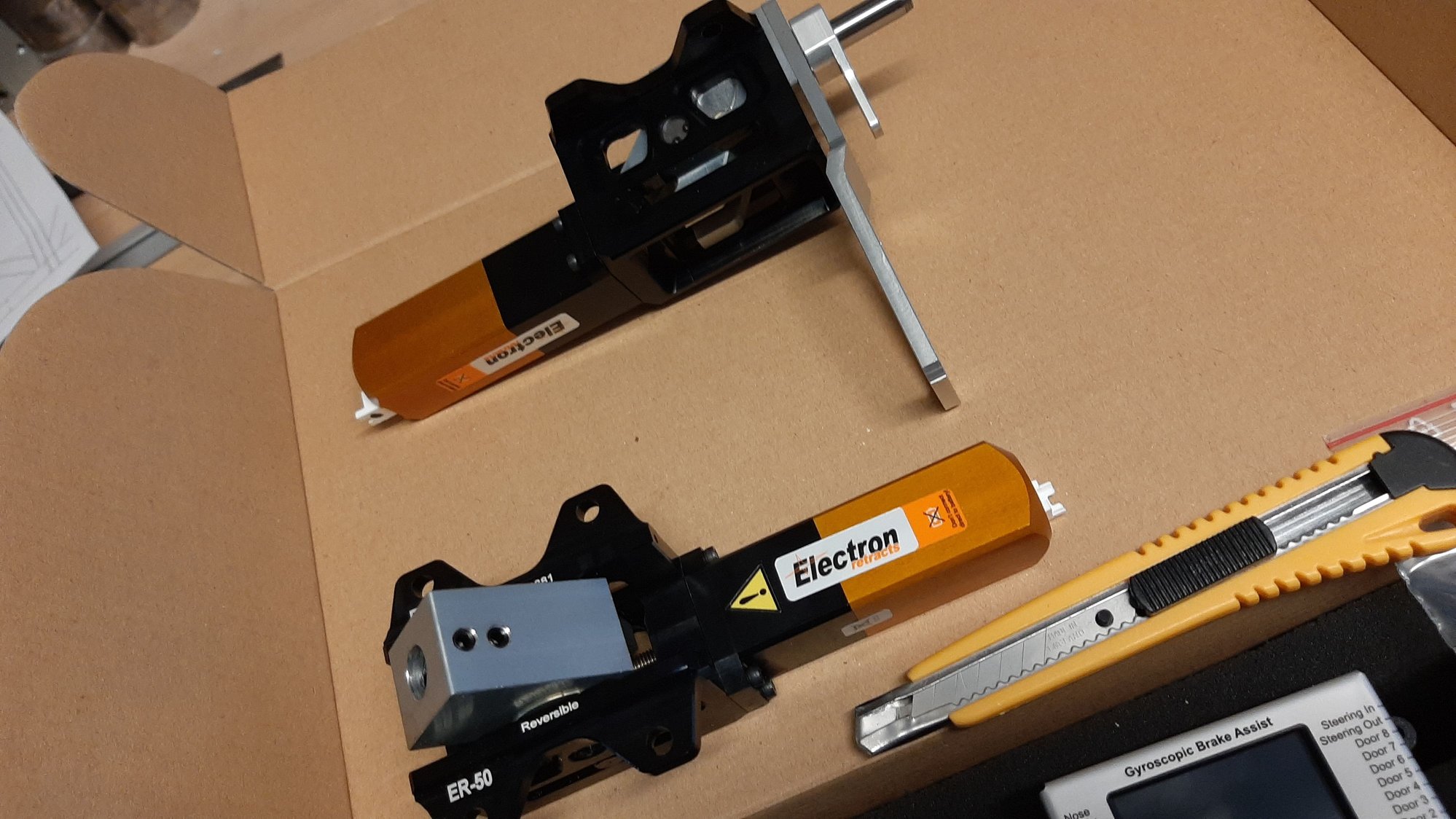

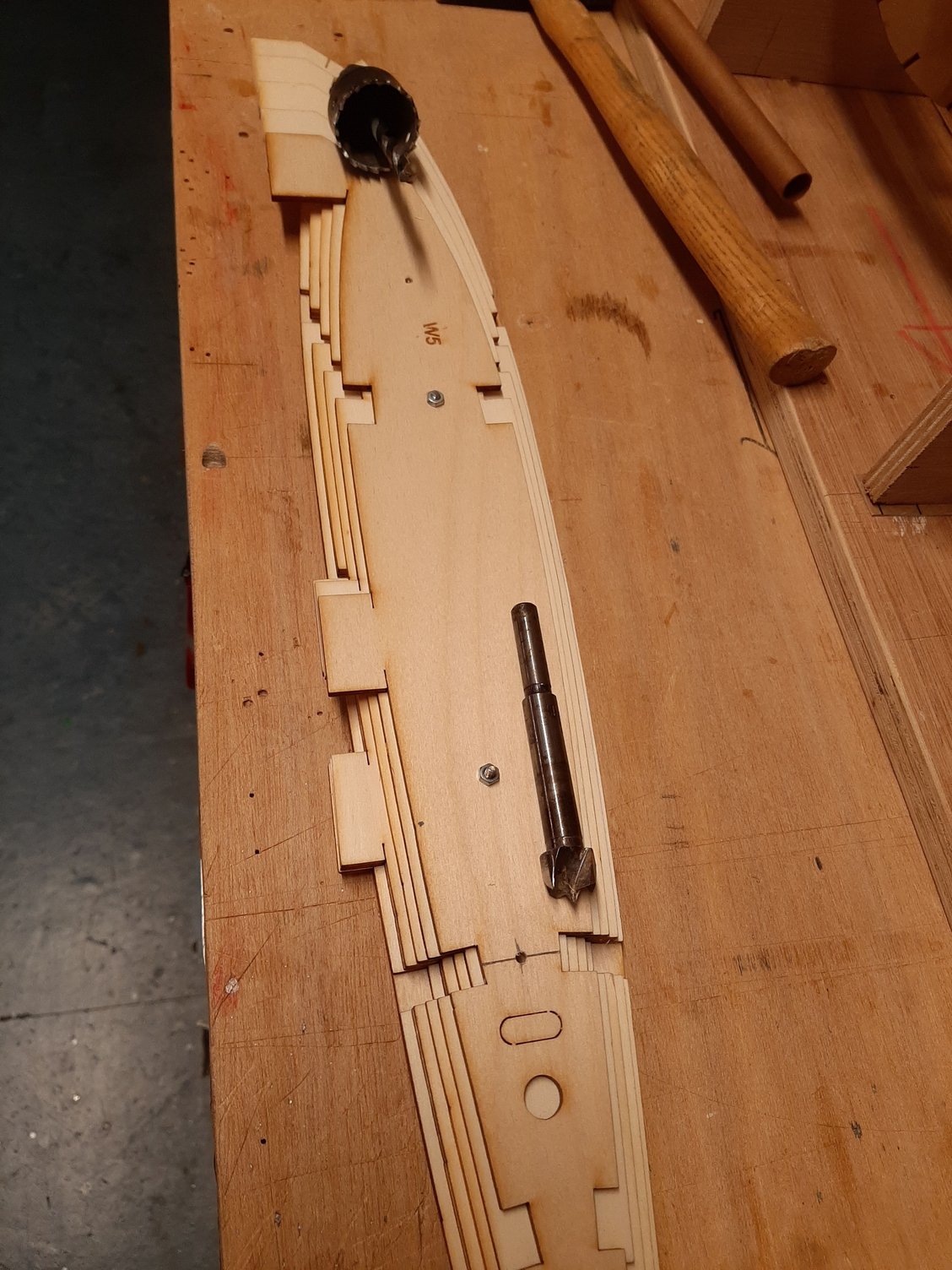

All servos mounted in the wing.
Aileron
Geardoor
Airbrake
Splitflap.

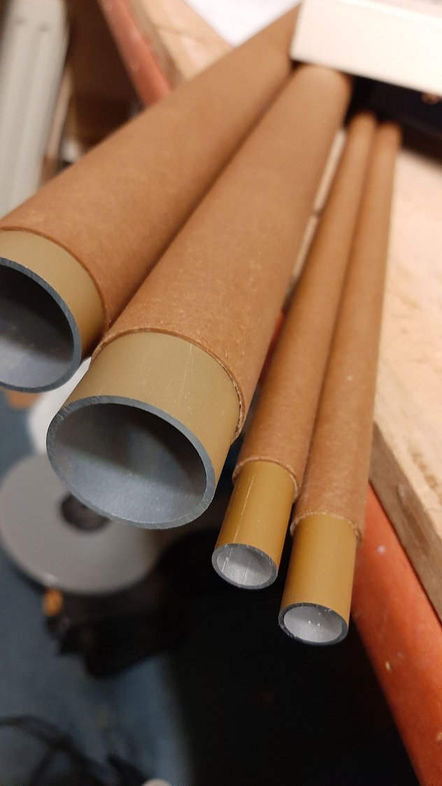

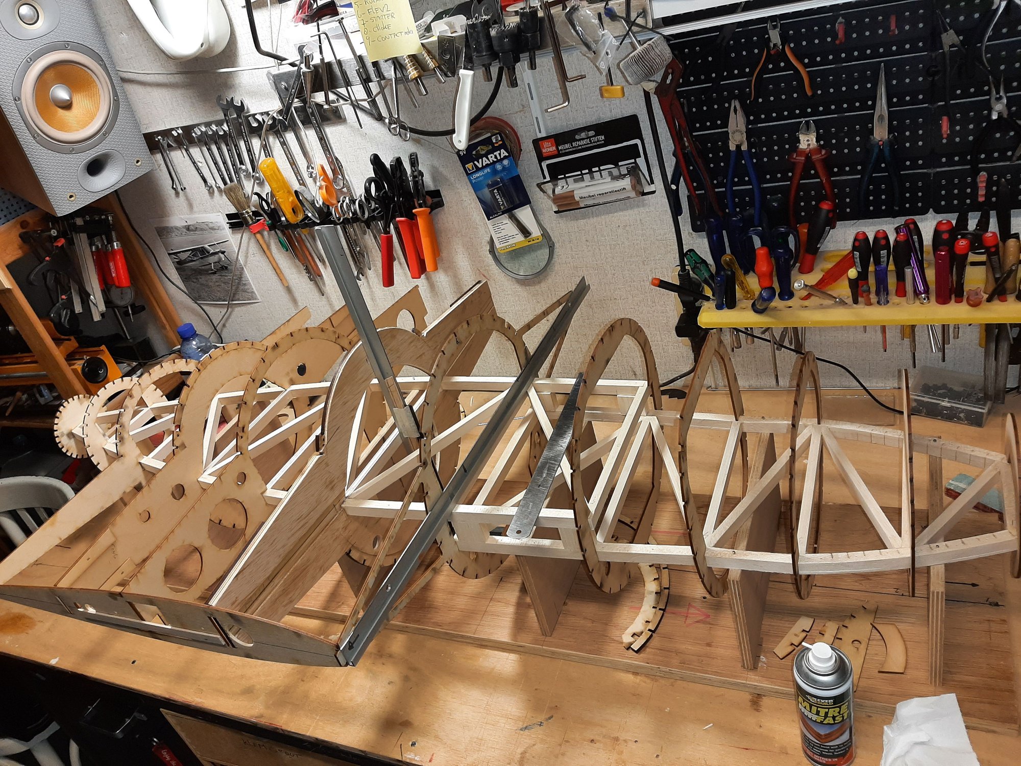

Removable tail construction for easy transport.

Old 12-29-2021, 04:18 AM
redcesar
redcesar's Avatar
Join Date: Jul 2005
Location: Rotterdam, NETHERLANDS
Posts: 322
Received 6 Likes on 4 Posts

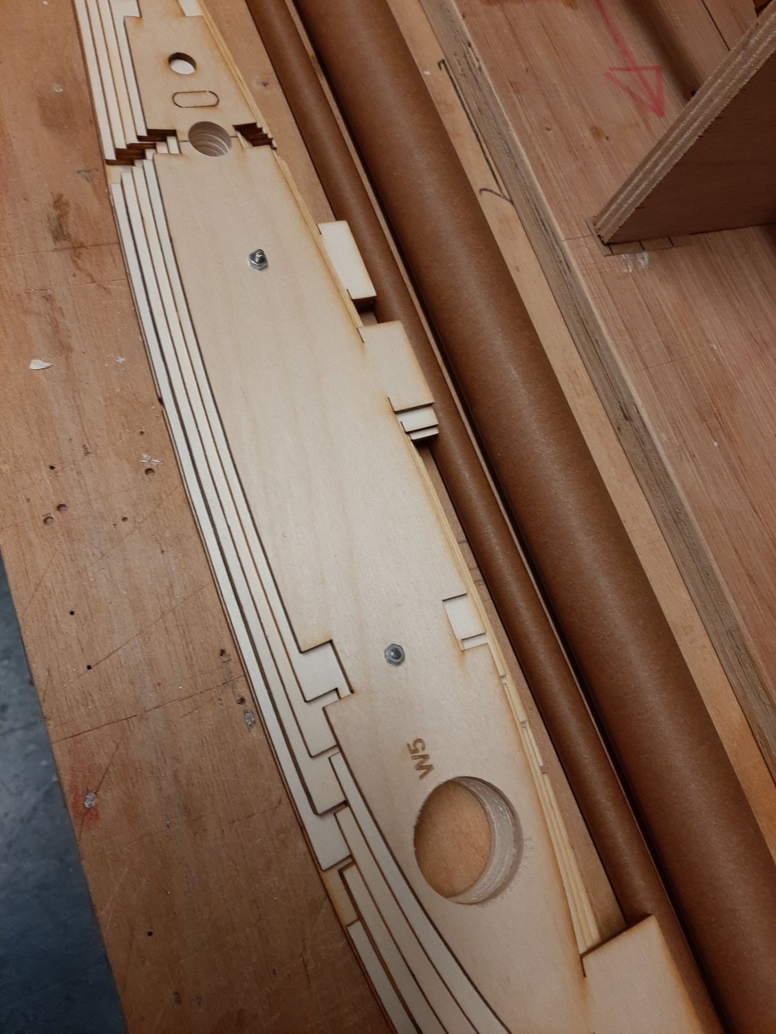

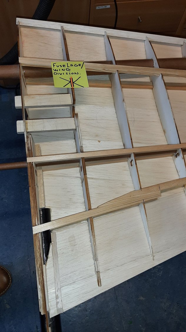

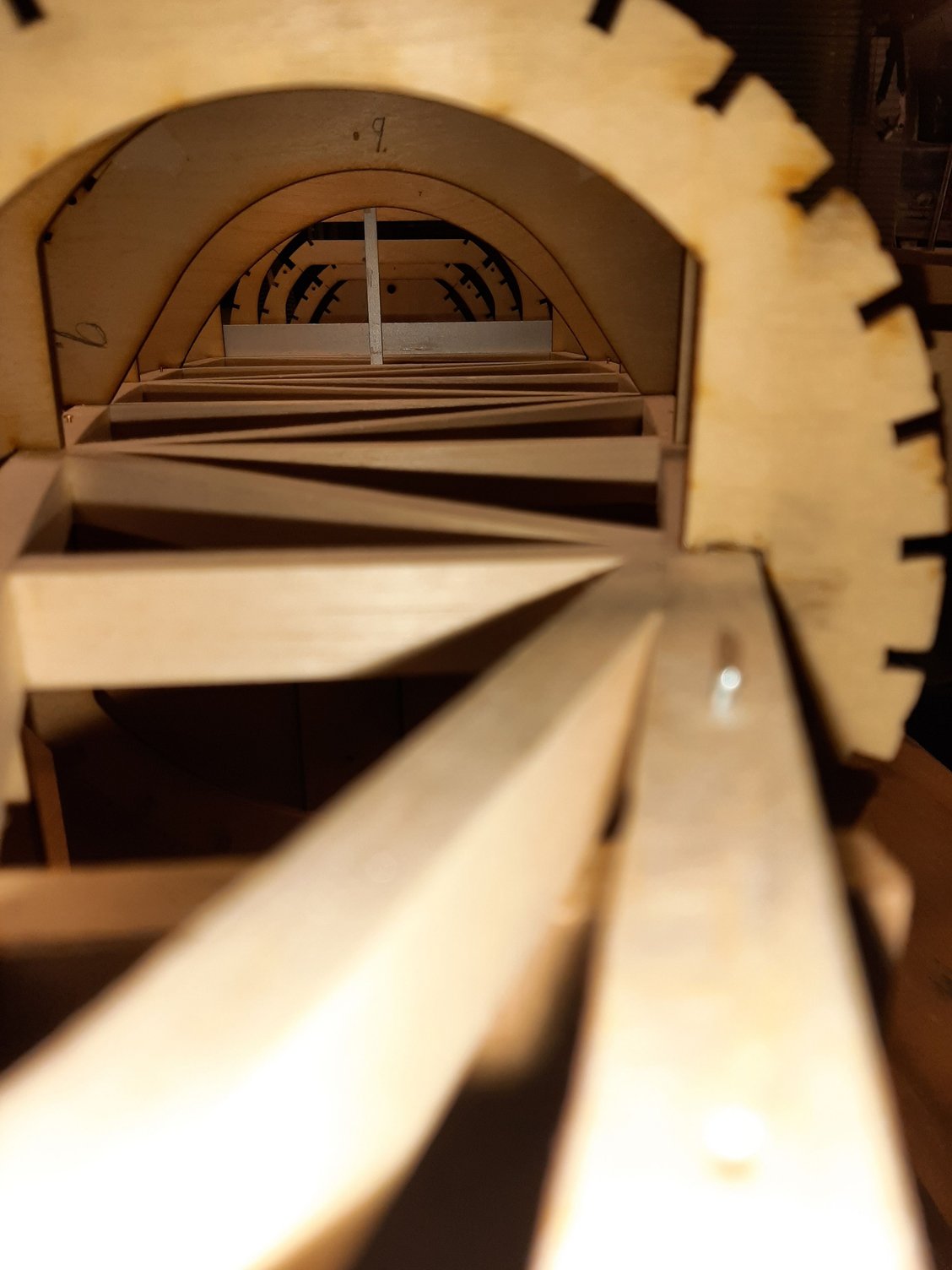

I also moved the dividing seam of the wing closer to the fuselage.
If you build according to the drawing you will get a hull width of 1.75 mtr. That is impossible to transport in a European station wagon
New dividing seam gives a hull width of 90cm.

Rudder and stabilo.

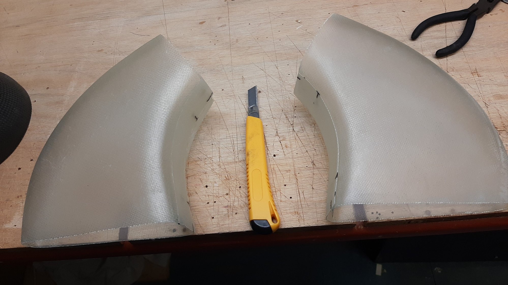

The Airintakes..
