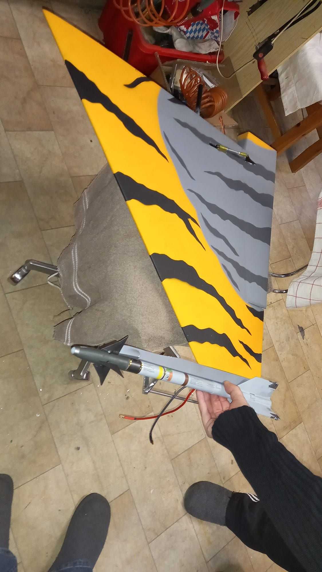

Hi huys,
Did a testrun and wanted to show the 1/6 Sidewinder with electric smoker unit. It will get new launcher and find its place on a 1/6 skymaster F16.

Yes its the smoke el duo system. Tank and pump in the fuselage, and one evaporator per missile, L and R wingtip each.
The missiles are made of a special high temp material to cope with the hot tubes and not burn up.

Yes, the Smoke EL stuff is pricey, but i consider it quite good also. It can be turned on and off at any time, while a cartrige burns off uncontrolled and cannot interrupt. The smoke output is also fairly realistic compared to the Smokewinders installed at airshow birds. Operational cost is also a lot lower than smoke cartriges, so if you intend to smoke a lot then it will pay off over time.

There is an explicid warning not to run the system dry, and at each power-up a primer sequence is mandatory that ensures immediate oil supply before even heating up the elements. Follow the instructions and install a tank with enough volume if you intend to smoke longer, and then you will be fine. Its like everything else in the world: if you dont follow the instructions you wont be happy with what you get.
Mounting inside the missile has no disadvantages so far. Ive noticed a little less energy consumption because the heat is contained better. You do need highly heat resistant materials, but with what is used there are no issues.

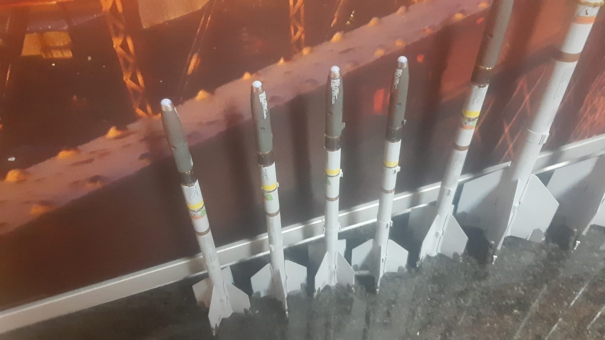

Ive also made a set in 1/11.5 scale for my Freewing/Lanxiang F-4. They are too small to smoke though....1/6 and up in the Sidewinder body. I will start working on a Sparrow and AMRAAM, they will be large enough in diameter to provide smoke at around 1/7 scale and up.
