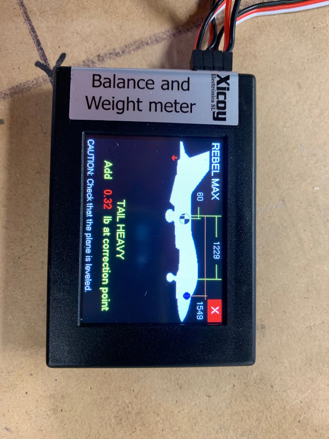

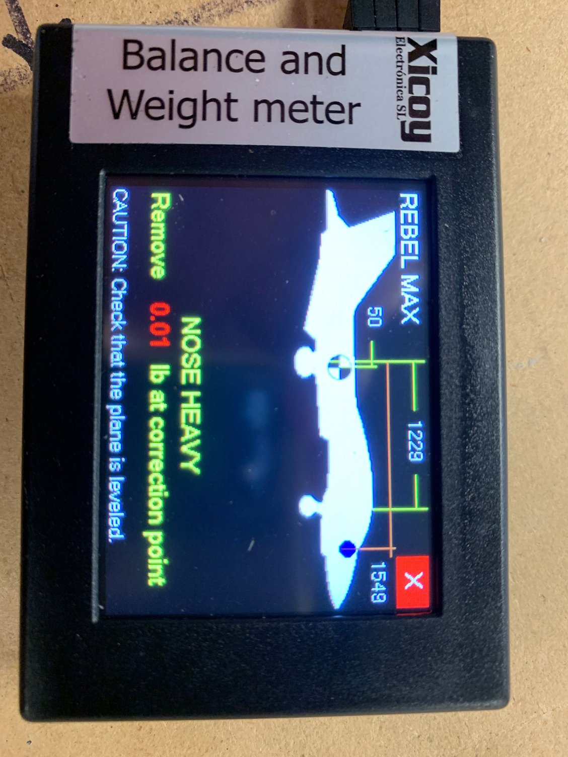

Ok, so CG is done. I ran it at exactly behind the wing tube showing a tad tail heavy. Ran it 10mm back from the wing tube and I am on the dot. The whole fuel cell is forward of the CG, so there is that. When I had my Rebel Pro, I ran an old JetCat P-200 for 10 minutes and had 1/3 of a tank left after landing. This has a JC Mammoth 250, so I imagine the same will happen.

Did you do the balance with some fuel in the tank?
The max will need more power longer than your Pro, so don’t be surprised if flight time is not as long! Although it’s lightly loaded there is a lot of aeroplane to get going from slow flight.

I will maiden mine at 5mm behind the wing tube. Had to move some items around to keep ECU battery under 24" from pump unit. Should get this bad boy in the air in the next few weeks.
