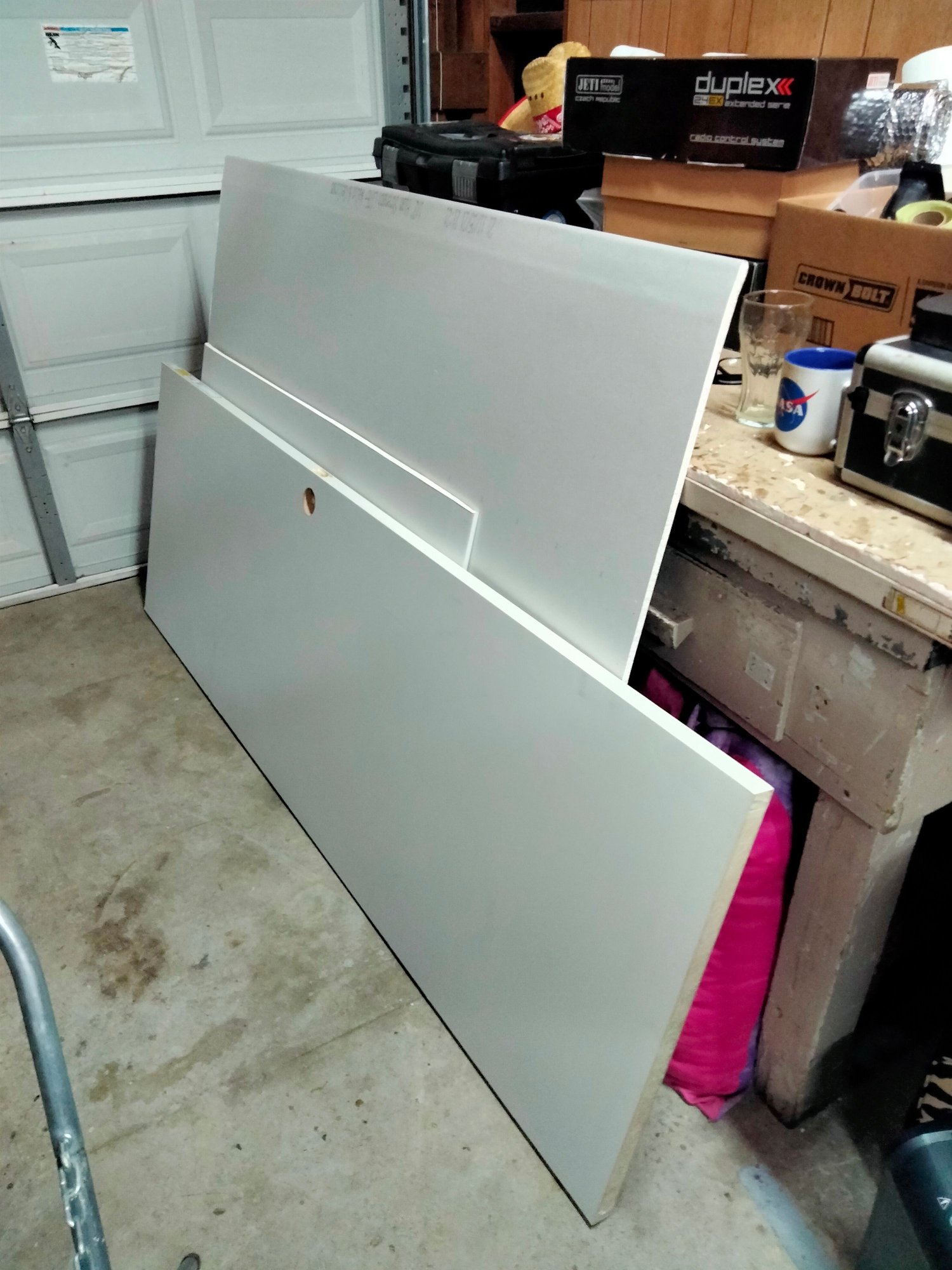

I went to HD to get me a new door and a sheetrock for the build, I will be doing a spring cleaning/inventory on all my tools, glues and all the other stuff, time to consolidate again 😳
​​​​​​Paul (JSF-TC ) contacted me, he has a short kit with some of the parts needed to complete the jet, I'm getting this kit from him soon and this is the kit that I'm building, the build will start in about two weeks, the plans were shipped today from Nick Ziroli and should arrive next week.

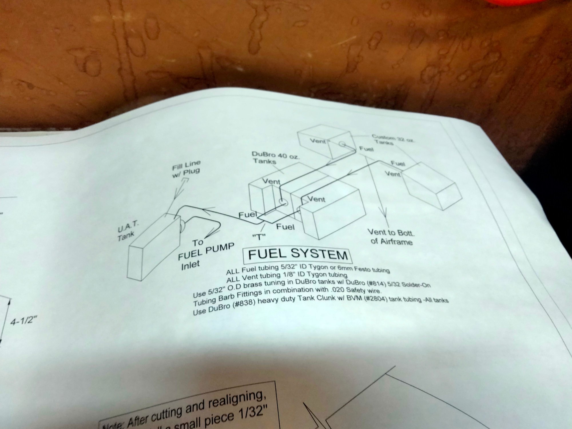

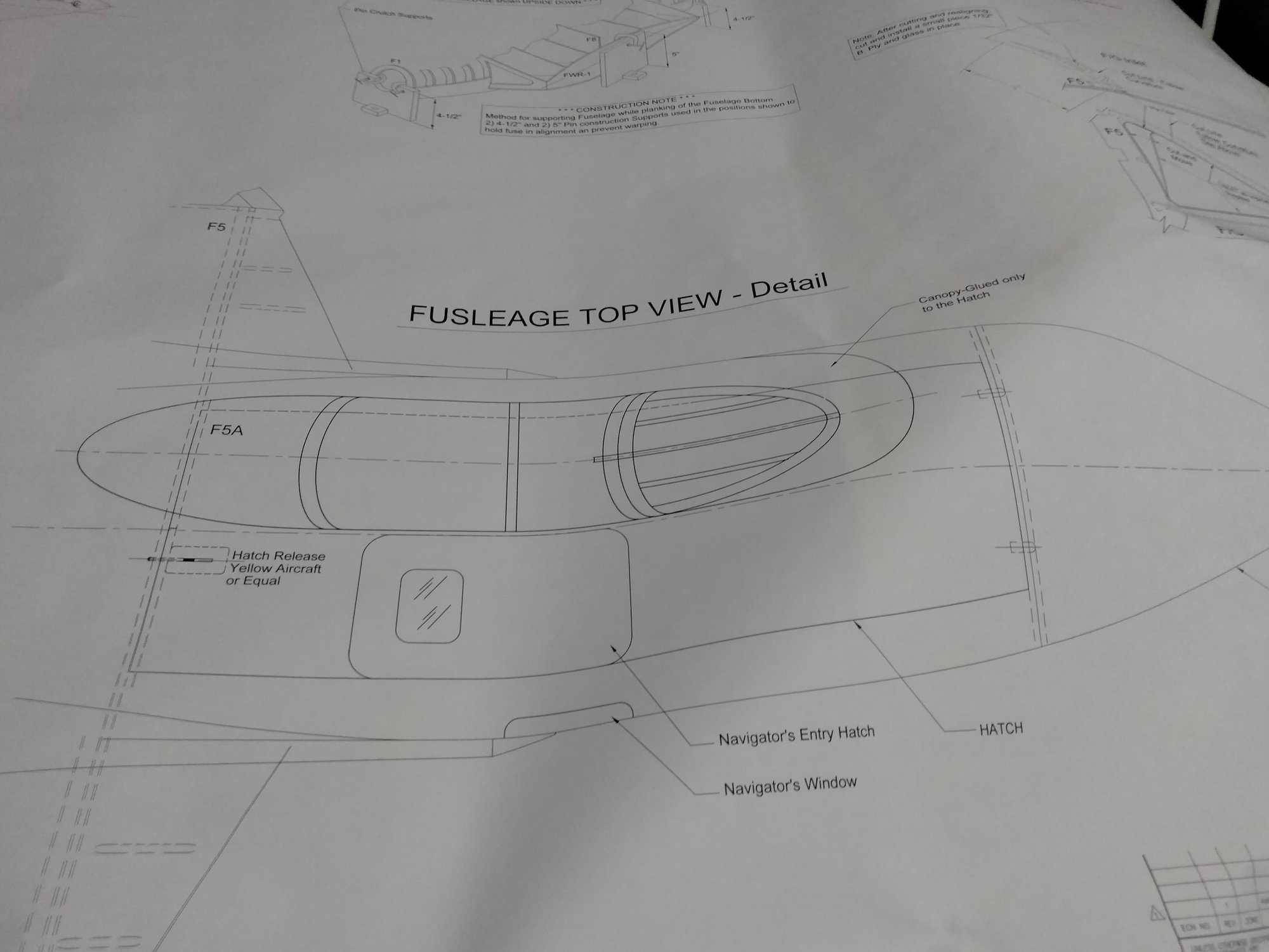

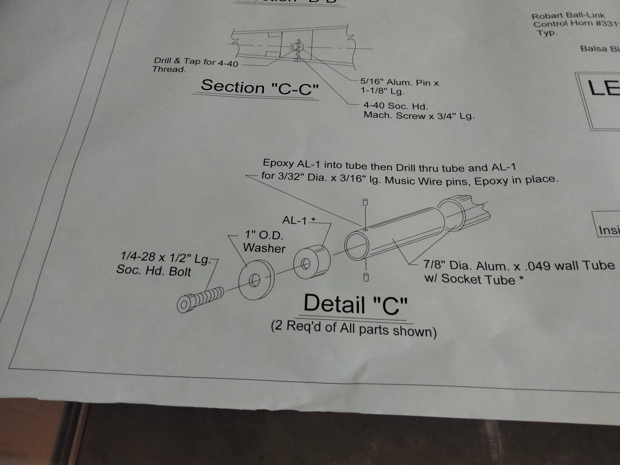

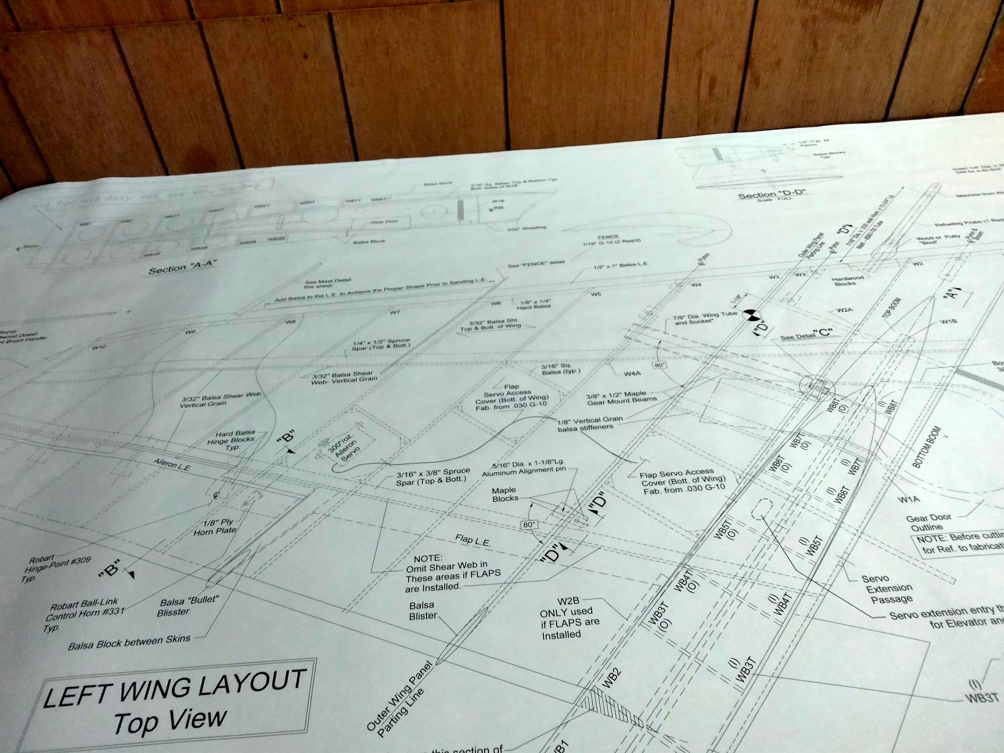

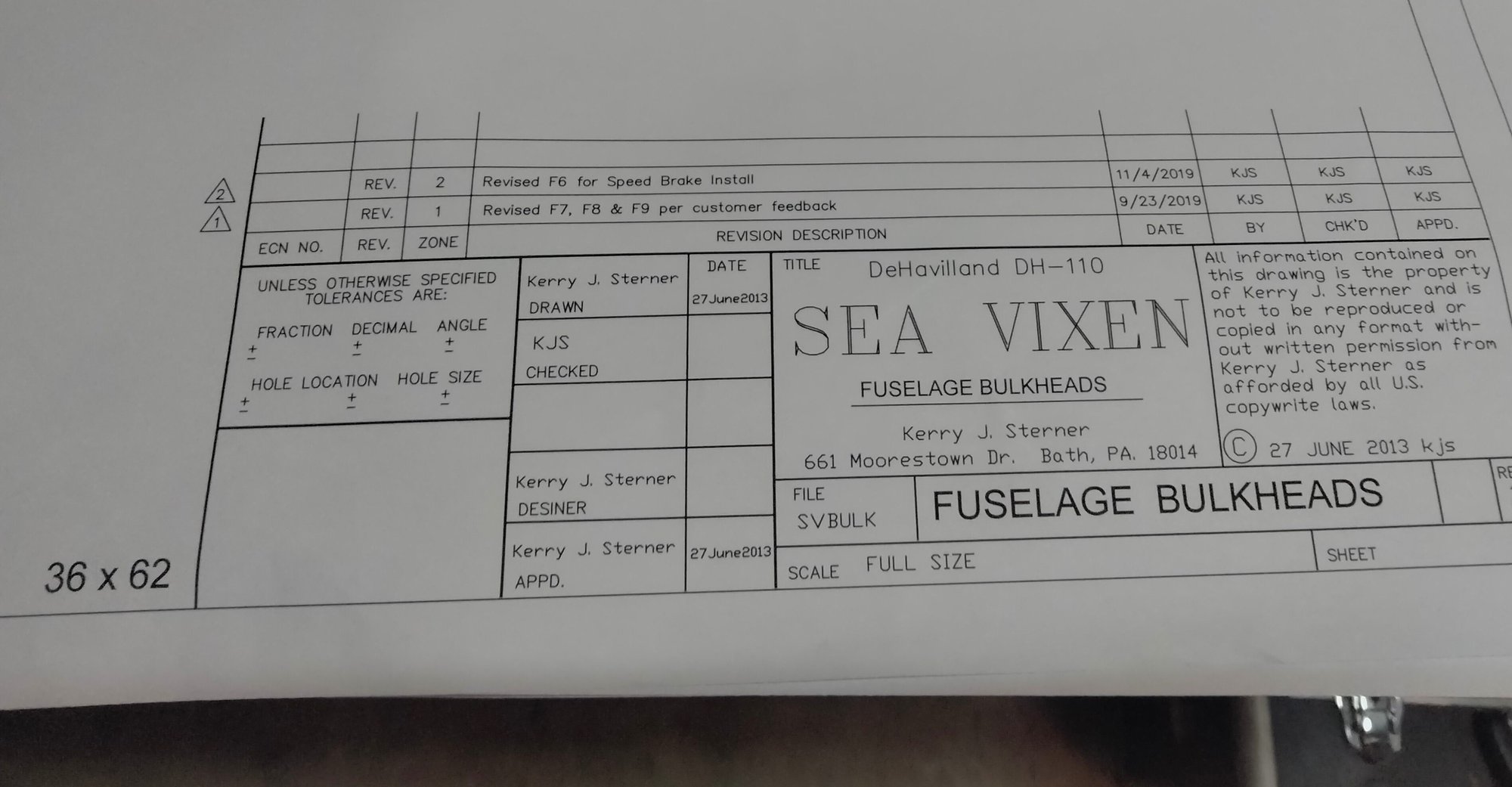

I had a chance to do a quick review of the plans, they are very clear and have lots of details and notes, Kerry has done a super job creating these plans.
The thing I was most interested on was to see if they have been recently revised and YES! they were revised by Kerry S. in 2019, he also added one or two more sheets for the V2 booms and the air brake, all this came about because of Dave B. and Chic, Mr: Straner worked with them to come up with the new revisions.
Now it's time me to study and understand the plans, read the instructions and start formulating steps and mods to be added, I will be doing that next week.
Right away I've decided to reinforce the gear ribs and gear mounts, add a second servo to the elevator, build a different wing locking mechanism and few other small things, all of these changes will be internals.
