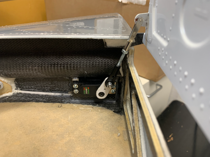

Default Wing Servos Mounted
Finally getting around to posting some shots of the servo install in the wings. Needed to sand the servo mounts a bit to fit my 8911 servos. My flaps will operate on XBUS while my aileron servos will plug into a standard PWM port on my receiver, which is the JR 16BPX -Hybrid- w/ 16 XBUS ports. This may be controversial, but I had to drill a hole in the wing former to get my aileron linkages to reach the horn. I managed to drill the hole big enough for the linkage to pass through without compromising the former. There is no workaround for this, the former must be drilled or notched for the linkage to reach the horn. I think CARF should consider a design change in this area for future kits. Currently working on mounting the nav light on the wing tips.
Left wing control surfaces removed
Left aileron mount
Left flap mount
Brass rod hinge removal point
Left aileron linkage 1
Left aileron linkage 2
Left aileron linage passthrough hole
Inside shot of the flap servo
Left flap servo (mounted) 1
Left flap servo (mounted) 2
Left flap horns and servo linkage
Drop tank mounting detail
Main gear door linkage

Airforce7, I mounted the aileron servo arm pointing downwards instead, and that way I did not have to drill a hole in the spar.
Interesting. Can you post a picture or two of your setup? Thanks!

Airforce7, here are a few photos showing how I did the Ailerons. I made a new servo "bed", and epoxied that to the existing one.
