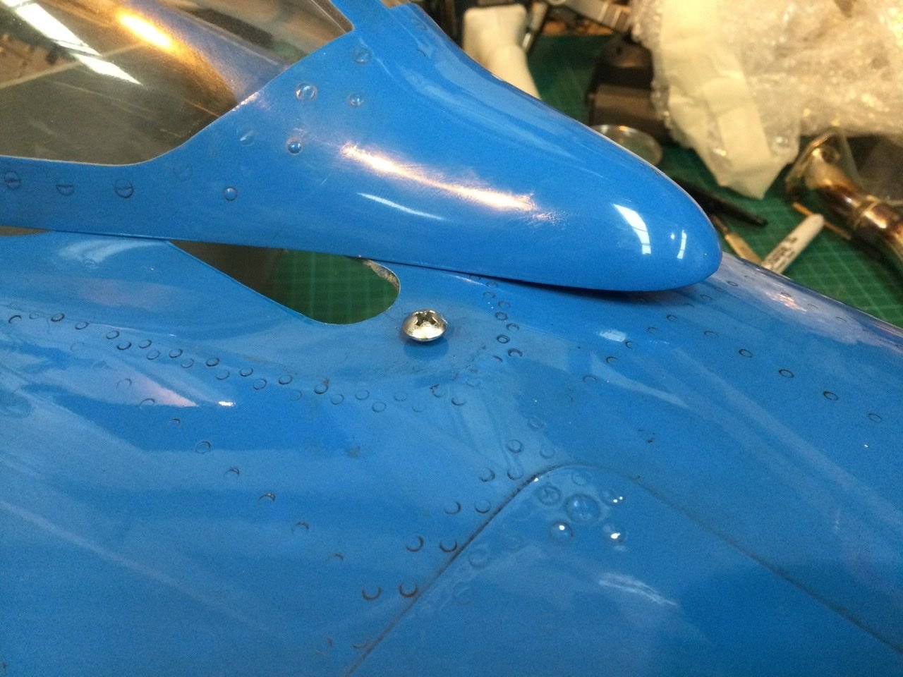

#144
Canopy opening complete, it’s very satisfying when you operate it the first time. The large headed screw hooks the back of the canopy when it’s closed, this screw also limits the opening as it catches the canopy front drive mounting plate.
