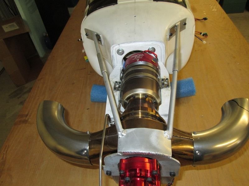

Does anyone know if anyone makes a mount or a set of drawings for a TP60 TIA Scott

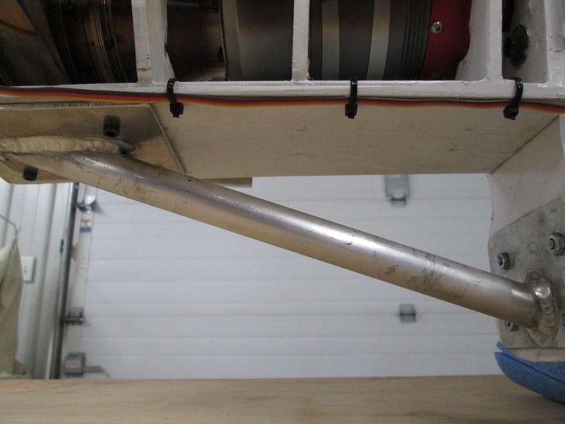

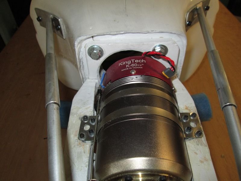

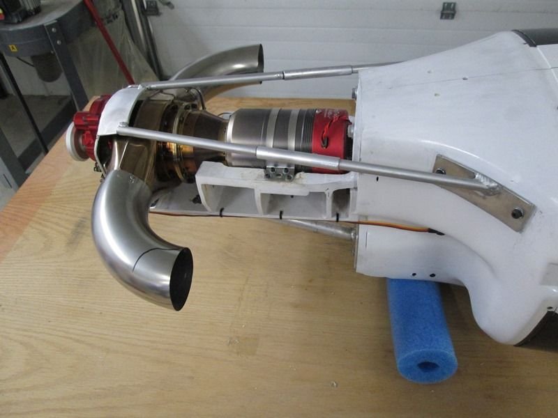

This motor required both a Front mount and a side support…similar to the photo of my turbo Raven, pretty your install is possible, but I never own a frankel so I can’t say….
But, I would run and extension from the firewall to support both the front mount and the side mount…..maybe a metal piece….
