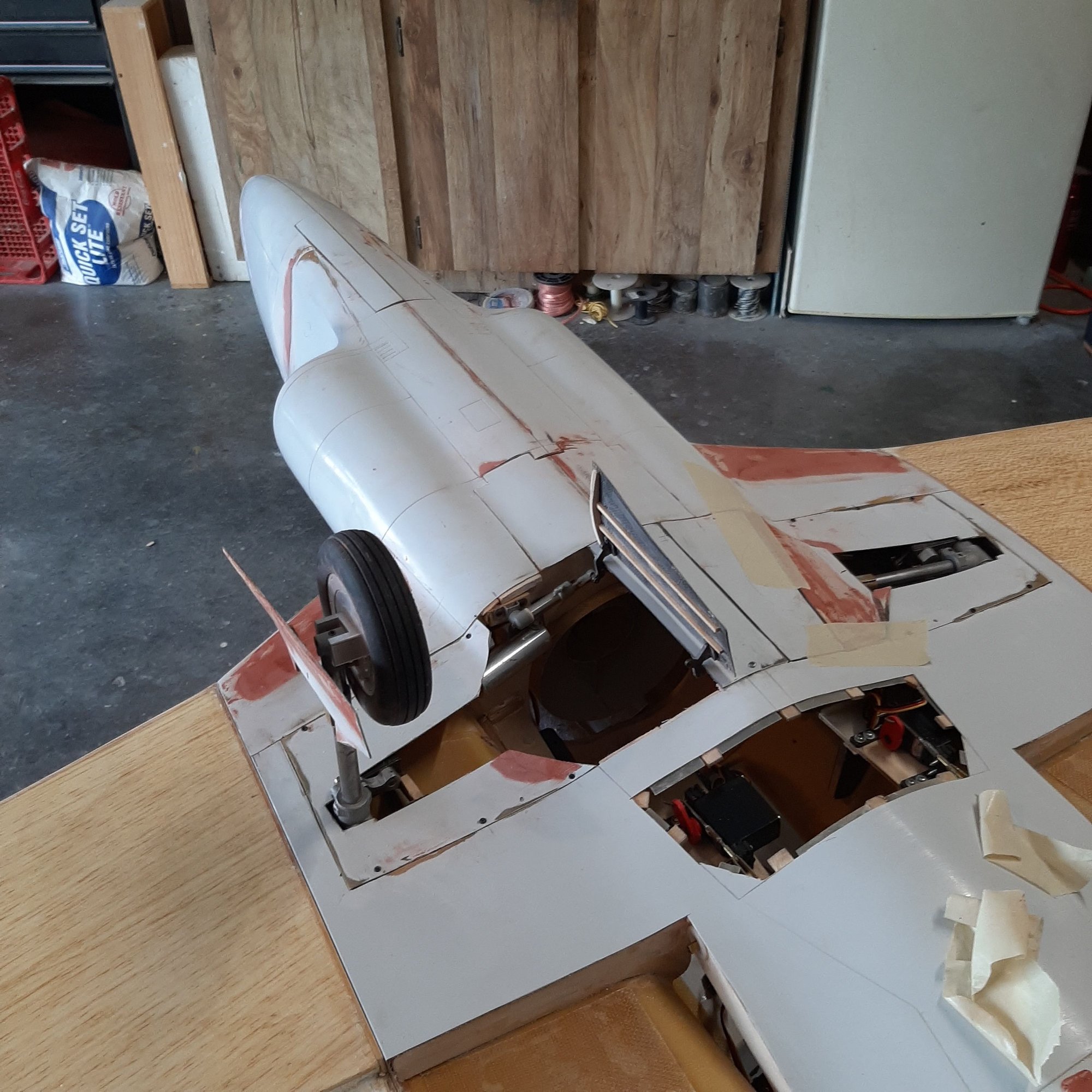

Unfortunately, I hit a huge road block, but I believe I can recover..
The gear doors were great until I mounted the motor. Now, the tires are hitting the motor housing, thus limiting how far they’ll retract. I’m needing maybe about a 1/4” of help? I definitely don’t want to scrap the gear doors. Maybe cut the strut a smidge?
Can’t shim the motor either due to the intakes..
Any thoughts?

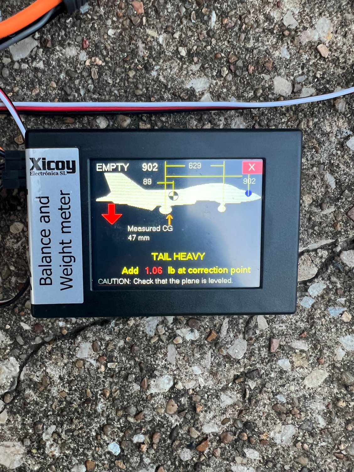

At this point, I’d hate to throw a number out because I’d probably be lying! The more and more stuff I add, I question on how the electric will fly this thing. Then I run it on the ground and I’m quickly reminded 😂
I thought I read somewhere it comes out about 1lb + - Could be wrong..
I’ve got the Xicoy CG device, and I’ll grab a number from it for ya!

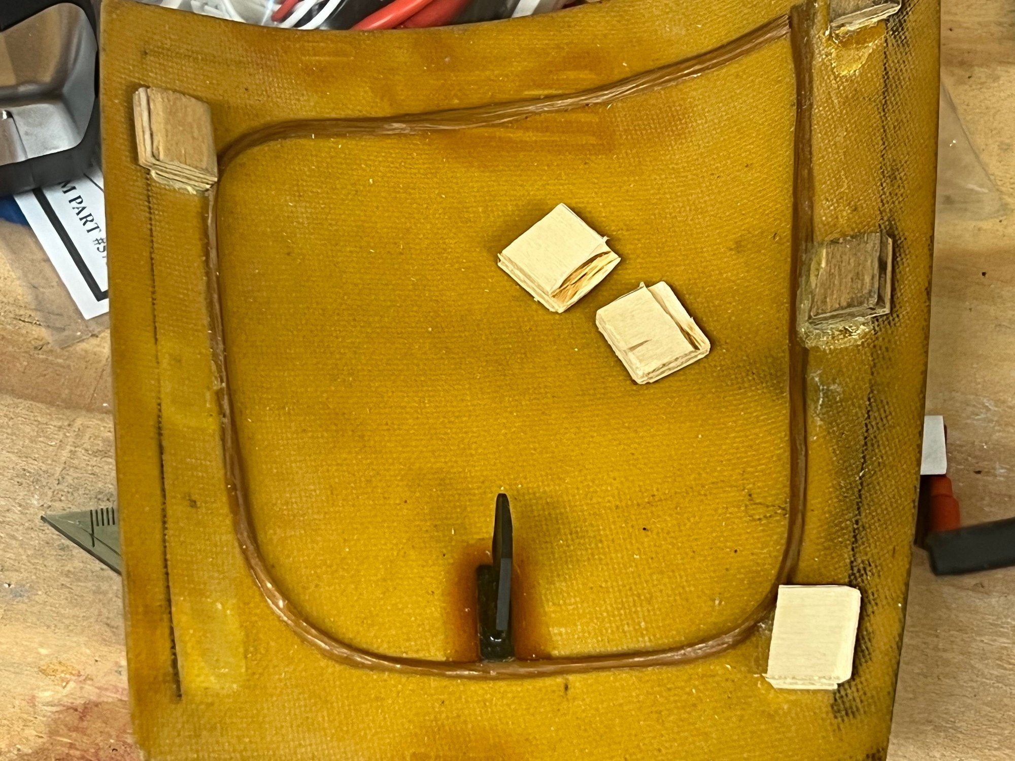

Few minor things today. Slowly working down my “critical” punch list to ensure this Saturday will be successful.
Fixed the front hatch by adding some missing blocks. I also added a hatch latch. (Forgot to get photos of that).
Added a block and trimmed the fuse area as described in the manual. Heads up, works flawlessly. It for sure isn’t coming out during flight! *knock on wood*
Moment of truth. The dreadful part. CG.
It’s a little ugly, but I am pretty sure I won’t be in a danger zone..Too bad at least. The measurements aren’t correct, they’re off -+1mm (can’t input decimals on this unit) So with that being said, I’ll have to manually balance this unit. I’ve slid the saddle packs as far as I can, and at this point, unless I run wire for the third battery from the nose to the fan, I’m gonna need about 1lb. I still owe the front end an air valve, so I think I’ll be right at that 1lb mark.
An option to reduce the need of “unnecessary weight.”
Add twin 4000mah lipo flight packs. This will probably reduce the nose weight to only needing .80lbs. This would replace my current twin 2000mah packs. At this point, I would have no choice but to add some weight to the front. Going off the top of my head from just holding their weight in comparison.
All in all, the for sure way to check this puppy is to manually do it. I’m not in anyway knocking this unit, it’s great! However, I think to be safe, I need to resort to a second opinion.
For those wondering, current “electrolyte’d” weight is 20lbs on the money. I didn’t put air in the plane, because I didn’t want it to weigh anymore.

Long story short, I believe the CG was a little misleading. Digital CG meter showed tail heavy. CG stand showed tail heavy.
Flew it, it became apparent after take off, it was too nose heavy. Smashed it into the ground on my 3rd approach. I had quite a bit of up elevator, and on final, I gave it all I had.

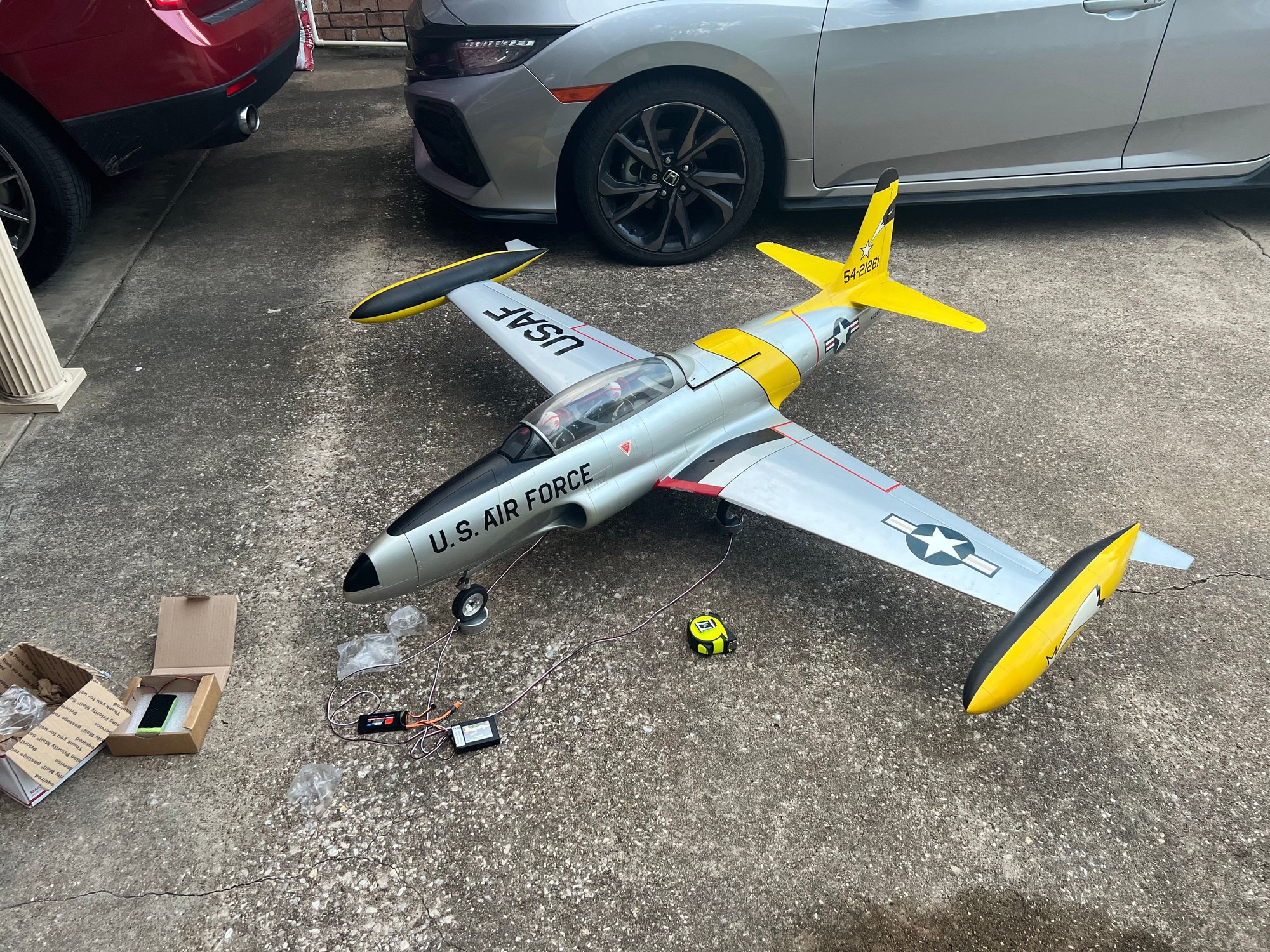

What a great weekend in Waco! Huge thanks to Dawn and the crew for the awesome and enjoyable time.
Here's the debrief on the T-33:
I can, 100% confirm that the CG stand I was using was 1000000% incorrect. This was a for sure set in stone confirmation after 3 other individuals who used the same stand had issues. One in fact lost his aircraft to it being too nose heavy. With that being said, the CG stand is hopefully in the garbage, and we're going back to the old school ways of putting a finger under each part of the wing/fuse.
First flight at Waco was rock solid. About two clicks of up trim, and one click of left, and it was game on. This plane absolutely floated like a butterfly, and flew pretty scale in my opinion. Just like a trainer! With these newer batteries, it was discussed and recommended to add a throttle mix to my transmitter. 100% on take off, after gear up, throttle reduces to a max of 80%. The newer batteries are a little bit harder on the motor. (70c vs 35c discharge) There's not a for sure timeline on how long/hard it can be on the motor before it fails, but better to be safe than sorry.
The first landing I had, couldn't have gone any better. Half speed brakes to try and understand how the plane would react, and no flaps created a somewhat hot landing. This was comforted by the spacious size of the runway at Waco. After bleeding off as much airspeed as I could, my spotter and good friend Andrew just muttered, "butter." Yes, it was a fantastic landing for what I was working with. Touch on the mains, and lowered the nose. I slowly applied the brakes, but quickly found out they weren't working the best. Luckily, it worked itself out, and it was discovered that a dried o-ring was causing a small leak. After applying some lube on the o-ring, it was time to go again!
Second and third flight: Man, this is the good stuff. I've been flying jets from all walks of life, but it was finally nice to have a nice little pattern plane. No 4 point rolls, no knife edges, just pure bliss and putting around. It's fun to go back to basic stuff sometimes. Sure it could do loops and rolls and split S's, but I wanted something just to putt around in. During my second and third landing, I saw no indication whatsoever that this plane was ready to snap. Even while bleeding off as much airspeed as I could on landing, I never saw a snap. With that being said, I'll still be super cautious of it, because you never know.
I am going to go back, fix the nose gear (I used an airblue as an immediate replacement), fix the nose doors and add lights to it.
If you've got an old DF jet, PLEASE consider switching it to EVF. It's such a great drop in replacement for the older systems.
Special THANK YOU to Tommy Dodgen for building this plane. Man, I wish he and Bob Violett could see it.. Also, Grandad for trusting me with this thing, Patty and Rob at BVM Jets for getting me parts and answering my questions and everyone else who has supported me along the way!
Next up, Aggressor 3.
