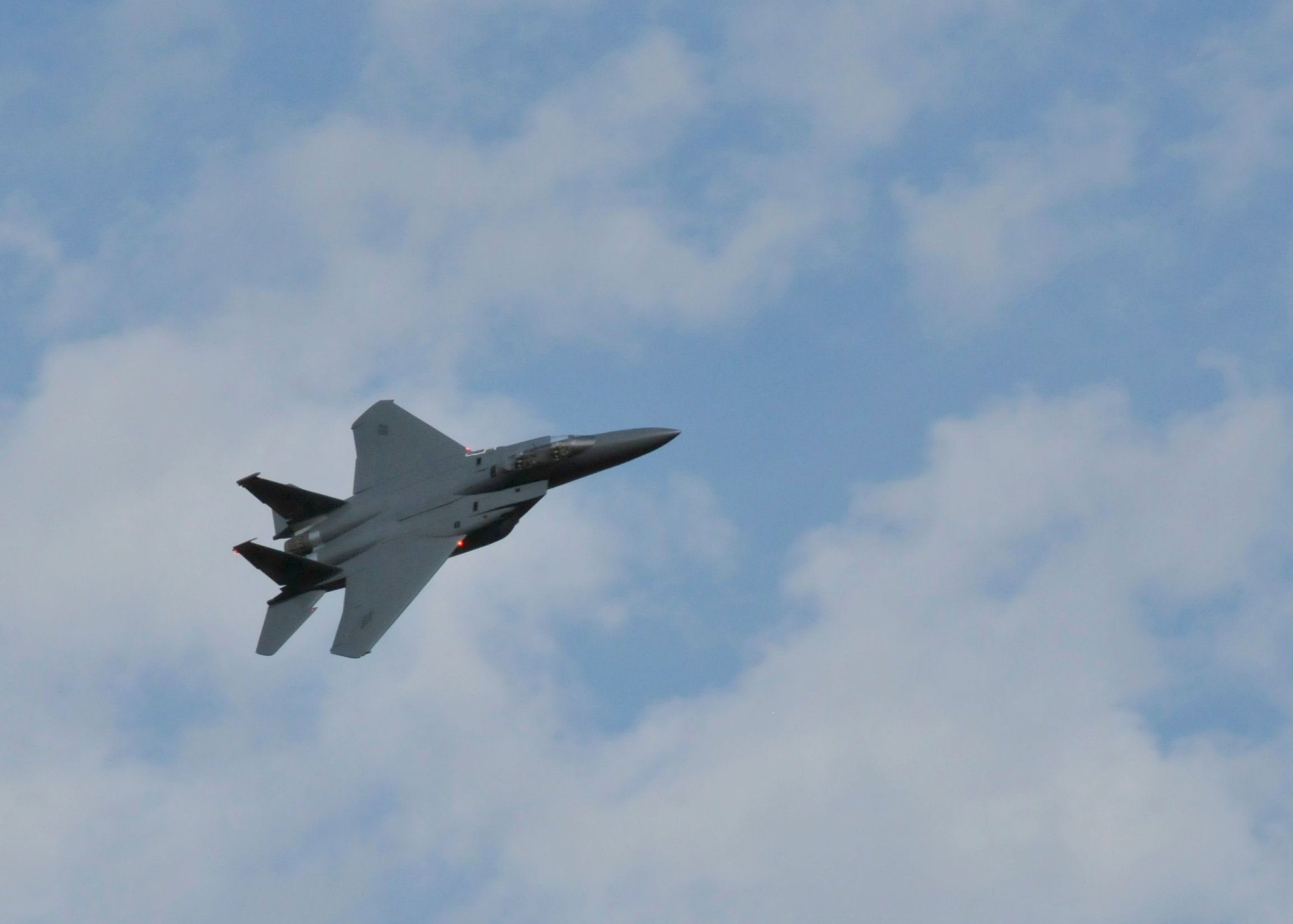

Unlike a lot of the others who may chime In, I acutually own and have been flying mine for over a year now, Mine is the E model and was built for a single, if I bought a new one I would do a single again no hesitation, I have a SWIWIN 300 from Bad Boyz RC in mine , would plan on needing an LTMA as I did on this jet, mine weighs almost 68lbs full of fuel, my engine put out 71 lbs, and, everyone who has seen mine will attest to how powerful it is. I can get mine off the runway in about 100 feet if I pull on it, get the gear up build a little speed and pull straight up until its out of sight if I want. I went with a single for a bunch of reasons, I love the way a large single sounds going though a split pipe, Ease of maintenance and service, of course it is also less cost, and less moving parts means less things to worry about happening, also there is the ease of install. The Only Benefit of twins, is If you lose one your Odds of being able to get her back down safe are much better as you will still have power. I have had to deadstick mine, One Time, last year, not the engine, My SPektrum telemetry showed 4 HOLDS, engine shutdown via RC as failsafe should, once I got my signal back I was able to get it back down on the runway with Zero Damage, and now I have converted over to Jeti. The 15 is a very forgiving jet with No bad habits, and the flat bottom helps keep it flying. The truth is its Up to you, its what you wanna spend and what you wanna build. There a few things to look out for on this plane, not sure if they addressed it on the newer versions, Mine is older, had a hard life from previous owner, I put alot of work in it repairing modifying and completely stripping and re-painting, but it was so worth it. If anything ever happened I would replace it Immediately, I love mine, and you will too. Here is a vid a buddy took of taking off, you can hear the howl, I did however have a custom pipe made. I would not Trust the Fei Bao pipe behind a 300.
and a landing, took a few flights to figure out the plane will actually land very slow, I’m actually landing too fast in this video,,
