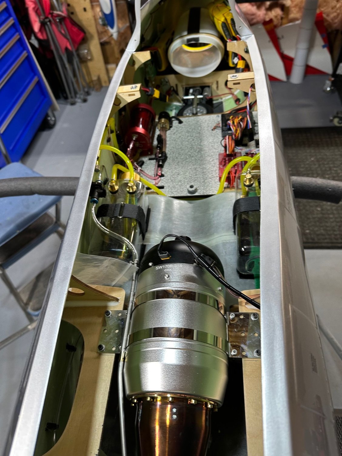

This is my initial idea for electronic stuff.. The CB220 will power the CB100 which acts as an expander. I need 18 servo ports. The gear and doors will be sequenced by my DS16. If you haven't tried an AR Q-Switch you should. I can control the power to the radios, gear, brakes and lights through the R3RSW in the Q Switch. I tried it on my GJC F15 and it works great. As for the vent or not to vent, I will use a 2nd vent if I have a spare laying around, if not the fuel loss is minimal for my Cheeta.
Old 02-22-2023, 07:12 AM
tp777fo
My Feedback: (28)
tp777fo's Avatar
Join Date: Feb 2002
Location: Greer, SC
Posts: 3,481
Received 113 Likes on 80 Posts
Now for the business end. I hear the jet is nose heavy so I will put my Power Pack and UAT on the fuse sides. I need to leave the fuel tank sides clear to be able to remove the tank when necessary. If I have to, I can build a plate for the top of the tank for the PP and UAT.

Got my motor mounts from my main source, Aeropanda. Initial fitting looks good. Will put a ply nut plate under mounts for a blind nut/bolt

Q-Switch mounted. Servos will be here Monday and will jump on them. Decided to wait for the UAT & Power Pack mounting until I get it on the balancer to help with the CG. 3 3300 LiPos coming. 2 for radio and one will power lights, gear and brakes.

Got the motor mount finished today and motor and pipe mounted. Spent the rest of the day updating firmware on TX, RXs (the new Rex7 A40 with dipole antennas), CB220, CB100 and Cortex Pro. Made leads for Rx 1 & Rx 2 and short leads for CB/Cortex link using PowerBox heavy duty wire. Tomorrow I will finish a connector for nose gear light and by then my servos should be here. Lots of progress expected this week.

Default F86 balance
This will not be nose heavy. I have 2x2600 mah receiver packs 2x2400 mah and a 3 cell 2500 mah LiFe ECU pack in the nose, plus all of my radio and turbine equipment on the front plate, the turbine pushed all the forward and a full UAT and it will still require 1 and 1/2 pounds in the nose to balance.

I also have a 5000 3 cell and 3 5000 2 cell in the battery trays and everything as far forward as possible and I am balanced OK Garry where did yu balance yours I am balanced right at the gear openeing on the fusalage which is about 420 mm back from LE
