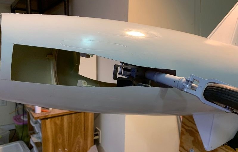

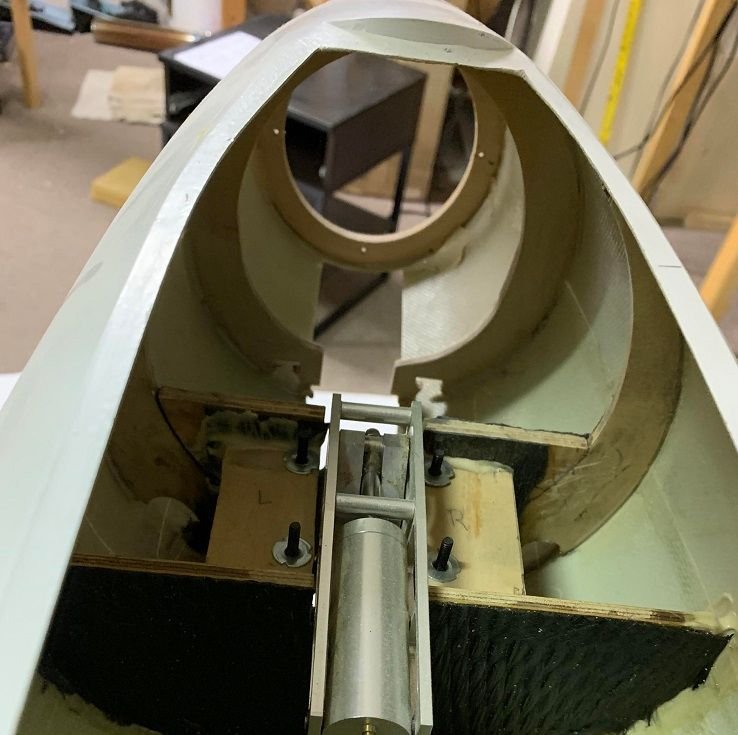

Here are the first three formers installed. The first one is a ring former right where the removable nose is cut off.
The second and third formers hold the nose gear mount plates. As I said, I modified them to move the plates up far enough for the ARF strut length, but I think I'll have to do more modifications to move the nose gear mount towards the rear. That's for later though...
In order to position them correctly, I measured the distance from the nose to the former on the plans, and tack glued small plywood blocks to the sides of the fuselage at that distance to provide a method to hold the formers in the correct location while the Hysol set.

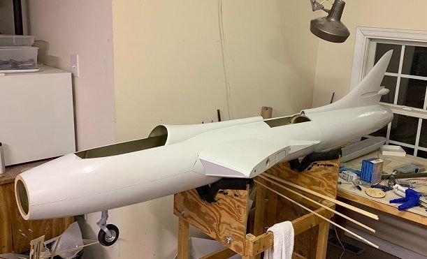

Here's the install of former #4. In the Mick Reeves Hunter, the wing tubes insert into the fuselage and bolt to a small "shelf" on former #4. Here the wing tubes are bolted in as well.
There are plywood plates that glue to the inside of the fuselage at the wing roots that the wing tubes pass through. Gluing these plates in indexes the location of the wing tubes, and thus the wings, in both a vertical and horizontal (longitudinal relative to the fuselage) direction. Thus, the wings need to be on and setup straight before these plates can be glued in place.
The next step is to fit the wings, get them straight, and glue the plates to the side of the fuselage as well as glue the wing tubes into the wings...

I've also gotten the fuselage halves together...
