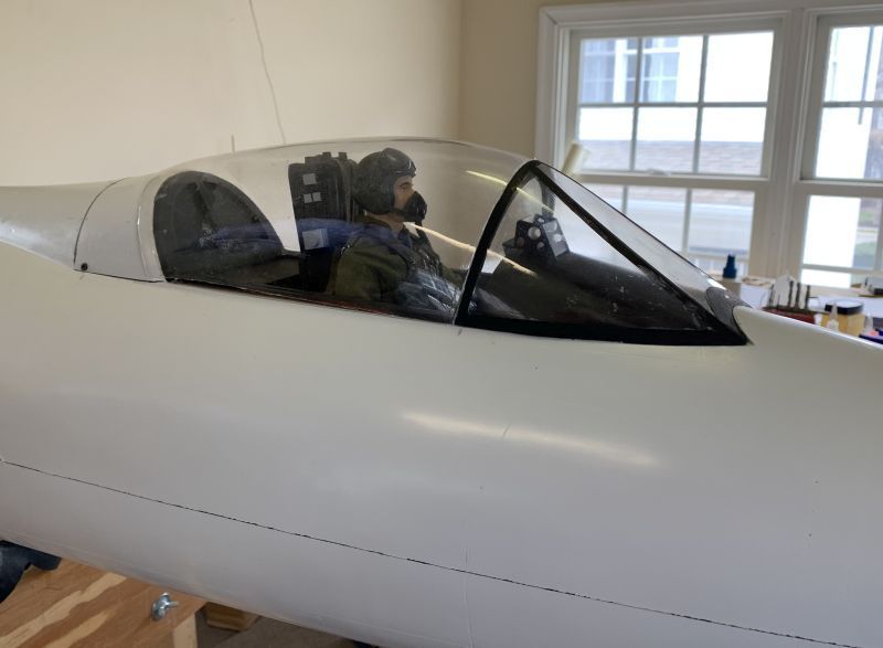

So I arranged a trade for a Hunter cockpit for the Ripmax Hunter - the same scale as the Mick Reeves Hunter.
As I thought might be the case, the Ripmax Hunter cockpit is wrong. For a 1/6 scale Hunter, the pilot figure should be around 11" tall. A pilot figure of around that size is shown on Mick's plans for the Hunter.
I have a 10.5" tall RAF jet pilot figure. He doesn't even come close to fitting in the cockpit - as you can see. I will use the parts from the ARF cockpit to build one that is suitable for the scale of the Hunter and my pilot figure...

Making some progress on the Hunter ove the holidays. Here's what I did with the cockpit. I extended it down into the fuselage and resized the seat for the proper size pilot. You can see he fits fine now.
I still haven't quite figured out how to do the sliding rails yet, but I have a bunch of K&S metal shapes coming to figure it out. The sliding rails likely won't be that tricky, but figuring out how to actuate it and still make the cockpit easily removable is going to be a trick.

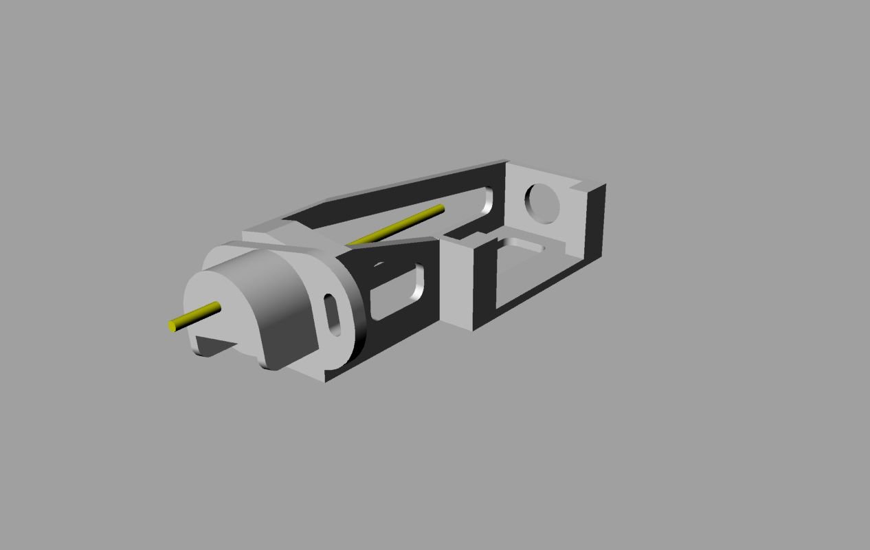

I'm also going to add a drag chute. I've installed the drag chute fairing from the kit and cut and hinged the doors on it. I'm not quite sure how I'm going to open the doors and deploy the chute, but I have a few ideas.
Bob,
Here's some images from my scratch build chute release system for my DerJet Hunter. One servo does all functions, door release and then chute jettison, using a 3 position switch.
The doors are spring loaded to open, and are held closed by the pin, which also serves to retain the chute. One door overlaps the other and a hook on the top door engages the pin and holds them closed.
The chute needs some help getting out into the airflow, so I use a sort of 'trampoline', attached to the doors that lifts the chute up as the doors open. After some trial and error it now works well.

Originally Posted by JSF-TC View Post
Bob,
A motivational shot for you - make the chute work, it is well worth it!
Paul
Paul,
That is AWESOME man, thanks very much for the information and inspiration!
