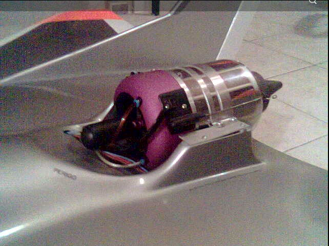

Enrique, I have plans to modifie my Roo's engine mount like it is on your Roo.
I like to know what should I be looking for when I cut the original mount and how to build the new one? also remind me of the benefits of doing this mod.
Tks.
Old 02-12-2020, 03:13 AM
  #58
erbroens
erbroens's Avatar
Join Date: Nov 2003
Location: Curitiba, Parana, BRAZIL
Posts: 4,247
[QUOTE=CARS II;12582551 I have plans to modifie my Roo's engine mount like it is on your Roo.
Tks.[/QUOTE]
Hi Carlos, the idea is to lower the turbine thrust line to match the airplane centerline to get rid of the pitch down tendency present in the original model when full power is applied at low airspeeds. You can also
takeoff shorter and at lower speeds,, aborted landings are much more cleaner too,this mod turns the original Roo in a more refined jet.
Making the mod is quite easy. Just cut off the original turbine mount , add two hard balsa/plywood mounts connecting the upper and lower fuselage shells, cover them with fiberglass and epoxy and add plenty of putty to round up the mount helping the airflow to cool off any hot point in the new mount.. it also looks a lot better too. Dont be afraid to put weight there, Roos have always a tendency to be nose heavy.

Got it! I will be doing that mod and a new paint job on the Roo this Summer.
Last time I flew the Roo I did a couple of go arounds and man! they felt bad, it was struggling to gain altitude doing smal stalls as it was trying to climb and had to baby it 'till it picked up enough speed to have a positive climb.
Tks.

if you have time to do it it will be worth of it.. however you can do a quick fix changing the turbine incidence (the turbine facing down) to reduce the pitch down tendency.

Of course if you're really keen you can completely hide the turbine. I did this mod just before the rookie came out lol

So, we want the engine to be just above the trealing edge or is it better to have it, ala King Cat, half of it hanging below the trealing edge?

In the position and angle I set it in (about zero degrees) there is not pitch trim at any speed whatsover, and also the turbine is protected from ground scratching in case of problems with the landing gear... both in the Hotcat and the Kangaroo.
A friend here also installed a fancy turbine cover in a Hotspot some ice ages ago, and I remember he used too a RAM 1000.. It had some air restriction and temp problems.. so he got rid of it . In case you want a hidden turbine, perhaps it would be better to buy a brand new Rookie, wich Andreas (CARF) has still available. :-)

Quique, I prefer the way you installed the engine on your Roo, I'm ok with having the engine exposed, I just want to remove the bad tendencies out my Roo, I think it's a cool airplane and really like how it looks in the air when it's flying and want to make it better.
Thank you for posting that pic Jeremy, it's giving me some ideas.
