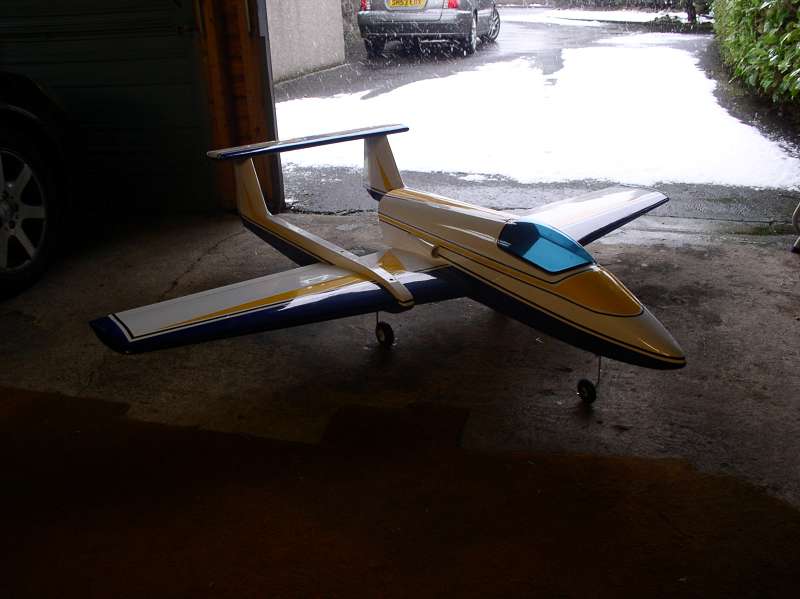

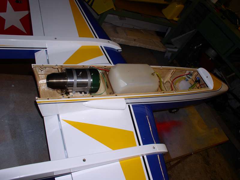

Ok Guys
Here is the Intro after about 12 hours work. Only radio install and control linkages to complete. Very easy build model is well designed with some clever features.Only negatives are quality of fixed gear noseleg as supplied and CG. It looks like some church roof will be required in the nose or much larger batteries. 2700 mah nimh fitted at present. Specs are Wren 54 Mk3 manual start Hitec 5625 digitals on airelon / elevator 635hb's on rudders. As you can see the Dubro 64 oz is a perfect fit with a 6oz Graupner hopper up front final weight dry should be under 14lbs depending on noseweight req. Sorry about the first pic flash did not seem to work as you can see we have snow in Glasgow today.
