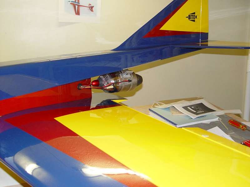

#271
Join Date: Jul 2003
Location: SeaTac - Angle Lake, WA
Posts: 1,057
Hi Guy's,
Getting really close to getting my R54 done. Spent the day doing the detail work for mounting my air systems. I had to do some thinking on how to get all the hardware in since I'm also using a set of pneumatic brakes which requires an addition air tank and valve. Figuring that there was a lot of free space up in the front hatch area that it would be pretty simple to make a couple of trays and mount everything to them. Planning to install my propane tank in the blank area of the rear tray on the left hand side. All ready have a shelf installed below the tray. Just need to cut the hole but didn't have the right bit to do it yet. A couple of guys asked how I was going to do it so here's some pictures.
Still have about another days worth of work left to get this bird done and it feels great!!!
Cheers,
Cheers,
#275
Join Date: Jul 2003
Posts: 1,057
ORIGINAL: rcguy!
Looking Great! Nice colors and all. I have FOD screen envy!
Dave Rigotti
Dave Rigotti
Thanks Dave, Much appreciated after all that work. I got my FOD screen from Todd at Dreamworks R/C. Cost $20. Really nice folks to deal with.
Will post pic's of my brakes in a few days. Too busy taking care of all the last minute details before a mall show this weekend.
Cheers,
