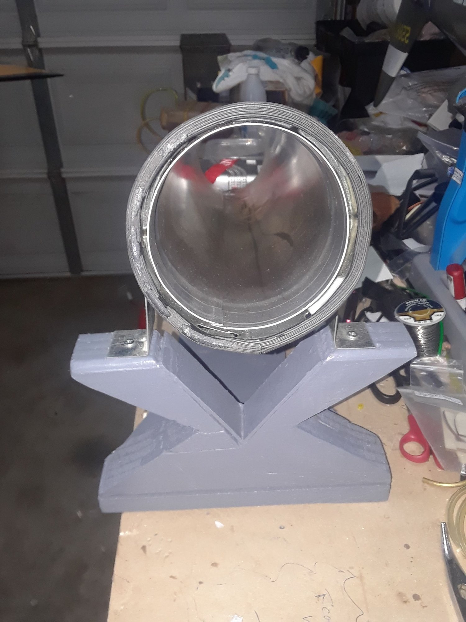

Done with all the checks, fuel, controls, electrical, engine and components and the most important, CG, I removed about 3 oz of lead from the nose, it still has 6 or 9 oz of lead in the nose cone, the CG came out at the very aft limits per the plan so, since we know that the model airplane designers are very conservative on the CG point to help the builders not to screw up during the maiden flights then I'm ok where is at, it should rotate easy on TO and hopefully it will be easy to fly when inverted and also looking for axial rolls here.
I've also done some mods to the exhaust deflector, it was a bit heavy, added some gray primer and most likely I will be painting the tube with the heat resistance black paint that I got for the Turbinator's exhaust deflector plate, notice the front of the tube, I added a sliced rubber tube from the hardware store to stop the front of the exhaust deflector tube from touching the back of the turbine, the exhaust deflector tube is a must have with this airplane, specially if your turbine is Kero start ( most of them are now days )

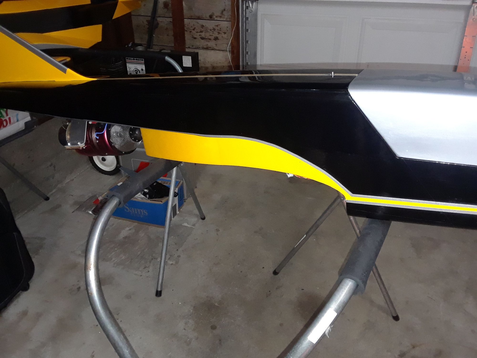

Some Reaction action happening right now the Reaction is an airplane in my fleet that I haven't flown after my eyes sergury, it sure will be enjoyable to take it to the skies once again, this time it will be more relaxing for sure.
Giving her some personality before it's back in the air, I also will be adding some of the stickers I have and some that I will get from Callie graphics.
I saw Jeramy doing the same thing to his reaction and I wanted to do the same, I felt it was incomplete.
ps: the cub stickers remains me that the yellow it is covered with is Cub Yellow and the how easy this airplane is to build and fly.

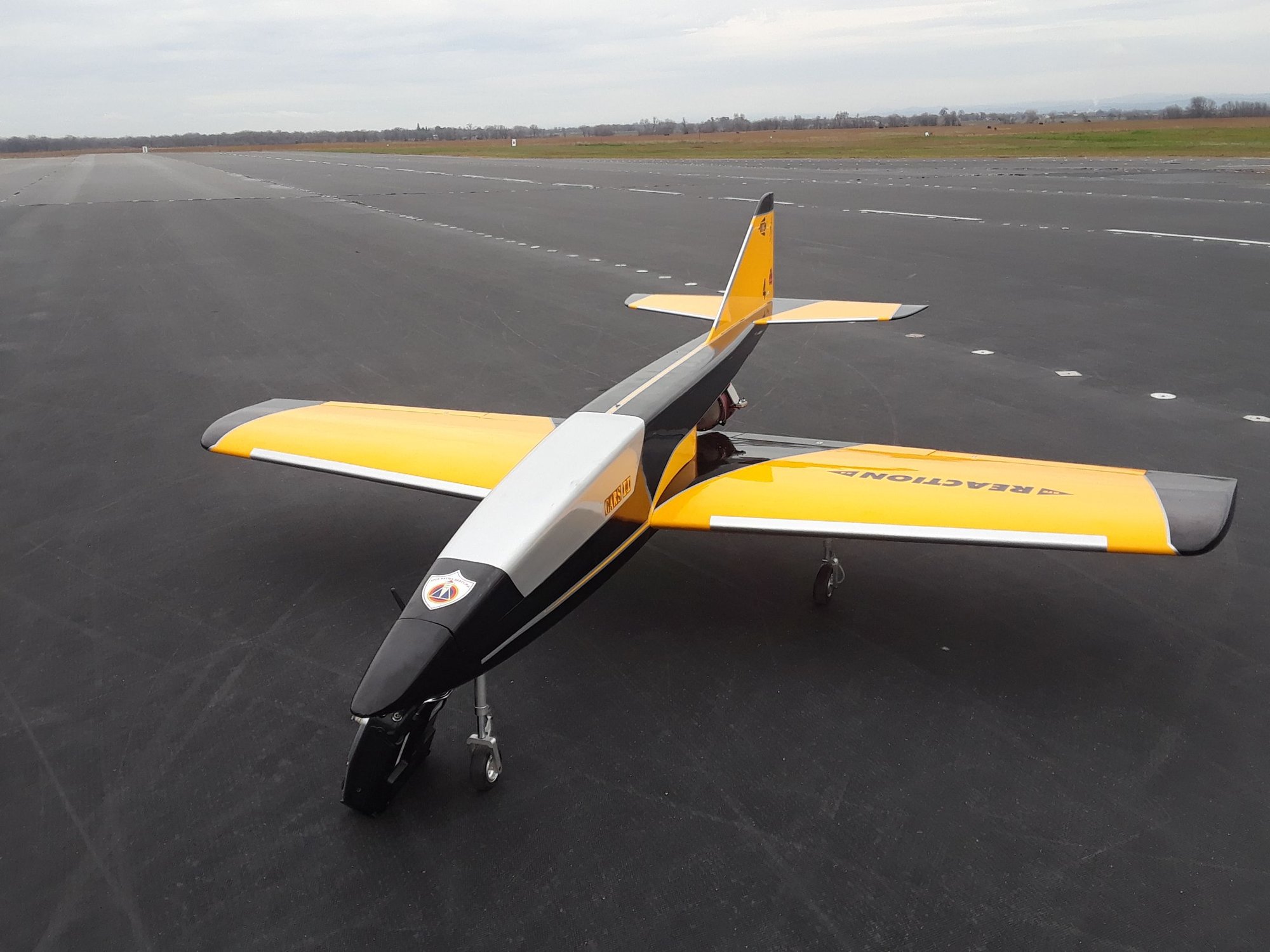

Flying my R-54 as we speak ( type ) flight #1 done then some minor adjustments to the steering and ailerons, ailerons low rate was reduced about 10% and 25% expo, high rate is fine with 35% expo, CG is at max aft position, checked on the second flight, the jet holds inverted with almost no down elevator input, rotation on landings is effortless, so far both landings were on the mains, the full flap settings was reduce from about 80° to 60° down, much more manageable approach, on the second landing because it landed so slow breaking was not needed, TOs are more realistic with the first notch of flaps down, with this flaps setting TO rotation is smooth not a jump off the runway, with first flaps down TO rotation can be done at a shorter distance and with a smooth rotation.
The two members that were here left so, no one but me, myself and I, light winds, very high overcast, the temps are ok, warmer tomorrow, more flying to be done here.
The Kingtech 80v1 is performing flawlessly, lots of power at max rpms and throttle response is awesomely fast, the jet now has 3 fuel tanks, 90 oz of fuel total, the timer set to 7 min, fuel remaining in the main tank after 7 min, 30 oz, 1/2 tank, average throttle position during flight is from 1/2 to 2/3.
I hope all this info can help the future R-54 builder/flyers.
Later.
Old 01-23-2020, 04:15 PM
  #4493
CARS II
My Feedback: (7)
CARS II's Avatar
Join Date: Oct 2002
Location: Sacramento CA
Posts: 6,589
Received 123 Likes on 106 Posts
This jet it's amazing how slow it can be flown and the landings, I got 4 flights in all today, I had to thame it a bit on the ailerons, the control throws are the recomended ones but as it should be one has to adjust them to each ones flying style, recomended max throws are there for the wild maneuvers.
After checking the fuel reserves again, it can be flown 7 min with 30 oz of fuel reserves or the flight time can be increased to 8 min.
Again, the CG was rechecked by flying inverted, it is perfect at the max recomended position, I wouldn't recommend moving it passed that point, stalls are forward and none event, so none event that I got it to stall then recovered then without adding power made it stall again.
TOs are more natural with the first notch of flaps down, Im still debating if I should keep the full flaps where they are or back where they were, it now has more residual thrust with the bigger engine and the previous full flap position maybe required, one thing is for sure, it is nice to have all that extra thrust generated by the K80v1.
