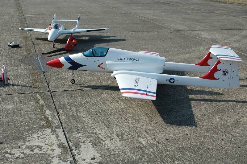

RE: Boomerang XL
This pic here clearly shows just how BIG the XL really is,that is my Kingcat behind my XL and we all know Kingcat's are rather large jets in their own right!!BTW my Kingcat is about to get a beautful Blue Angels Paintjob!!

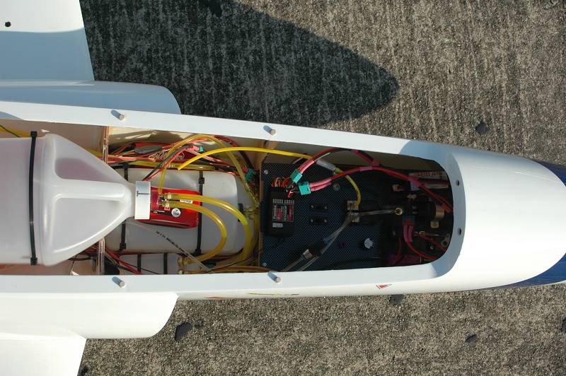

Anurag,
Yes my builder said it went together very easily/quickly,like any ARF jet 75% of the work is final setup /electronics layout.Here is one of the interior layout.I unfortantly didnt get any aerial shots cause the camera battery was on the fritz![:@]

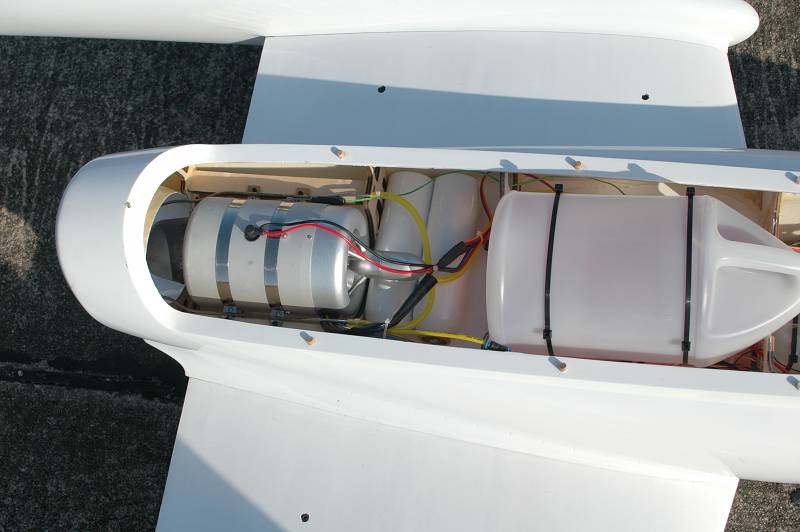

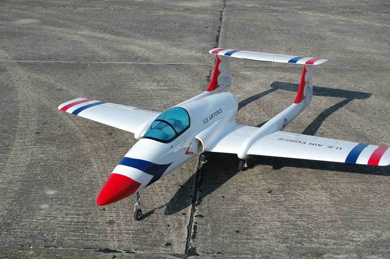

RE: Boomerang XL
Last one,I will get some aerial shots next weekend! This XL is a very BIG jet and it's so much fun .I gave a few other pilots some stick time last weekend and they agree!
One piece of very helpful/friendly advice I can offer is this.I'd highly advise not using anything shy of 30 lbs thrust with the XL.I have a Artes Super Eagle on mine (30 lbs) and while it has awesome vertical,the top end is very limited however,my XL weighs 29 lbs dry .I'd estimate that the top end is 130 at best! It is just a huge draggy jet.
What I'm getting at is that if you use anything less than say 28 lbs of punch your gonna be disappointed with the performance.While speed isn't everything of course we sure like to see atleast 120 or so with our jets !! I'm personally happy with the power/speed that my Super Eagle offers
