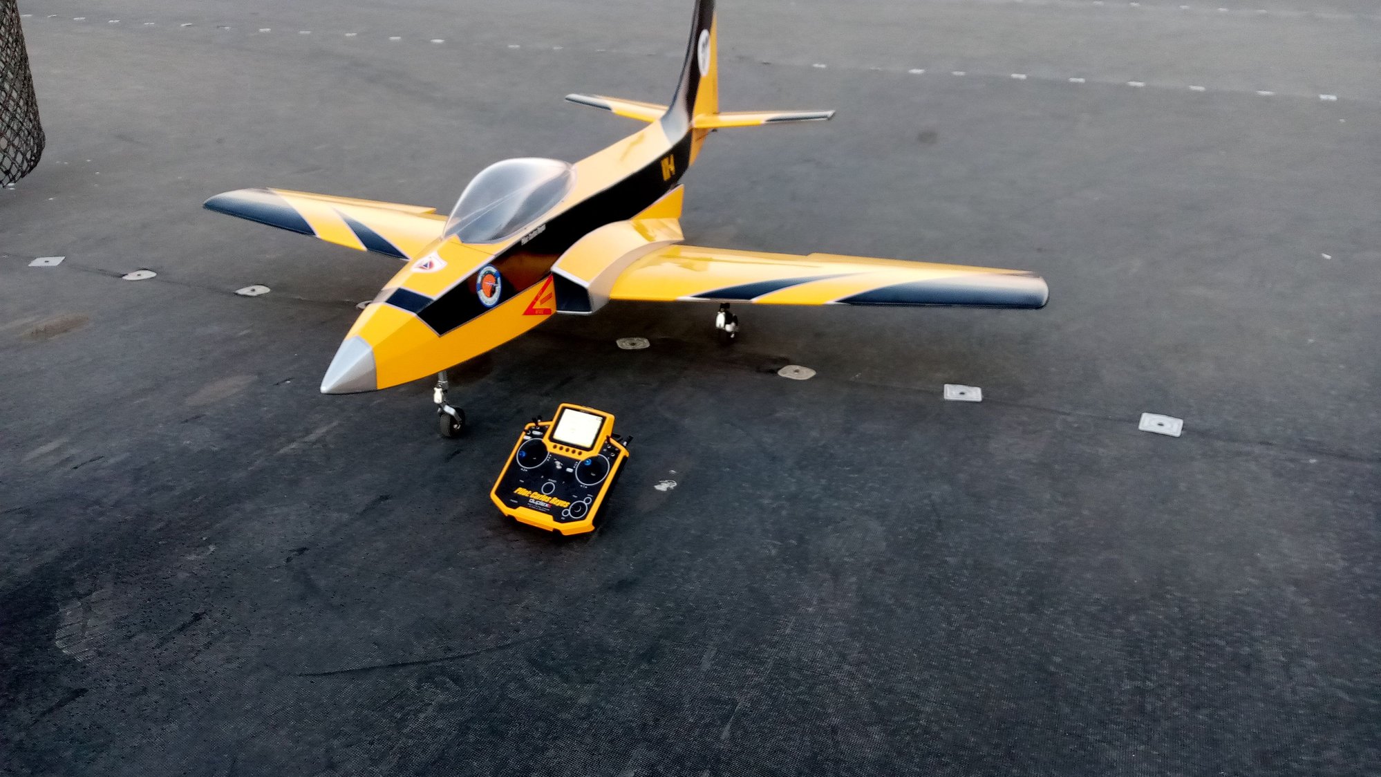

The Turbo is flying again, I installed a Jeti receiver since that's what flys my models now, it took a bit to learn the basics but here we are now, flying my models with it.
The remaiden started yesterday, as usual everything works at home but at the field somethings don't, yesterday, just before sunset I was able to give it the proper checks at the field + one more check because of the gyro build into the receiver, today I just needed to do a bit more programing on the radio and it was ready to go.
The TO was amazingly short, I felt comfortable flying it around, throttle position was around 2/3, the thrust angle of the engine was build per the plans and it seems to be the correct angle for the 19 lbs thrust P80, I haven't see it climb when flown from 2/3 throttle to full throttle and accelerating, the flaps produce an immense amount of drag, I'm finding out that I don't have to do long approaches, if I do I end up adding a tad of thrust to help it make the runway so, closer approaches next flights, the smoke system is working just fine, the fluid was syphoning at the end of the sprayer because of the tank been above the sprayer, I added a Sullivan one way check valve and it seems to have solved that problem.
I added 1/2" of crow and it is helping big time, on my second landing for the day just before touchdown I had the nose of it so high that I thought it was going to tip stall, it didn't.

Took the Turbo to it's first jet meet, it got to fly a couple of times, on the second flight the engine stopped ( no smoke ) it was in an excellent position to do a partial downwind, base and final legs to a normal landing, I was breading heavily ( of course ) but I knew all was going to be ok and it did.
On the ground, I found out that the ECU stopped the engine because of a failsafe, on a more detailed examination, the radio/receiver were cleared from the problem, the signal and quality of the link between the radio and receiver was strong, I now have to look between the receiver and ECU, everything else in this jet is working solid, I'm starting to enjoy this build, my Boomer was my go to jet, I will be making the Turbo my go to from now on, hopefully I will be able to show on vids the performance of this all around wood jet

I went to the field to workout the failsafe, I told a friend about the problem and where I should be looking for the problem, he looked at the ECU throttle cable where it enters the ECU and look at what we found.

The Turbinator has flown again with the fixed ECU, all went well.
