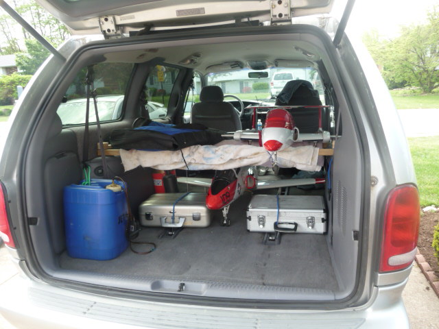

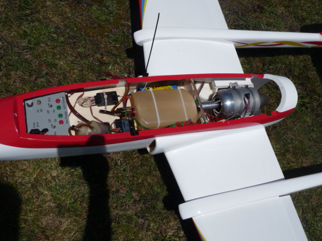

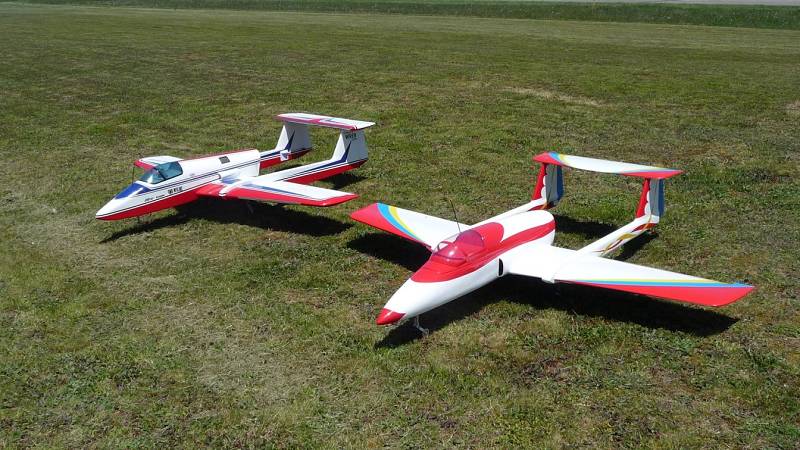

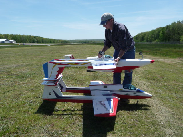

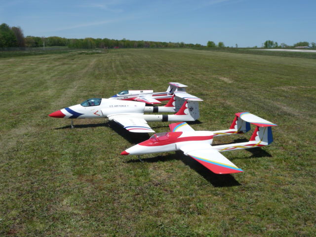

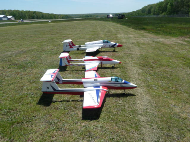

Well mine is very close, it would have flow this past weekend if it wasn't for a small problem with my RAM 500 starter motor, oh well, next weekend it should go!
Took some shots with a Baby Boomerang and a XL so you can see the size difference

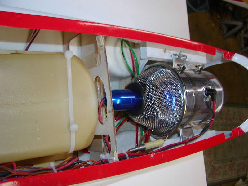

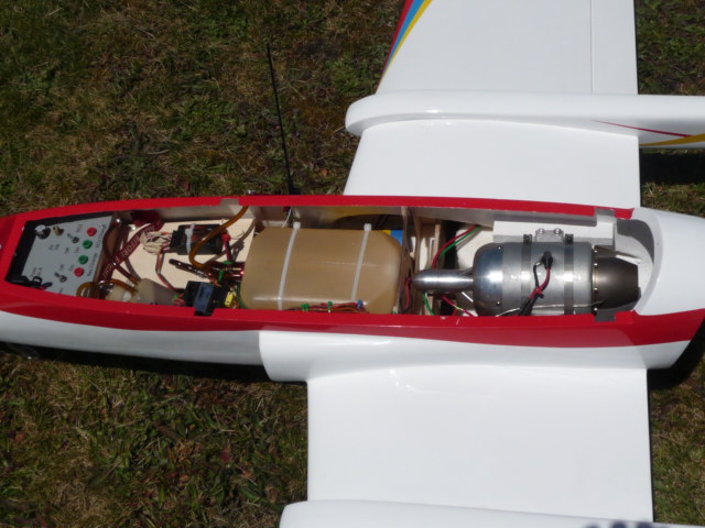

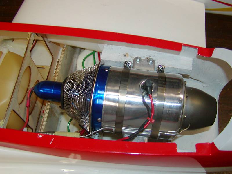

Well I have my Ram 500 running better than new again, it is running so good I decided to give it a face lift
I rearranged both of my batteries in the nose wheel well to shift the CG forward.
I had an issue with my Robart 700 series retracts (Air Up - Spring Down) they collapsed on every landing, I called Robart and they told me that the first production run had bad springs, they said send them in and they will fix under warranty, I just received them back today and the fix was to convert them to Air Up & down, which was fine by me!
Robart's service was great, I mailed them last Friday and got them back in less than a week!
So I hope to fly the Heck out the Formost this weekend.

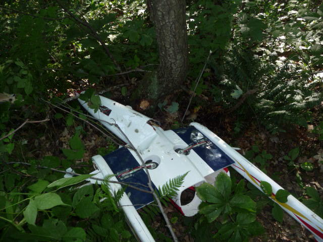

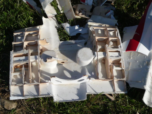

Yea, amazingly all of the hardware is fine, even my trusty Du-Bro fuel tank!
I had to climb up a 20 foot tree to retrieve one of the wing panels... had to get my digital servo
The First photo shows the fuselage resting against the tree that finally stopped its trajectory, the second photo shows the center section after I pealed away the fiberglass skin, it show the landing gear mods I mad, they were very strong!
I can also tell you that the fiberglass booms were very strong, the split a bit along the seams, the tail feather mounting broke, but I guess thats to be expected.
The fuz traveled about 150 feet through the woods, she was moving!

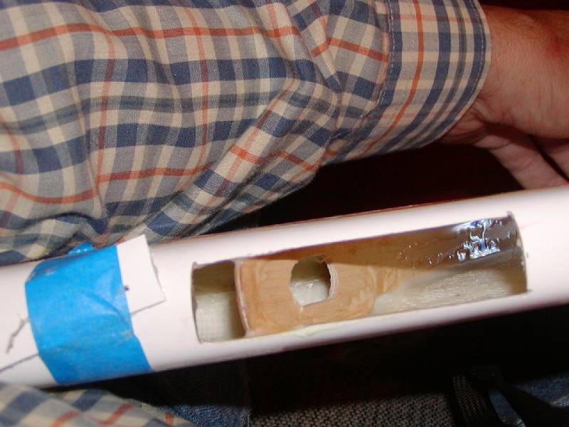

No I didn't use the foam, I designed a versicle spart that worked great, we took the booms on a table and tried to break the fin off, it was extreamly difficult to do with my spar in place.

Ah, the old who's got it trick.....
Thought the problem with the booms was they twisted and broke. I guess I missed the part about putting in a vertical spar. Is that in this thread or, if not, can you say something about it. Like did you split open the boom to install it??

Thud_Driver, I guess I didn't post any photos of the vertical spar when I did it, so here you go, once you put this in the booms are nearly indestructible, unless of course you put them through the woods!
The spar is shown in the bottom of the first photo, the second photo shows the cut out hatch I made in the bottom of the boom to slide the spar in, the spar run parallel to the LE of the fin, about 3/4" back.
I hope this helps

Ok, if I get this right, your spar goes up into the fin and anchors to the boom.
