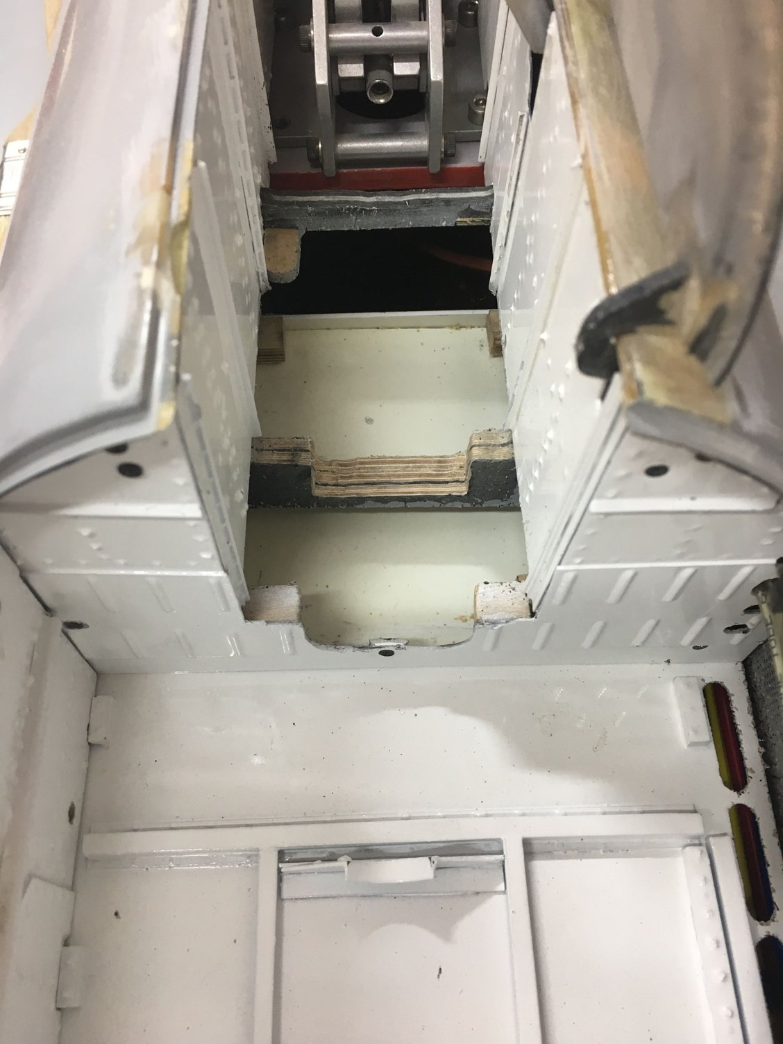

Thats correct, the rod that is threaded at one end slides in the brass tube slightly during retraction. when the leg is down it's push push.

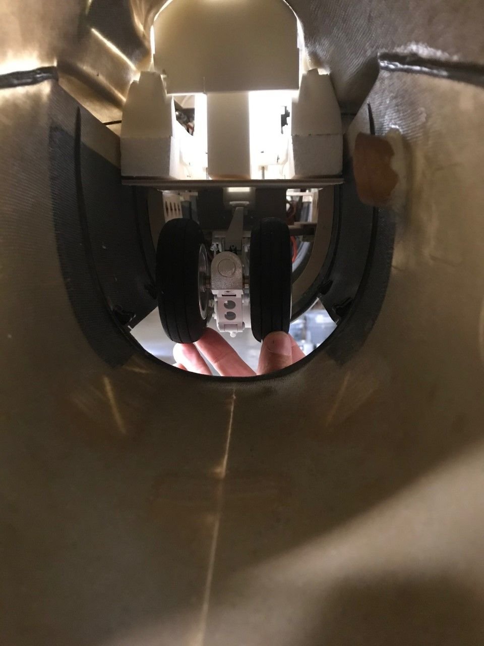

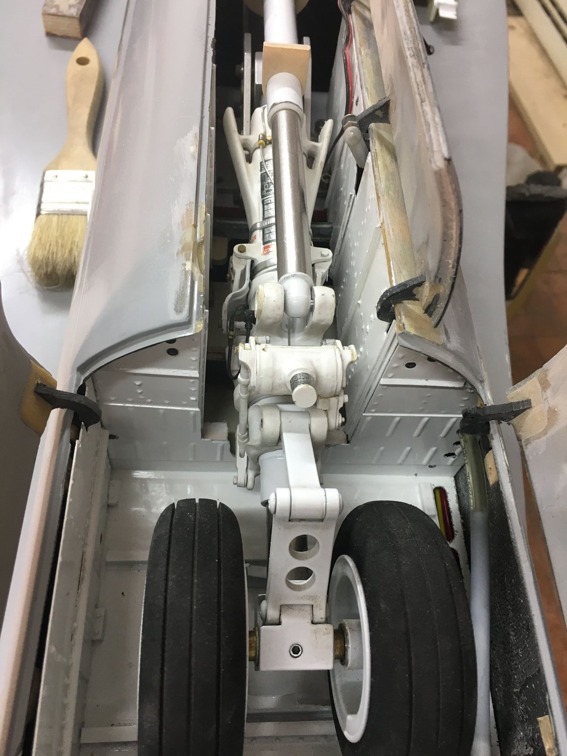

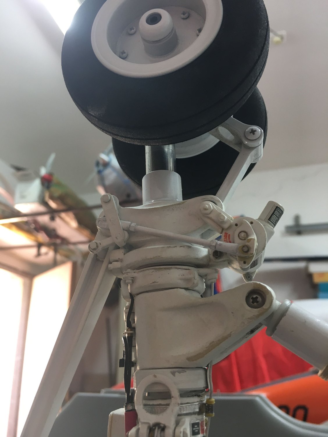

Originally Posted by smchale View Post
The tow bar folds flat when it retracts. Doesn't appear to be a problem with the cockpit nor is the bottom of the servo. I did have to eliminate the cross brace on the fwd former so that will need some attention, but then this plate also spans the fuselage providing stiffness.
Can't wait to see the results of the tires.
thx

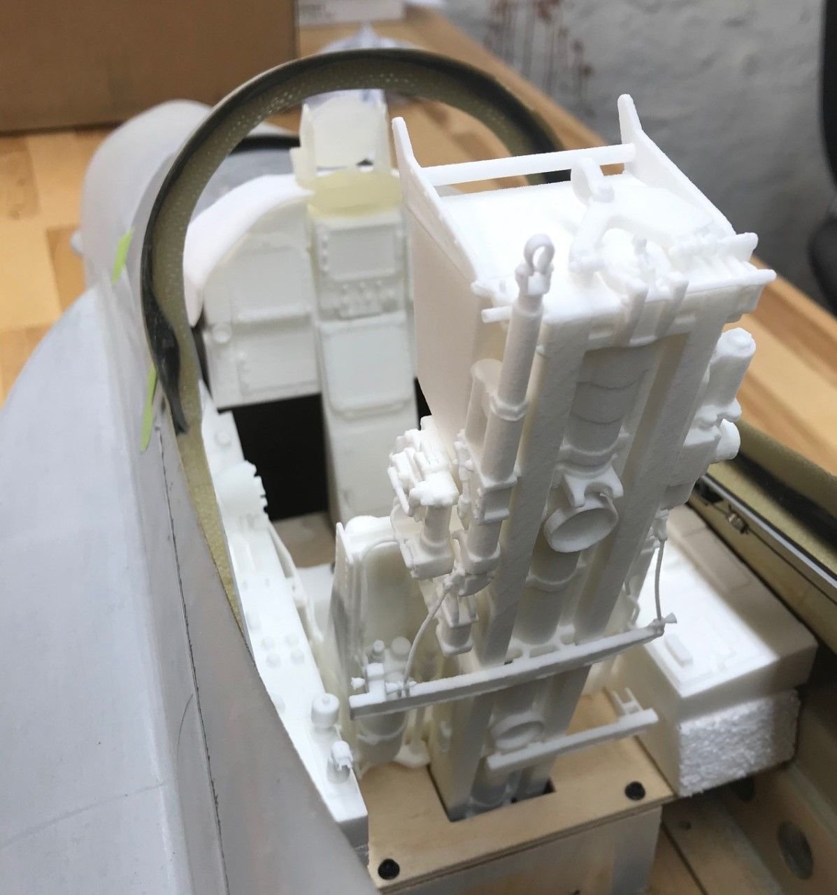

I think you’re wrong here . There’s no room for the pilot seat if you place the servo in front of the retract , assuming u have a full depth scale size pilot seat . The bottom of a scale full-depth cockpit is actually the retract wheel well ceiling double checked .
Old 05-18-2020, 06:36 AM
  #79
lavi rider
Join Date: Jan 2003
Location: Givat Zeev, ISRAEL
Posts: 1,268
Default Bug steer

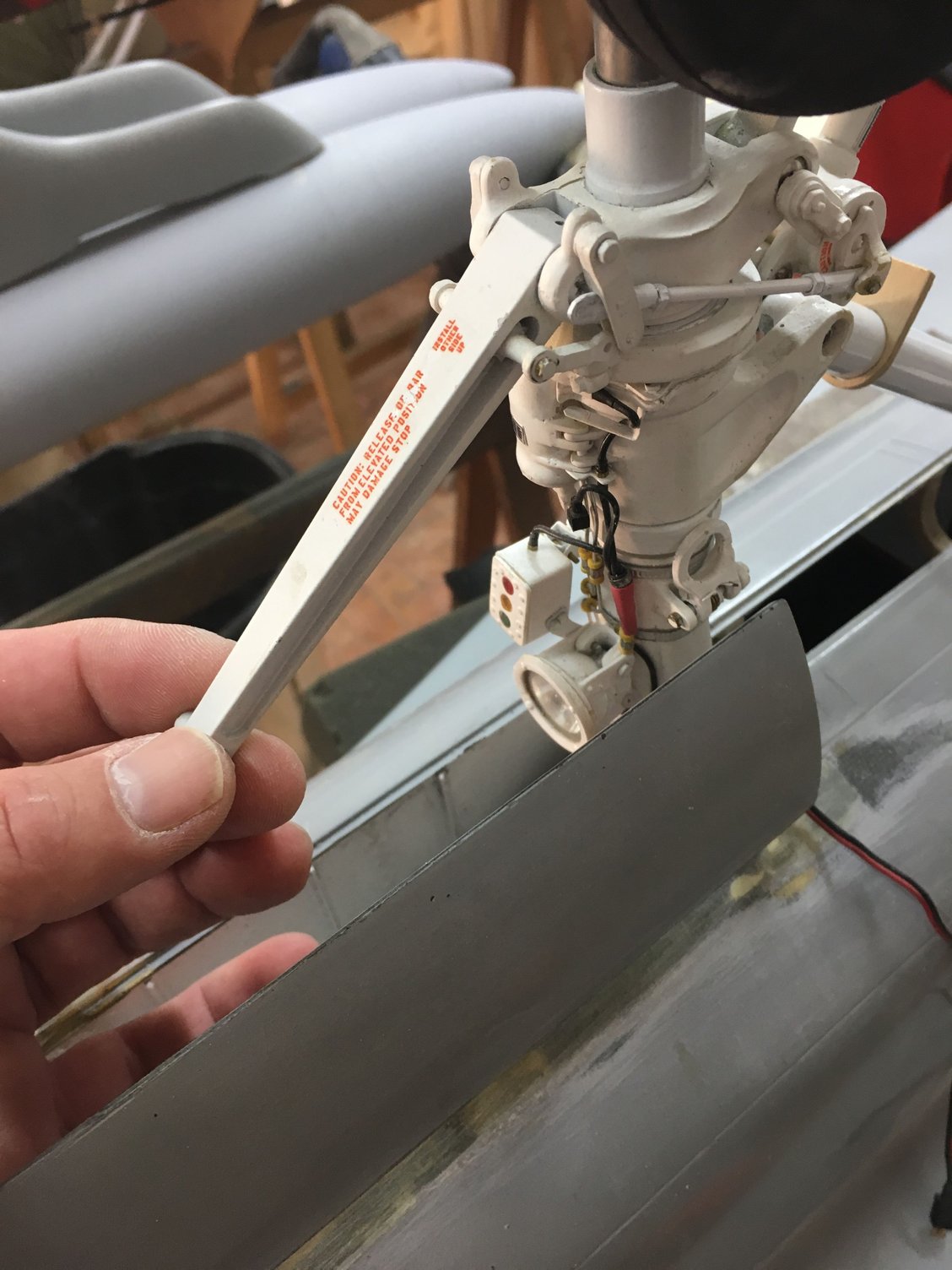

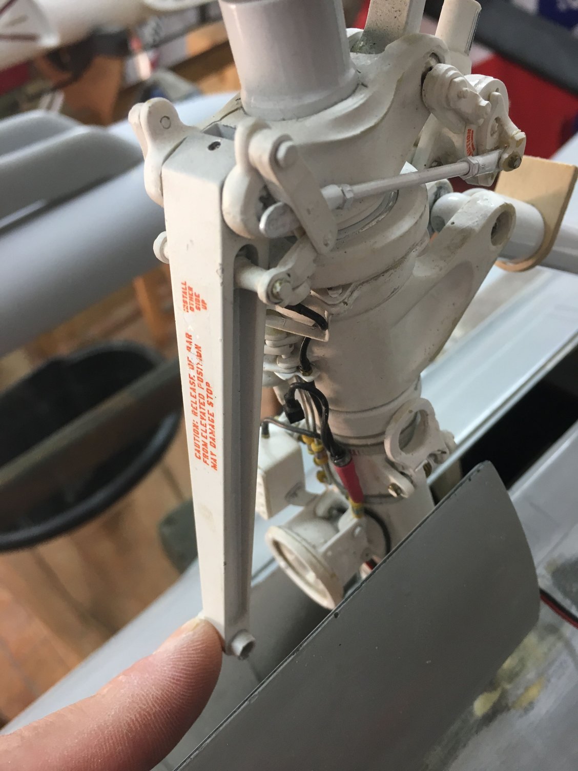

Furthermore, the tow bar can’t lay completely flat because of the scale details on the strut such as the landing light etc as one can see in the pictures attached .
best solution as I see it and what I had done, is simply follow the instructions , place the servo behind the retract and control the steering via pull pull cables . No issues .
I honestly think a solution was given to non really existing problem .
I will update date on the tires as soon as we are ready , rough guess 6 weeks .

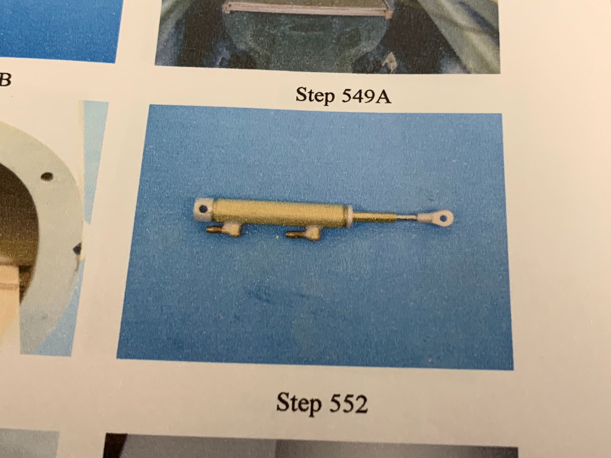

What type/brand air cylinders are you guys using on the gear doors? Is there a list somewhere of the recommended stroke length for each door? Thanks!
Old 05-19-2020, 10:12 PM
  #83
lavi rider
Join Date: Jan 2003
Posts: 1,268
Default Ya bug
From Ultra Prescision , the sizes are in the build manual if I recall .

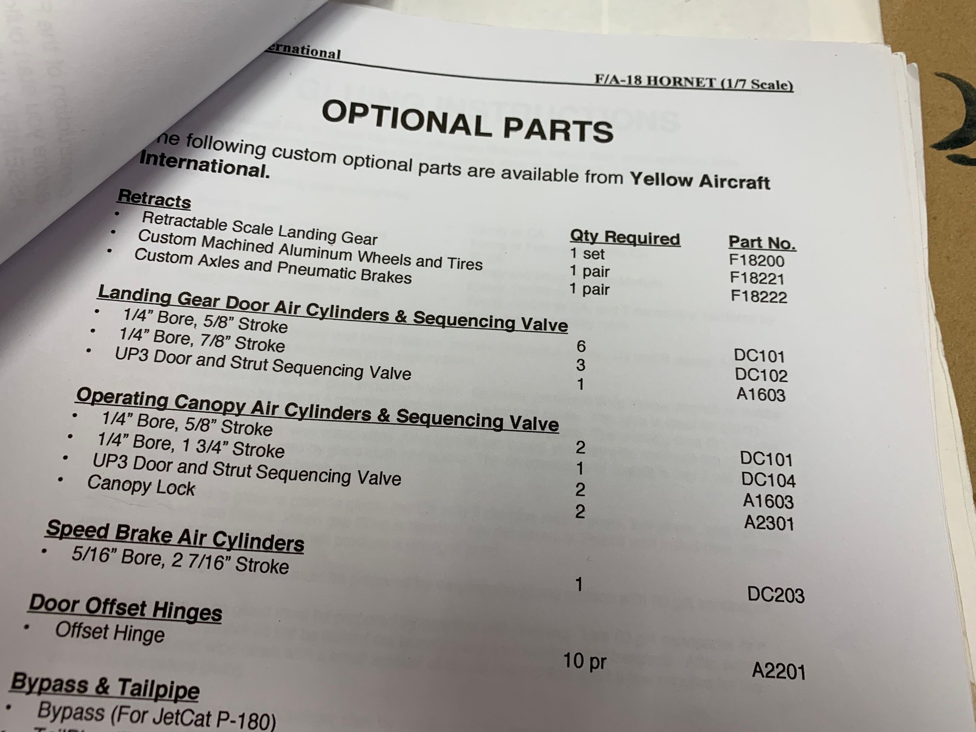

Old 05-20-2020, 06:23 AM
  #84
Auburn02
Join Date: May 2005
Posts: 849
Here is the list from the manual:
Old 05-21-2020, 09:57 AM
  #85
Airforce7
My Feedback: (31)
Airforce7's Avatar
Join Date: Feb 2004
Location: Brentwood, CA
Posts: 1,031
Default Spare air cylinders
Thanks guys! When I got the F-18 it was already built ready to fly. I remembered I was given the manual so I checked and sure enough the parts listing was there. My cylinders look a little different from what's on the MAP site. Did they redesign the air cylinders? Was there an issue with the original design? I want to be able to source the air cylinders should I need to replace one in the future.
Air Cylinder from Manual
Installed Air Cylinder
Manual Parts Listing
Old 05-22-2020, 06:27 AM
  #86
grbaker
My Feedback: (29)
grbaker's Avatar
Join Date: Dec 2001
Location: La Porte TX
Posts: 3,470
In August of 2017 I ordered and received a complete set of air cylinders as well as other F-18 parts from Jason @ FunKey.
