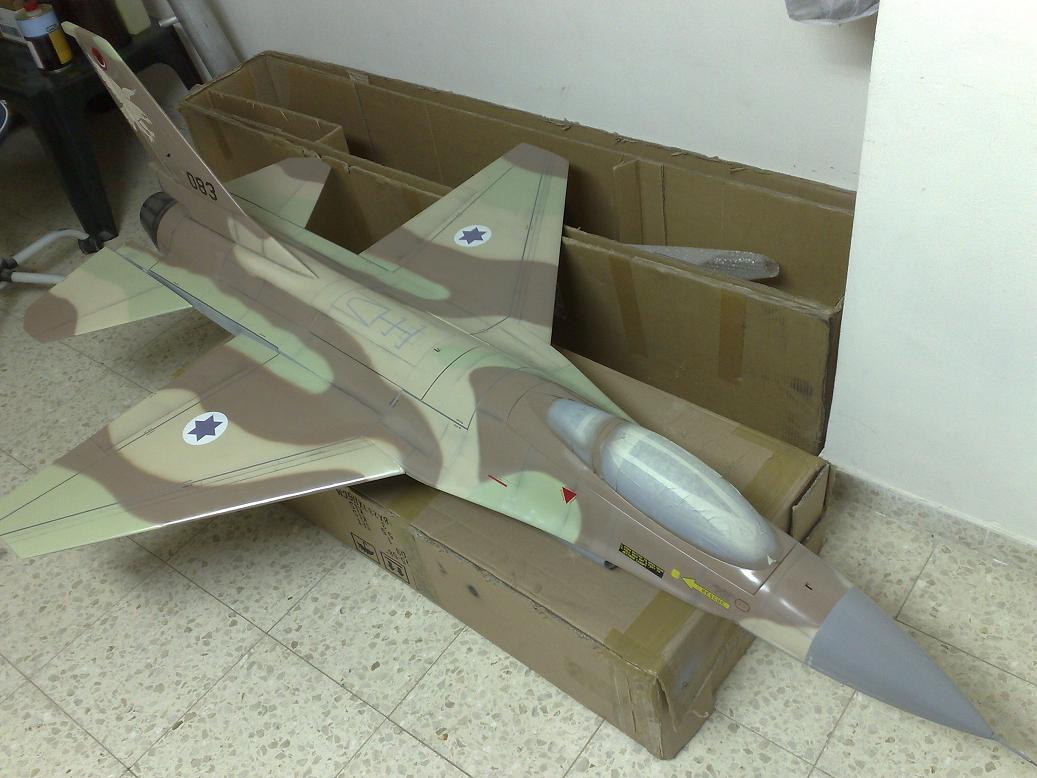

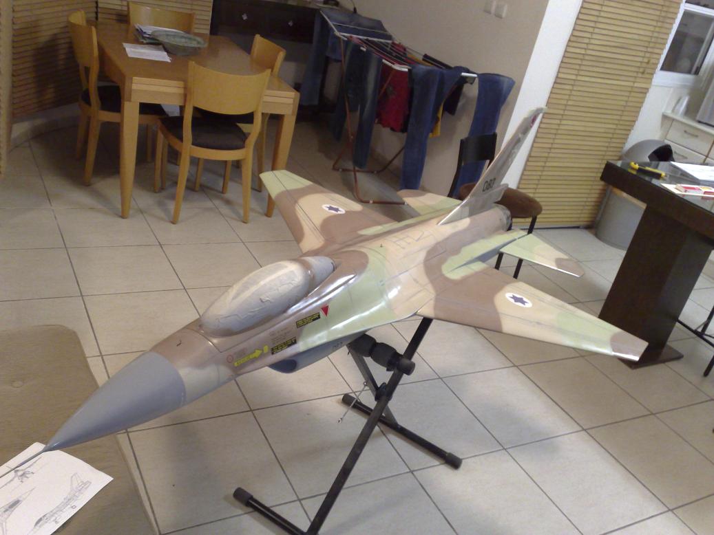

Panel lines, walk lines, final decals all ready, and she is ready for matt clear coat.

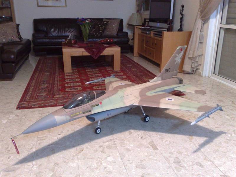

Hey Guys,
WIth the help of my good friend LaviRider, in the past 2 days the plane has been clear coated to a perfect realistic dull finish, using Standox vehicle paints.
Here are 3 pictures that demonstrate the finish.

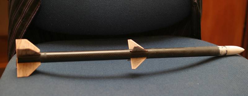

Another thing that Lior (i3dm) wanted is a set of scaled down missiles for this plane.
I built him a set of 1:9 scale of AIM-120 AMRAAM.
as you can see from the pictures, the missiles are easily attache and detache from theire carrier that will be glued to the wing tip.
each missile is made of a carbon tube (heli tail boom), the fins are thin plywood sanded to an airfoil shape.
the tabs are plywood glued securely to the missiles with the appropriate bracket inside the carrier to fit the tabs.
all-in-all, it came out very nice...

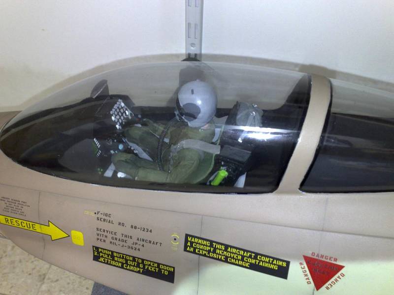

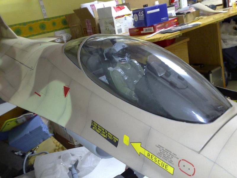

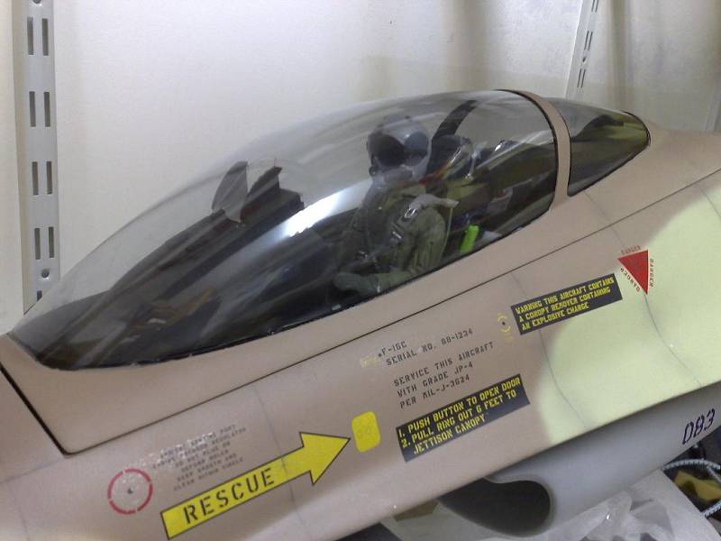

With some slight mods i was able to install a Tam Jets 1:9 Scale F-16 cockpit - its beautiful and adds a touch of realism.

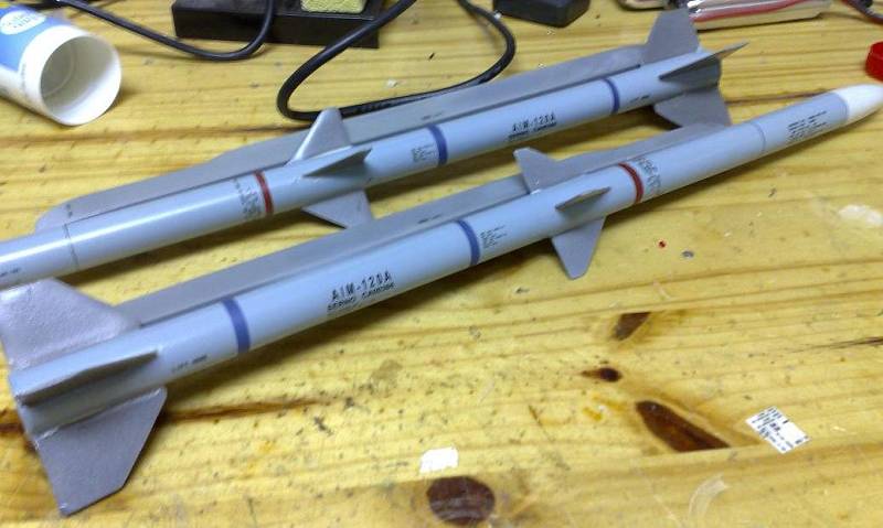

OK guys, AIM 120 missles are ready, decal'd, clear coated and missle holders are glued to the tips.
Time to start installing components..

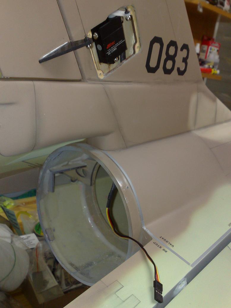

Hey guys,
After some time off this project (was busy with school) im finally back to finishing the F-16.
I have notched the rudder and installed the CF rudder horn, made a tray for the batteries in the nose (note lightning holes) and painted the inner wood with sanding sealer (to seal off the wood) and than gray paint.

In the meanwhile, while the gray paint is drying overnight, i decided to do the rudder servo mount as well.
This was simple - bolt the Hitec HS-125MG thin servo to the Tamjets mount, roughen the back of the mount with an Xacto blade, and glue in with 30 min epoxy mixed with some Aero-Seal to make it thick so it wouldnt run.
I positioned the entire servo with mount in the fin, in order to get the correct location for the servo horn, and while the plane it on its side, put some lead weights on the servo body to keep it in place until the epoxy hardens.

Today, i finished the rudder servo intallation and linkage, and later, with the help of my good friend Ravivos, i installed the landing gear and took her out for a short picture session.
She is looking awesome on her legs !

I used pencil to draw panel lines and a soft pad to create the smudge effect.
