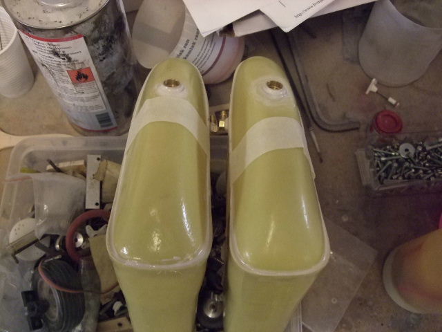

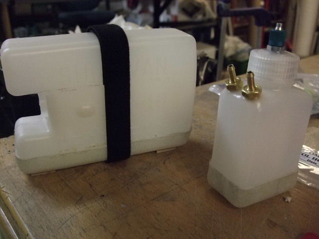

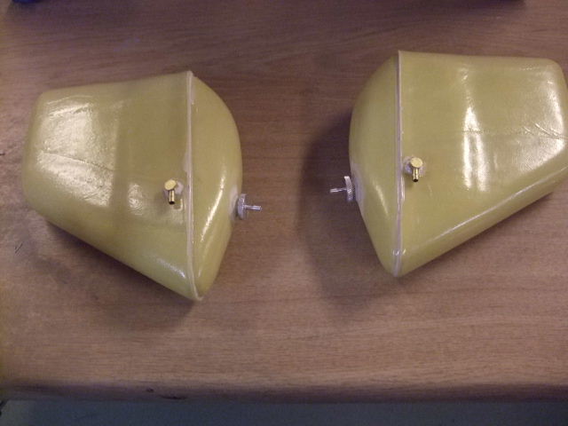

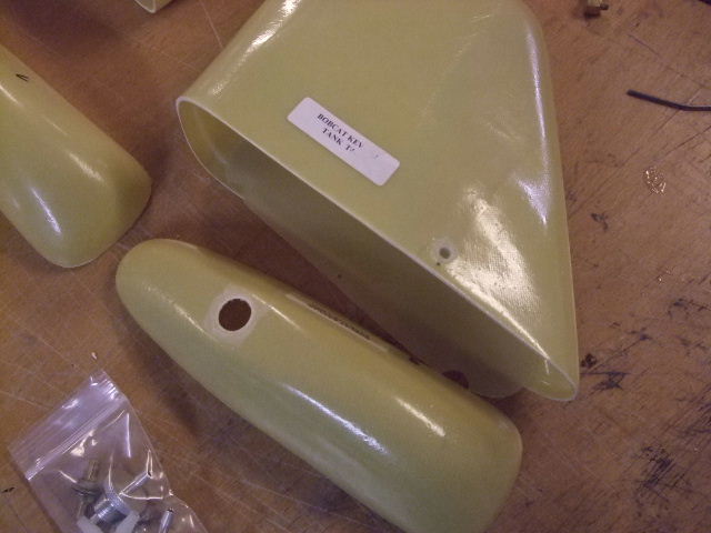

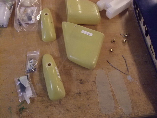

Fuel cells in kevlar!
I use BVM hysol to put them together

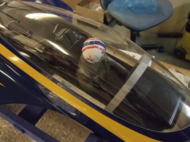

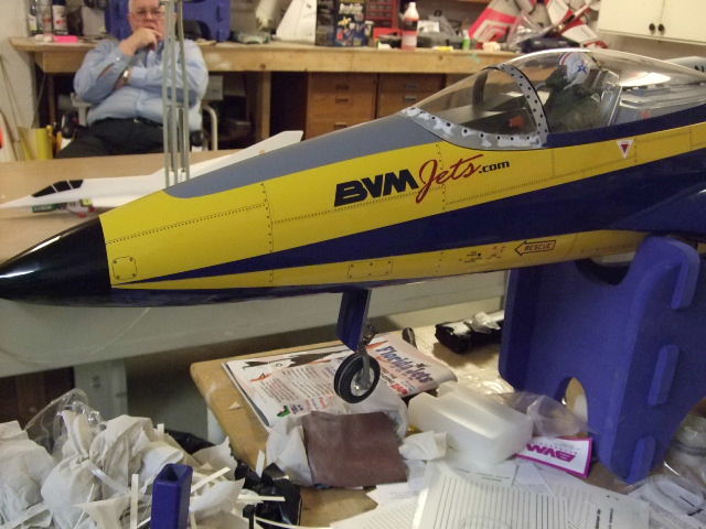

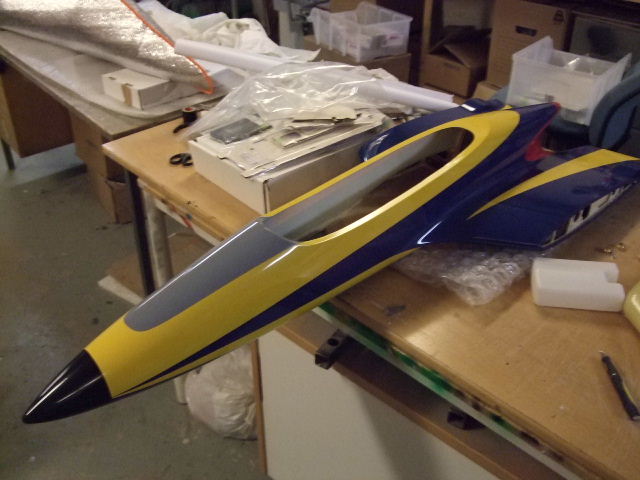

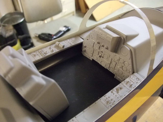

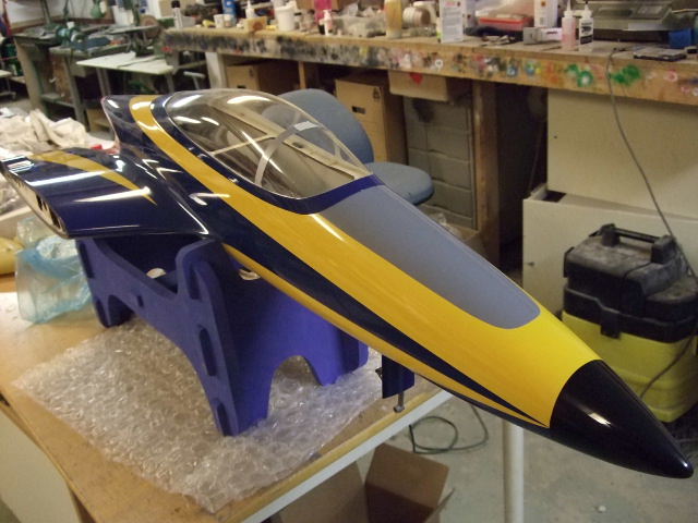

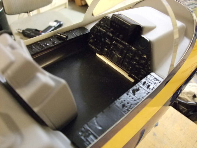

Cockpit and Canopy
I make my own Cockpit/Clear canopy!!

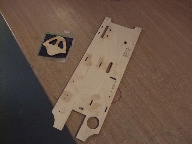

Hi Lasse,
Here's a tip for you.
When you do the cut outs for the main retracts, cut inside the pips on the fuselage, then dremel out to size.
It's easy to make the hole too big if you go to the pips on the first cut.
This is mentioned on the drawings but easy to miss.

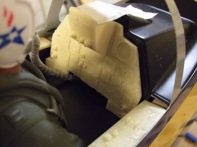

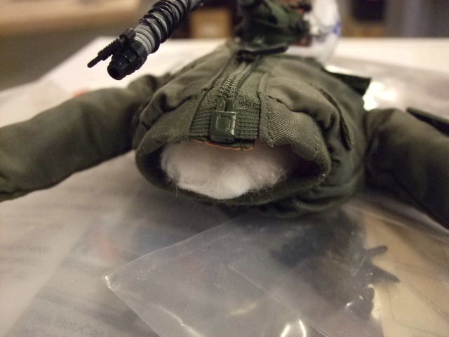

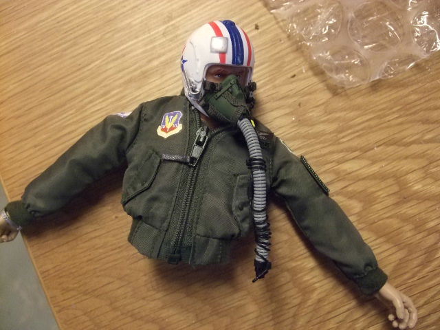

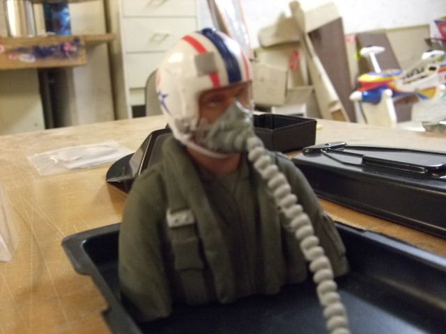

I killed my MGA pilot and made a new special LP-pilot

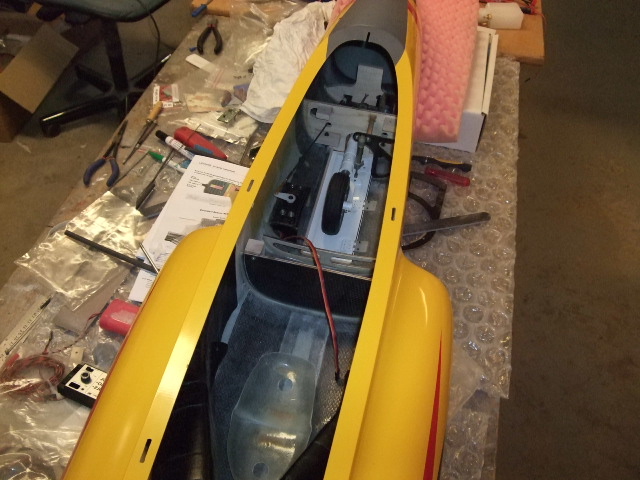

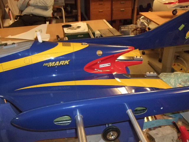

Main Gear installation.

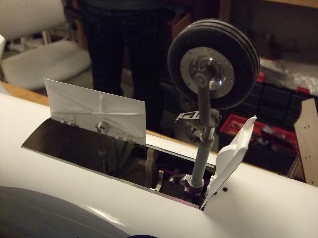

Nose Strut Door

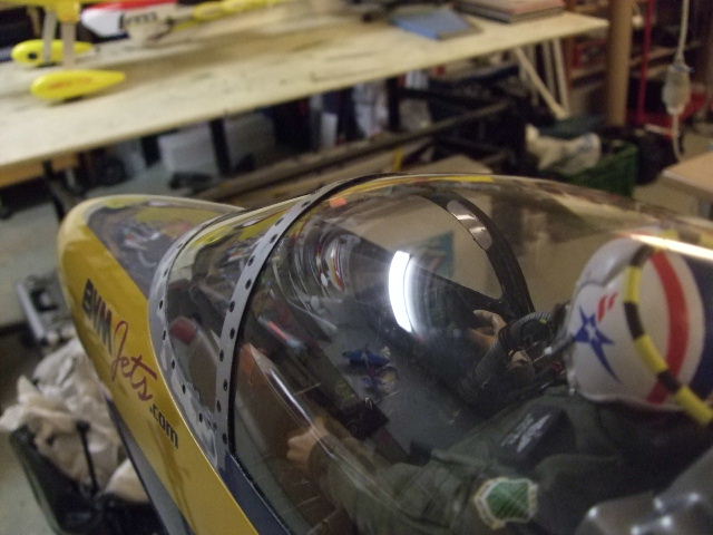

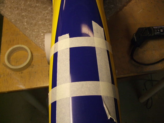

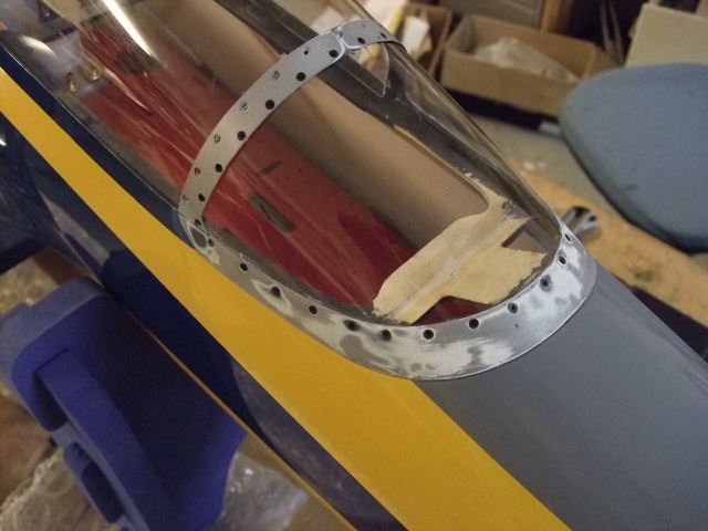

I have a small problem with the canopy framework!
The blue color on the silver color is not the best solution!
the blue color is not fixed.
I think BVM must look at this color problem
It was same problem with my King Cat canopy framework!!

I made mirrors of bad CDs to my Bob Cat!
I used the same CD on my UB..[8D]

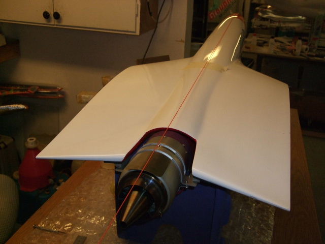

Engine installation!
Jet Cat P-70
I am using a cord and plummet to get the turbin installation straight

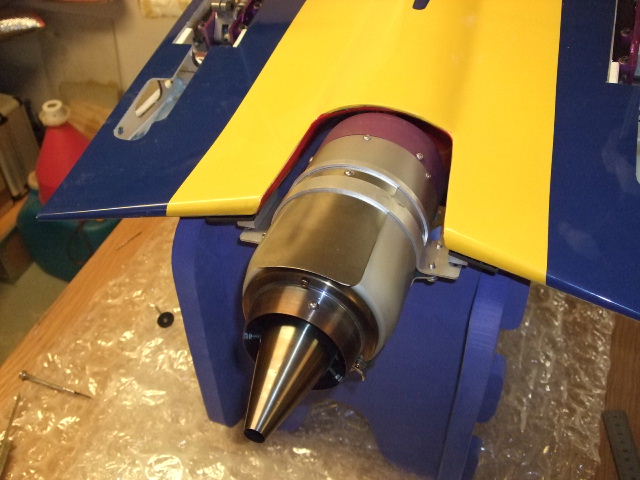

More pictures!

This is my first Jet model with Futabas 2.4 GHz
I am not sure about the 2.4 Rx placement, does anyone have a pictures on Futaba 2.4 GHz Rx installation in a Bvm Bob Cat Composite!
Where is the receiver in the model?

I am waiting for JR/Futaba servos.
So I have started to decorate my Bob Cat with Promark dry transfers

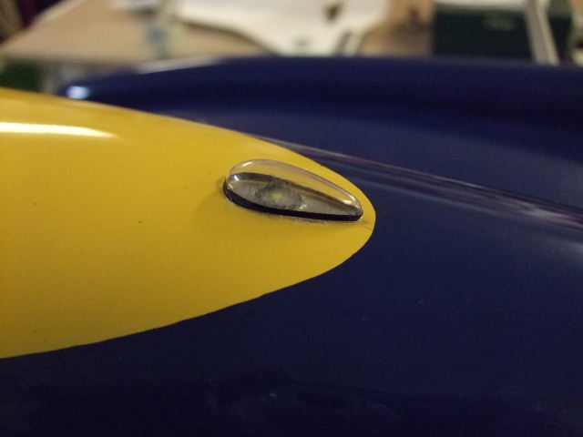

I will use navlight from modellbaue.de

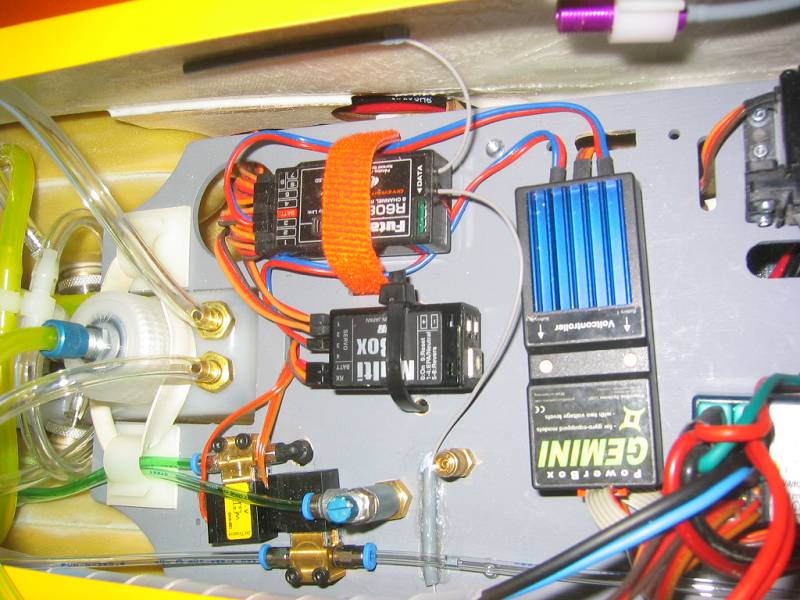

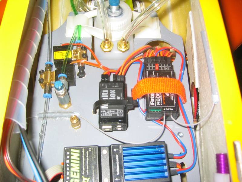

Pics of a Bob Composite with FASST 2.4
The first pic is with a PCM RX but the FASST one goes in the same place (i.e. the standard RX location on the radio plate). The second 2 show you how I have installed the FASST RX. It's not very pretty and am I sure you will do better but it works. I have about 10 flights on mine with no issues.
ID:	1119029   Click image for larger version
ID:	1119030   Click image for larger version
Old 01-25-2009 | 07:07 AM

Lasse, great idea how to make cockpit mirrors from old CD's.
Sicklick33, thanks for the radio tray layout, I'm just doing mine. First venture into Futaba FASST also.
I will be using 6014 Rx so hopefully no matchboxes.
