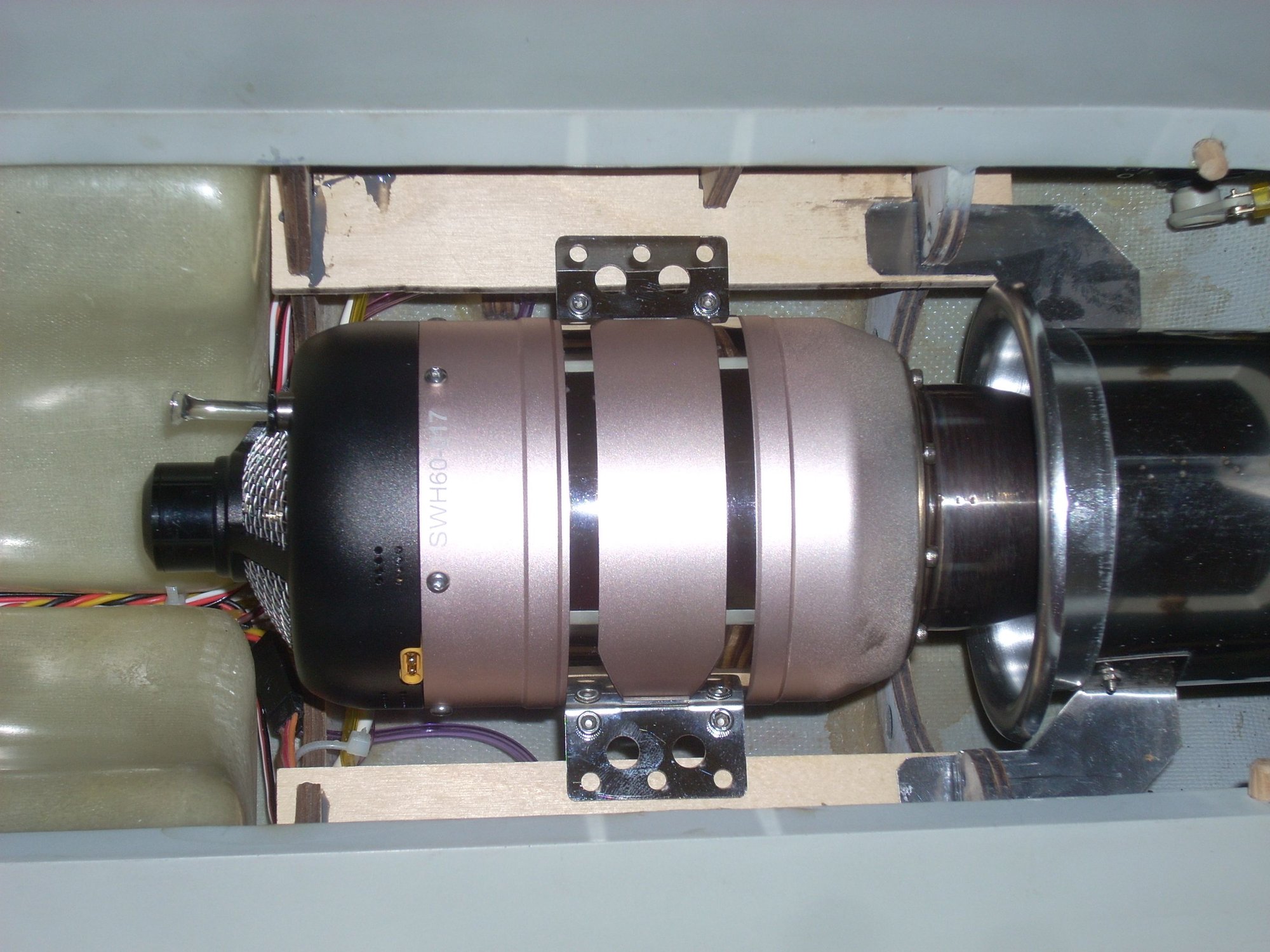

Managed to get a scale cockpit and tank pylons from Hans in Canada. Also fabricated my own turbine mount rails and the cross brace.
Got all the servos installed, and decided to start working on panel lines. Got the top of one wing done so far. Still need to paint the elevons white (already did the rudder). The panel lines were drawn in with a charcoal pencil, then feathered with a short-bristle detail brush. I will put a coat of dull finish over it to protect the finish.
The Swiwin 60B will fit in there nicely!
