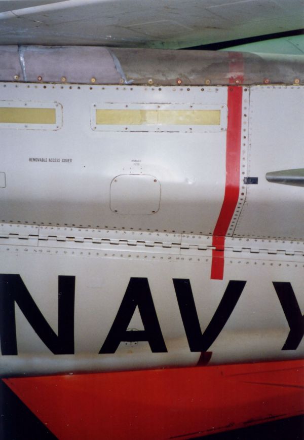

What's the shape of this rubber bladder thing.
Anyone have a picture of what it looks like.

ORIGINAL: Mike Emilio
Mike,
if you look in this photo you can see a "khaki" colored part on the upper part of the fuselage that is screwed to the fuselage structure. This is the wing "sealing" bag, that is on the upper part of the fuselage aft of the over wing fairing. When the wing sweeps back, this "bag" inflates sealing the gap between the fuselage and the wing.
and a couple pics showing the area on the airplane:

I have in mind something like a long belows, similar like you use to blow on a fire.
If the belows was side hinged on the inboard, of the area shape, then put into a corresponding shaped rubber bag. Almost sounds like the wing would gently push it down when swept, then spring back up when the wing clears it on extending.
I can mould a rubber bag to any shape, just need the bellows mechanism inside.
It's a long way to go to get to this stage but something to think about.
