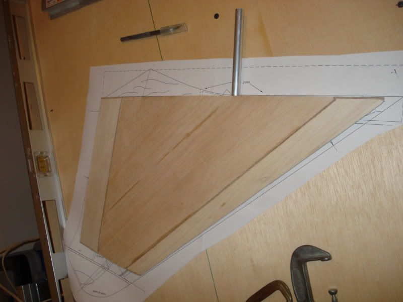

Lil bit more work done so far today.. Made up the root and tip blocks for 1 stab, and the tip block for the other. Ran out of balsa to do the root block for the other stab. I've still got to sand both of them, but other than that, they are done minus glass and detailing. I also took the stab shaft bearing mounts and installed them to there respective bulkheads, make sure the bulkhead centerlines were aligned. After doing that, i couldn't help but slide the stab shafts into bulkheads. This really gave me an idea of exactly how big this model is going to be. the ruler is 20" long in the picture.

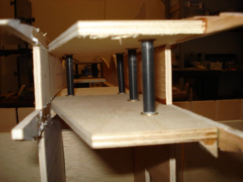

Thomas, as i told you i would send you pix, here is how the hatch is on mine. The main sliding mechanism is the Radio Antennae on the top, from there a thin music wire is routes o the back and is attached to a 1/8 inch brass tube that goes out laterally to two bvm hatch latches and those engage the fuse. It works great and is totally hidden!Hope the pix help

Now thats so simple i would have never thought of it.. thanks for the pics nick.

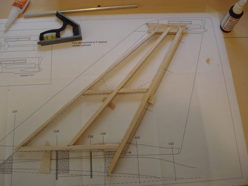

One horizontal stab is complete and ready for glassing... If i can find my fiberglass and have enough laminating resin left, i might get that done tonight.. I also got the mock-up wingbox assembled and installed to the C20 and C21 bulkheads. Using 3 squares, 2 laser levels, the jig i cut out earlier and about 45 minutes later, I got it all lined up. Wing box is made of 1/4" thick birch ply w/ 1/2" balsa triangle, and then AN-3 bolts w/ 1/4" OD carbon spacers. I wasn't going for strength on this box since its just used to align the 2 bulkheads together so the wing incidence can be set later on.. Here's pictures. I'm going to try and get the other horizontal stab done tonight as well, so the tail will be done minus the verticals.

**Update 2 for the day**
The Second stab is done minus a bit of filling and final sanding... should have that done tomorrow.... Now its just a matter of time to wait for 2 more drawings to get here, along w/ a balsa order. I've got the stuff to make up the wing spars, so i'll probly get started laying out the wing ribs and spars so the wing panels are ready to sheet by the time the balsa order gets here. I should have the stuff for the TCS pod under the nose as well, i've just got to come up w/ the drawings for that one... Which i'll probly do this week while i wait on those vertical stab drawings to get here.

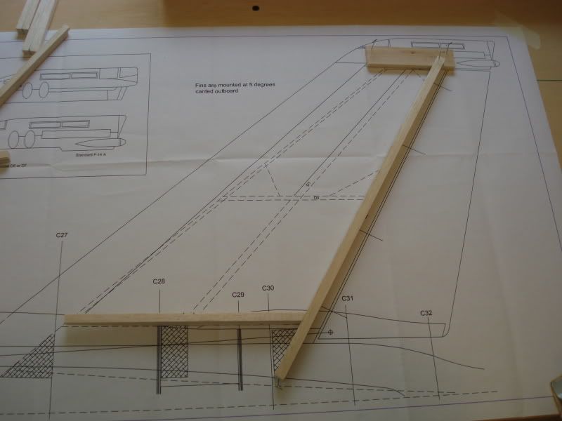

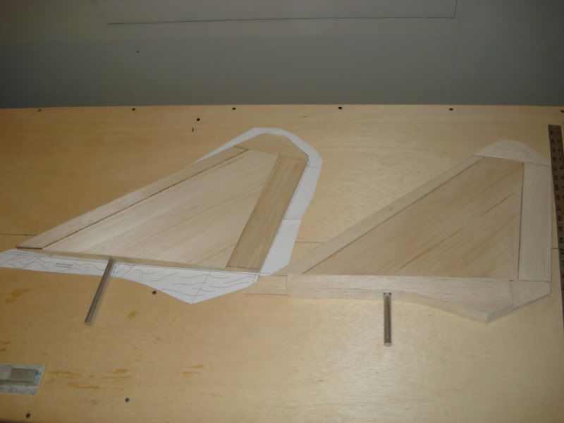

Both horizontal stabs are done and ready for glassing. Hopefully the LHS will have some Finishing resin, so i can get that done this weekend.. I made my balsa order.. about 90 sheets of balsa (60 of which are 3/32") and a couple of blocks for the slats, wingtips, etc.. Got 2- 16oz bottles of glue as well.. Hopefully that stuff will arrive on tuesday or wed. of next week. I'm going to try and get the vertical stabs and rudders done this weekend as well, so when the balsa arrives, its a matter of getting the wings built and starting on the fuselage.

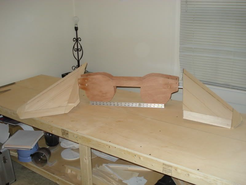

Both stabs are complete and ready to be fiberglassed, primed and then surface detailed. The plans for the Vertical stabs arrived and i'm going to build them and the rudders before i do the glass work to the horizontals, that way i can do all four at once (i've got to do a bit of fiberglassing on the rotors of an autogyro i'm buidling for a friend as well). Here are 2 pictures showing the horizontal stabs mounted into the stab bulkheads w/ a 4 foot bubble level for size reference (as if yall haven't gotten enough of these already)

2 more pictures... Does it look like an F-14 yet?
