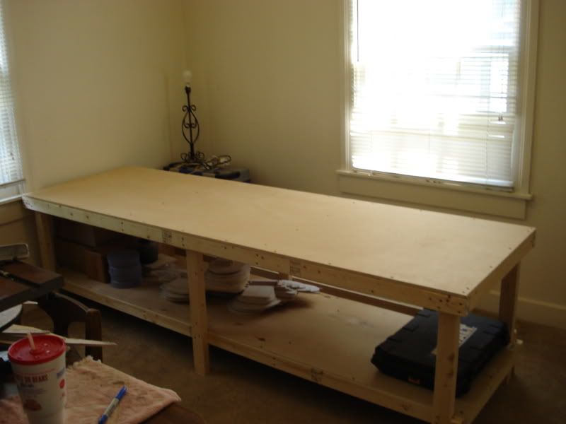

So i have begun the build of a 1/7th scale F-14. Some are probly going "why, xxxx company has one / will have one coming out".. Main reason... mostly b/c i want to But some other reasons are b/c on some of the others i have seen pictures of, some of them have some scale defencies, engineering i just personally dont like, to small of size, etc etc. So thats the reason for this. I'm planning on doing this "harold huff" style w/ plugs that are lithoplated, then molds and an all composite airframe. I was lucky enough to get a set of plans from Mike Emilio at http://www.cmsmithplans.com/html/catalog.html to get a head start. I've been stocking up on books and other materials for scale documentation as well. I've been working on some of the mechanical stuff in cad for the past couple of weeks, and just recently got started on some of the saw dust making procedures. I plan to keep this thread updated with new pictures through-out the entire build as i'm wanting to make this an "extreme" scale model that will have a quality in par with the airworld stuff. I am "thinking" of selling some airframes once the molds are complete to offset some of the cost as well, but honestly For this to happen i'd need to raise of hands of who would be interested in a high quality scale Tomcat and a price range they feel would be reasonable.
I'm planning for the model to have scale hinging flaps and leading edge slats. I still haven't decided how I want to actuate the leading edge slats and speed brakes.. but a hausl hydraulic system for these along with the landing gear are in my mind as one of the easiest ways...
Ok, enough of the rambling.. here's some pictures: Any questions, or comments are of course welcome and highly encouraged. If you have any documentation of a F-14D and willing to share, please let me know, as i'm always looking for more.

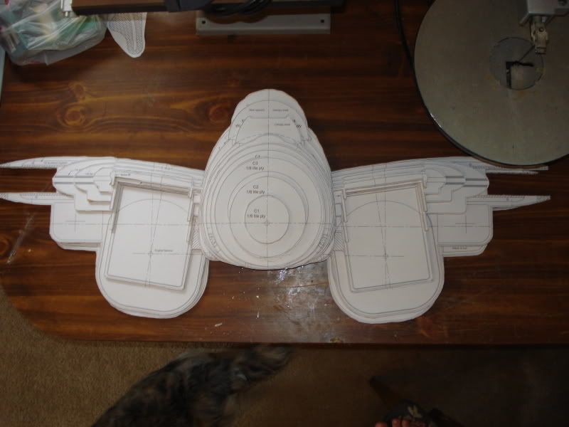

i cut out the formers using a good ole hand held jig saw w/ a very fine tooth blade, a dremel scroll saw, and a 1" x 30" table top belt sander. If it hadn't of been for that belt sander, it would of taken me months to get the fuselage bulkheads sanded to size, but with the belt sander it only took about 9 hours to do all 33 bulkheads. I looked into having all my parts laser/cnc cut but no one had a table large enough to keep the fuselage bulkheads in 1 piece (largest bulkhead is 12" tall x 36" wide) and all wanted to use birchply. Since the bulkheads are for the plug, i wasn't worried about weight and more worried about cost.
All of the bulkheads are made out of the 6mm luan plywood from home depot. It took approximately 1 1/2 4x8' sheets.. and at $9.87 a sheet, the price was more than worth it to hand cut them.

Short kit is 99% complete. all i have to do is cut the spar slots in the wing ribs out and do a wee little bit of sanding in the corners and she'll be ready for construction to begin. Pictures to come later tonight.
Old 06-23-2009, 08:34 PM
invertmast
My Feedback: (23)
invertmast's Avatar
Join Date: Dec 2003
Location: Capon Bridge, WV
Posts: 8,183
Received 217 Likes on 110 Posts
Default RE: 1/7th F-14D Scratch build thread *building started*
Ok,
here's the pics of the short kit. i've still got to remove the spar cutouts, but other than that the short kit is done. After looking at some detailed photo's and 3 view drawings, i've noticed a very large discrepancy in the line drawings of the plans between the Trailing edge of the wing and horizontal stab. This area should have a inward "sweep" towards the centerline of the fuselage, and the plans are just "straight". This should be a fairly simple task to fix, as all i'll have to do is measure the discrepancy between the 3views and the actual plans and do some math to figure out how far the side of the fuselage needs to be moved in, then just copy the current shape at this new mark and trim to the new dimension and we'll be good to go!..... This is no fault of the designer, as i believe it was intentional to make the building process easier..
Each wing rib is 3/16" balsa, except for the 2 most inward which are 1/8" ply. All of the horizontal tail parts are 1/8" ply. The vertical tails are a combination of 3/8" and 5/16" balsa.. If your wondering why their is only 1 of each part, the parts are actually doubled together so each pair of ribs are identical side to side.
enough of my babbling... here's some pics:

I double checked that side indent Thomas.
The plans will generate a side indent, but could use a bit more.
Geez, , , that's gonna be a real terror for sheeting because of the concave shape.
It should indent inward an additional 3/8" more from the current line.
Sending you a pm showing which formers to adjust. I'll update the master.
