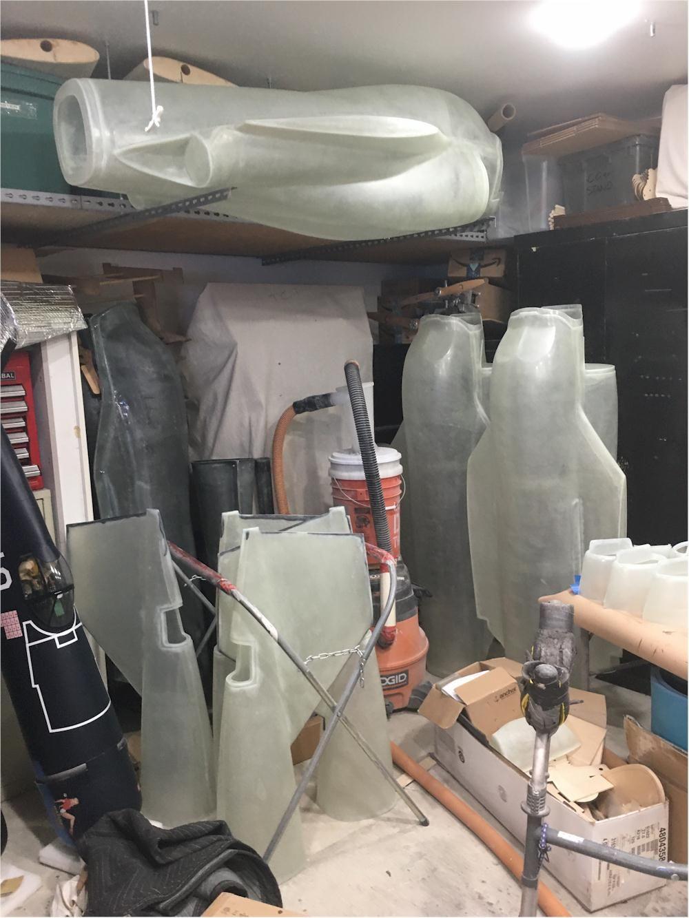

That was the hard part. Think I have the legs worked out. Will know in a week. Vertical fin is in the mold. The fuse is two piece parting just after the exhaust fairing. If you look at the head-on pic you can see the rear end laying on the floor in the background. Hope to pull three by first ~ second week of Nov.

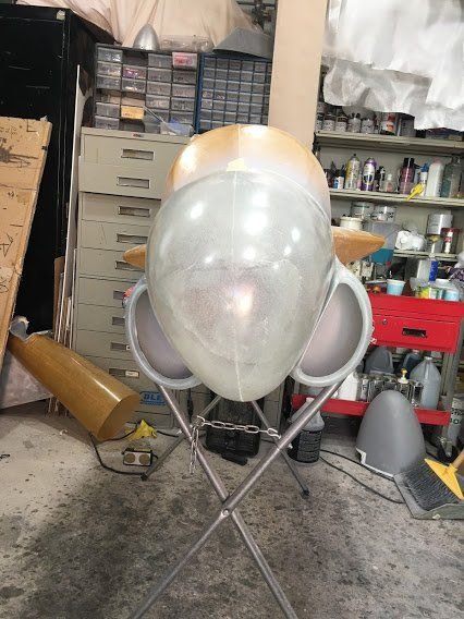

Things have progressed on our 1:5.5 upgrade of the A6's used in the "Flight Of The Intruder".
Santa arrives on Friday the 13th...These weigh 30% less than the movie fuselages...and much easier to transport. Now the wing building begins.

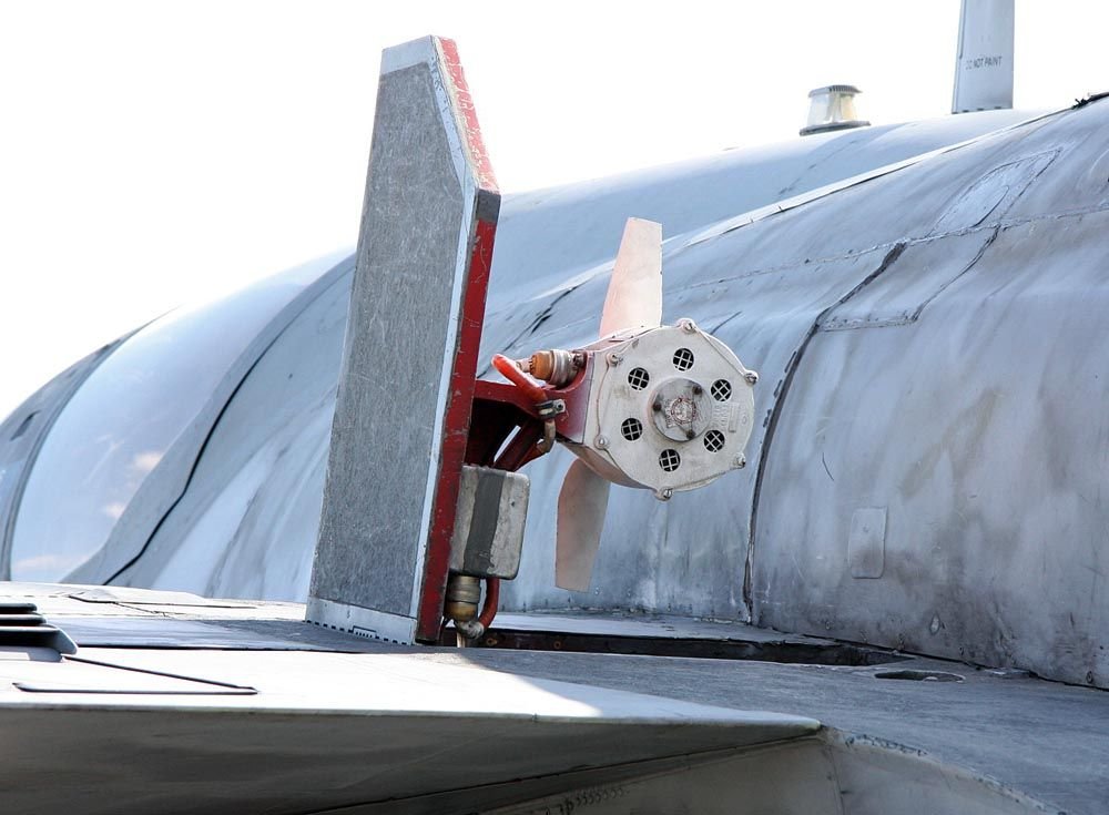

Actually there are several surface details which will be Flite-Metal. A6 fuselage panels were sealed with black caulking compound and over time appeared rough edged and in some cases almost warped from frequent maintenance. An interesting feature of the A6 wing is a hardwood ply hatch cover for the RAT aux power unit. There are two panels, one on each wing which will have a Flite-Metal panel in those positions. I have not decided whether to or not to make a pop-up RAT in the left wing...

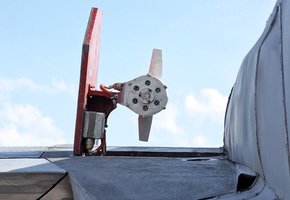

RATs are under rated. that example does look like a 60's unit! just missing the warm glow of some vacuum tubes somewhere along the line

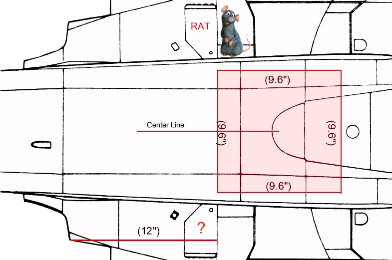

The RAT is only in the left wing though there are two identical RAT bays. Does anyone know what is in the one on the right wing?

I found interesting the airlines still have these
