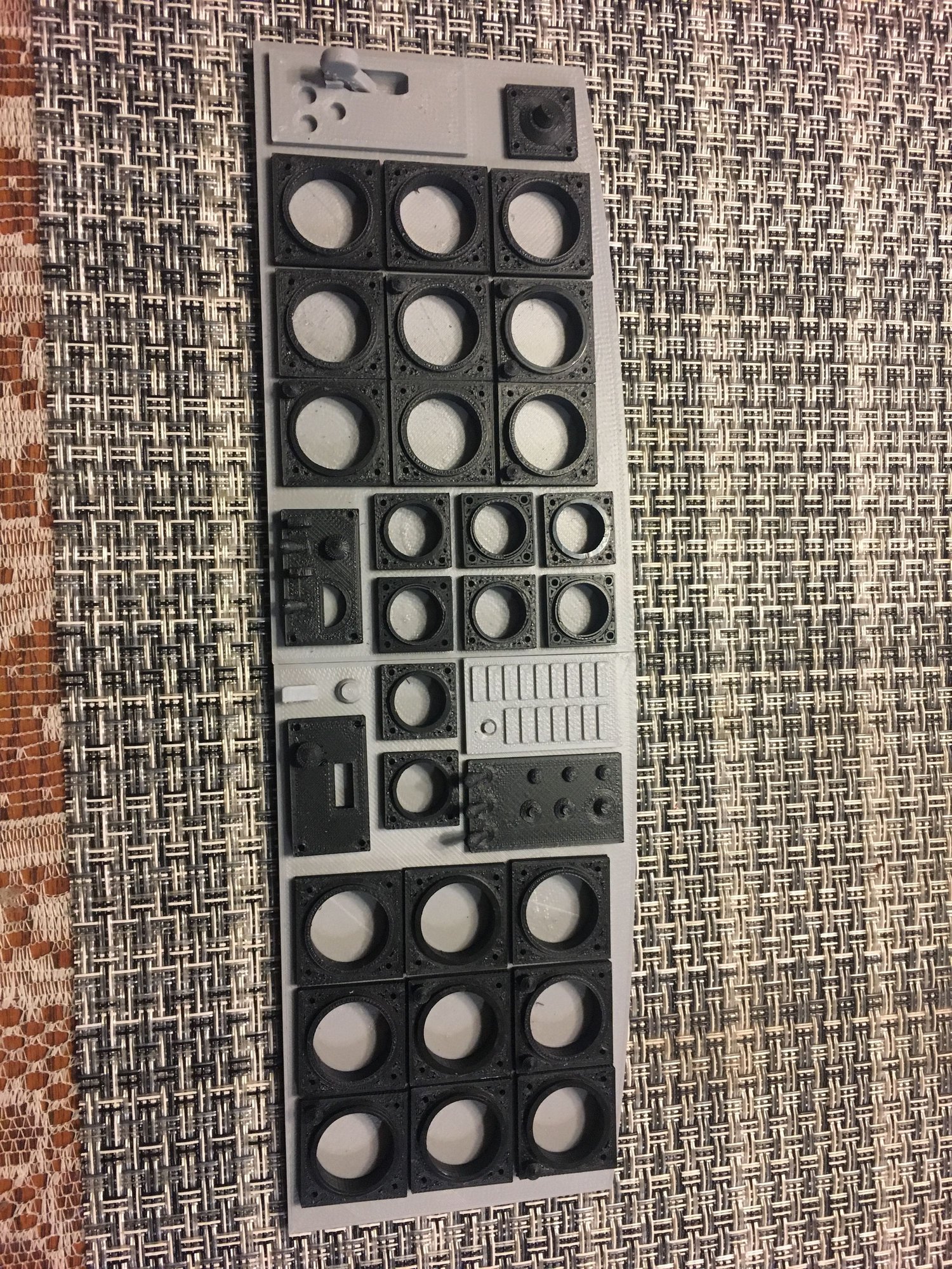

Hi Alan, I have an older 180rx to install which should be enough thrust. I have the Behotec c50 electrics with linear actuators on the gear doors. Iím installing air brakes using Chrisís laser cut kit and will install linear activators to drive them. Planning to have an operating canopy and unilights nav/strobe, spots. I have a smoke pump but will wait to see what my interior comes in for weight before installing the smoke system. Iím hoping to limit the interior to 1.5lbs, 2 ejection seats, center console and panel.
Still need to finish the panel with instruments and bezel glass and airbrush, so still a work in progress.

Great looking dashboard. Donít worry about the added weight in cockpit. I donít think there were many off these flown that didnít have to have significant ballast added in the nose. All of mine did. Also just a thought about the air brakes, have lots of throttle ready when you apply them, when I had full flaps and air brakes on my first one it needed 3/4ís throttle. This was on a 160sx. On a 180 I would expect not to have that much, but a fair bit.
Will look forward too seeing when when you complete it.
Alan

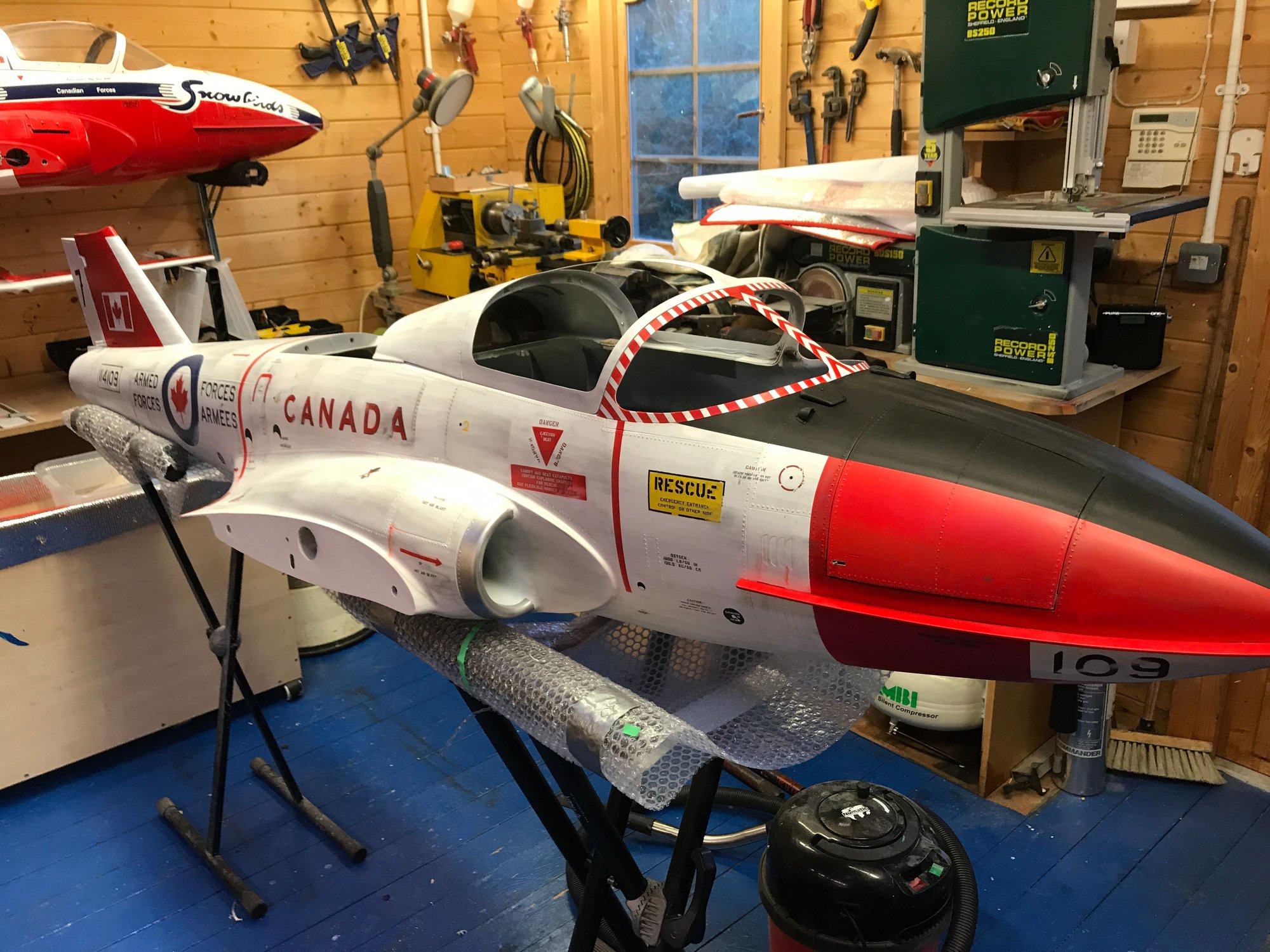

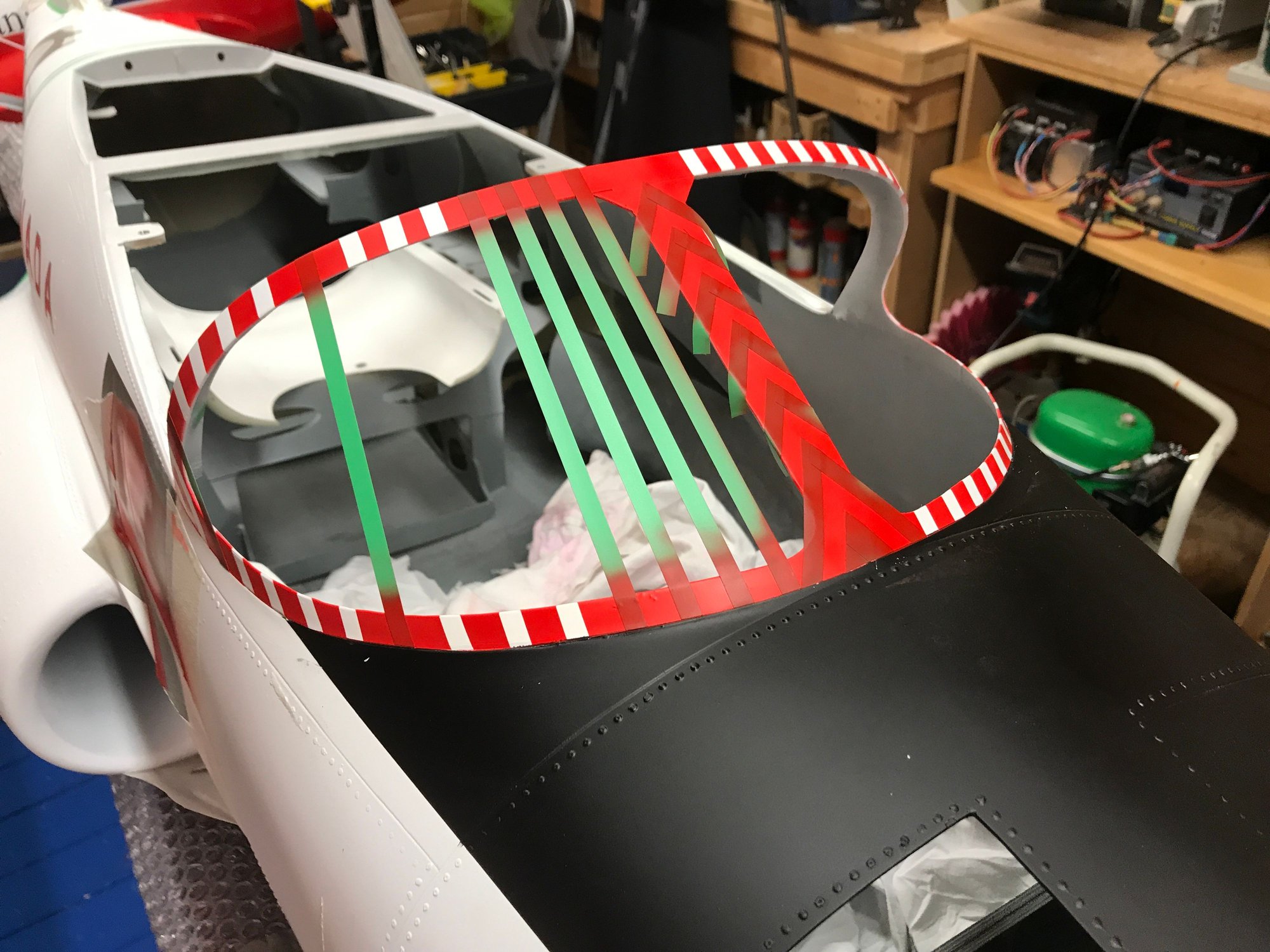

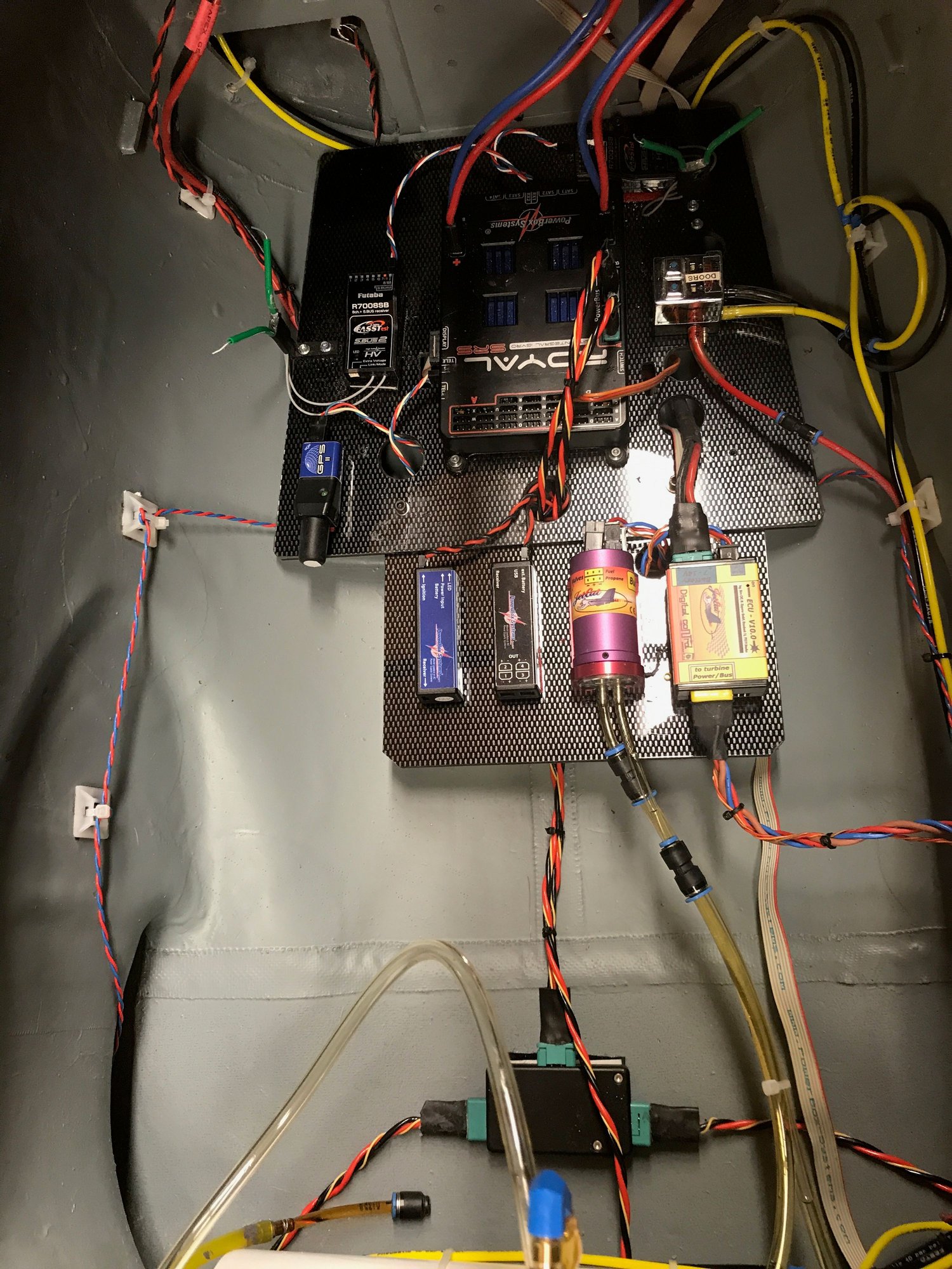

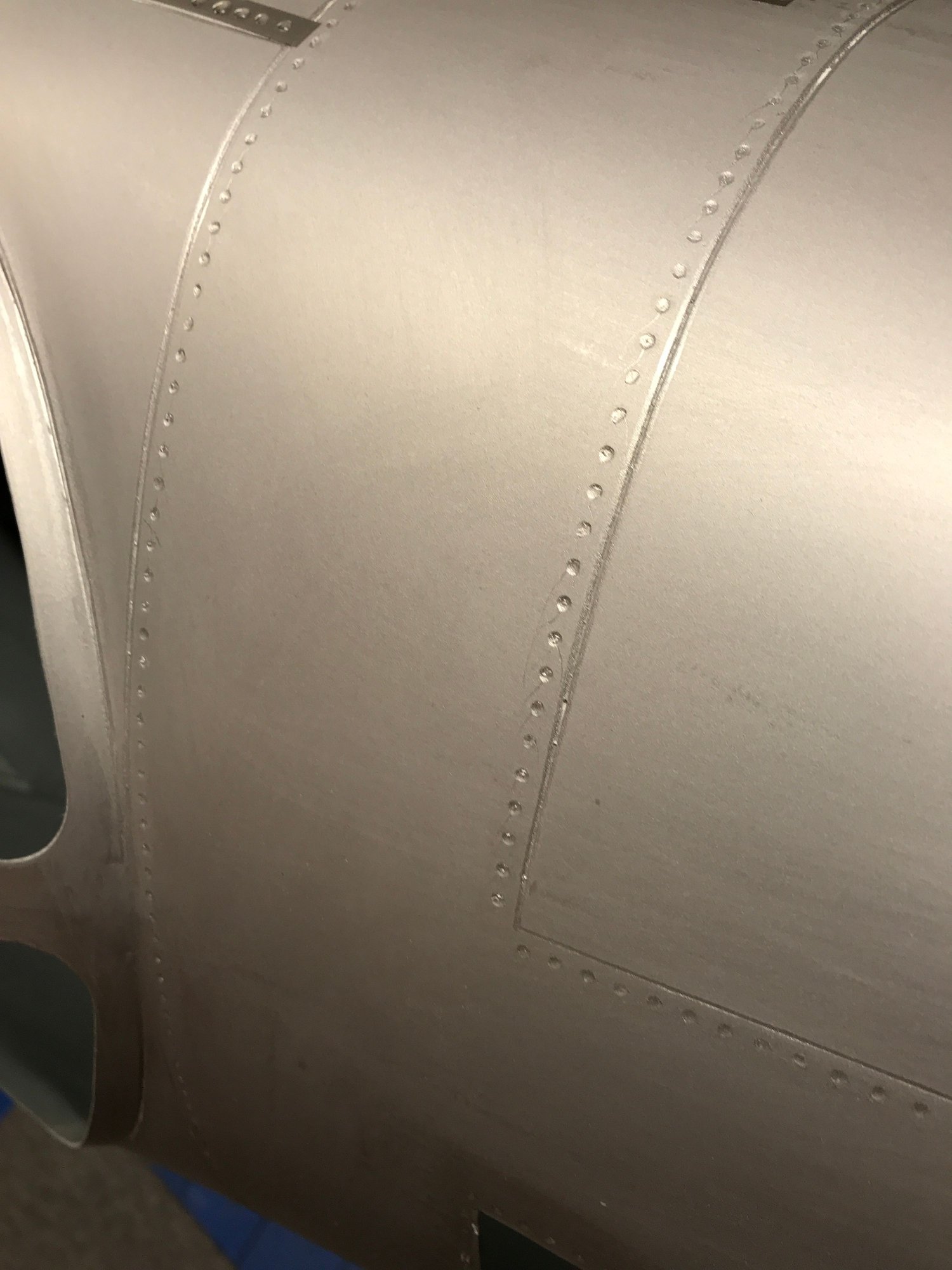

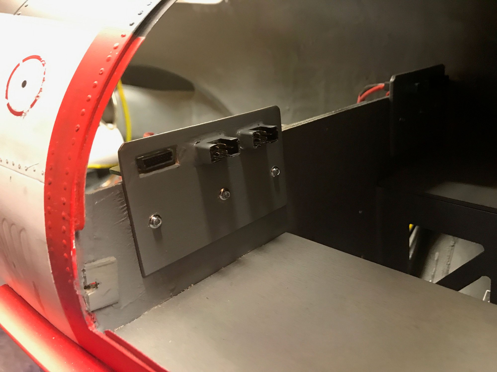

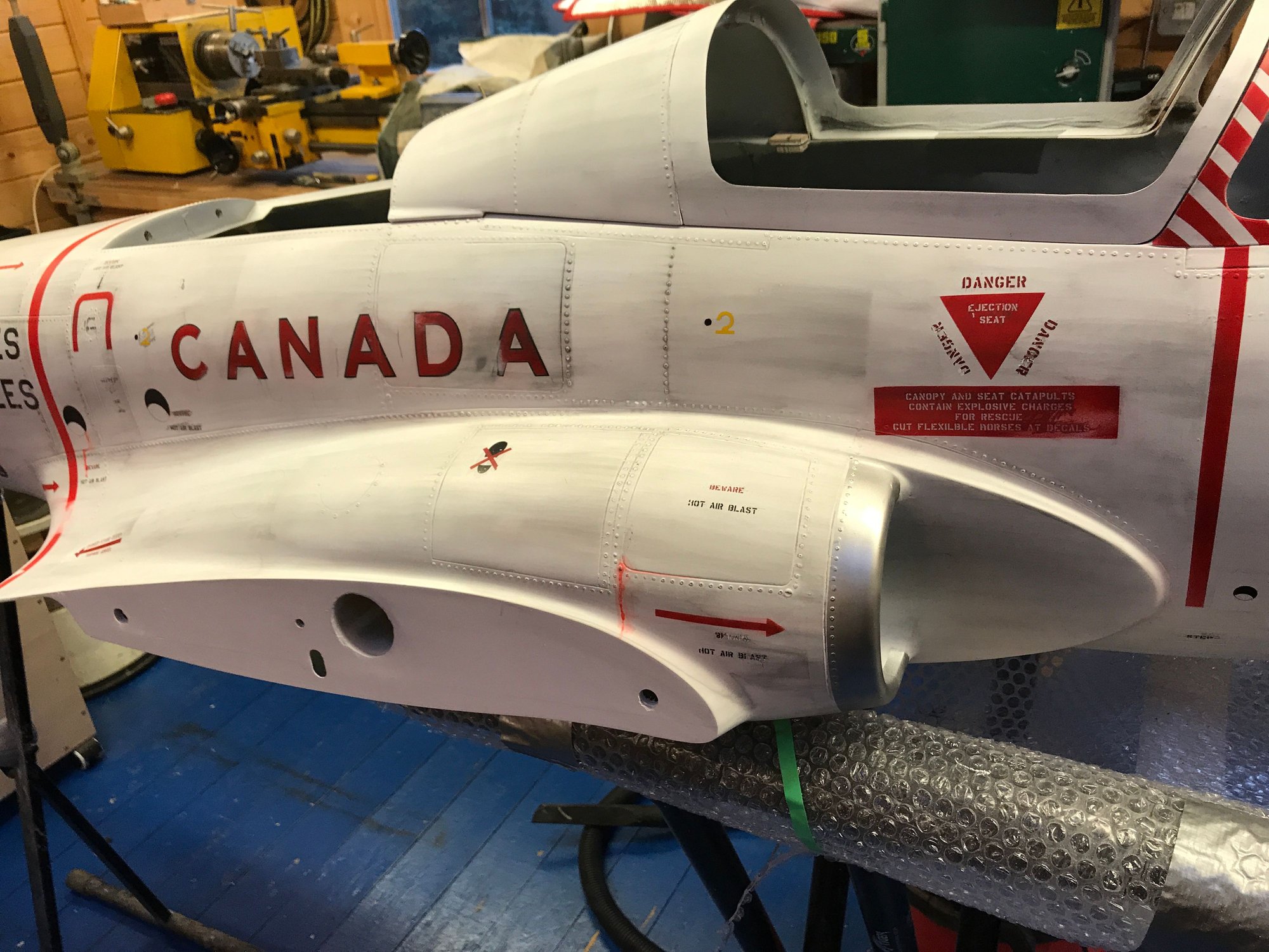

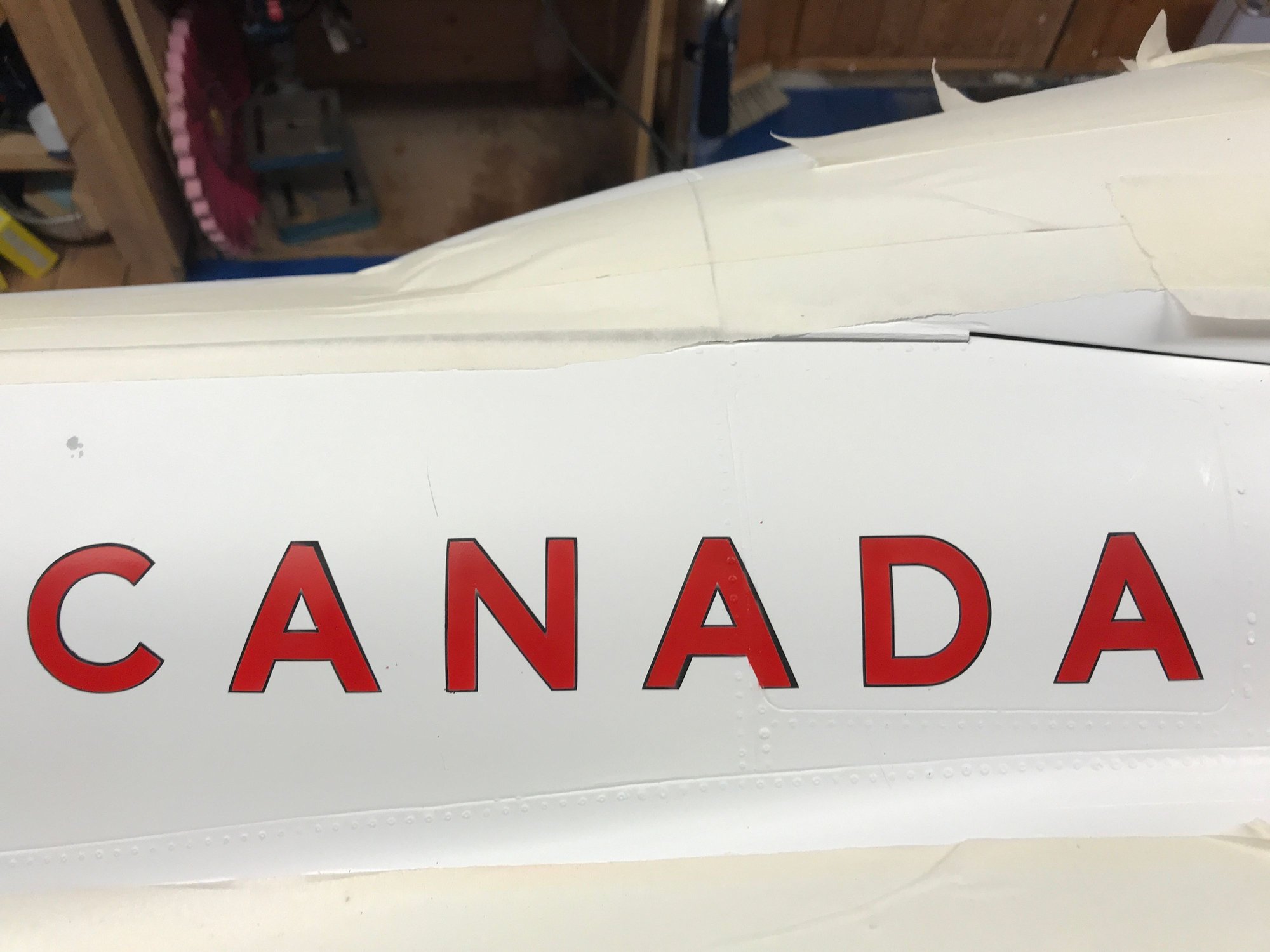

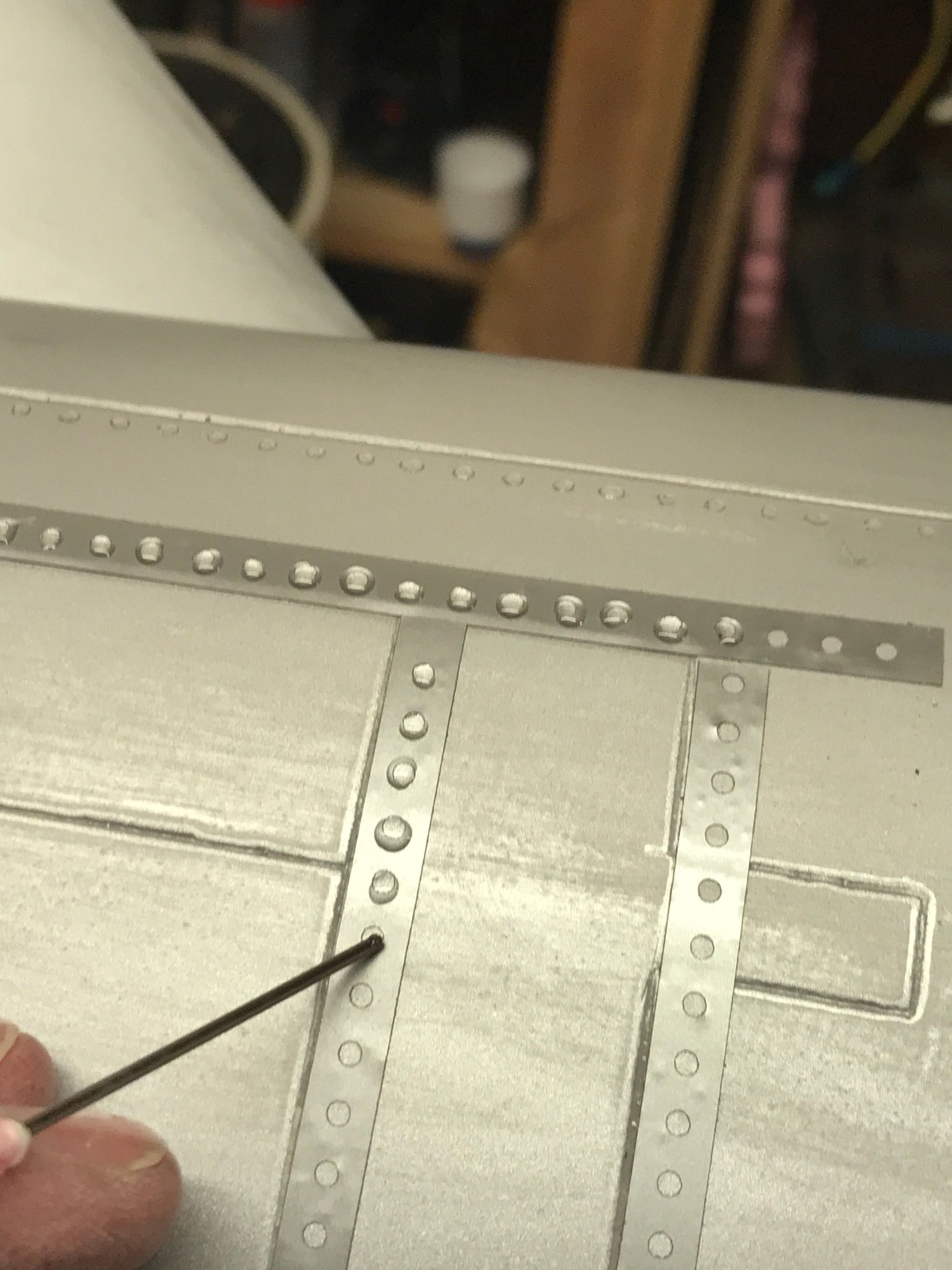

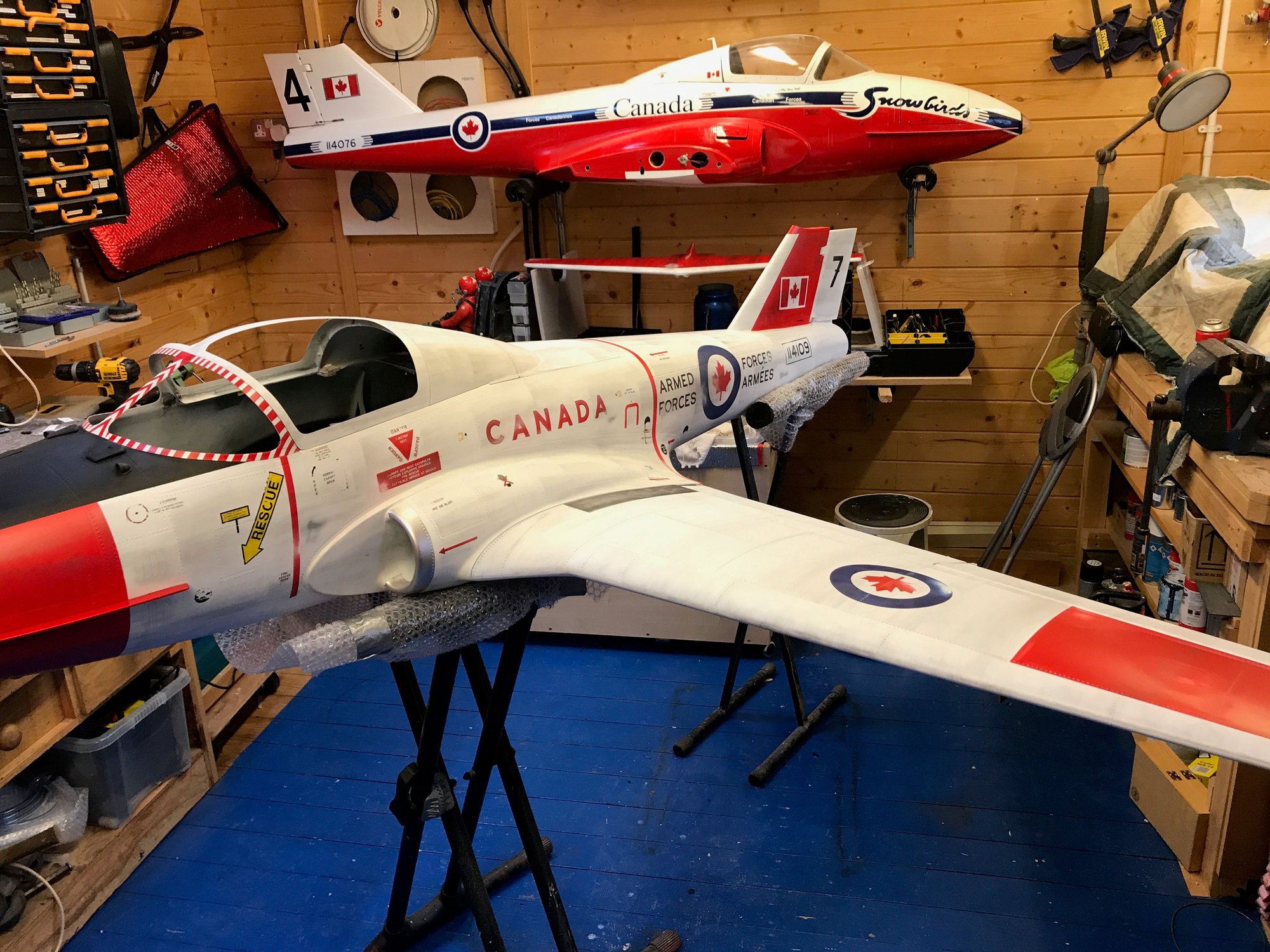

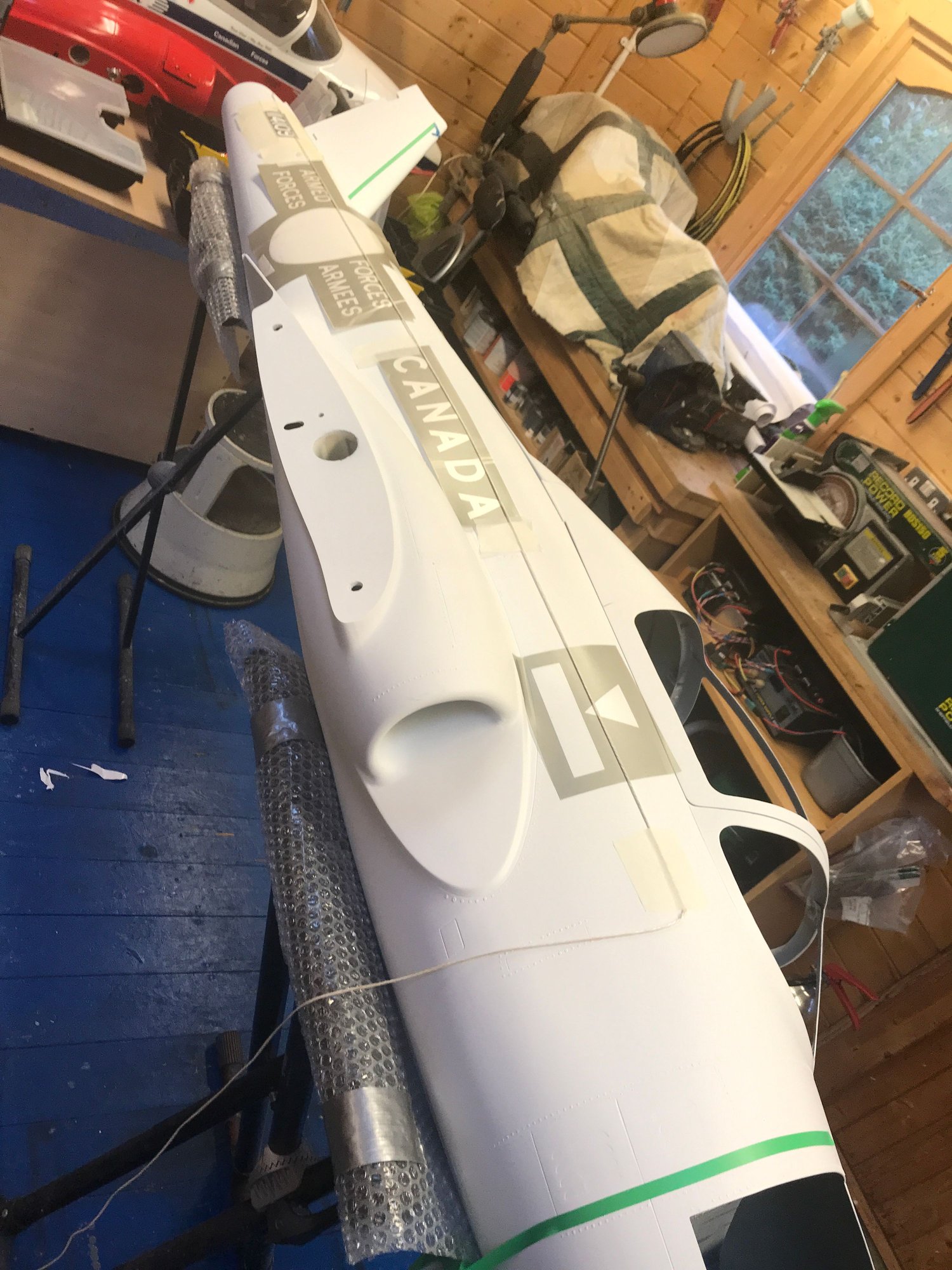

Hi, Well I got my new shell in late November and revised my idea for an aluminium surface finish in exchange for white. Firstly I wanted a unique scheme and aluminimum and chrome had been taken. I am not anal about it being a true scale replica but more about looking real and beaten up with dents and grazes from a hard life in the sky. To that end I have done rivets which my "Snowbird" scheme lacked as this helps with weathering and also scale effect in my view. I am about 3/4 into completion setup stage and am transferring all electronics and gear from the original ( seen in the background) with a few changes. This time I am still using Behotec oleos as they are bullet proof and proved well in the past but a change to their electric version of units and much more control over brakes. However all doors will be air operated as the rams are known position and worked well plus there is no fiddling around to get servos in the right place.They also keep the doors closed under pressure which is a natural thing with air rams.As yet I have not delved into the world of electric actuators and saw no reason to test this here. A P/Box Royal is transferred and this time I decided I would have the 30mm light in the nose but 15mm lights in the wings as I don't have to destroy the integrity of the wing section as before.Whilst this has worked historically they are quite hard to do neatly and strongly and the 15mm x 2 led from Unilight give virtually the same lumen power although of course the dish is half the diameter. I will use the 180 rx which has powered perfectly all other flights and as David says lots of power when needed but stooge around at 50 % throttle all day. There is also a throttle curve remember. I have Grumania pipe which weigh in at 1 1/4 lbs or 130 gr lighter than the stock beast and am using Power bus units so the fus/tail contains one main Power bus lead and not three plus lights ( agreed the p/bus unit weighs as well by but is very light). I have framed this with two layers of 2mm ply and epoxied it to the base of the fin with an access cover plate for programming shown here needing tidy up and paint and addition of hatch cover
. The hole can be quite small as all you need is room to press the main button and see the four lights. So will keep in touch and go from here to having a different looking Tutor to all others.
David
Thick cyno rivets
Not easy yo line up on a tapered shaft
This stencil was a challenge
Lots of dirt and scuff marks
Starting to become one unit

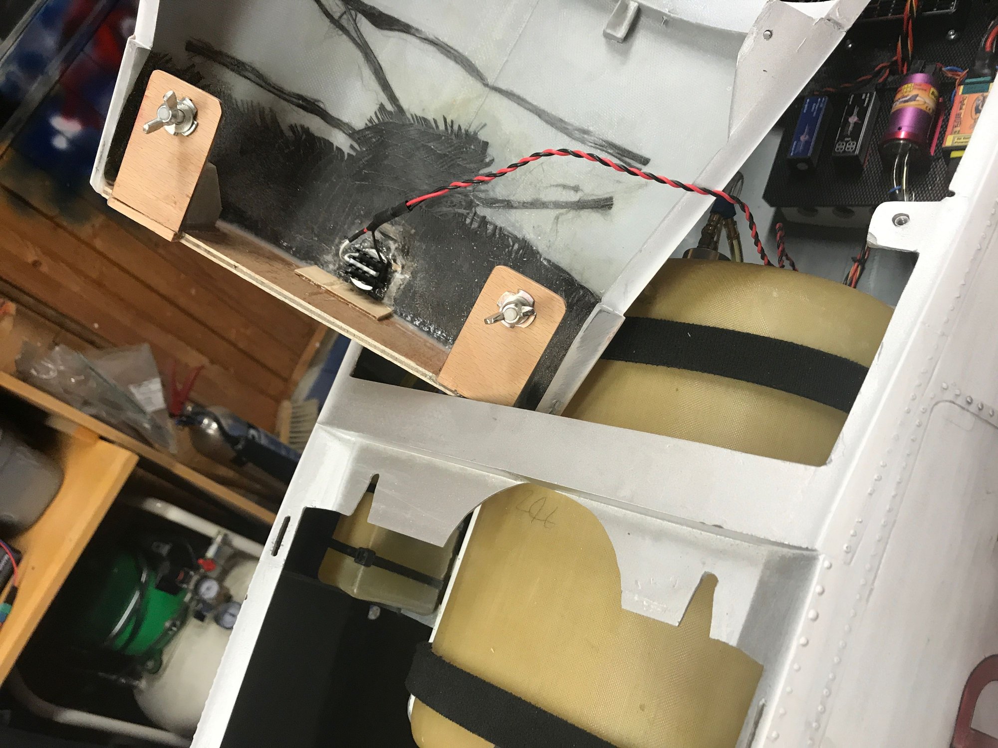

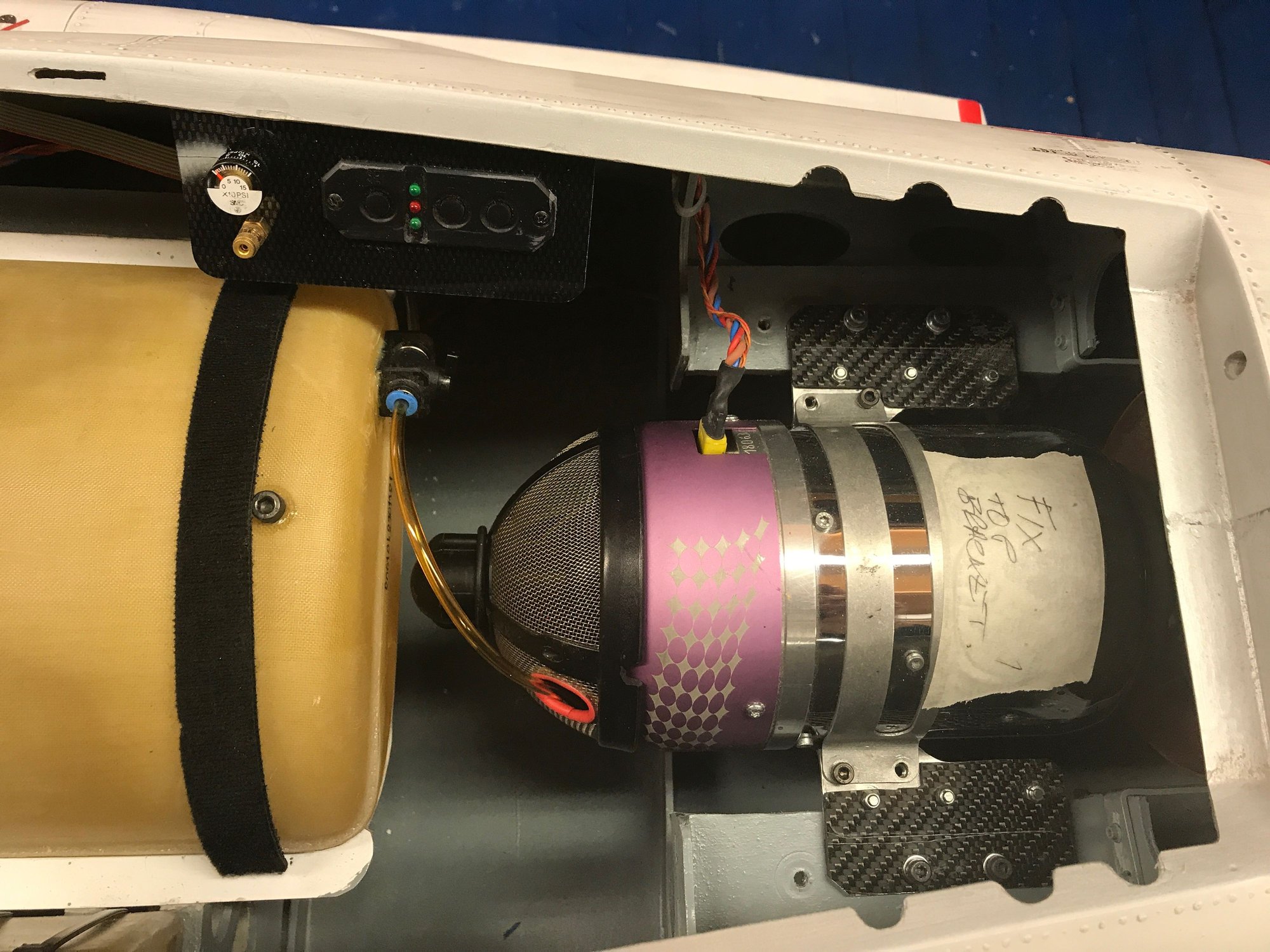

Default A few more snaps

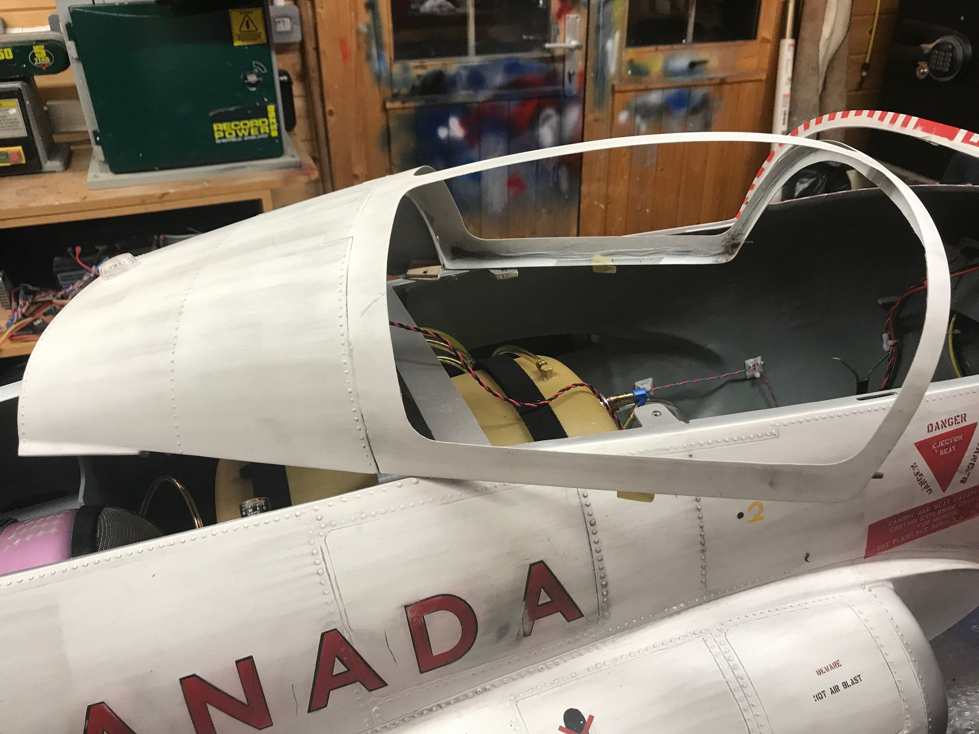

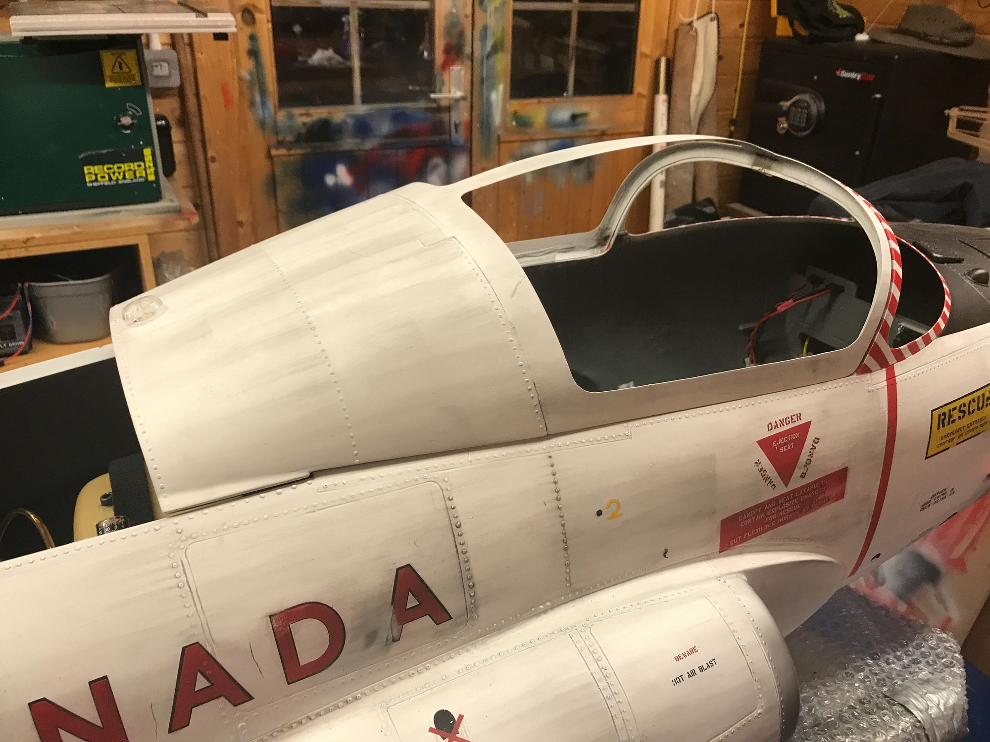

Here are a few more photos to cover other aspects of my build. I chose the one piece rear cabin and cockpit glued and screwed as one piece. To me this is a less fragile arrangement than the lift up scale version and with a trick shadow line yet to be painted it looks the same as the normal way. The standard way looked likely to be blown down the runway when left standing at the first gust of wind. Probably me being pessimistic !This of course means that everything like switches and air fill needs to be to the rear of this units edge so that constant on/of of the cabin and first rear cover is avoided. This worked well on the previous model and this is why I chose it again. The install has a few more bits and pieces like U/C Elec controller and associated leads to fit but is pretty much there now. The cut out in the fin is shown but needs tidying up and a hatch cover of thin epoxy sheet screwed in place painted red. I will do this when I have the red airbrush going.Next to turbine is the main switch and air fill for the gear doors. Again all reached outside of the main cockpit unit which can stay in place until major access is needed.
Regards
David
